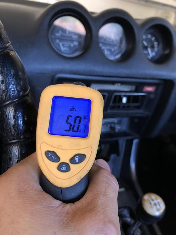

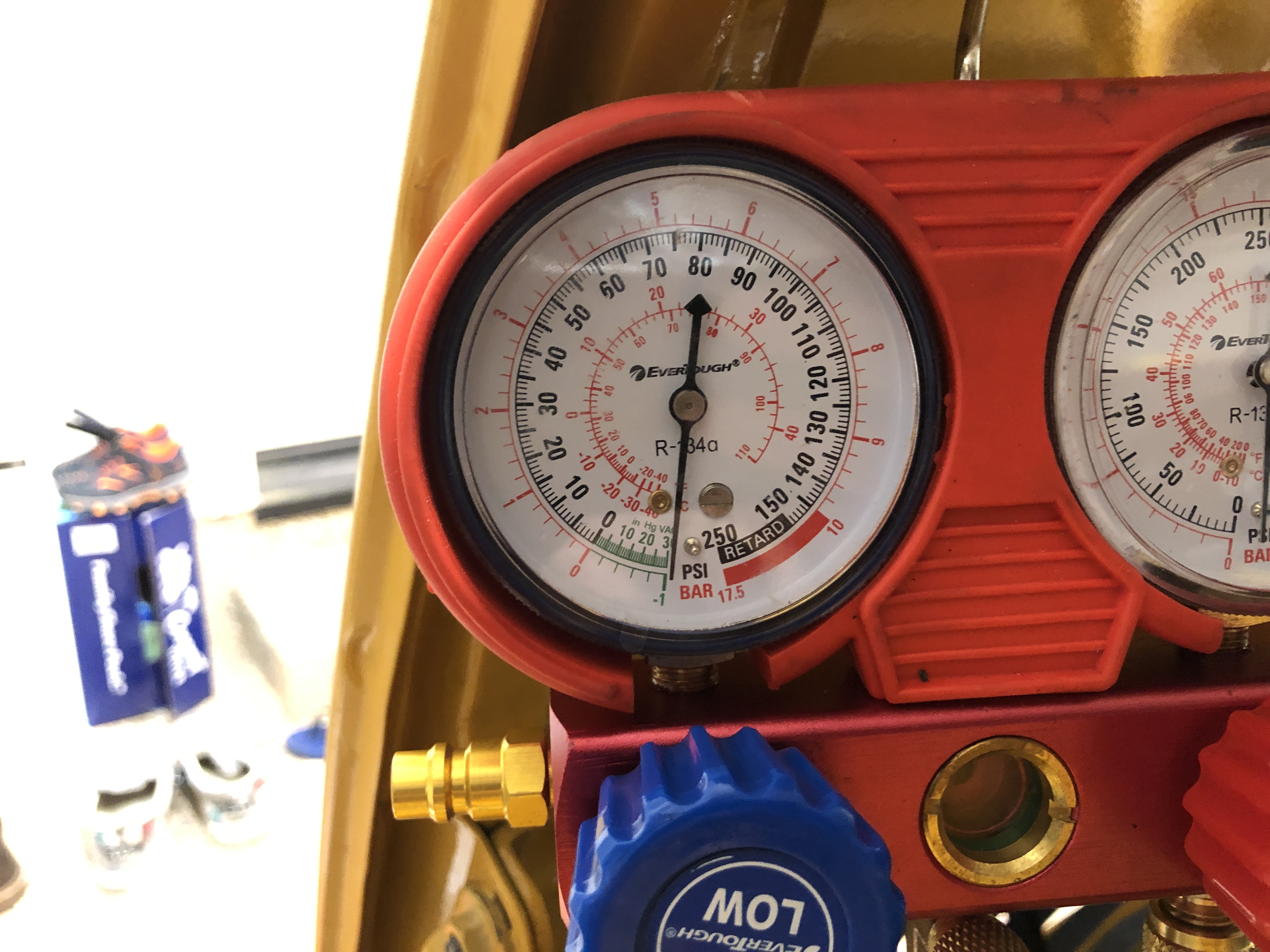

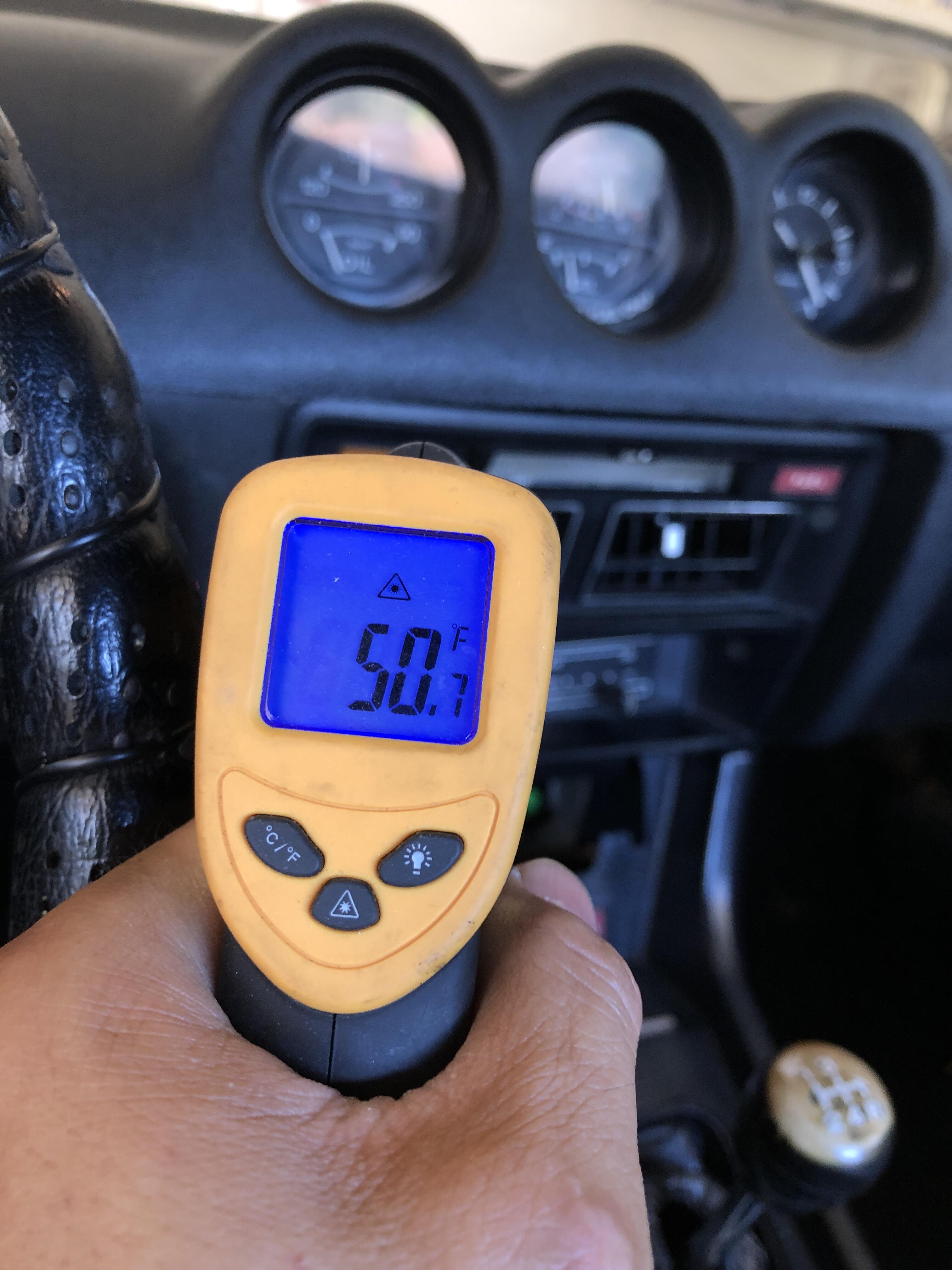

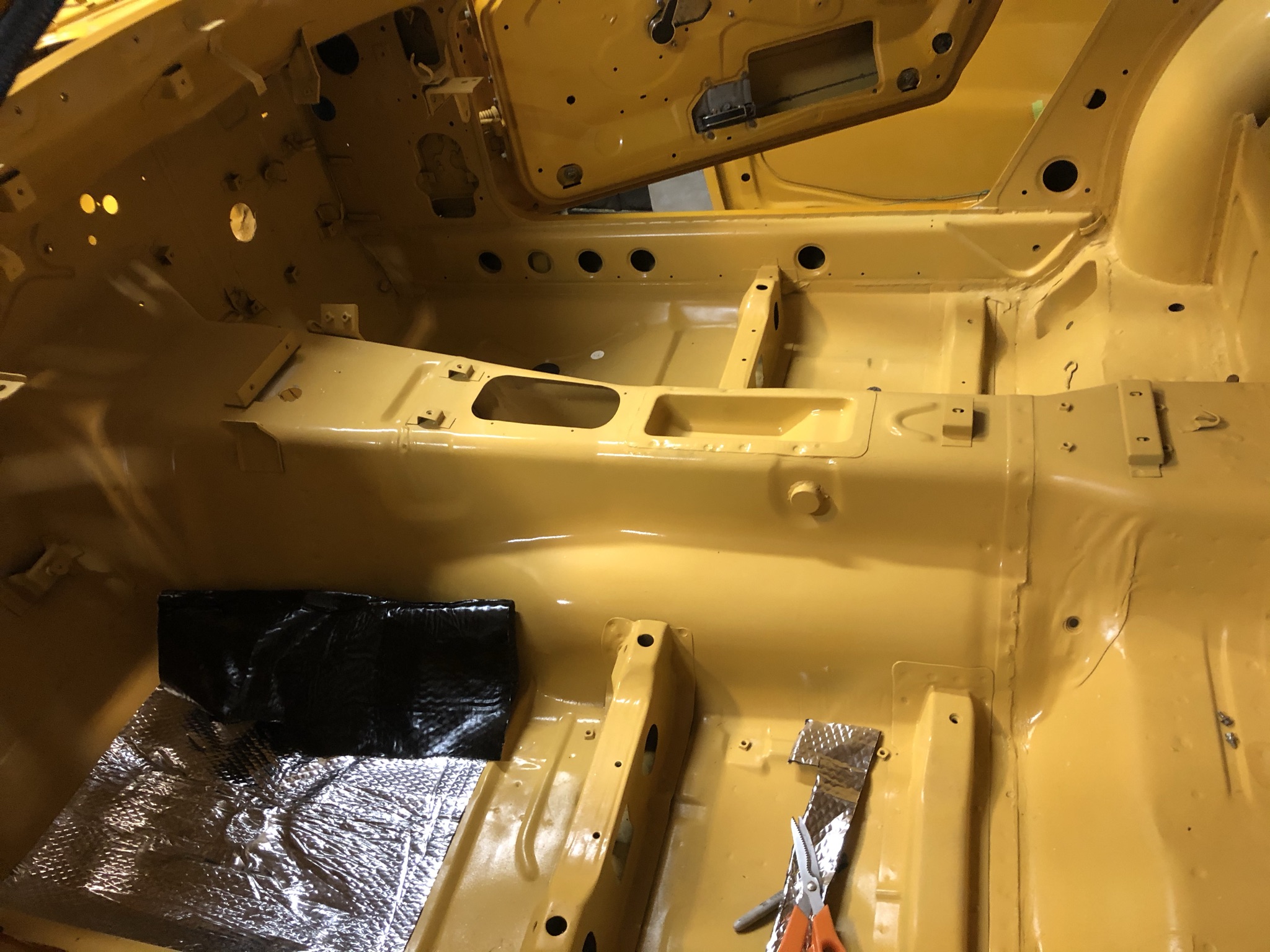

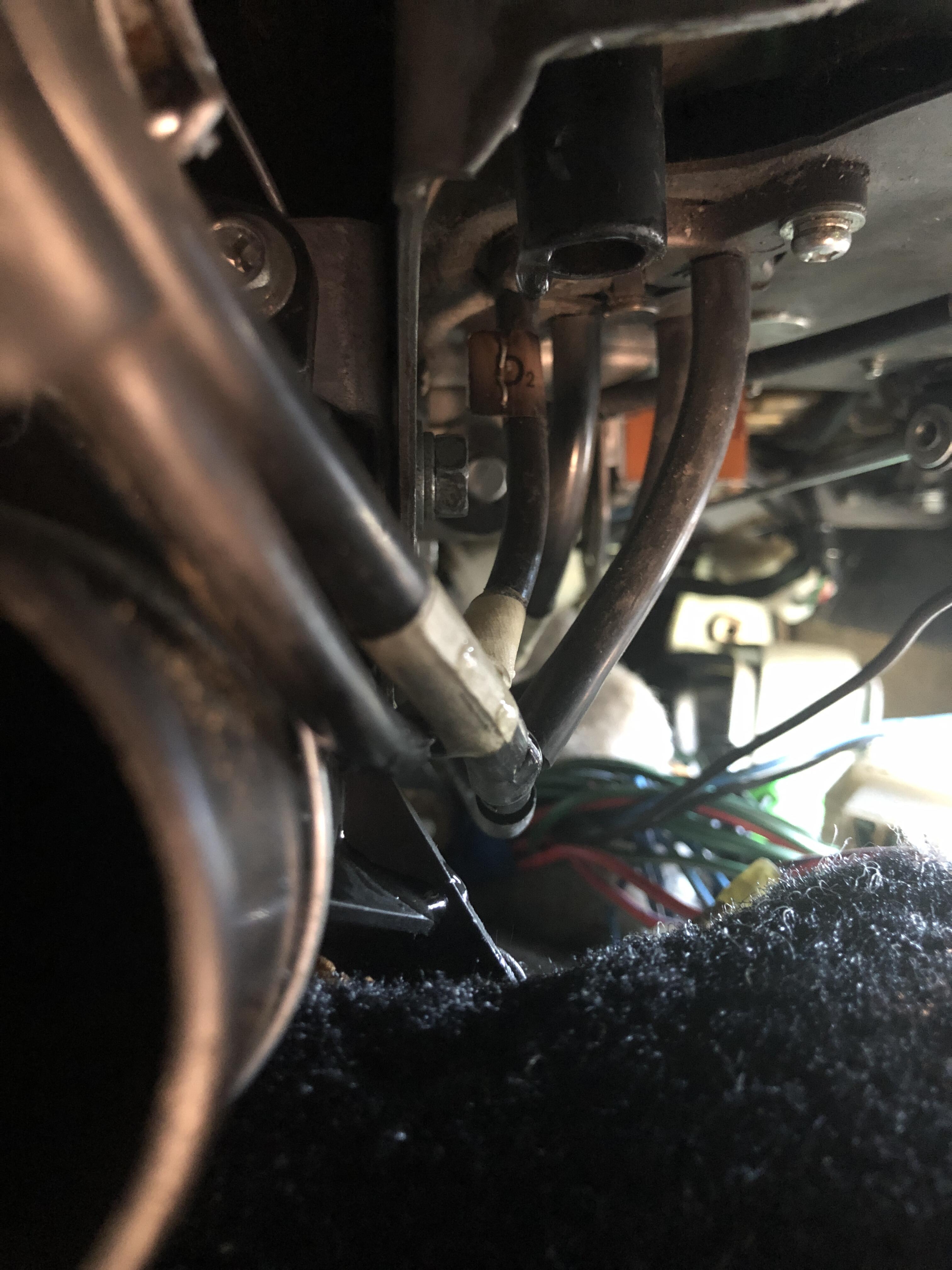

August 10, 20213 yr Author comment_626626 Greeting! I skimmed the gym’s sauna last could of months by using my sauna on wheel but can’t stand it anymore.  When the car is moving I guess it’s bearable, but boy, people saw me wipe sweat off of my face at red lights … I can see their sympathies in their eyes…. below was how I did it.  Hopefully it can help somebody learn from my experience or avoid my mistakes.  Keep in mind I’m not a mechanic let alone AC specialist. the R12 to R134a valves conversion do  not work.  Parts are below  All I did was remove the caps and screw the new valves on top of the old ones.  The high valve is toward the radiator, the low valve is toward the firewall. I follow the online instructions of how to pull the vacuum, close the valves at the gauges and turn off the vacuum pump.  Left it like that for 12+ hours.  Seem like there is no vacuum leak after more than 12 hours with 29psi solid.  i used 3oz ester oil and 2 can of 12oz R134a without any additive from Oreily.  Some one from this forum and other places suggest to put approximately 80% of R134a as molecular is lighter, operate at higher PSI.  So I put in approximately 18oz of r134a Outside temperature was in the mid 70.  After 3oz of ester oil and 18oz of Freon, cabin temperature measure was about 50 degree.  I’m so happy.  Been running almost every other day for 30mins to 1 hour happily without wiping sweat off of my face.  Other avid drivers were surprised why my windows were up mid afternoon knowingly cars this era often than not, no AC.  last couple of days, I notice when I made a sharp right turn, about a tea spoon of water splashed on my right foot.  Closer examine under the evaporator under the radio, there is a, suppose hose connector to drain the condensed moisture.  I suppose it need to connect to that hose and down the transmission housing.  You can see a drop of water about to fall.  I couldnt find the hole on top of the transmission housing.  Perhaps my carpet/sound deadening cover it.  Can someone confirm?  Edited August 10, 20213 yr by 240zadmire Link to comment https://www.classiczcars.com/forums/topic/64339-1977-280z-ac-issue-xx-of-yy/?&page=3#findComment-626626 Share on other sites More sharing options...
August 10, 20213 yr comment_626631 congrats! yes there should be a hole for the condensate hose. Link to comment https://www.classiczcars.com/forums/topic/64339-1977-280z-ac-issue-xx-of-yy/?&page=3#findComment-626631 Share on other sites More sharing options...
August 11, 20213 yr comment_626667 You should be able the find the drain hole near where the carpet ends in your picture, under the drain tube. Link to comment https://www.classiczcars.com/forums/topic/64339-1977-280z-ac-issue-xx-of-yy/?&page=3#findComment-626667 Share on other sites More sharing options...
August 11, 20213 yr Author comment_626676 You’re right.  Looked back at old photos and there it is.  Got the hose hook to the tube and it actually quite a bit of condensation.  Probably about 2 full spoons of water when park in the garage.   Link to comment https://www.classiczcars.com/forums/topic/64339-1977-280z-ac-issue-xx-of-yy/?&page=3#findComment-626676 Share on other sites More sharing options...
