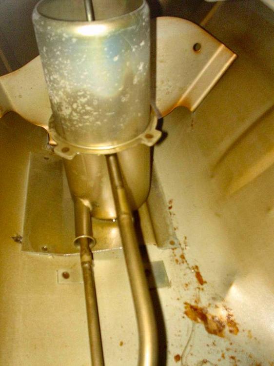

here's a pic of the pickup in a '77.
The crud at the bottom appears to be rust.  It does not scrap off with a stick.
Since gas floats on water. Rust will occur on the bottom of the tank first as well as in the air space above the gas where condensation occurs.
The larger upper tube is the send to the engine and the lower is the return.
above provided by..
http://240260280.com/legacy/techtips/fuel/gastank/index.htm
