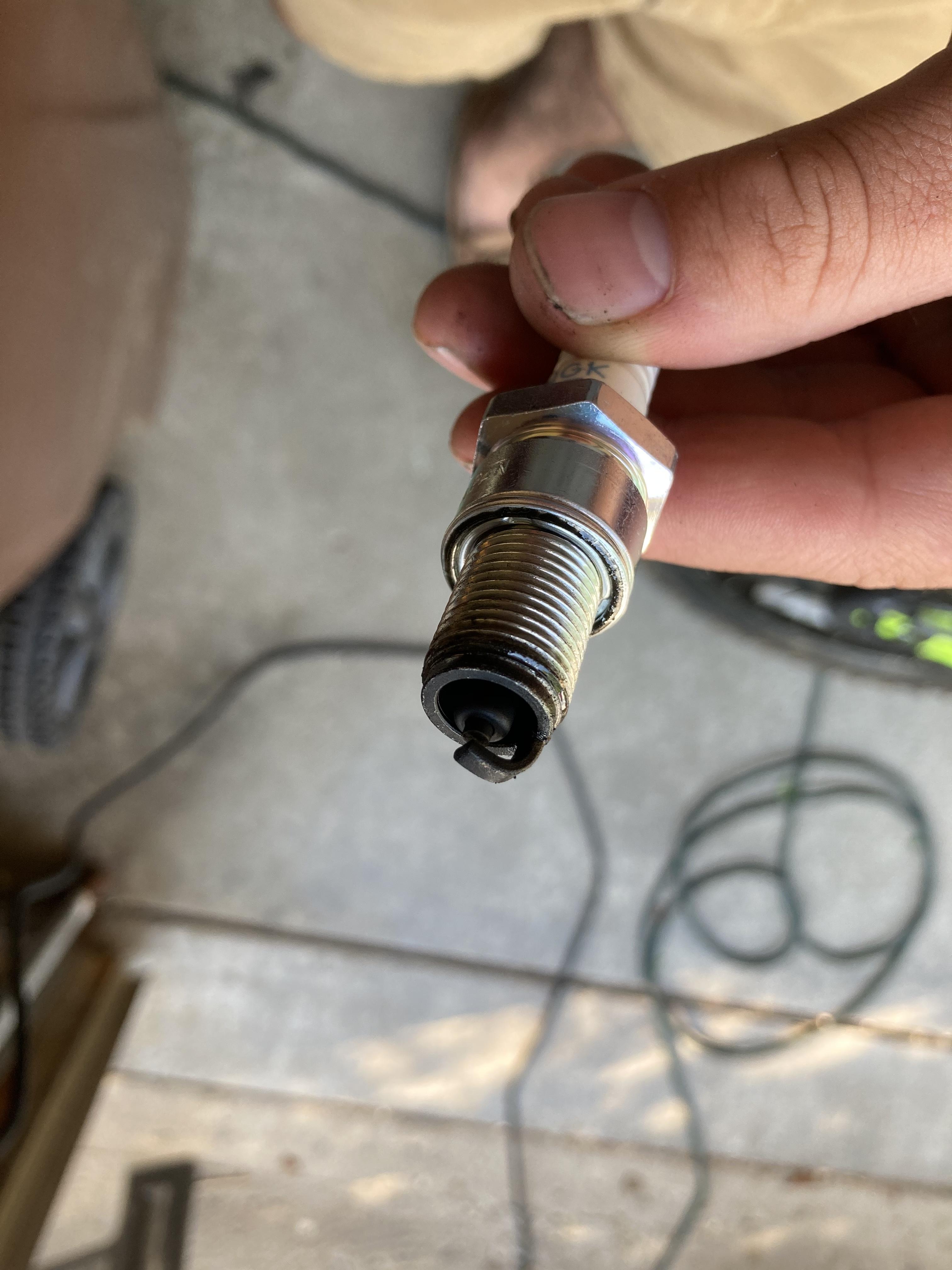

this car is giving me so many issues. Doesn’t accelerate over 2k and dies on hills, not to mention it burns through spark plugs.
It runs and drives decent fine with brand new plugs, but they only last about 8 miles MAX.

Yes, if the water temperature sensor is disconnected the ECU will supply maximum extra fuel.  That's probably why yours is running so rich.
If it doesn't run when it's connected it might be because it is shorted out, making the mixture as lean as possible.  Or because you have a large vacuum leak, maybe through the PCV system.
