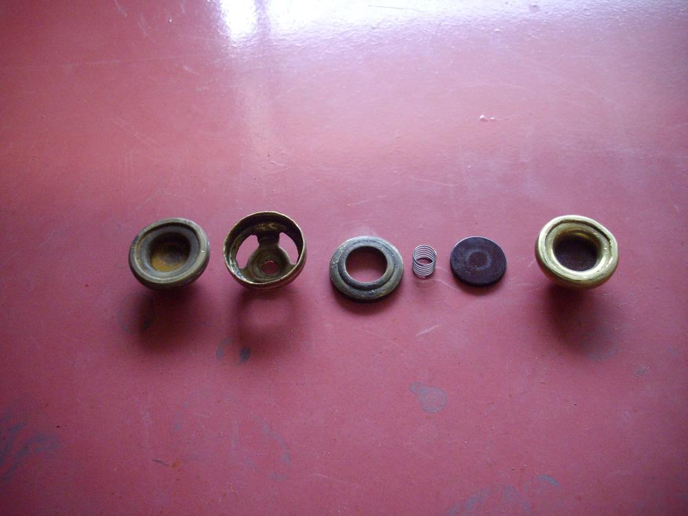

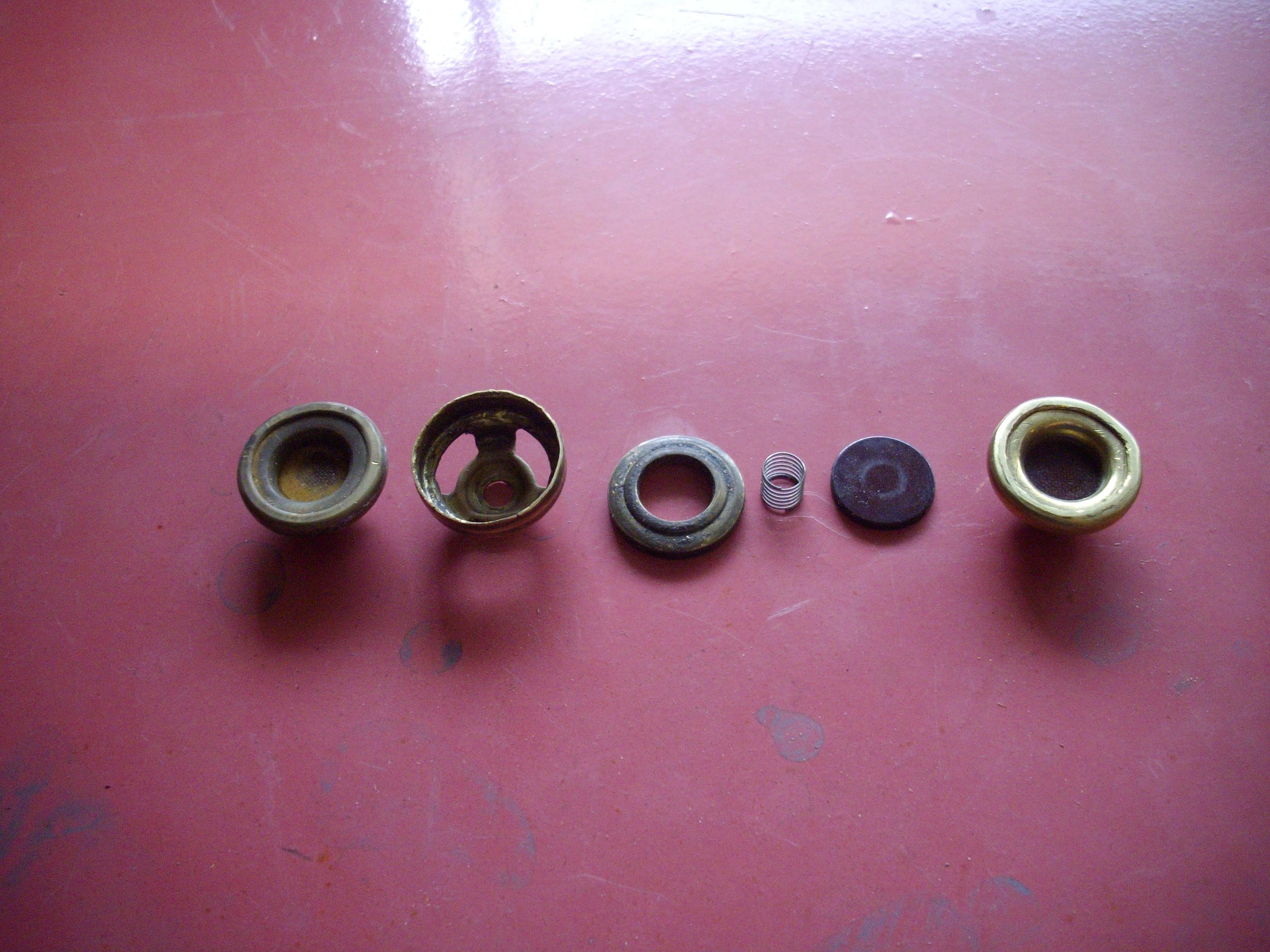

Thought I would see if the original check valves could be reused, so the first one is an old used valve, middle four are all the bits when taken apart and the last one is one cleaned up, disc flipped around for a new surface and seat buffed up. IMGP2156.jpg
