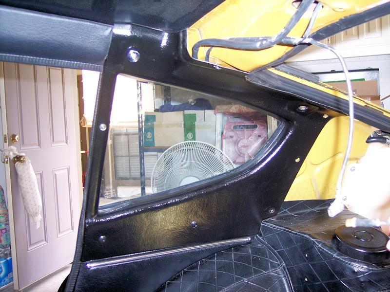

Here's a pic of the wires in place on my car, the only one I have of this area.  You'll probably have to rub a "fish" wire down thru the opening where the wires emerge.

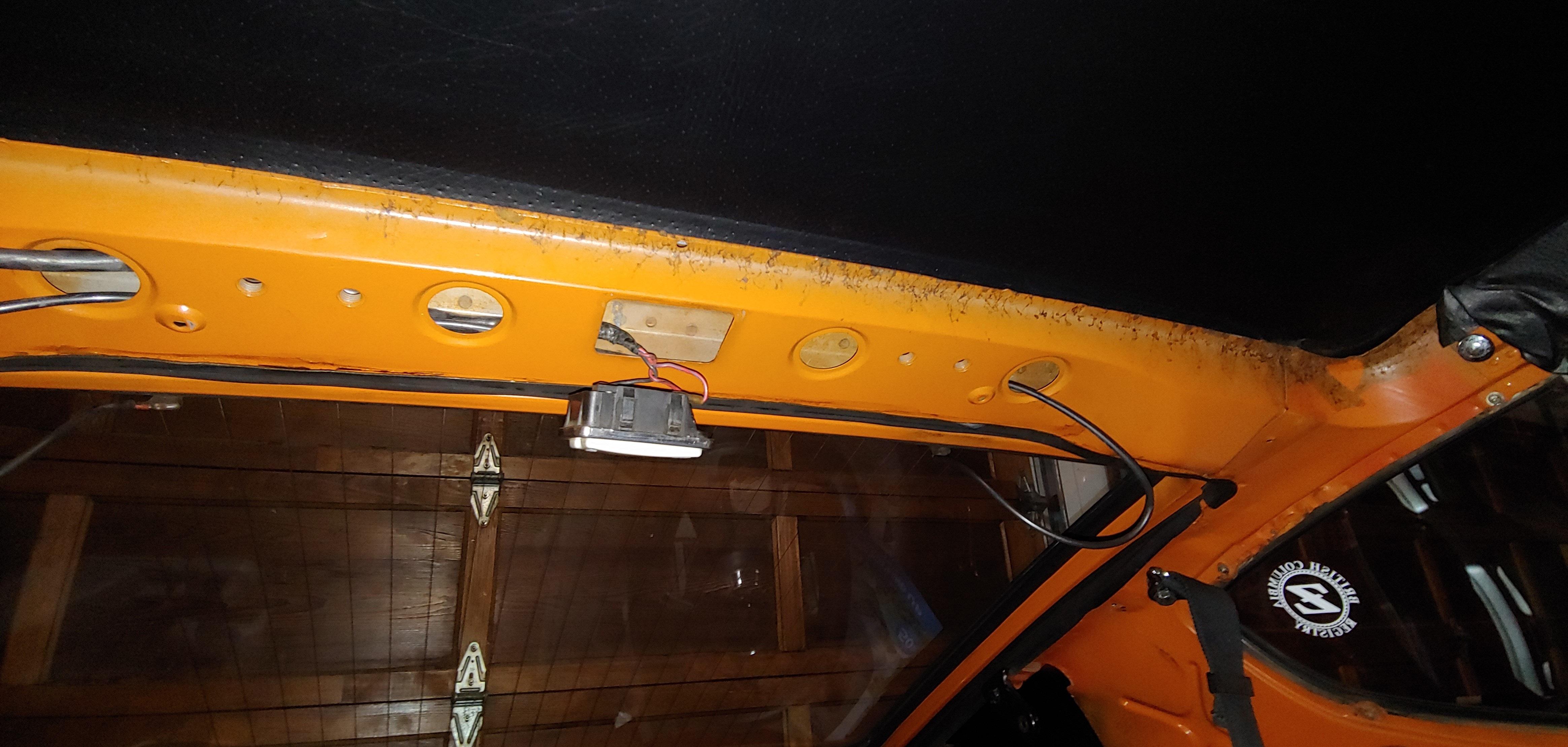

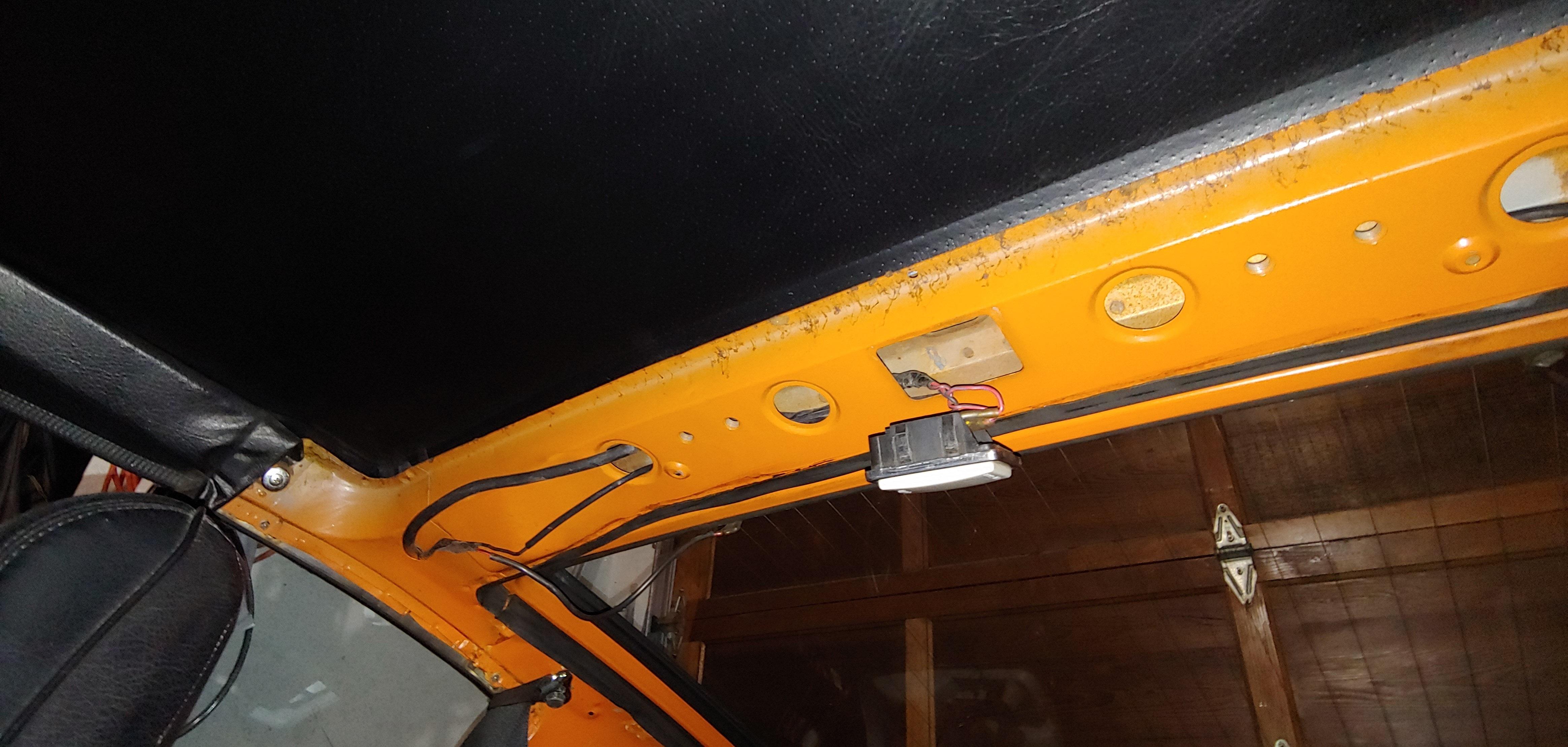

Here are a couple more pics, I'm slowly disassembling my 7'70 car. Hope they help
This helps a lot. I've been trying to fish the wires in the channel behind the hatch hinge not outside of the channel as shown.  I have 500 pictures of the disassembly but not this one. Thanks!
