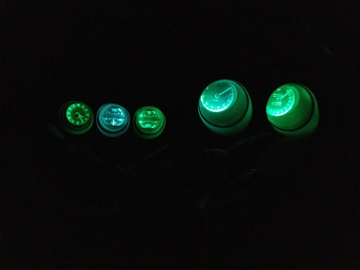

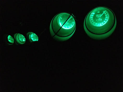

For comparison (image 1) I installed 2 white LEDs in the Tach and I installed 1 white LED in the center gauge (AMP/Fuel).  The remainder of the gauges and the speedometer has Green LEDs.   Green LEDs populate all gauges in image 2.

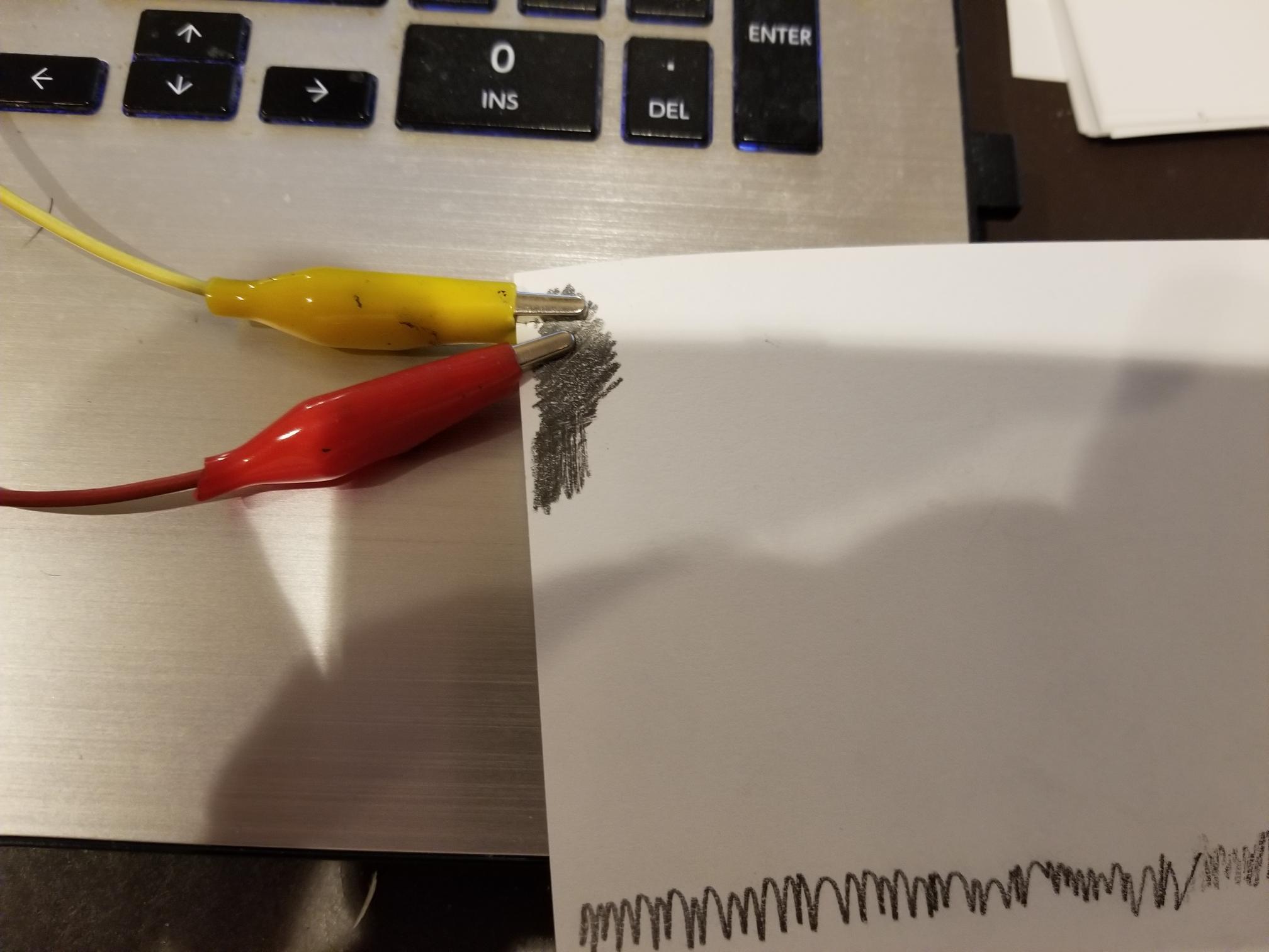

Its Sunday, I am trying to be a good citizen and not go out unless it is an absolute necessity.  When I was a kid I had some hobby kits where you build things and do experiments.  Anyway, here is the cool part (at least in my opinion), if you draw a box, on an ordinary piece of paper,  and fill it in with an ordinary pencil you will have created a resistor.  If you put an alligator clip with a wire attached to it on each side of the block you can measure the resistance that you just created.  If you want less resistance put the clips closer together, more resistance – space the clips further apart.
Homemade resistor
So W3wilkes – the answer to your question is that the recommended LEDs are dimmable.  I suspect that the dimmer in your Z (mine is a 1973 240z) may not work because the resistance in it is too low.  But if you get a dimmer in the 0 – 1k ohm range you will be able to dim these LEDs.

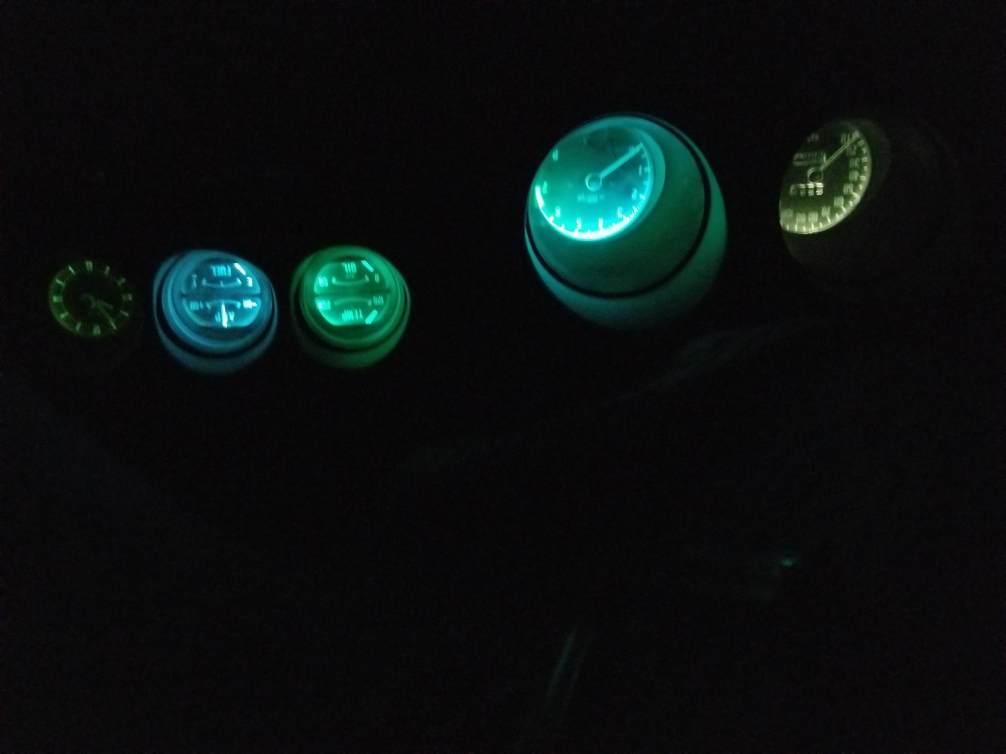

LEDs with no dimmer (speedometer, oil/temp and clock) - Green LED
Tach and amp/fuel) White LED
LEDs with 458 ohms of dimmer resistance

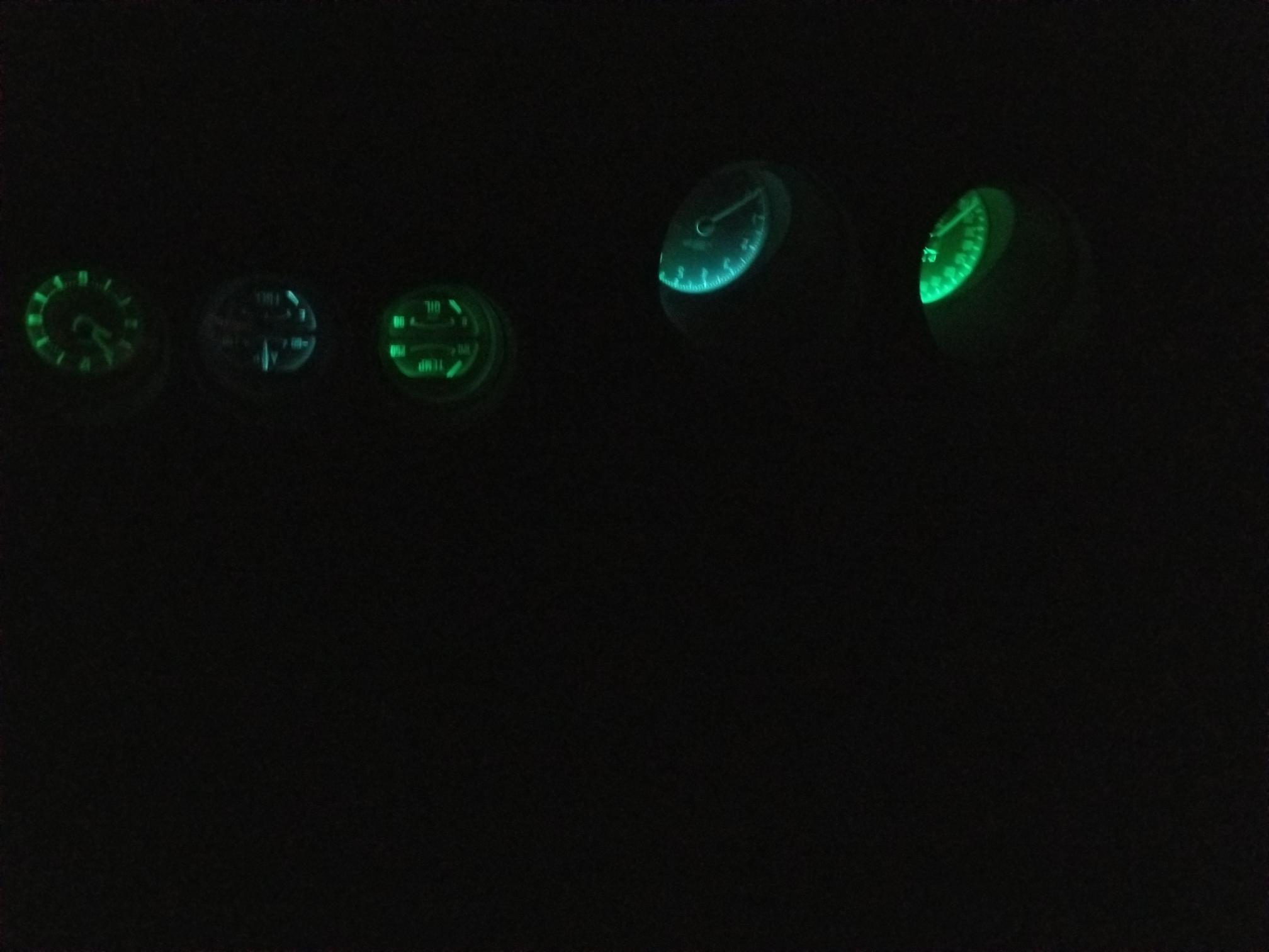

The next image has no dimming, Incandescent lamps in the speedometer, and clock, Green LED in Volt/Temp gauge, and white LEDs in the tach and amp/fuel gauge
You must take care in picking the resistance value if you mix incandescent lamps and LEDs.  You might be able to get away with using the original dimmer if you have a few incandcent bulbs and some LEDs.  I think I will try to go with one or the other.  My conclusion is that I prefer either the white LED with a dimmer or the incandescent lamps and a dimmer,  I might consider white LEDs in the speedometer and the Tach and incandescents in the 3 gauge set.
