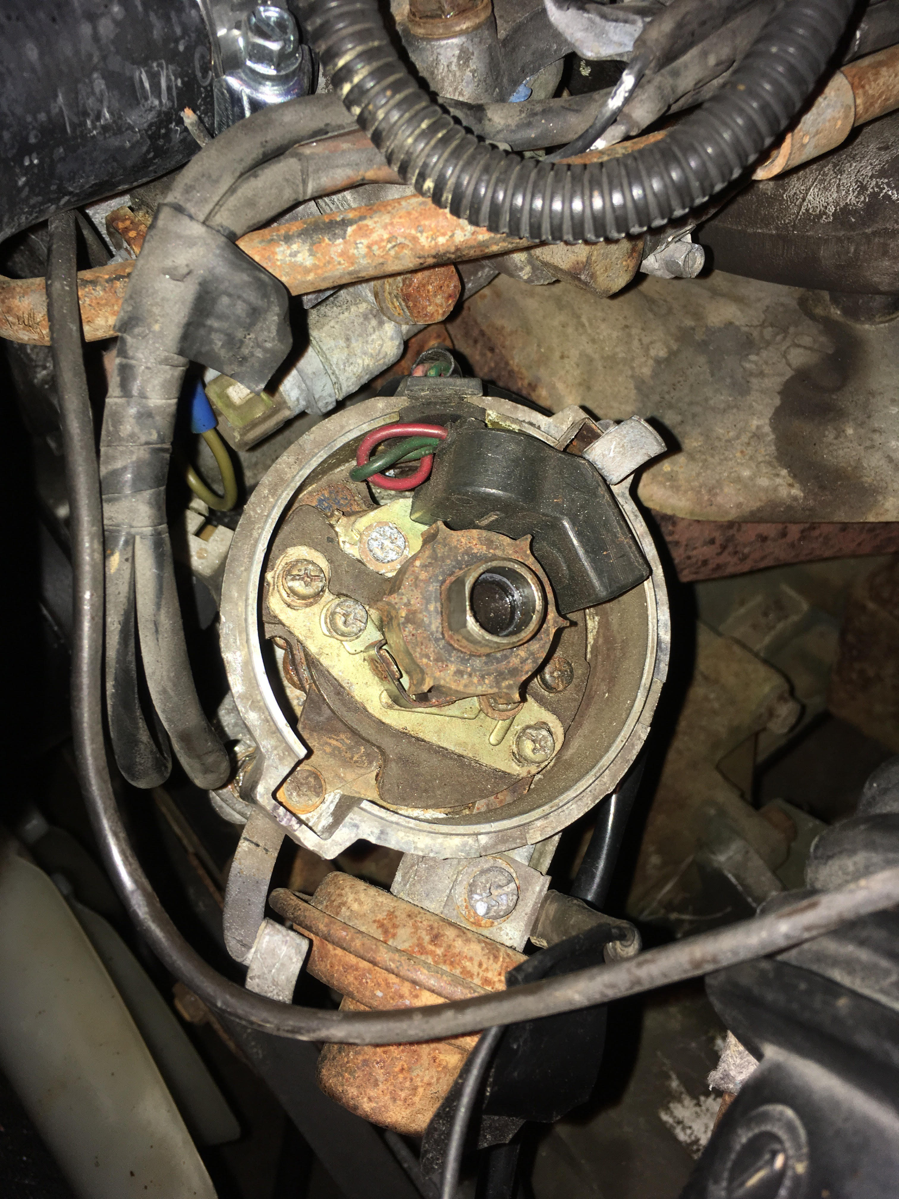

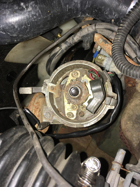

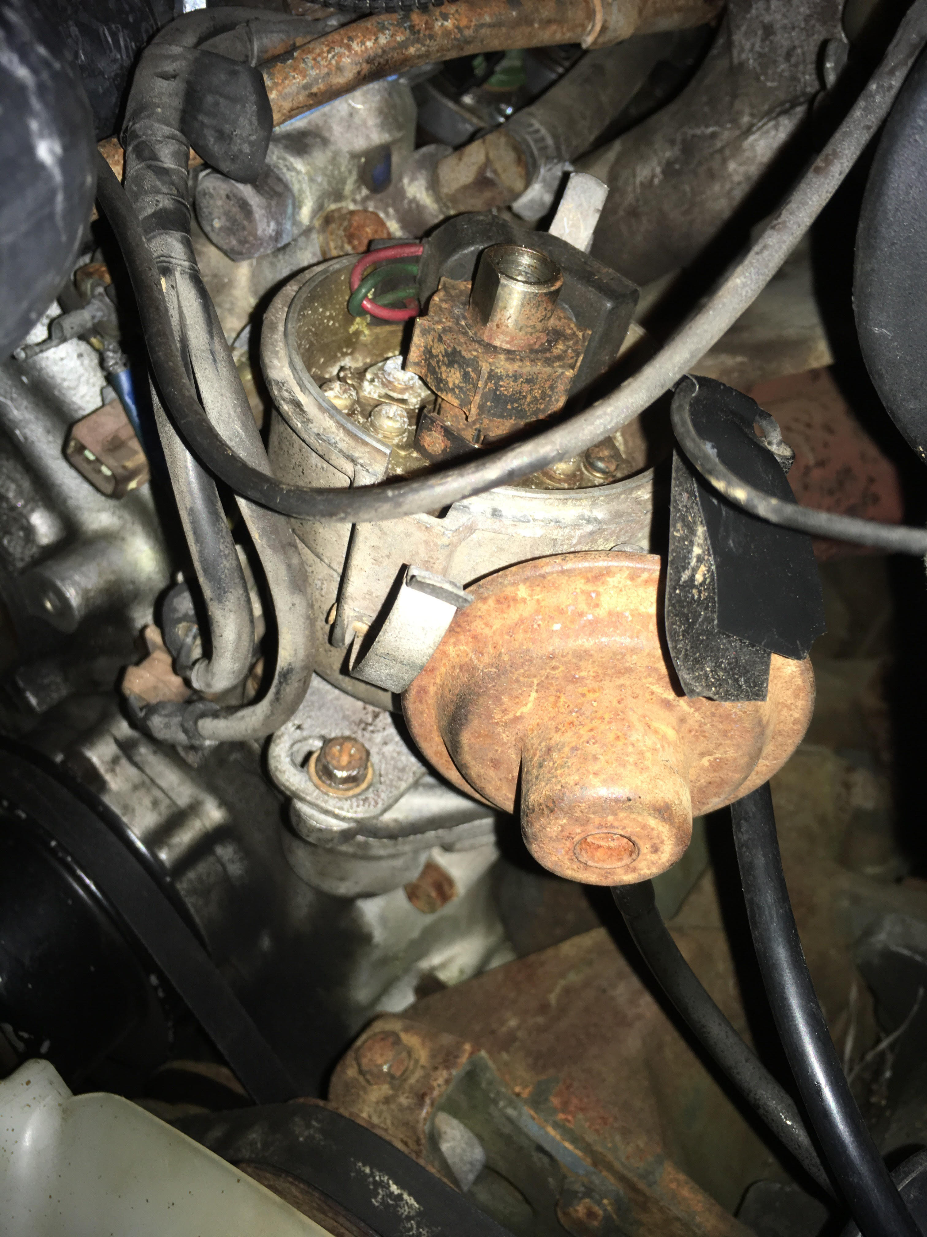

Still waiting for that picture...
I know... I appreciate your help. I'm gonna try to do it tonight. I live and work 20 mins away from my garage.
That's a 280Z distributor not 280ZX.  Looks like the lock-down screw ins in place and tight.  Were both spring clips properly in their slots when you removed the cap?  They can be difficult to get in to position. I always have to use two screwdrivers, one to locate and one to apply pressure until it snaps in to place.  Can't get my fingers down there.
Did you check the cap for looseness when you wee removing it?  This was mentioned earlier as a possibility.  The cap should be rock solid on the distributor body.  Pressing on it should have no affect at all.
