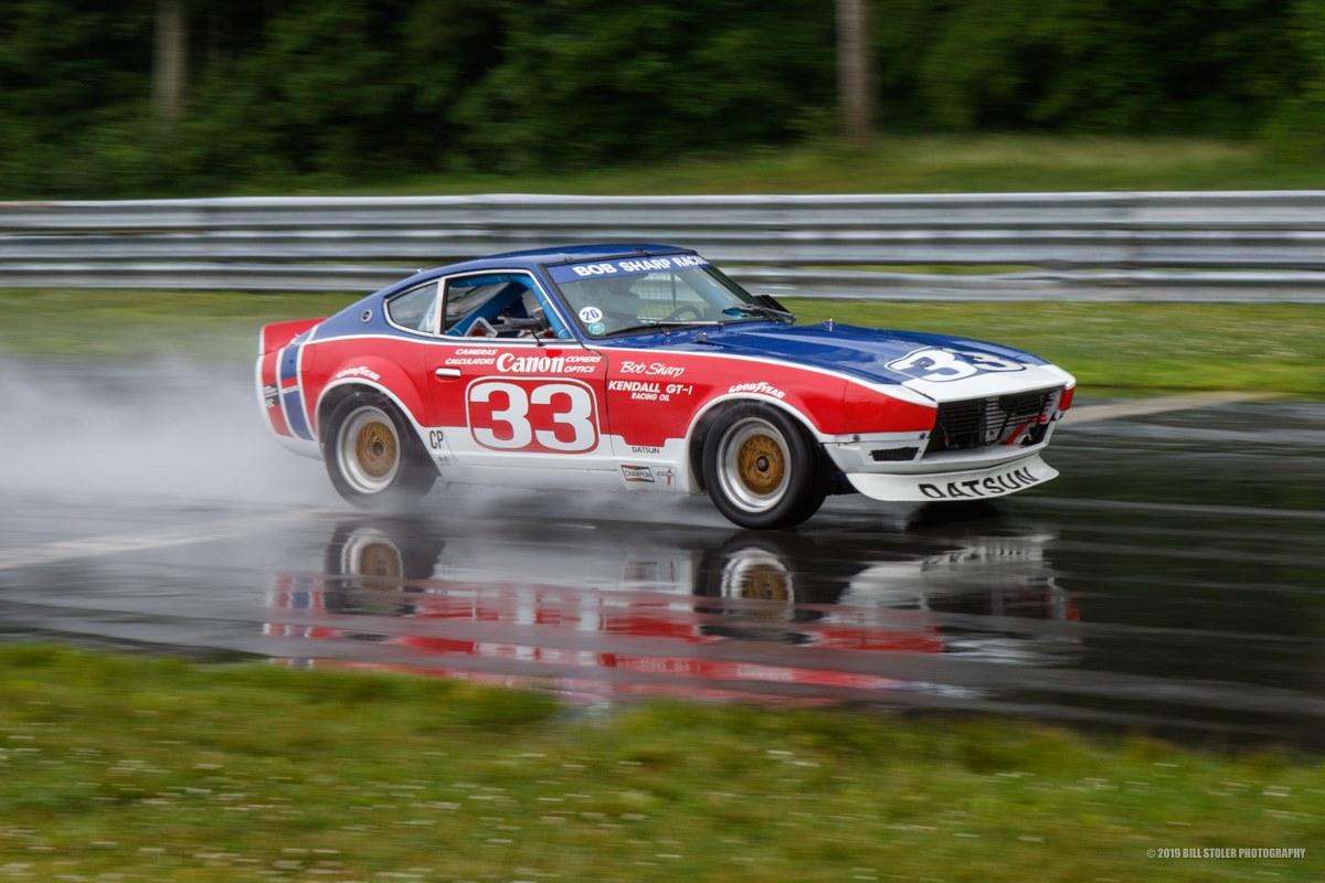

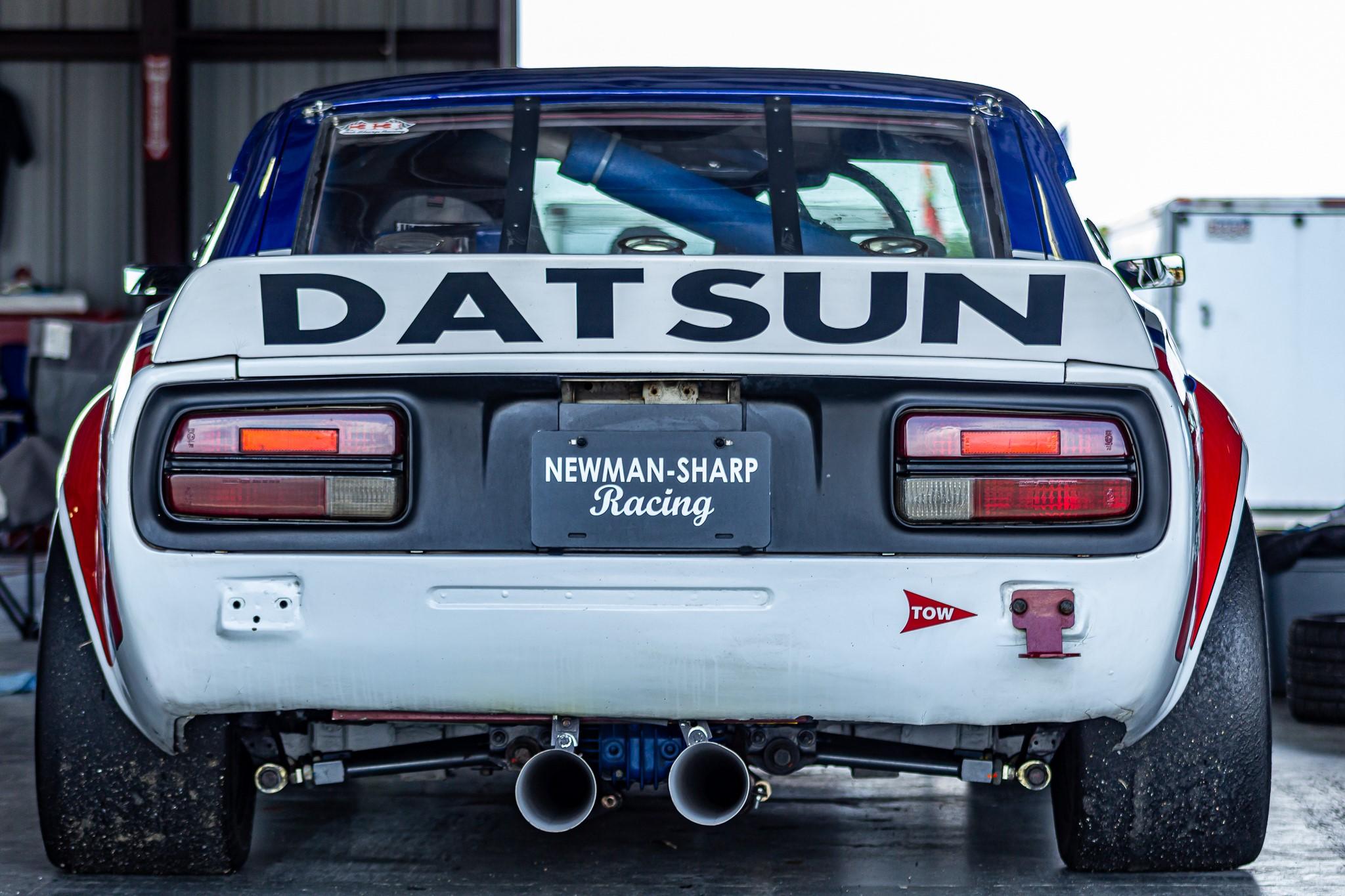

January 7, 20205 yr comment_590541 Starting in 2003 we have gone from stock fronts and rear drums (autocrossing) to S8W to S12W and drums (track days) to S12W and Wilwood rears(vintage racing). RockAuto calipers taken apart and Swan coated. Have run Porterfield front pads and shoes until our various engines started to overrun the brakes (current: L28 - NA making 260rwhp). Moved to Carbotech 3 years ago all the way around. Brake ducts for the past two years. Motul 660 or 600. We would bleed before each race weekend and at the end of each day but not anymore. Upgraded to 280 booster and 15/16 MC along with stainless lines. Gutted stock prop valve and installed inline valve. Removed all this after 3 years and installed Wilwood pedals, bias adjuster and 3/4 front MC- 5/8 rear with equal length front brake lines the winter of 2018/19. Now moving to Wilwood front 4 piston calipers (12 inch dia & 1.25 inch wide rotors). Getting out braked by the SCCA guys running their 240/280s as GT-2s. All this on 15 inch wheels with either Toyo RA1s ( 225/45/15) or Hoosier R7s (225/45/15-front and 275/35/15 rear). Love the Toyos, they are great from the start if used as rain tires until you wear them down or have them shaved to 5/32. Under 5/32 they are like slicks. Very predictable. Hoosiers are a blast especially with the 10-inch rear wheels. In the rain 225 Hoosier wets all the way around, I have a set of Porterfield and Nismo rear shoes available.  Edited January 7, 20205 yr by gnosez Link to comment https://www.classiczcars.com/forums/topic/63288-stock-brakes-for-track/?&page=2#findComment-590541 Share on other sites More sharing options...
January 8, 20205 yr comment_590562 Love that 33! Link to comment https://www.classiczcars.com/forums/topic/63288-stock-brakes-for-track/?&page=2#findComment-590562 Share on other sites More sharing options...
