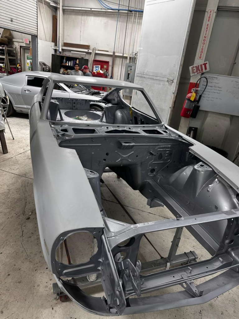

The body shop sent a couple of pictures.  The rest of the car may be done this week.
I don't know why, exactly, they aren't following my instructions.  I mean, yeah, the instructions are many pages long, but specifically, I wanted them to spray the car all at once.  And, I didn't want them to remove the headlight housings for painting.  I think they know what they know... and don't want to depart from methods they think (or know) are best.
I realize that they may not be equipped to spray the car all at once - paint can dry during the process and that can create its own problems.  Anyway, I am sure it will look nice when it is done.  I just hope it looks similar to how it looked when it was sprayed at the factory originally.  That is one of my goals.

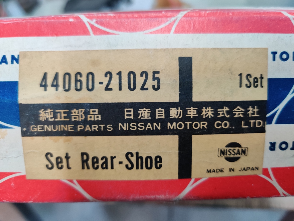

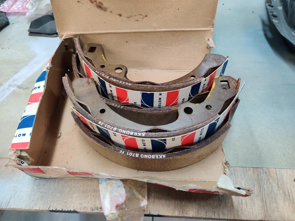

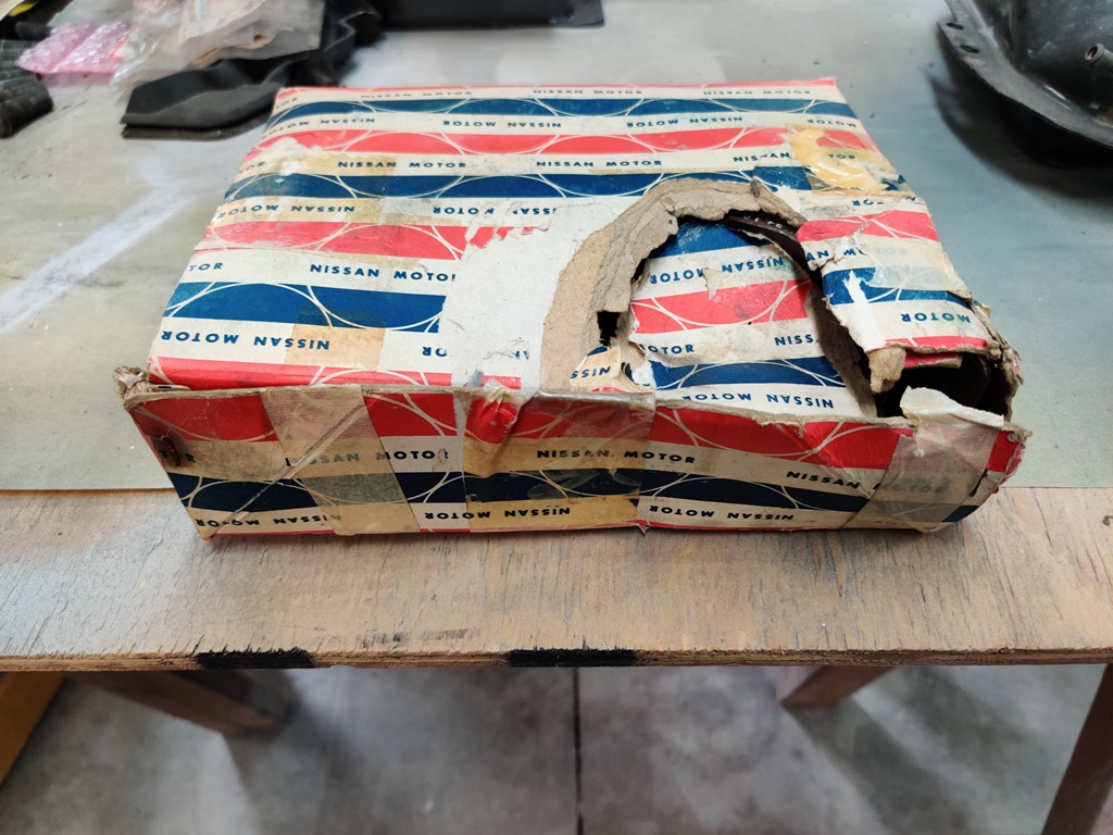

I also found these and snapped them up the other day.  I have original brake pads for the front, so it was nice to find these as well.
My painter told me those headlight housings are a pain in the a**e .. to paint right.. haha. As you have to paint upside down IN them.. (Oh well.. my painter .. he worked at his dads paintshop, and i think he still can't paint very well after many years.. 🙊 ( I did my own first paintjob in a paintboot on my own car ( the first anti rust layer) and only one drip and i immediately knew what i did wrong!)
Your painter did the right thing! As there is a rubber seal between those parts and half a mill distance or so.. if you keep them together you get a mess, separate painting is necessary..
I was told by the head guy at the paint shop that they spray the headlight housings separately because the clear coats will "bridge" the gap between the back of the headlight housing and the front of the fender, where the two parts contact each other.
From examination, my car had been painted twice when I received it, once from the factory and one afterwards, in a gold color.  I can see, from examination of the disassembled parts, that the car was painted at the factory with the headlight housings bolted in place.  The paint surely did "bridge" the gap, to the degree that the number of coats of primer and paint at the factory could.
I believe the concern by the paint shop with this repaint is that much more material is used during their paint application process, and as such, more bridging will occur.  I don't think color coats are an issue, but the clear coats are likely much thicker than the factory paint coats.
Anyway, they are going to do it how they feel is best.  I just hope the paint doesn't "crush" and "move" (like it did in on one or two spots on my other 240z) when they bolt the headlight housings to the fender, as there will be a certain thickness of paint on both the fender front edge and the headlight housing back edge, and these will come into contact and compress when the headlight housings are bolted into place.
Crossing fingers that they are completing the work this week, and that, if it matters in their shop, the weather cooperates on the day they spray the exterior of the body.
Edited by inline6

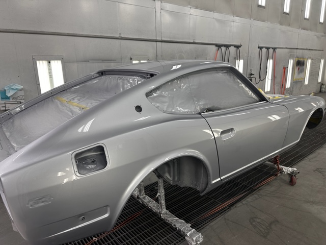

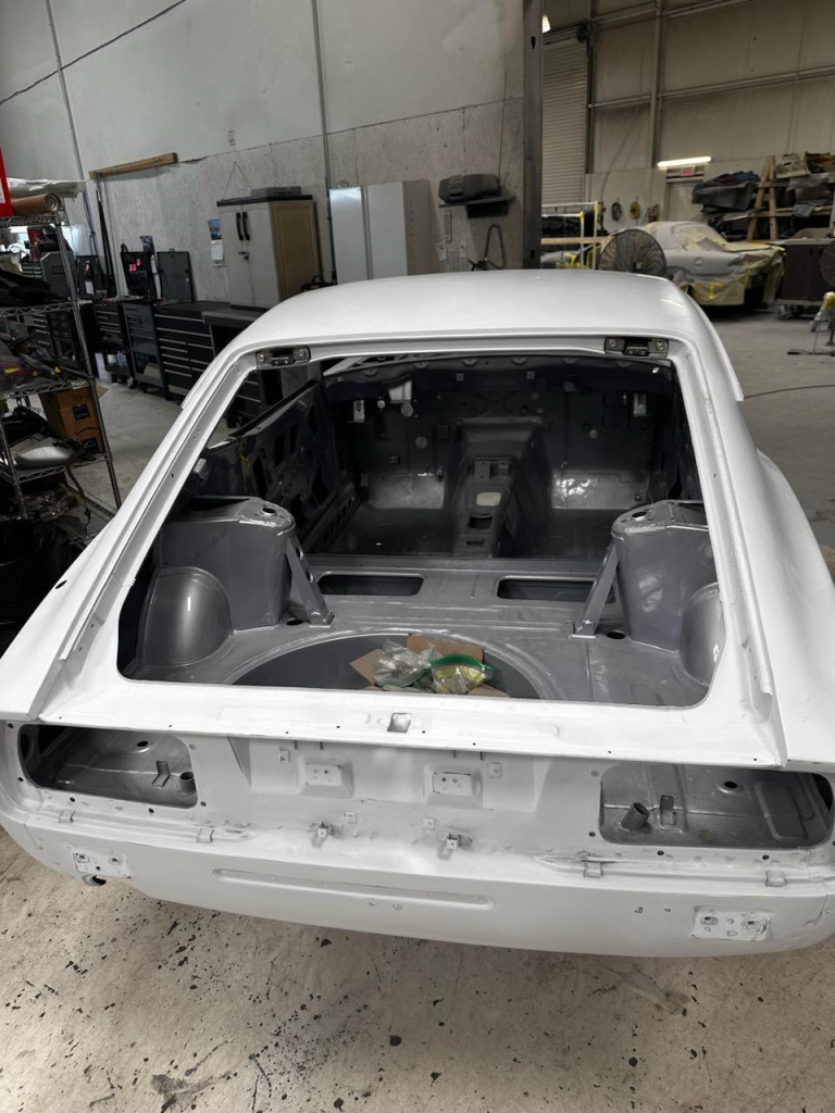

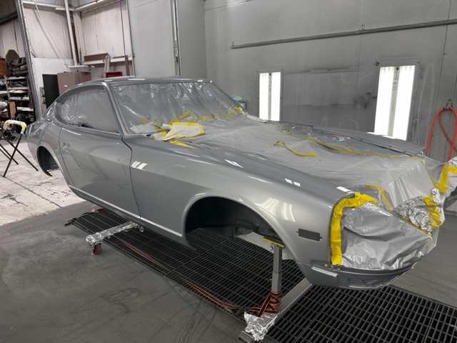

There has been some more progress at the paint shop.
It looks nice from what I can see in these pictures.
I see that they did as I requested with regard to painting the car without taping off the wheel wells and presumably, the underside of the floor also.  My intent was to attempt to replicate the paint done at the factory originally.  Those areas of the car received overspray as the primary body surfaces were painted.
They departed from my instructions by painting the inside of the car and the outside of the car at different times, and by removing the hood, cowl panel, headlight housings, and fuel door.  Those, I assume were sprayed separately (or will be) along with the rear hatch panel.
It will be interesting to see the body in person.  I am curious to see if the surfaces "moved" due to shrinkage of filler/primer over the last 6 months.  Hopefully, it is straighter than when I gave it to them, as they certainly went over it as part of the work done.  I have seen over and over how painted fresh from the shop, panels are super straight, and then months later, they aren't due to shrinkage.  This car has had considerable amounts of time sitting, so hopefully there will not be additional shrinkage post paint having been applied.
I am looking forward to getting it back and starting the assembly process!

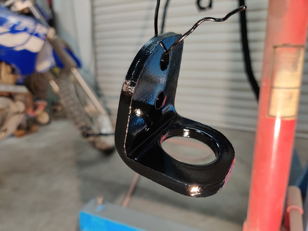

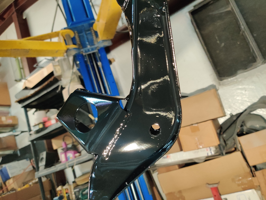

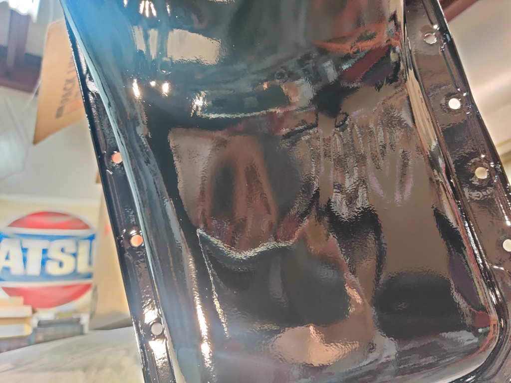

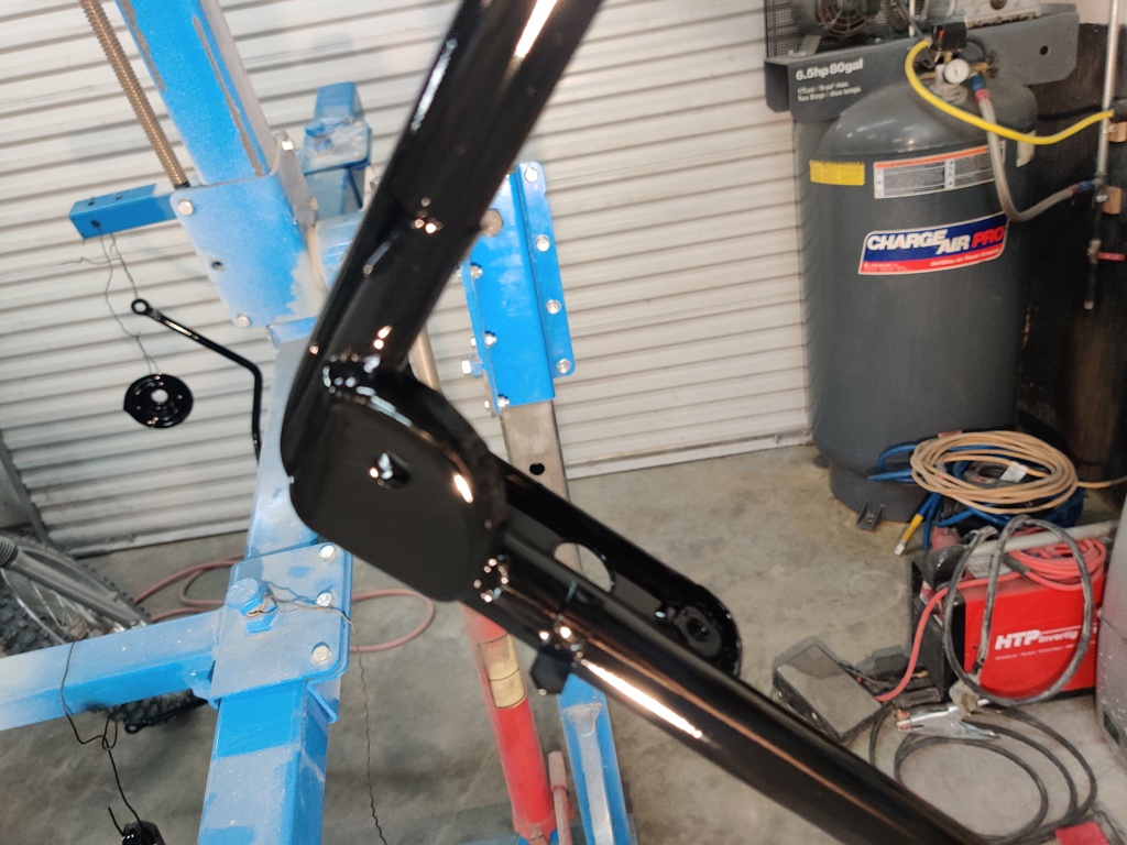

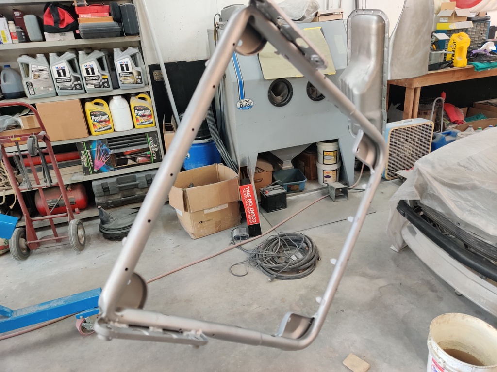

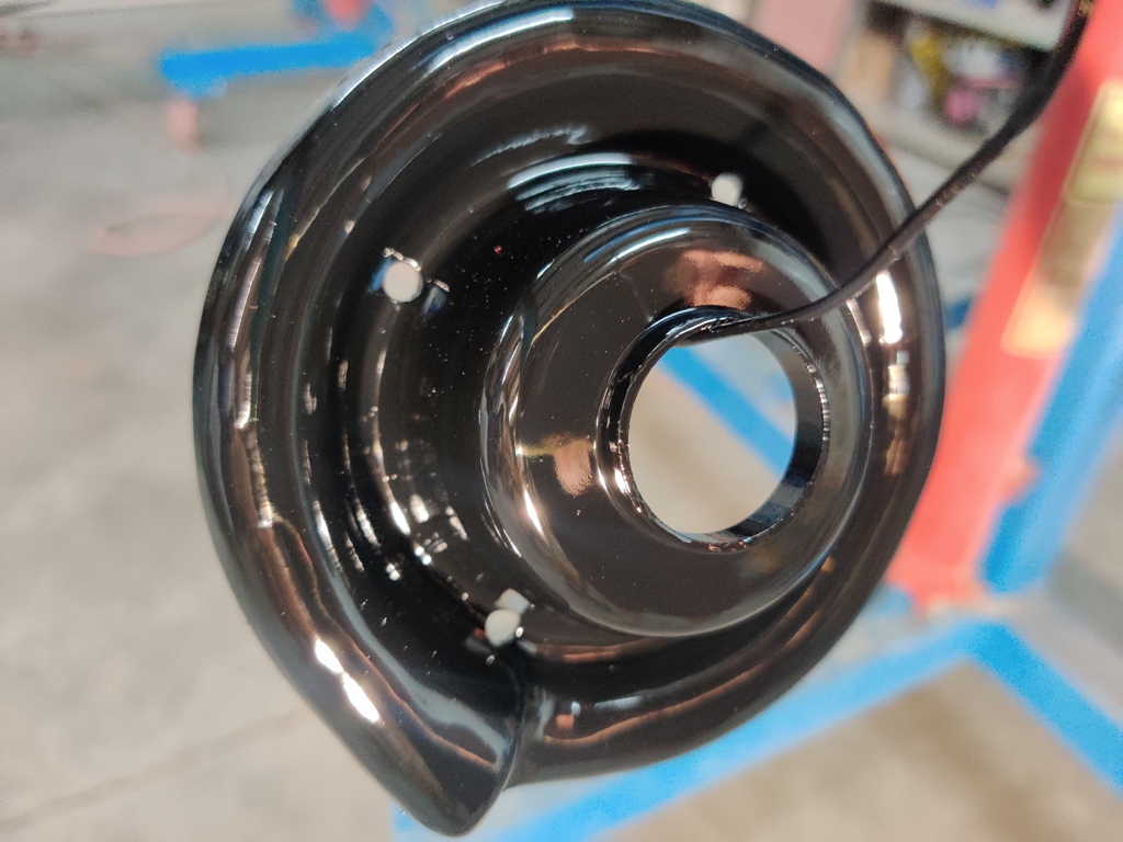

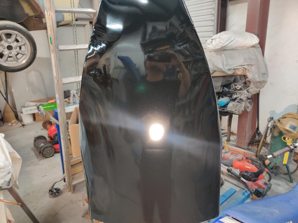

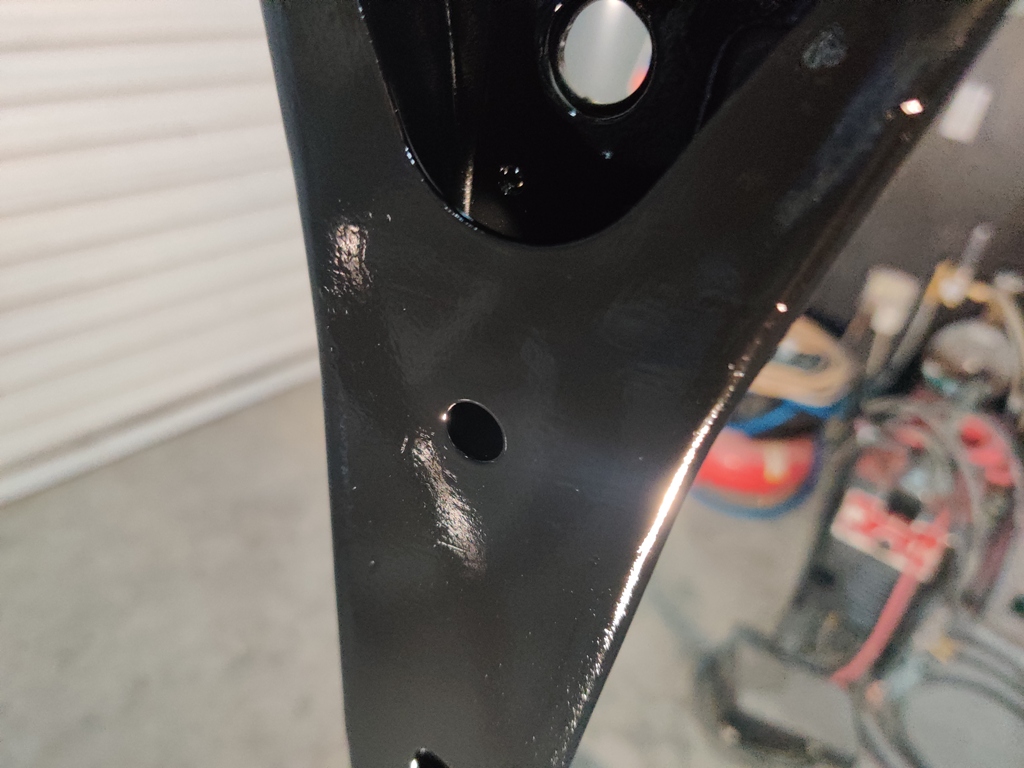

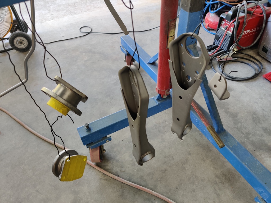

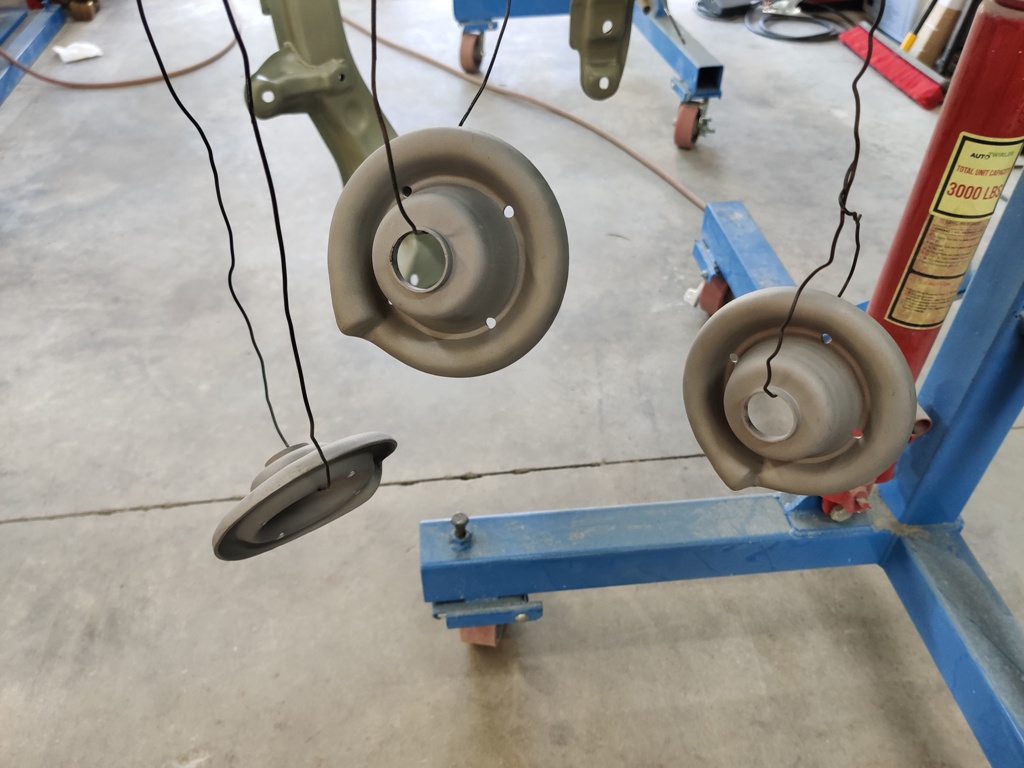

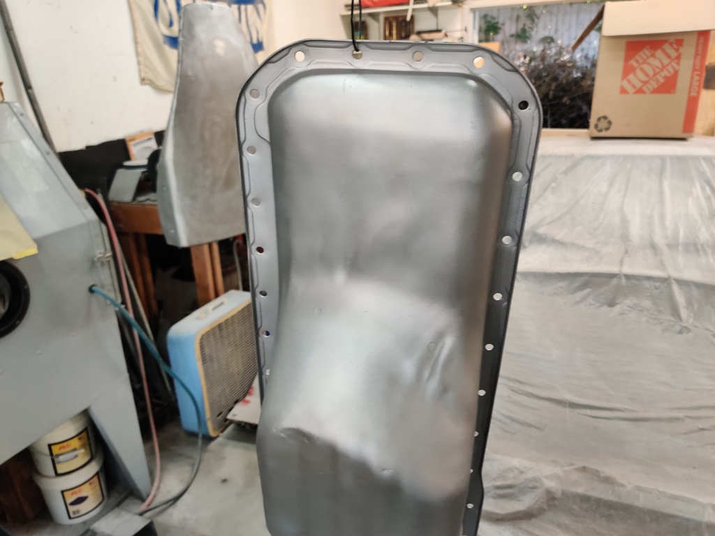

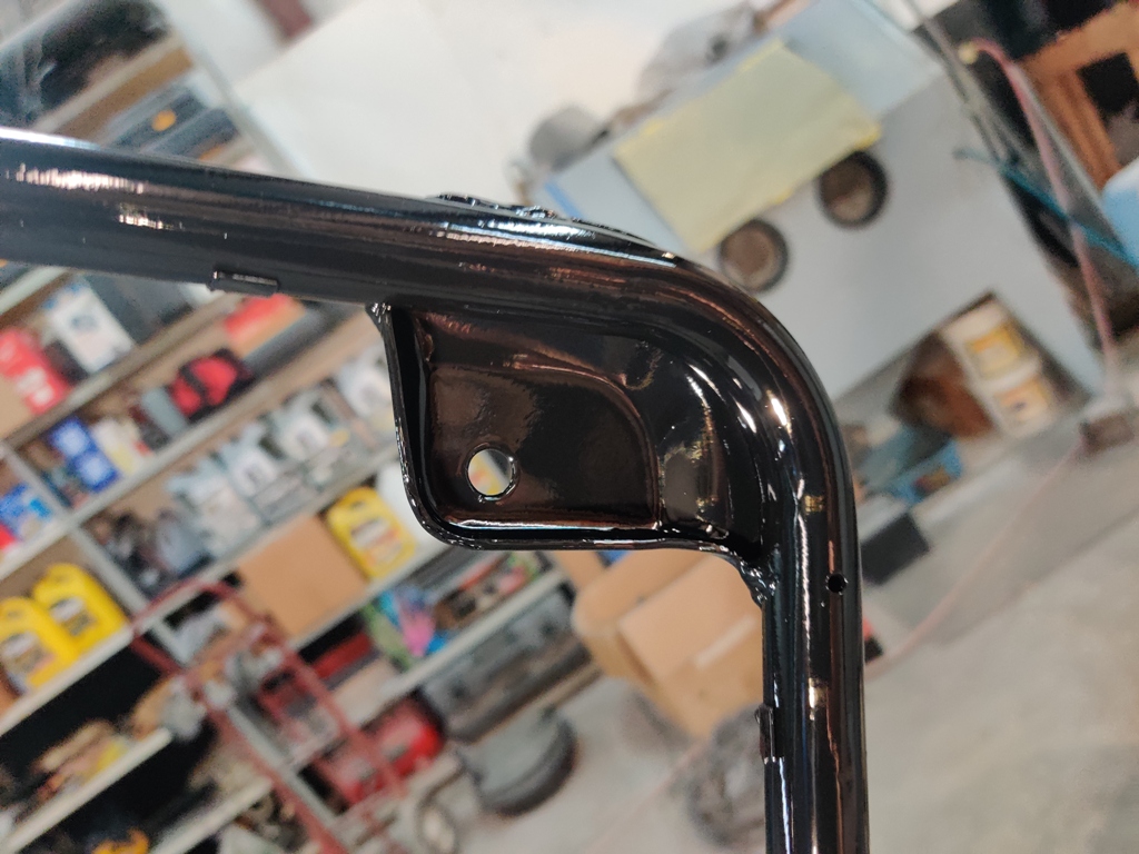

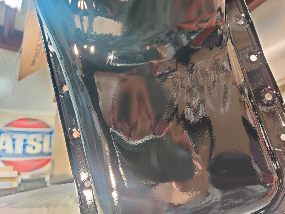

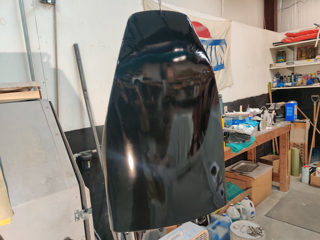

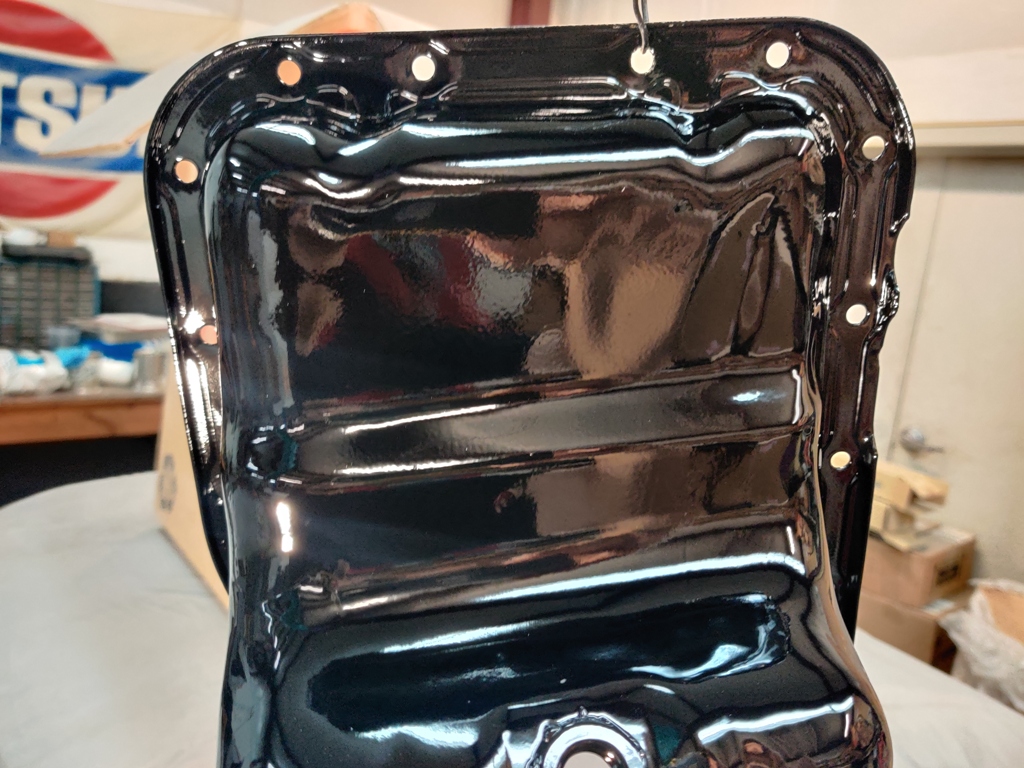

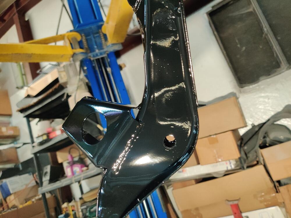

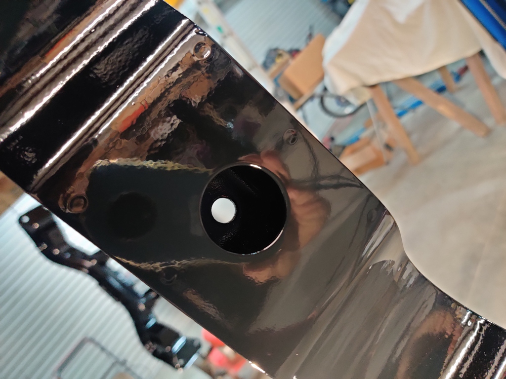

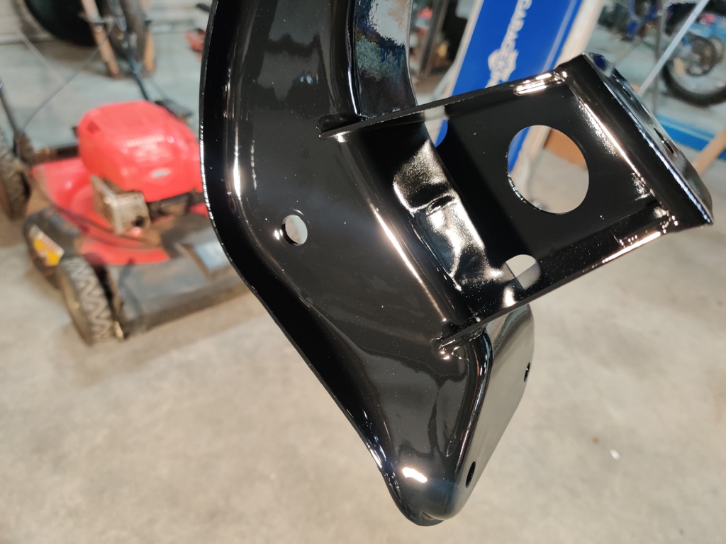

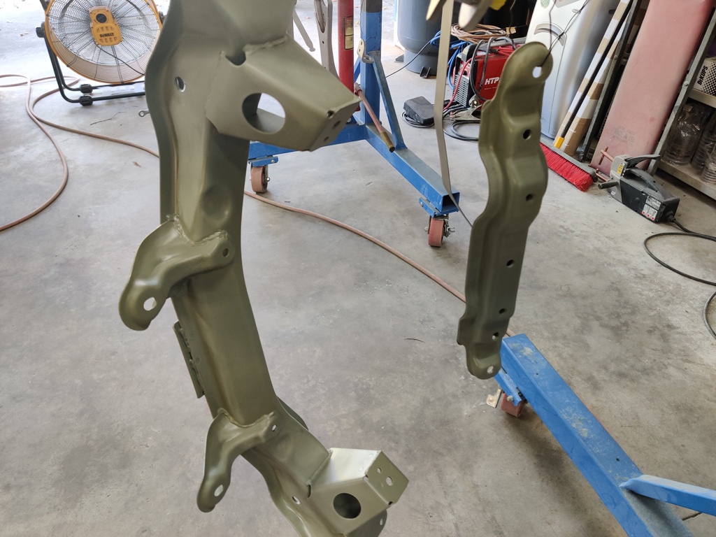

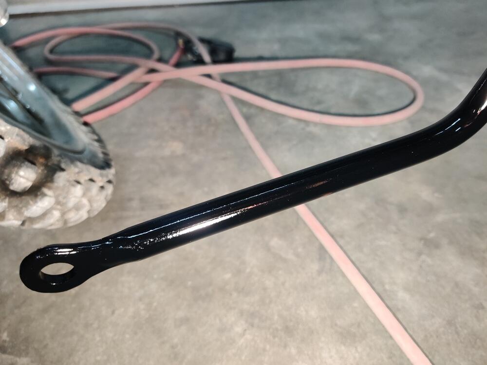

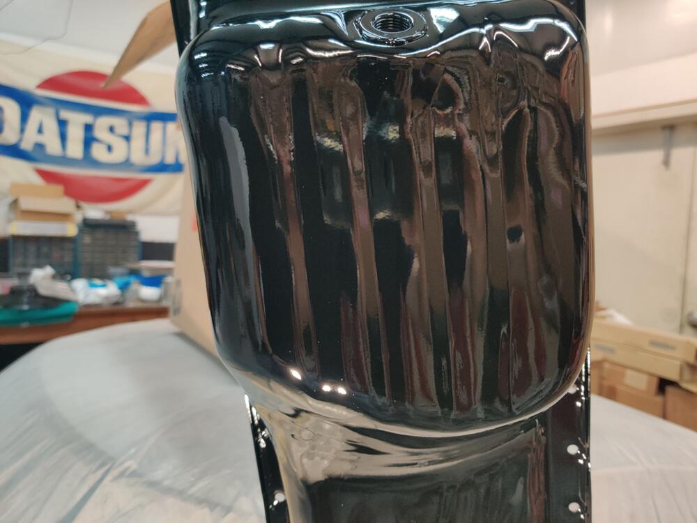

Over the past weekend, I got through another batch of parts that are black:  All of these parts were coal slag blasted, glass bead blasted, epoxy primed and painted black.
I only have a few parts left that need to receive fresh black paint.  I will try to get that accomplished before the car chassis is back from the paint shop.
Edited by inline6
I am using Nason products for the black paint.  The paint supply place picked the paint code, some Hyundai non-metallic.  I can see about getting the code if you would like to have it.  I mix that with hardener and thinner and apply using a Devilbiss HVLP gun.
