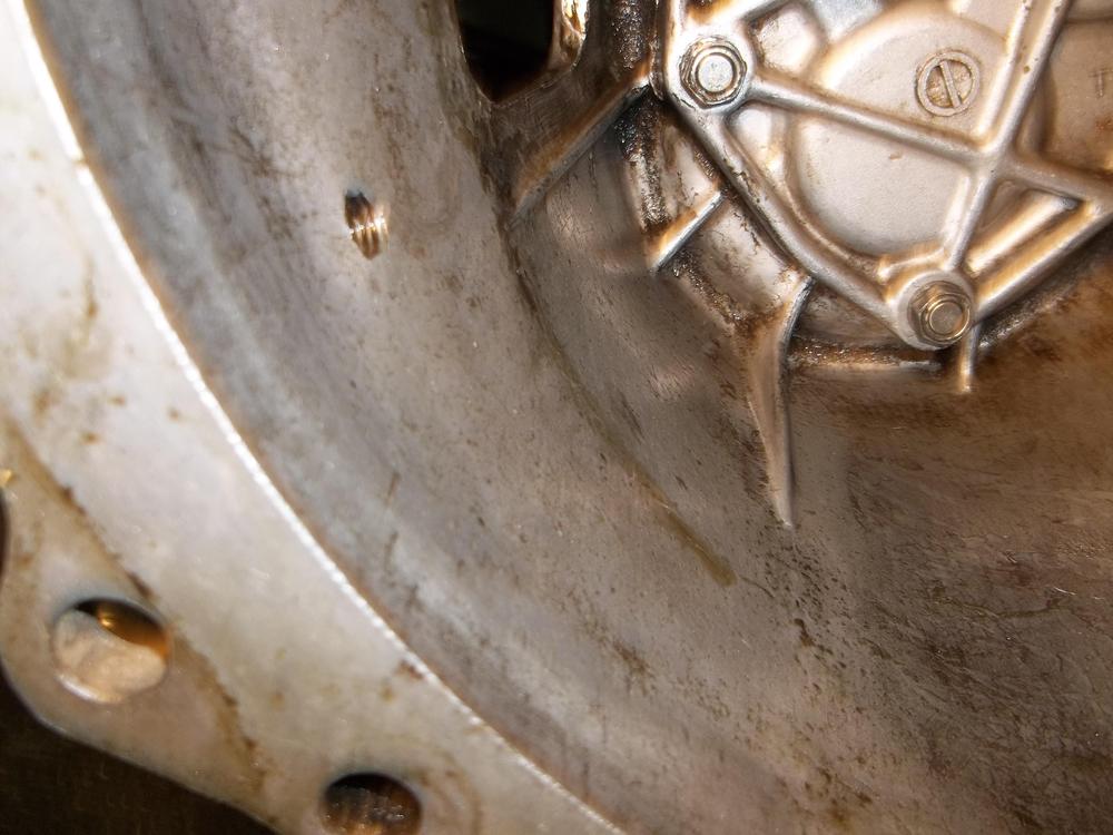

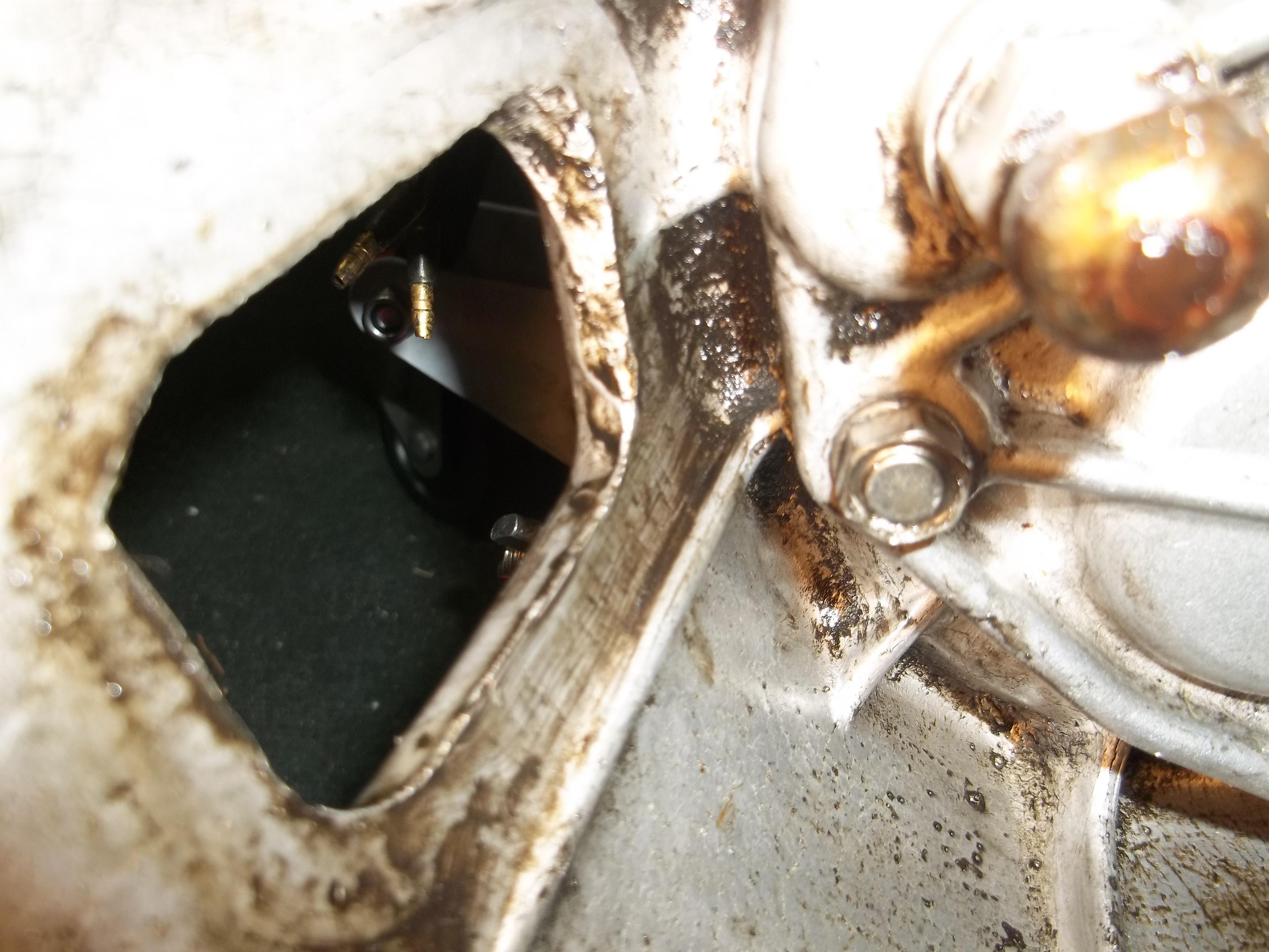

I thought I had a transmission leak at the reverse light switch, but I fear its the front cover plate area. I get oil right at the weep hole of the plate between the trans and engine, the oil looks clean like transmission oil, there is oil (a fair amount) coming from the clutch fork boot. there is oil right at the engine to trans bolt area on the passenger side only, looks like its damp with oil but above the oil pan gasket (right below the starter), no oil above the starter.
So we are off to pulling the trans and getting a look see what is going on. The good thing is I know it will come apart easy since so just have to plan a few hours to get the car up on jacks and have enough room to get the trans jack in there and pull the transmission out. I don't want to do a front plate install under the car.
I imagine the clutch plate could be oil soaked but I have no evidence of slippage. Not sure if I want to pull the pressure plate/flywheel off to inspect the rear main IF I find the smoking gun at the trans front cover. will have to make that call when I get in there. the rear main seal is only about 6-7k old .

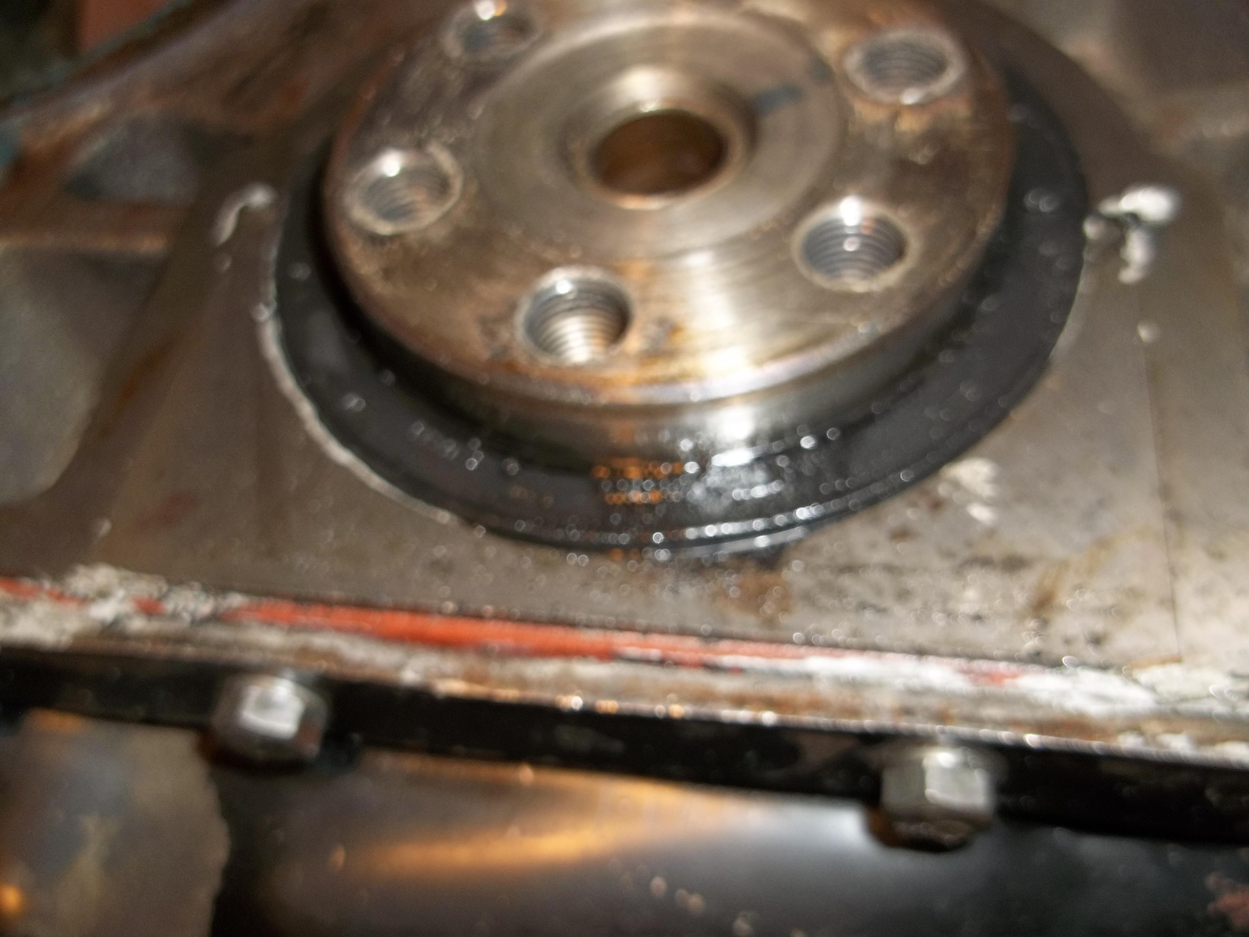

Before I replaced my engine, I replaced the rear main on the original engine. Probably about 1200 miles before I pulled it out of the car. Once on the stand, I noticed it was leaking again.
It was a Fel-pro rear main. I oiled it, and installed it per the FSM. Making sure not to get it too far in. I even went as far as to get 2 seals in case I screwed one up.
Nevertheless, it was leaking. But it wasn't visible unless the flywheel and dust plate were out of the way.
Sent from my Coolpad 3310A using Tapatalk
if its the rear main I will go with a Nissan seal. Mine is a felpro as well, I goofed the Nissan I had during the 1st try at the install. Like you I lubed it up think it was vasoline, but cant recall. I did install it dry on the outside (no sealer) if that matters. I also had a rear main side seal leak that I installed new side seals with the FSM directed sealer at the bottom and side of the bearing holder.
I am hoping its just the transmission front seal or paper seal around the cover plate. But I will prob pull the flywheel to check that main seal anyway...

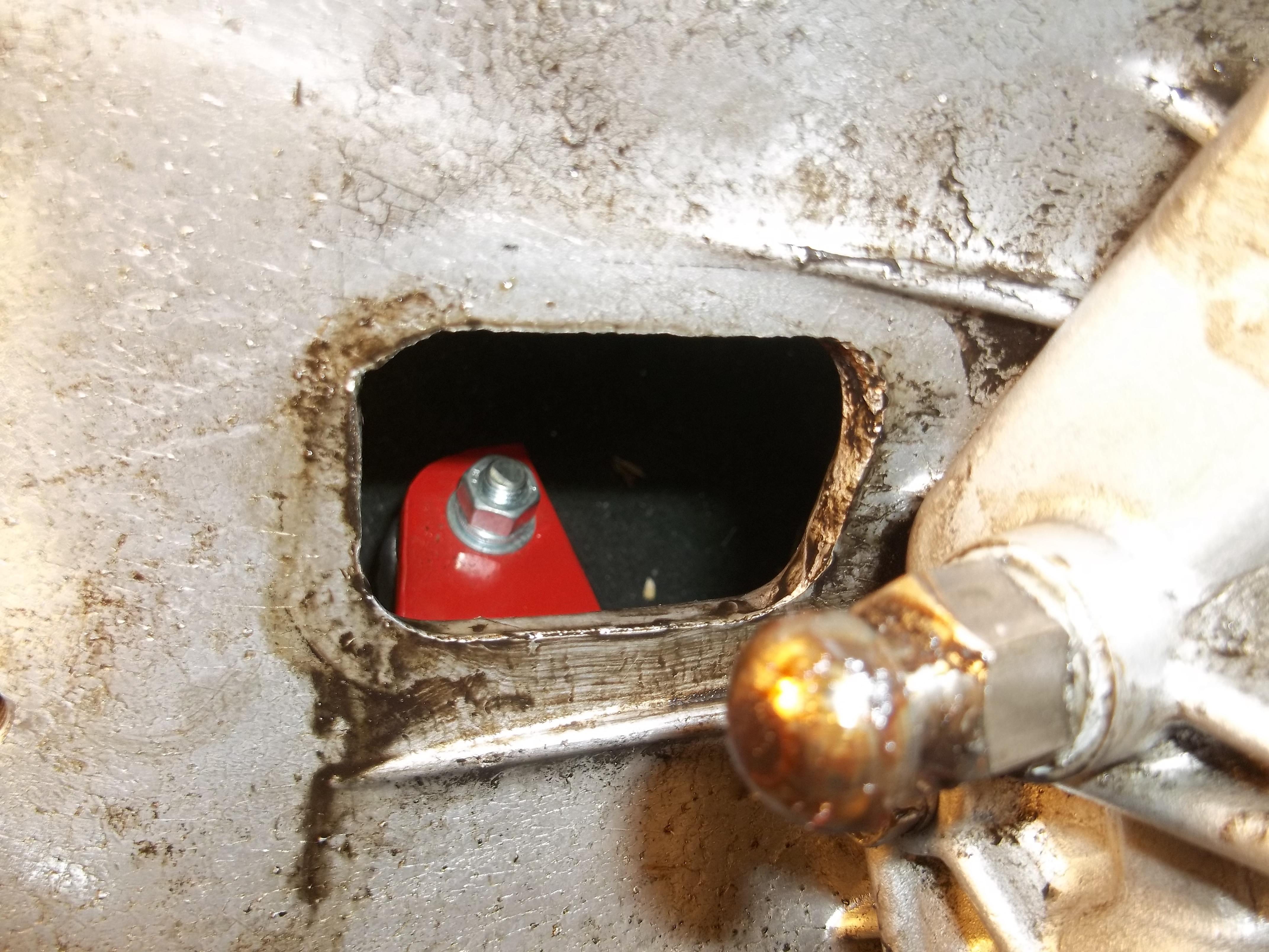

I had one that leaked at the clutch fork pivot ball.  Its hole is a through-hole to the oil-wetted area.  Someone must have removed it and reinstalled it without sealant.  Took me a while to figure out.  Oil leaked down the fork, through the boot.  There's really no way for oil to get on to the fork except from the pivot ball
great info ZH, I may have removed it and not realized it was a thru hole. I certainly don't recall using any sealer there.
I put a good gob of black silicone on it and reinstalled.  I never got it back in the car but I did refill it with fluid and stand it on end to cover the hole with fluid.  It didn't leak.

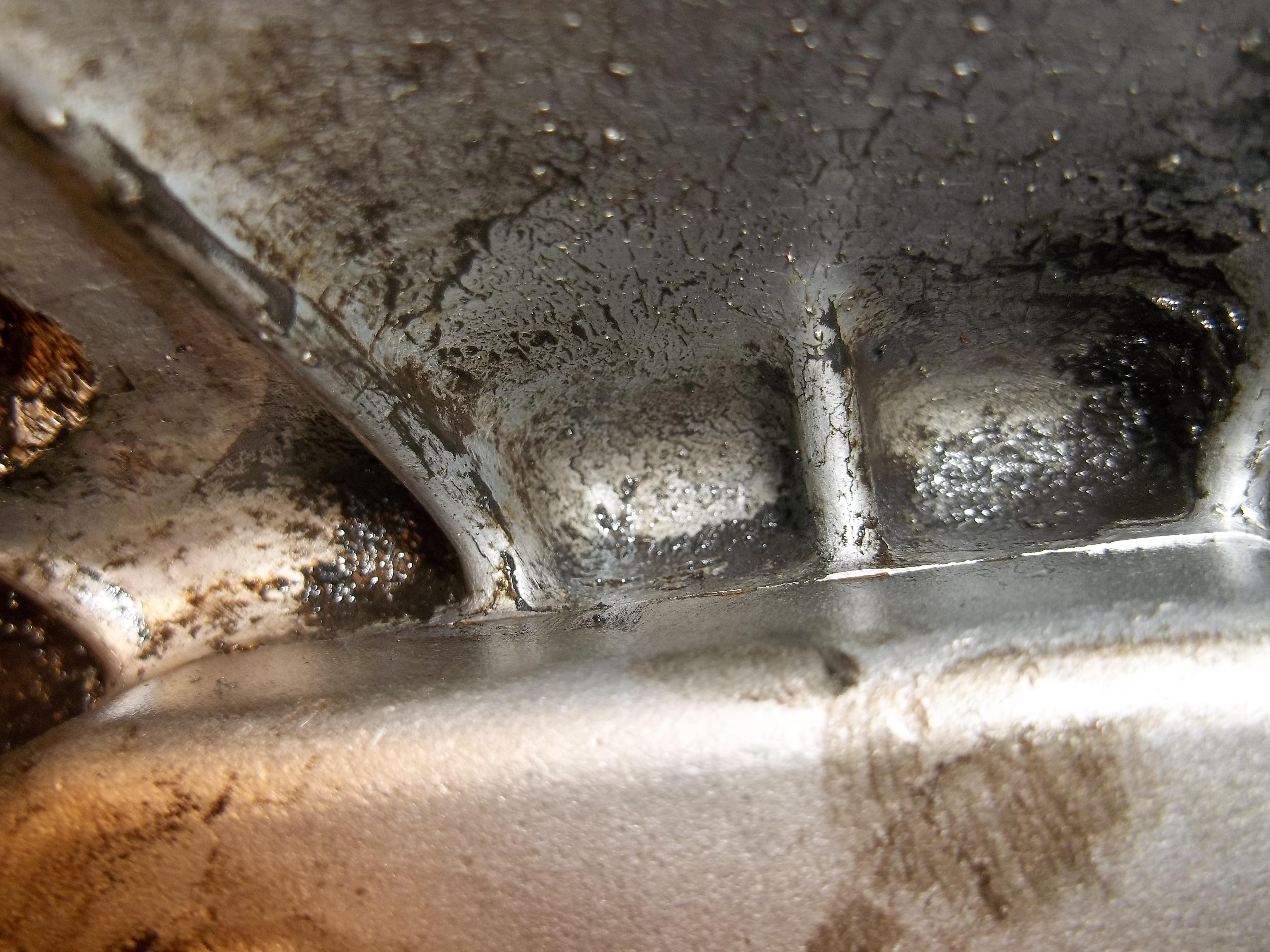

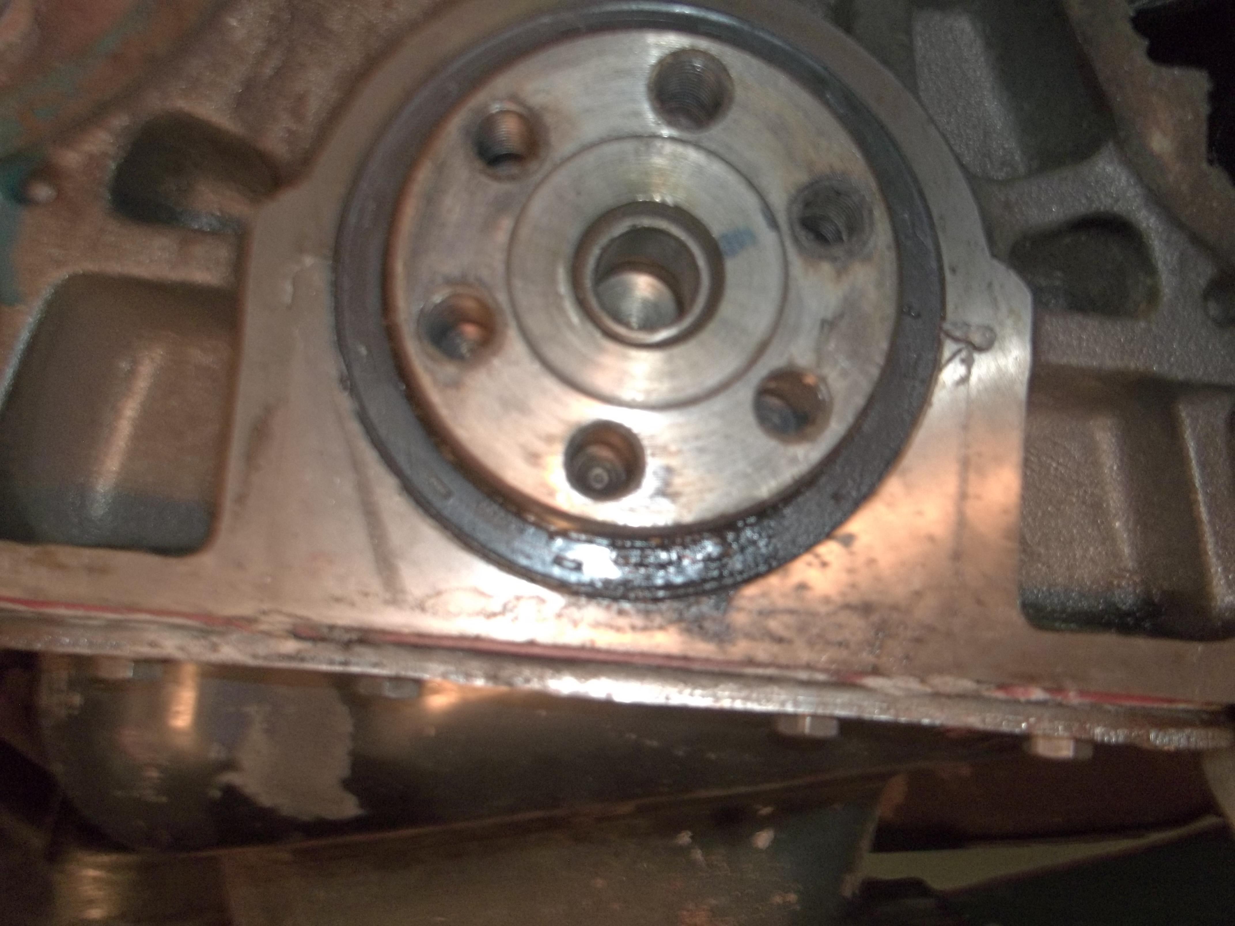

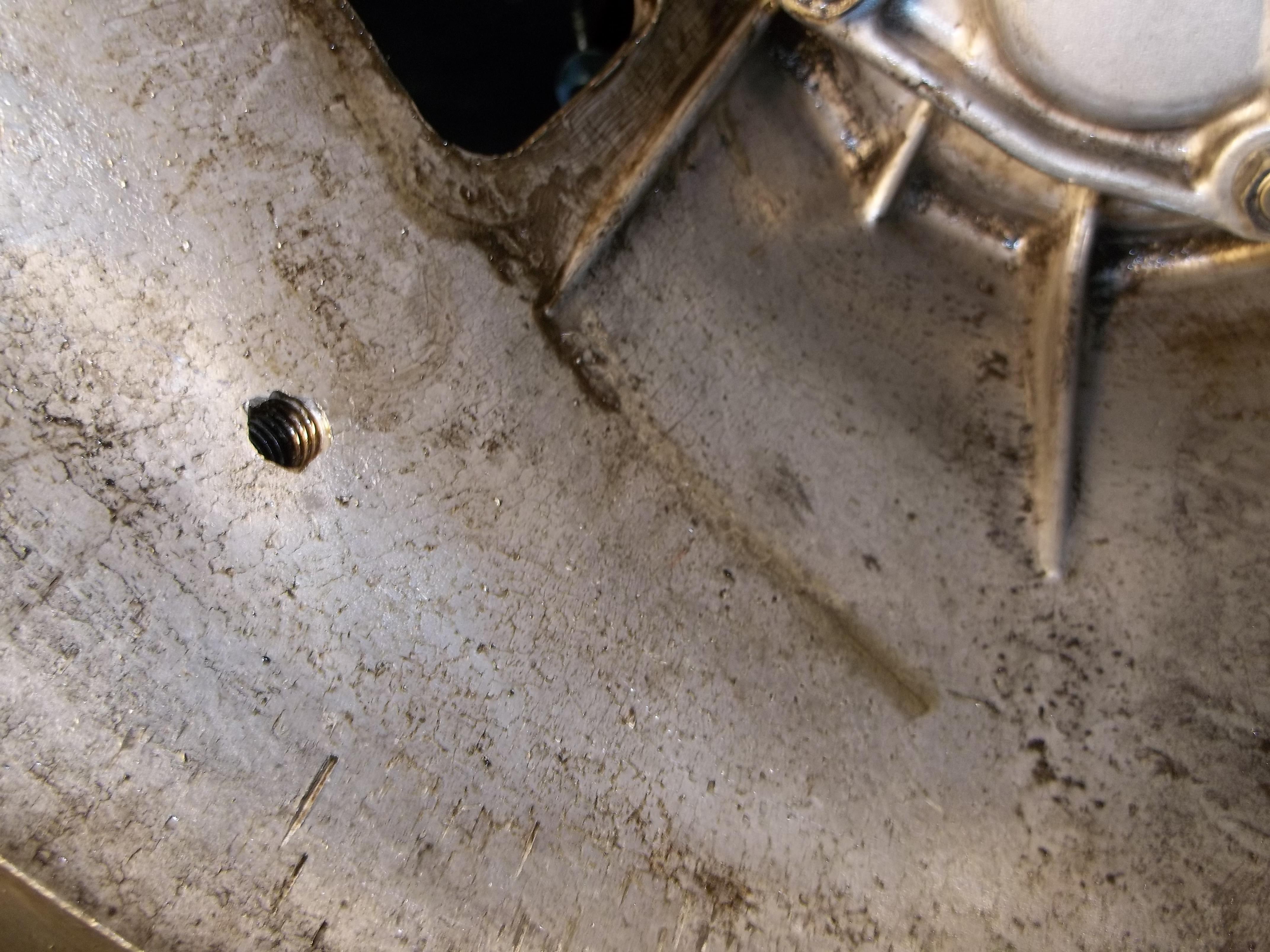

looks like just a little bit from both the trans and the engine. I have a rear main seal leak (side seals look ok) and a kinda all over leak from the trans front cover. Funny I see I did use some sealant on the pivot ball, but it still shows leakage. I will get some decent photos tomorrow when I get better light. Think I will pop for the Nissan rear main this time, and will look very closely for any score marks on the crankshaft. I have a spare trans that I have been wanting to try out, so I think I will do the front cover on it (it shows signs of leakage as well) and the input shaft seal as well. Will take a look at the rear seal and see how it looks. You can clearly see the paper gasket of the front cover is saturated with oil (the tiny bit that sticks out around the sides) I suppose that is normal since it is paper. I will use a VERY thin coat of the gray sealant on the gasket this time, OR maybe the spray on kind would be better (more even coverage).
while I am waiting for the main bearing seal as well as new input and output and gasket for the transmission I decided to make my own gasket using the old as a pattern. I had some oil proof gasket material on hand, same thickness as OE gasket (which came out very clean). I used brake clean to make sure everything was dry, lubed up the ball bearings with some assy lube, greased up the input shaft seal (the old one looked fine, this is the spare untested transmission), made sure the shim was in place with a dab of grease, then used some Permatex anaerobic gasket maker/sealer. It says ok to use as a dressing for a gasket or to make a gasket. Its very viscous I dab some on the front cover and smeared it all around where the gasket will mate, put the gasket on the front cover, then smeared it around the case on the bell housing where the front cover mates to. I was careful not to over apply or get near the bearings, not sure if that would hurt or not, but why chance it. bolted it up, torqued to 15ft lbs in a cross pattern. I stood the trans up on some 2*6's to the input shaft would not get in the way and put about 3/4 of a quart of MT 90 in it. I will check it later to see if there are any leaks. I know this is not a good simulation of how it will be in service but what the heck better than no test at all.

all back together. I made a seal installing driver out of some 1" oak and a 3.25" hold saw, worked great. If you look at the pics of the main seal you can see it not seated perfectly flush on the very bottom. I used a piece of scrap wood and just tapped around the perimeter, this time I wanted it to be more precise and it is.
