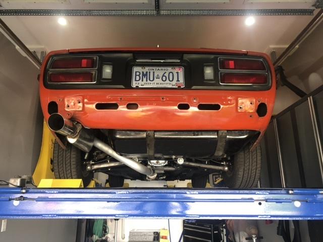

Finally got the rear passenger side bumper shocks removed.  Did what was mentioned above.

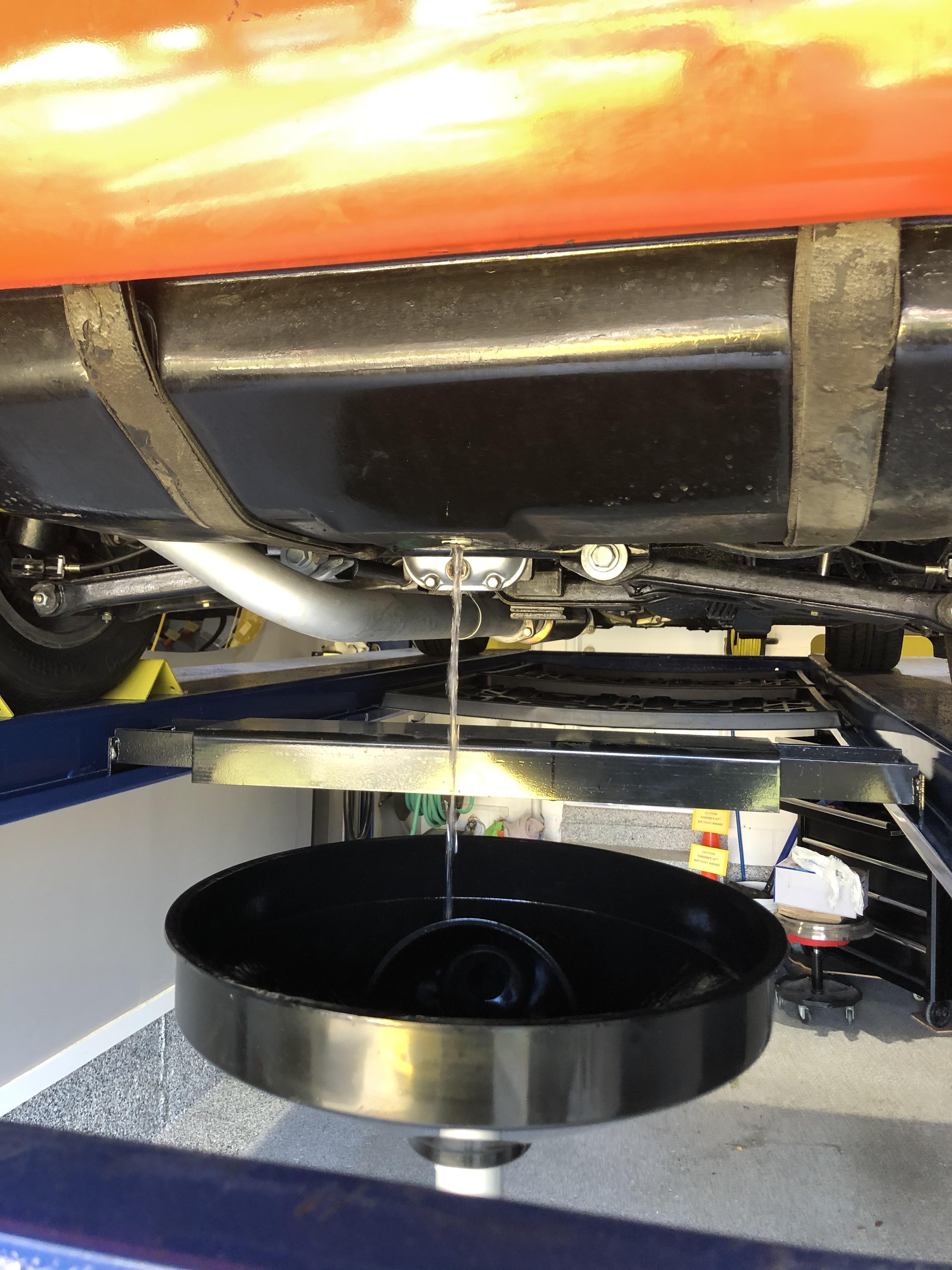

1. Removed the fuel from the tank.

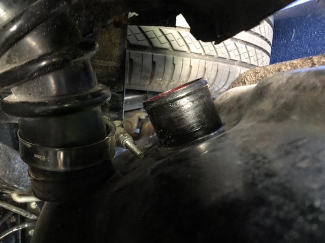

2. Loosened up the clamp in the trunk that connects the filler neck to the rubber hose.  This is need to give some slack to remove the tank.

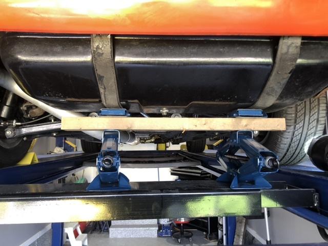

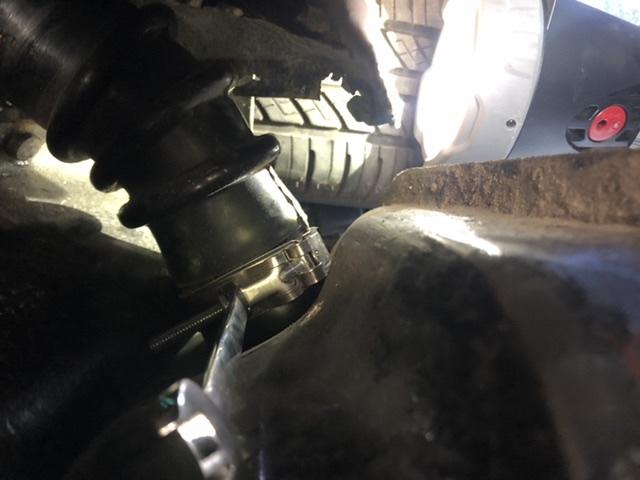

3. I raised the car, then loosened up the tank straps.  This gave me some room to get to the end part of the filler hose that connects to the tank.  Once the hose has been disconnected, then it’s easier to move the tank over to the driver side.
4. Then removed the 3 remaining bolts for the bumbler shocks located above the tank, had to play around to remove the shock.
