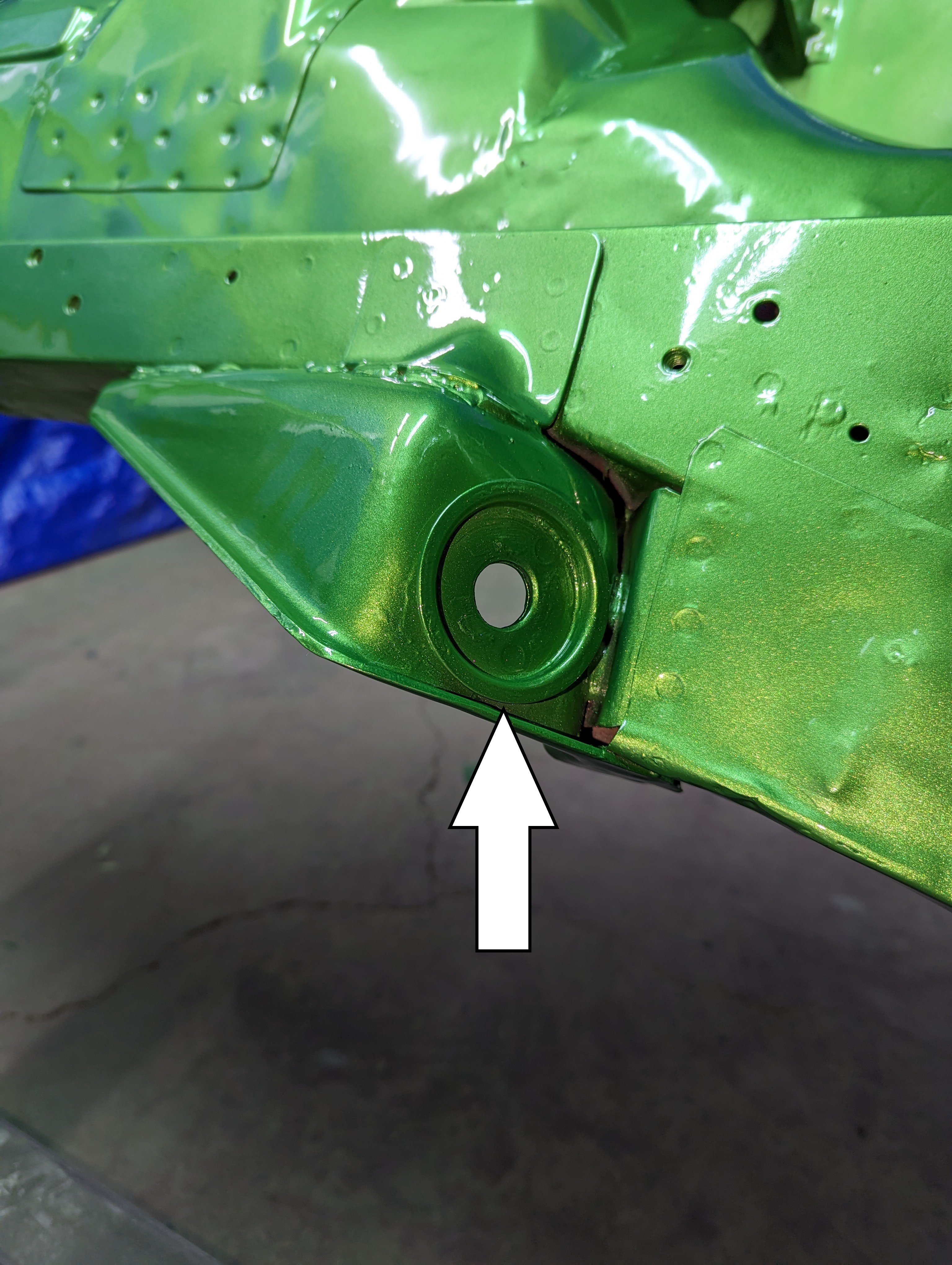

               The knowledge here is amazing! Finding pictures or examples of these cups was very difficult. Once I had gotten all my answers from everyone here, I ended up cutting out a section and welding in a new section with a hole already pre-drilled. I then used the cups I found laying in my garage. The cups had to come off my first generation Camaro (1967-1969) or off my sons 67 Chevelle. They were almost perfect circumferance wise and just required the hole in the center to be drilled out to the proper size. I welded them in place and reassembled. The car has been on the road for a couple of years now. No problems whatsoever. Since the car is a daily driver for my son, I did not want to take a chance of one of those bars snapping, so we went with rubber on both sides. I hope this helps. I will look for more pictures to post.

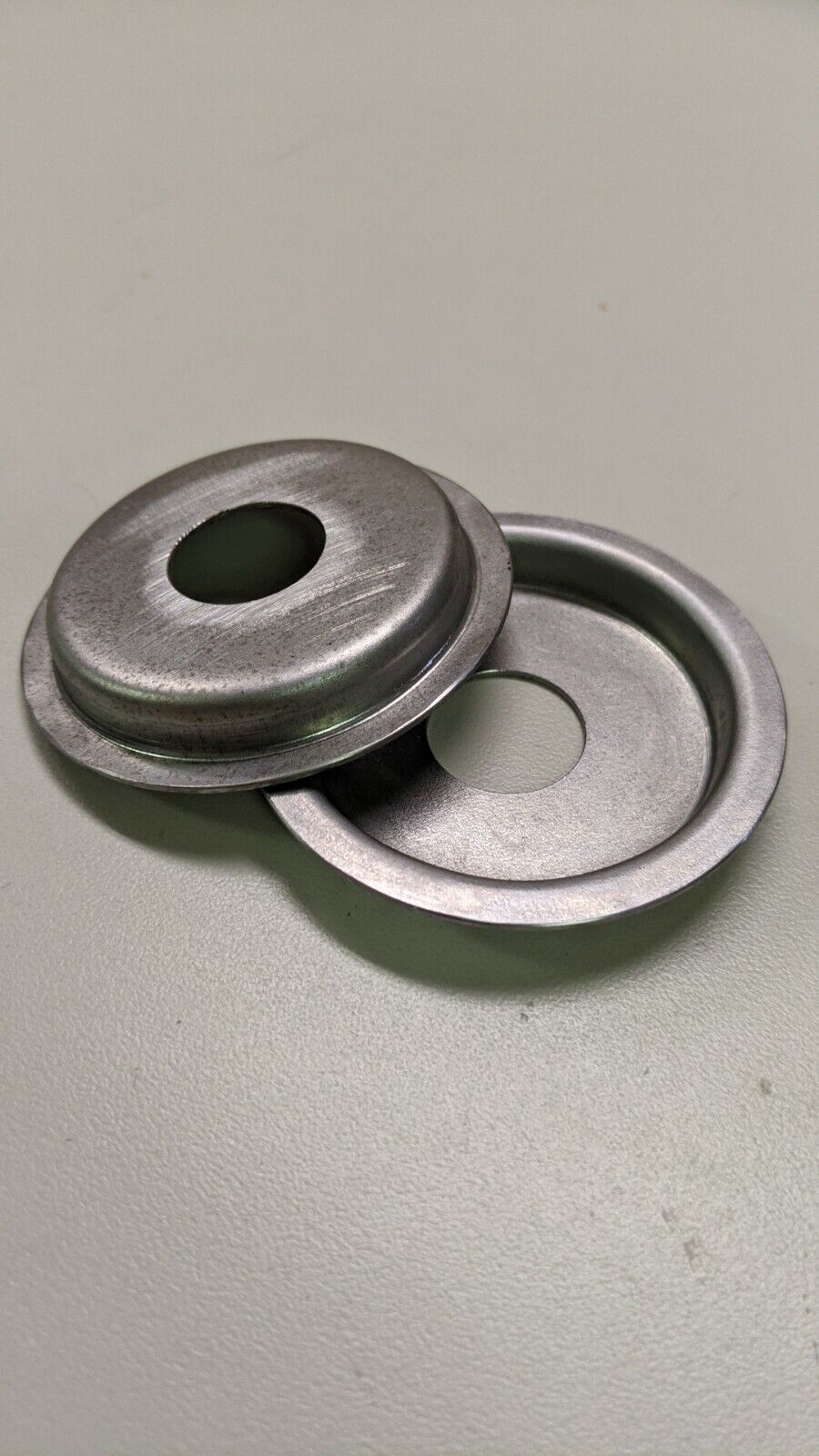

I know this post has been sleeping for a while, but I fabricated some of these bushing seats/ mounts for my own restorations.  I made extra.  If anyone is ever in need, shoot me a message.

18 minutes ago, Linda Todd said:
I need 4 of these. Available?
I used 4 inner fender well cup washers from a 1967 Chevelle for my sons 280z 2+2. They are widely available all over the internet. You will need to make the center hole larger.
https://www.classicindustries.com/product/f14111.html
