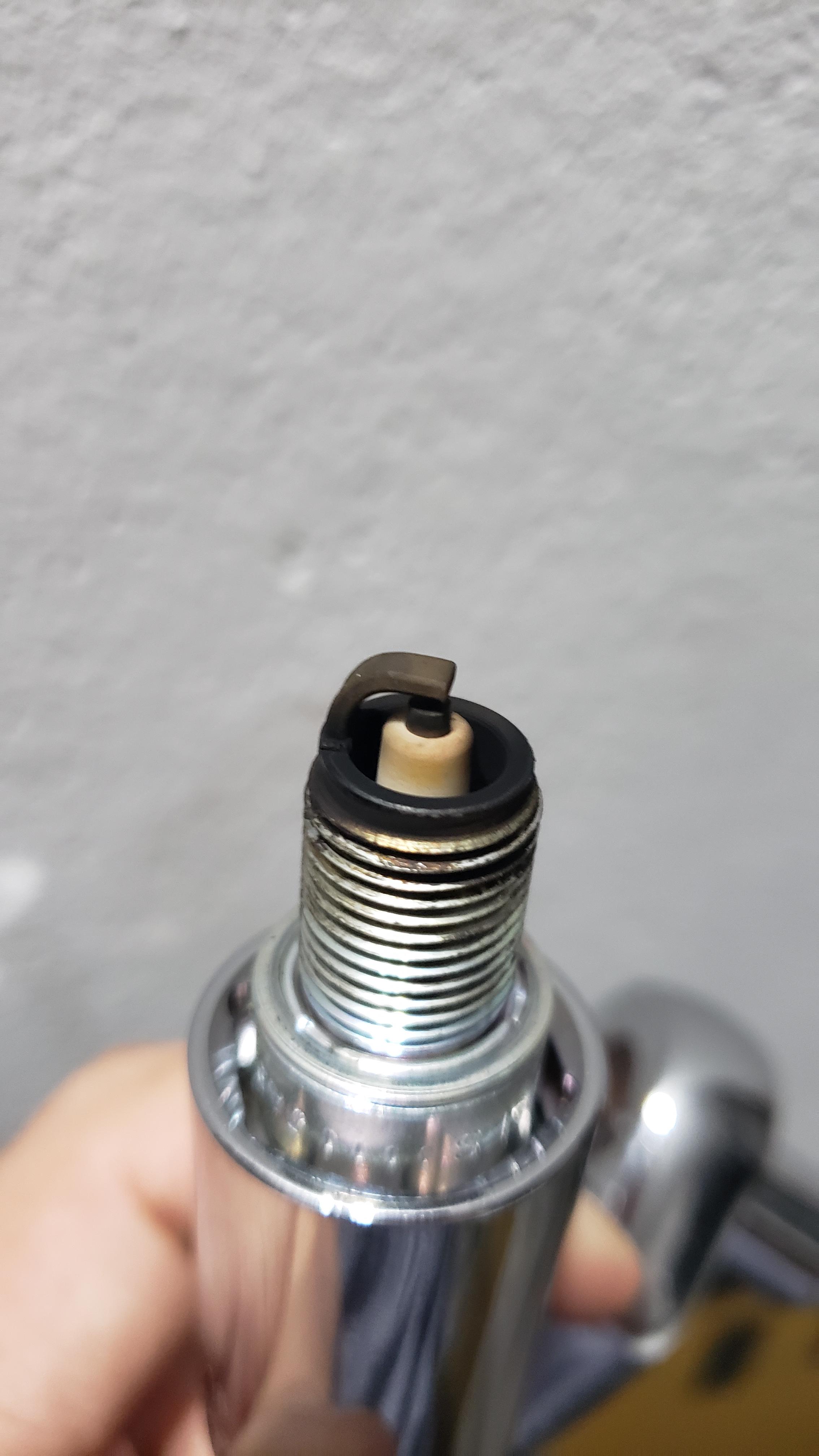

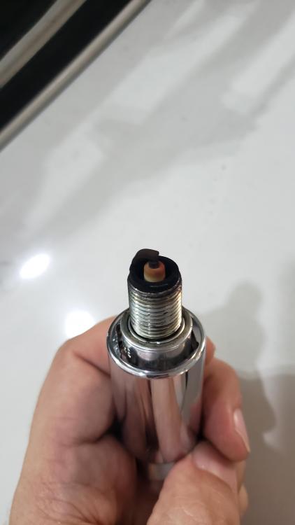

May 9, 20213 yr Author comment_621296 15 hours ago, Johnny280 said: Hi, can you elaborate a little bit why you still want to remove the head to change the valve stem seals? The video I posted (pretty easy to find for everyone) shows exactly what needs to be done. I did it together with my girlfriend and it was pretty easy. You just need a valve spring compressor tool and some rope (and maybe a new valve cover gasket if yours is done). Spark plug number 5 and 4 oily. This is a hotter plug bp5es. Link to comment https://www.classiczcars.com/forums/topic/62317-random-misfire-while-cruising/?&page=11#findComment-621296 Share on other sites More sharing options...
May 9, 20213 yr comment_621300 Are you sure that is not just carbon on this plug? As if running too rich or not having enough spark?Here are two of mine for comparison from the old engine that used to drink 1L of oil every 500 miles. That engine was definitely burning oil. Now see the difference to yours: you can see they are shiny and have solid deposits on them. Yours from the photo, looks matt and dry as if it’s carbon.By all means go take the head off to put your mind at rest but I genuinely think you have another issue here. If you are still convinced it’s the seals then do what has been suggested first - namely replace the seals WITHOUT removing the head. Link to comment https://www.classiczcars.com/forums/topic/62317-random-misfire-while-cruising/?&page=11#findComment-621300 Share on other sites More sharing options...
May 9, 20213 yr Author comment_621301 3 hours ago, AK260 said: Are you sure that is not just carbon on this plug? As of running too rich or not having enough spark? Here are two of mine for comparison from the old engine that used to drink 1L of oil every 500 miles. That engine was definitely burning oil. Now see the difference to yours: you can see they are shiny and have solid deposits on them. Yours from the photo, looks matt and dry as if it’s carbon. By all means go take the head off to put your mind at rest but I genuinely think you have another issue here. If you are still convinced it’s the seals then do what has been suggested first - namely replace the seals WITHOUT removing the head. Would you recommend a final test drive and take the plugs out after leaving the car idling for more than 20 mins? Link to comment https://www.classiczcars.com/forums/topic/62317-random-misfire-while-cruising/?&page=11#findComment-621301 Share on other sites More sharing options...

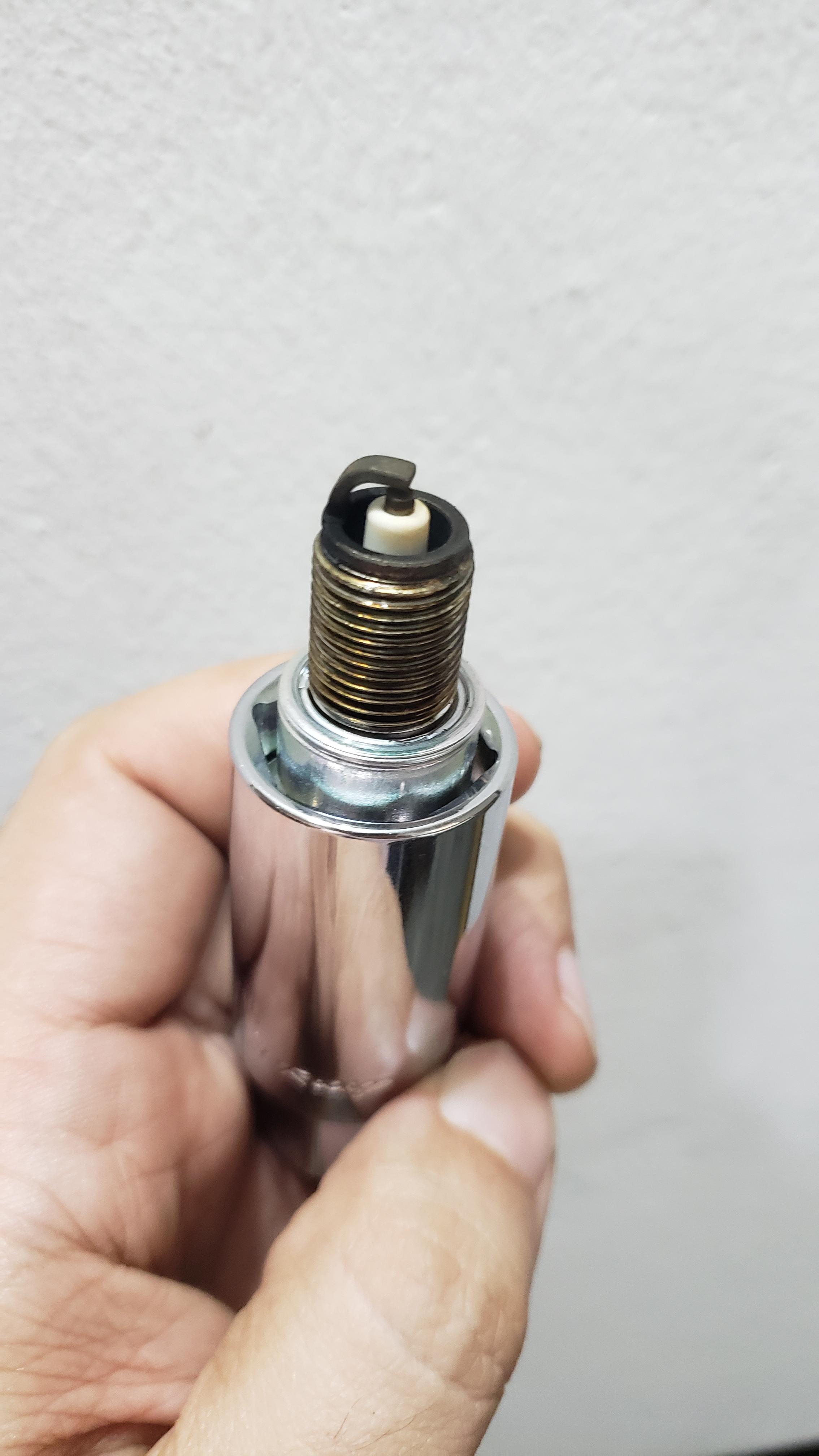

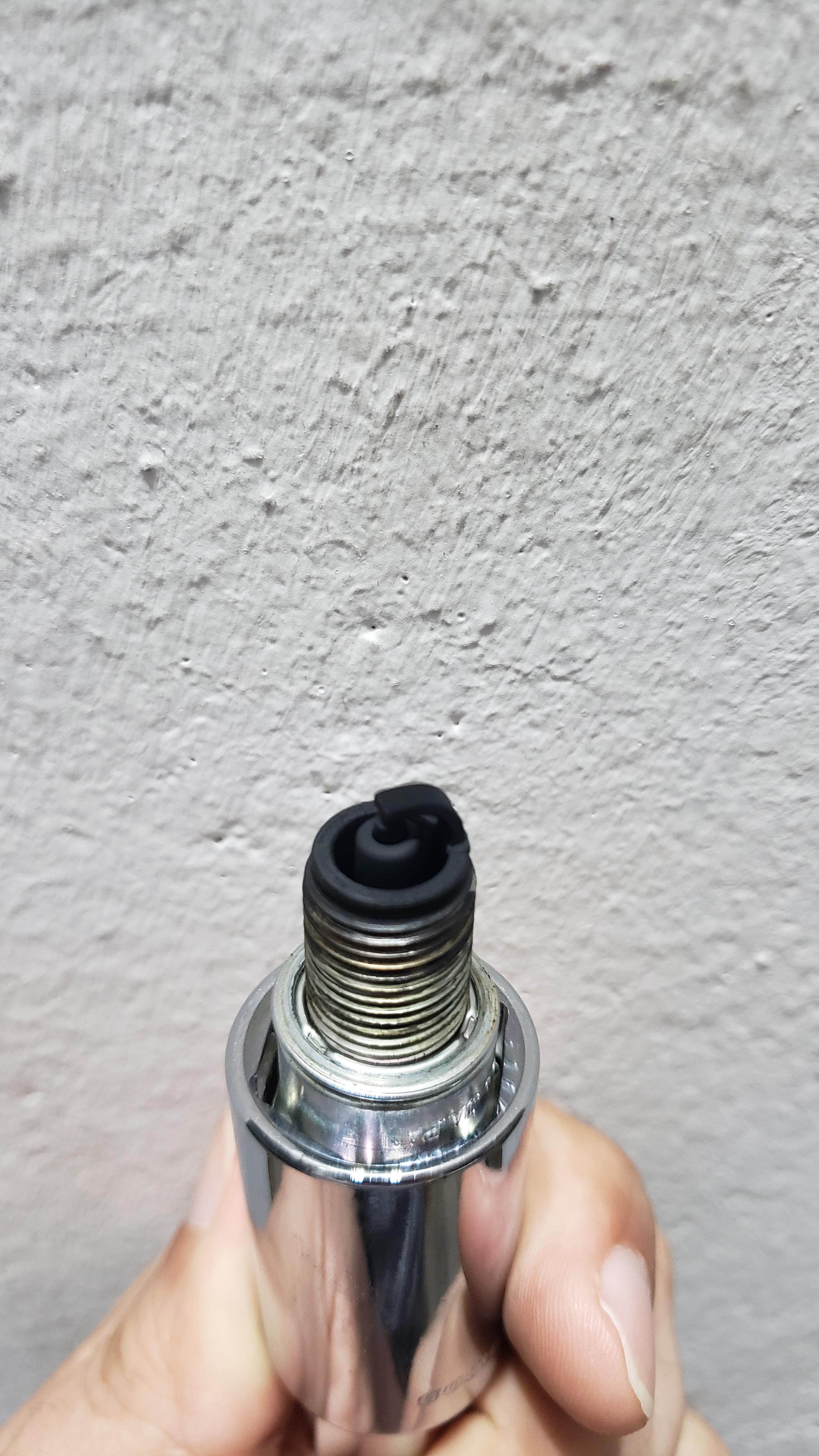

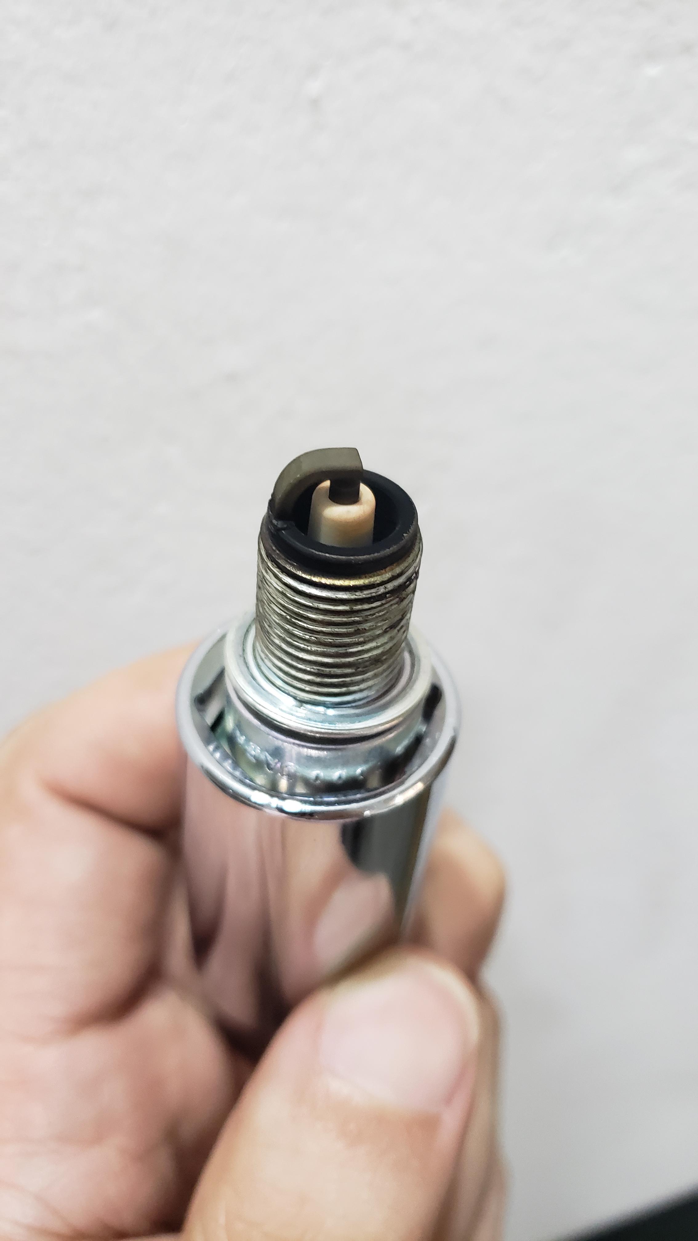

May 9, 20213 yr Author comment_621333 Hard accelerating for 40 mins on highway, parked the car and have the following resultd cyl 4 ,5 and 6. Spark plug on cyl 4 shows a lot of difference. Link to comment https://www.classiczcars.com/forums/topic/62317-random-misfire-while-cruising/?&page=11#findComment-621333 Share on other sites More sharing options...
May 10, 20213 yr comment_621345 I’m assuming your other plugs are from the same bank of three - so it seems to me that no.4 is not getting enough spark / electrical energy.Is it safe to assume they are all gapped the same? Link to comment https://www.classiczcars.com/forums/topic/62317-random-misfire-while-cruising/?&page=11#findComment-621345 Share on other sites More sharing options...
