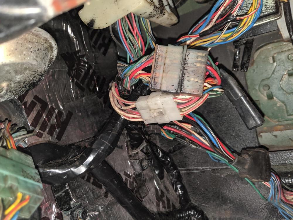

July 29, 20196 yr comment_580781 The tach resistor is clearly pictured in Post #17, first picture of this thread... >>> https://www.classiczcars.com/forums/topic/62552-78-280z-turns-off-with-turn-signalreverse-lights/ <<<<< Off center to the right, the *BLACK* rectangular plastic housing shown here is the tach resistor. Thanks to @Usain_Boat for uploading his picture. Edited July 29, 20196 yr by wal280z clarification in bold Link to comment https://www.classiczcars.com/forums/topic/62200-1977-280z-runs-rough-and-no-tach/?&page=2#findComment-580781 Share on other sites More sharing options...
July 29, 20196 yr Author comment_580783 What a great picture! … and thank you! I found the resister! It appears to be in the factory bundle still taped and still connected. Could the resistor be bad? Link to comment https://www.classiczcars.com/forums/topic/62200-1977-280z-runs-rough-and-no-tach/?&page=2#findComment-580783 Share on other sites More sharing options...
July 29, 20196 yr comment_580785 Since you've found it you might as well check its continuity to the coil's negative terminal. You can do that by turning the key on and checking for voltage at the female part of the bullet connection after removing the resistor. It's more likely that you just have a bad tach though. Link to comment https://www.classiczcars.com/forums/topic/62200-1977-280z-runs-rough-and-no-tach/?&page=2#findComment-580785 Share on other sites More sharing options...
