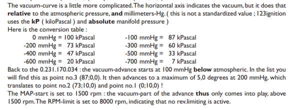

 In addition to the ignition curve, I can edit the MAP curve as well.  Trying to figure out how to get this thing to retard the timing when I put my foot in it at low rpm’s.  Is that possible by using a specific MAP curve, or is that unrelated.
Yes, MAP is what you would change to get timing to retard at low intake vacuum, when you open the throttle at low RPM.  MAP is intake manifold pressure, and centrifugal, or RPM, is engine speed.  Two different curves, typically shown in table form.  They interact.

Here is vacuum advance map for L24 high compression engine:
5.5 degrees in by 245mm HG
