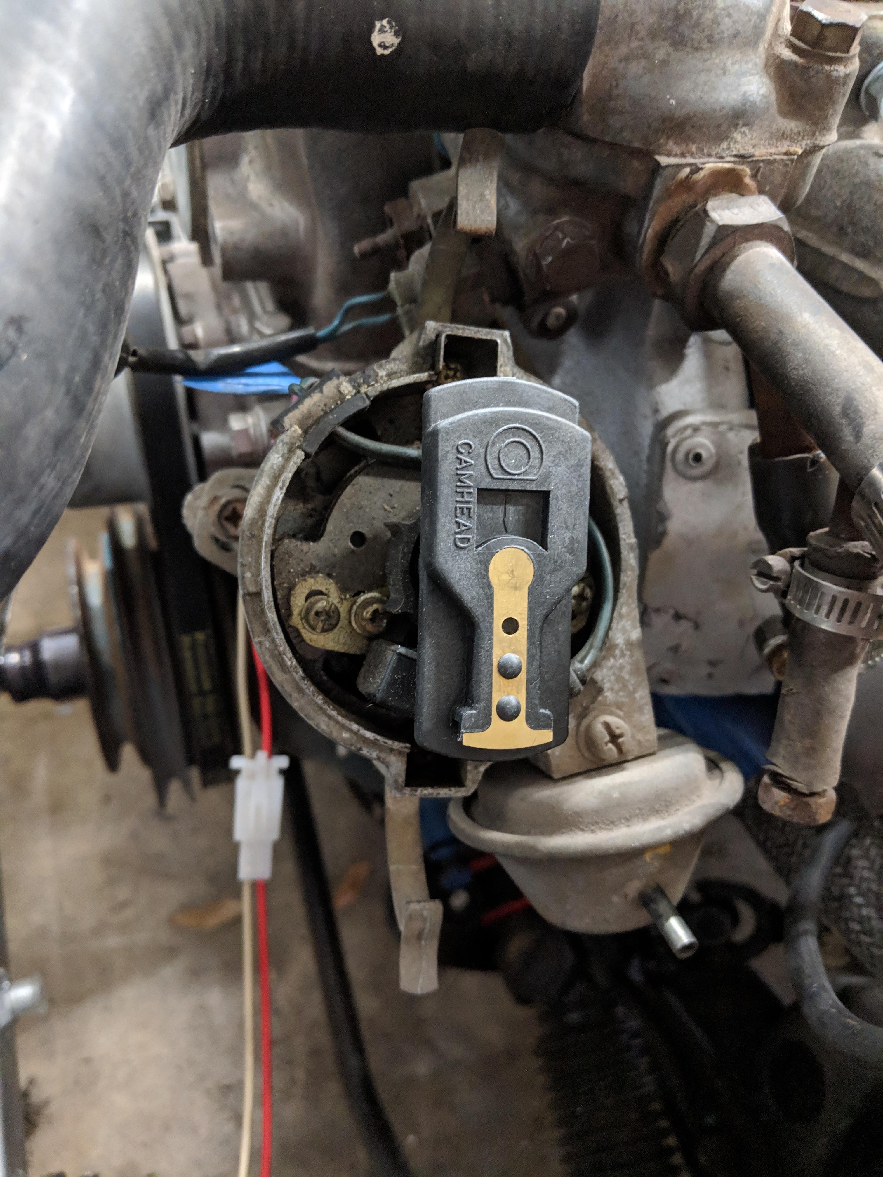

April 5, 20196 yr Author comment_572714 Update, I re-did the valve lashing and now I have compression, about 130 per cylinder (except 6 around 120). Here's what the distributor rotor looks like when I'm at TDC: https://photos.app.goo.gl/EFTUHwfnY15yvpQh8 From what I've seen online, it's slightly too far south and should be a tick more in the CW direction. I'm guessing I need to pull the oil pump and tick it back one notch? Link to comment https://www.classiczcars.com/forums/topic/61948-rebuilt-engine-wont-first-start/?&page=2#findComment-572714 Share on other sites More sharing options...
April 5, 20196 yr comment_572717 Looks like the fat side is 180 off. Link to comment https://www.classiczcars.com/forums/topic/61948-rebuilt-engine-wont-first-start/?&page=2#findComment-572717 Share on other sites More sharing options...
April 5, 20196 yr comment_572718 You could do the wires 180 and see. 153624 would be 426351? Some more informed cats could chime in here, PLEASE??? Link to comment https://www.classiczcars.com/forums/topic/61948-rebuilt-engine-wont-first-start/?&page=2#findComment-572718 Share on other sites More sharing options...

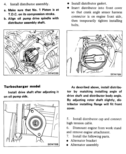

April 6, 20196 yr comment_572720 1 hour ago, CaptainMajestic said: From what I've seen online, it's slightly too far south and should be a tick more in the CW direction. I'm guessing I need to pull the oil pump and tick it back one notch? Actually site might be right. The small half is on the other side. Nissan drew bad pictures for the distributor setup. Here's the setup picture from the FSM. Are you sure that you're on the compression stroke? The timing mark matches twice, once on exhaust and once on compression. Edited April 6, 20196 yr by Zed Head Link to comment https://www.classiczcars.com/forums/topic/61948-rebuilt-engine-wont-first-start/?&page=2#findComment-572720 Share on other sites More sharing options...

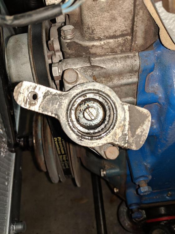

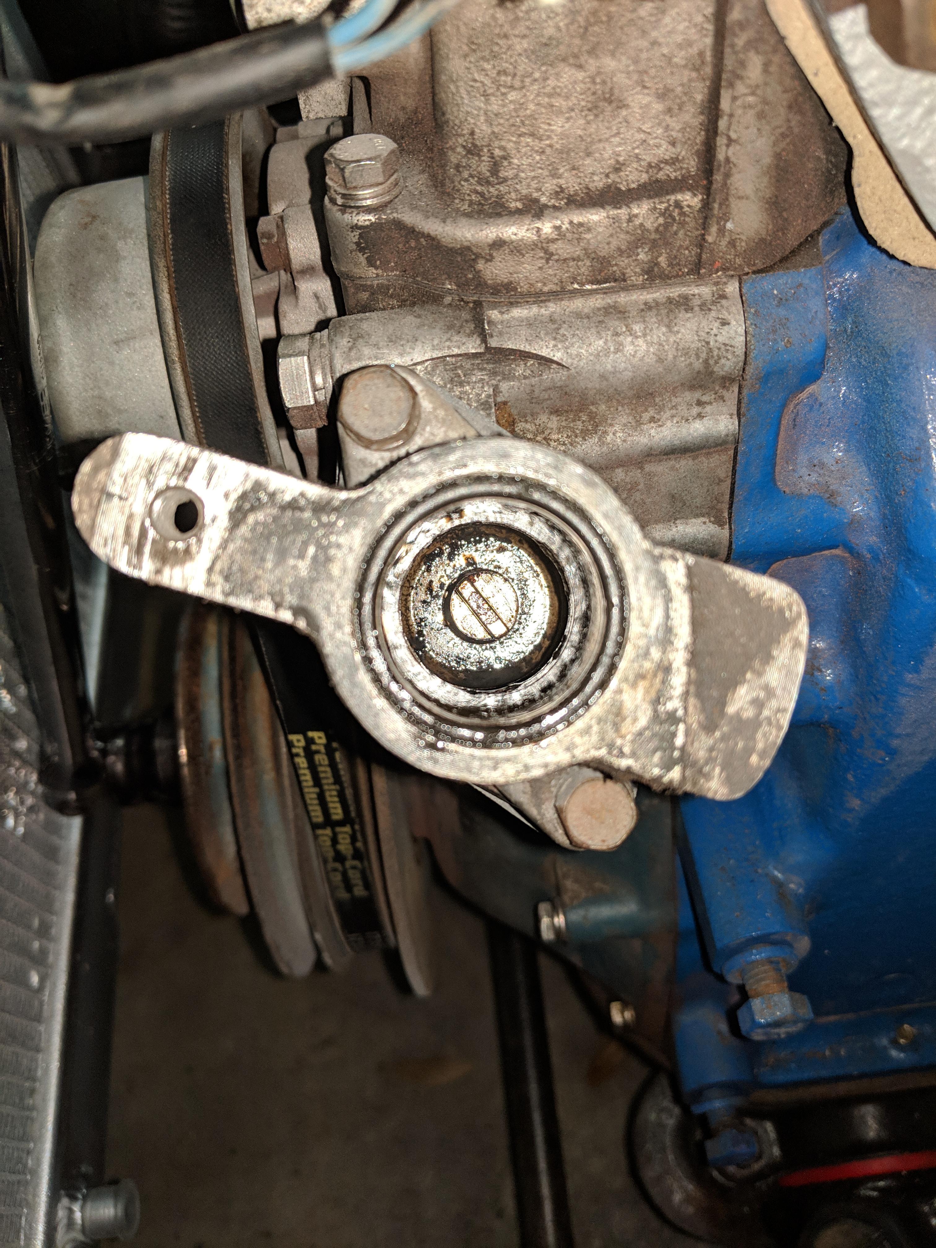

April 6, 20196 yr comment_572721 46 minutes ago, siteunseen said: You could do the wires 180 and see. 153624 would be 426351? Some more informed cats could chime in here, PLEASE??? site, his fat side matches the fat side you showed except it's off by about a tooth. Here's the 280ZX pictures. They show a rotor for NA and the half moon for turbo. 57 minutes ago, siteunseen said: Looks like the fat side is 180 off. site, it's not clear if this picture is a good setup or bad. Link to comment https://www.classiczcars.com/forums/topic/61948-rebuilt-engine-wont-first-start/?&page=2#findComment-572721 Share on other sites More sharing options...
April 6, 20196 yr Author comment_572722 Update: Moved it a tick in that direction. https://photos.app.goo.gl/1c1ooQshVhN17STt6 ? It seems a bit weird that I have to put the distributor all the way clockwise. Link to comment https://www.classiczcars.com/forums/topic/61948-rebuilt-engine-wont-first-start/?&page=2#findComment-572722 Share on other sites More sharing options...

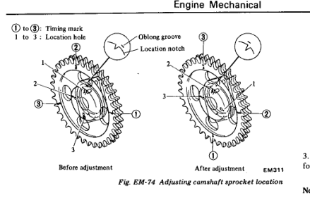

April 6, 20196 yr comment_572723 1 hour ago, CaptainMajestic said: Update, I re-did the valve lashing and now I have compression, about 130 per cylinder (except 6 around 120). You haven't shown the notch and groove either. Match up all of the marks and you can't go wrong. Most people run in to problems when they guess about where things are. It's why Nissan had somebody draw all of these pictures, even if they are bad. Edited April 6, 20196 yr by Zed Head Link to comment https://www.classiczcars.com/forums/topic/61948-rebuilt-engine-wont-first-start/?&page=2#findComment-572723 Share on other sites More sharing options...
April 6, 20196 yr Author comment_572724 Just now, Zed Head said: You haven't shown the notch and groove either. Match up all of the marks and you can't go wrong. Most people run in to problems when they guess about where things are. It's why Nissan had somebody draw all of these pictures, even if they are bad. Yup, I double and triple checked it earlier today. Had to rule out beer mistakes Link to comment https://www.classiczcars.com/forums/topic/61948-rebuilt-engine-wont-first-start/?&page=2#findComment-572724 Share on other sites More sharing options...
April 6, 20196 yr comment_572725 39 minutes ago, CaptainMajestic said: Update: Moved it a tick in that direction. https://photos.app.goo.gl/1c1ooQshVhN17STt6 ? It seems a bit weird that I have to put the distributor all the way clockwise. EDIT! - THIS IS WRONG. It's just a tooth off. I posted mine before I realized you might have it backward. See my edit way above, about the half moon. Can't emphasize enough, using all of the marks. You should have the valve cover off so that you can see the cam lobes. Edited April 6, 20196 yr by Zed Head Link to comment https://www.classiczcars.com/forums/topic/61948-rebuilt-engine-wont-first-start/?&page=2#findComment-572725 Share on other sites More sharing options...

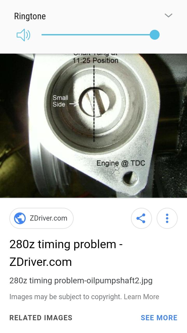

April 6, 20196 yr comment_572727 Just reread all of my stuff and the only good advice is the notch and groove. I don't even use the half moon, I use the rotor and #1 plug wire. Lots of redundancy in the FSM. Not really sure which way the half moon goes, There's variation all over the internet and the FSM pictures are bad. Good luck. Link to comment https://www.classiczcars.com/forums/topic/61948-rebuilt-engine-wont-first-start/?&page=2#findComment-572727 Share on other sites More sharing options...
April 6, 20196 yr comment_572728 2 hours ago, CaptainMajestic said: Update, I re-did the valve lashing and now I have compression, about 130 per cylinder (except 6 around 120). Here's what the distributor rotor looks like when I'm at TDC: https://photos.app.goo.gl/EFTUHwfnY15yvpQh8 From what I've seen online, it's slightly too far south and should be a tick more in the CW direction. I'm guessing I need to pull the oil pump and tick it back one notch? Alright, I knew it was in there somewhere. They used words!!! Who knew. @CaptainMajestic You should be good to go. Edited April 6, 20196 yr by Zed Head Link to comment https://www.classiczcars.com/forums/topic/61948-rebuilt-engine-wont-first-start/?&page=2#findComment-572728 Share on other sites More sharing options...
