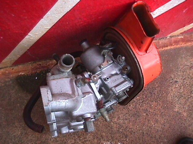

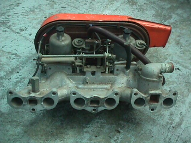

May 18, 200322 yr Author comment_37876 Photo as promised. Thanks Simon Link to comment https://www.classiczcars.com/forums/topic/6187-manafold-questions/#findComment-37876 Share on other sites More sharing options...
May 18, 200322 yr comment_37880 I asked the guys from the mailing list to review your manifold picture in the gallery. I'm sure you'll receive a few comments. Link to comment https://www.classiczcars.com/forums/topic/6187-manafold-questions/#findComment-37880 Share on other sites More sharing options...
May 18, 200322 yr comment_37899 I took a look at the picture you attached to this thread. It is hard to see much of the carbs other than the domes. And from that all I can say is they look like SU type carbs. The air cleaner surely doesn't look like a US round top SU type carb air cleaner. It is the right color but the shape of the air inlet is totally different. And the manifold would not work on any of the US Z carb heads. The mount bolts are too far in the corners, US heads bolts are closer over the holes of the ports. Also the US Z carb heads don't have wather inlets between the rear ports. One more thing is that the thermostat housing is not part of the US manifolds and it is further forward on the head. It also looks like there are vacuum diaphrams on both carbs. US 240Z SU carbs only have a vacuum fitting on the front carb for the distributor vacuum advance. The linkage looks somewhat Z like. Either this is off a Z with a very different head design or a different straight 6 engine. How about a picture from the other side with the air cleaner off? Sorry, I cannot be more helpful in identifying these carbs!!! Link to comment https://www.classiczcars.com/forums/topic/6187-manafold-questions/#findComment-37899 Share on other sites More sharing options...
May 18, 200322 yr comment_37907 Hi Royce,Simon was querying the manifold.I must say it is interesting, I've certainly never seen anything like it and could only guess it may have been associated with a 240K or GL? That would mean a different head to the types we are used to! Crossflow, the mind boggles......I wonder if the SU's are actually Zed SU's? I have seen many zeds running around with smaller SU's from SSS, with owners thinking that they where the correct ones!Measure the head side of the carb body if you have time. Link to comment https://www.classiczcars.com/forums/topic/6187-manafold-questions/#findComment-37907 Share on other sites More sharing options...
May 19, 200322 yr Author comment_37921 They measure 3 1/4 Inches. thanks Link to comment https://www.classiczcars.com/forums/topic/6187-manafold-questions/#findComment-37921 Share on other sites More sharing options...
May 19, 200322 yr comment_37923 Oh my god the're inclined as well!Absolutely got me, wonder if they might be zed SU on a manifold for another manufacturer? possibly English????After all no one said it was a 240Z that crashed! Link to comment https://www.classiczcars.com/forums/topic/6187-manafold-questions/#findComment-37923 Share on other sites More sharing options...
May 19, 200322 yr comment_37971 Well, those are certainly not US Z Hitachi SU carbs. The carb bodies are very, very different. I am pretty sure that they are from a non-Datsun vehicle but don't know what they might be from. But hey! That doesn't mean you cannot get them to work on a Z. But you will likely need to get them to mount to a Z manifold. Link to comment https://www.classiczcars.com/forums/topic/6187-manafold-questions/#findComment-37971 Share on other sites More sharing options...
May 19, 200322 yr Author comment_37990 Ive posted more photos and are awaiting approval.Its beginning to look like the boats going to be sercure with two sets of anchors!!Thats very much for your help.Regards Simon Link to comment https://www.classiczcars.com/forums/topic/6187-manafold-questions/#findComment-37990 Share on other sites More sharing options...
May 19, 200322 yr comment_37994 Oh, I wouldn't say that at all. If you cannot make these work on a Z than they would certainly be valuable to someone. I would think much more than the "boat anchor" US flat top carbs. I have also heard of people using British SU carbs on Z's with good success. I'll have to take a look at my Ztherapy video again to see if he shows carbs like these. I am pretty sure he goes over British and Volvo SU carbs. Link to comment https://www.classiczcars.com/forums/topic/6187-manafold-questions/#findComment-37994 Share on other sites More sharing options...
