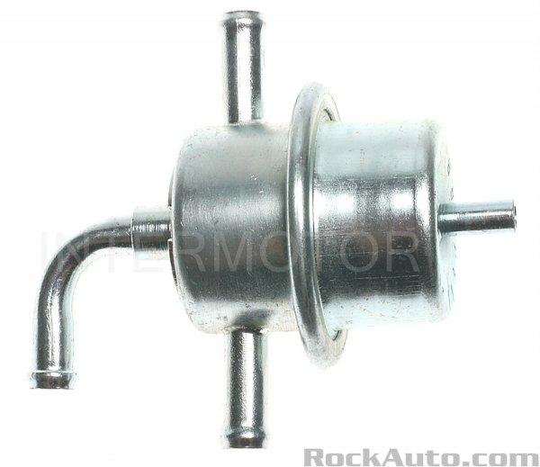

The PN in the carpartsmanual site is 22670-N4200
before you go this route make sure you know what you are getting. Or just go the cheaper route, it will most likely be fine as well. I just like to get OE if I can.
Edited by Dave WM
Yes that's one of the alternate / OE part numbers listed for the part on the Rock Auto site. I went ahead and ordered it, comes with a 3 year / 36,000 mi. warranty.

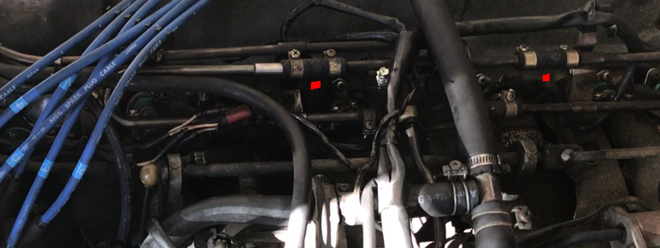

While you're there you should probably replace all of the hoses.  Even the injector hoses if they have that braided hose on them, which seems to be on the rail.  Probably original.  Mine were and they eventually sprung a leak.  I smelled fuel, stopped, popped the hood with the engine still running, and a thin stream of raw gasoline shot by my head to the sidewalk.  Luckily there were no people walking by, and i had a screwdriver in the car to crank the clamps down.  The hoses had tiny lengthwise cracks.  You can probably see them with a bright light on the end of the hose.
Plus you'll probably bend things if you try to replace the FPR without removing the injectors.  I've seen many bent rails.
Hoses on injectors and fuel rail were all recently replaced with new hoses by PO's mechanic.
Thanks for the word of caution. Might just cut the hoses off at FPR if easier than trying to remove and reuse. Replacement high pressure fuel injection hose is not that expensive ($5.25-ish per foot).

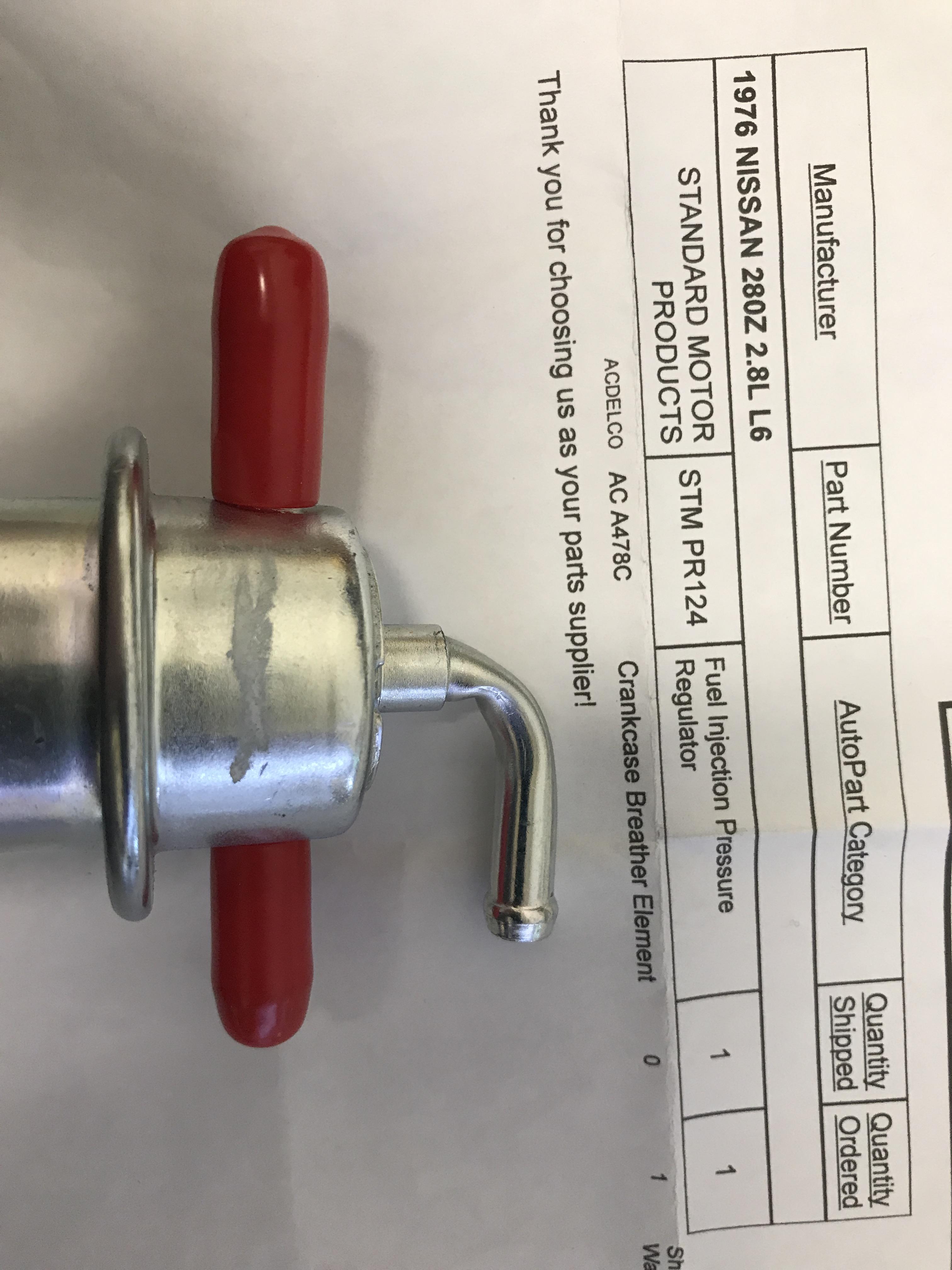

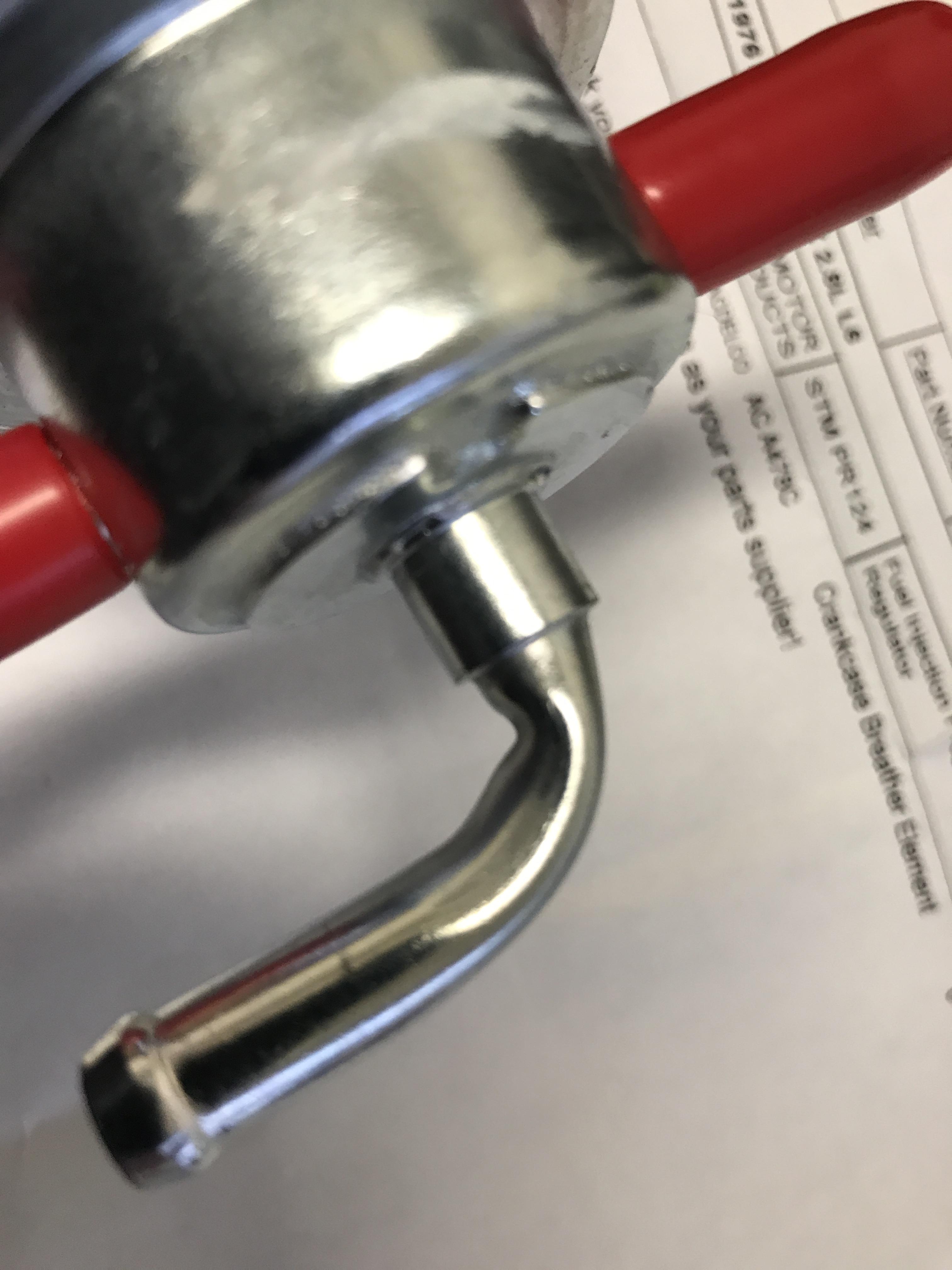

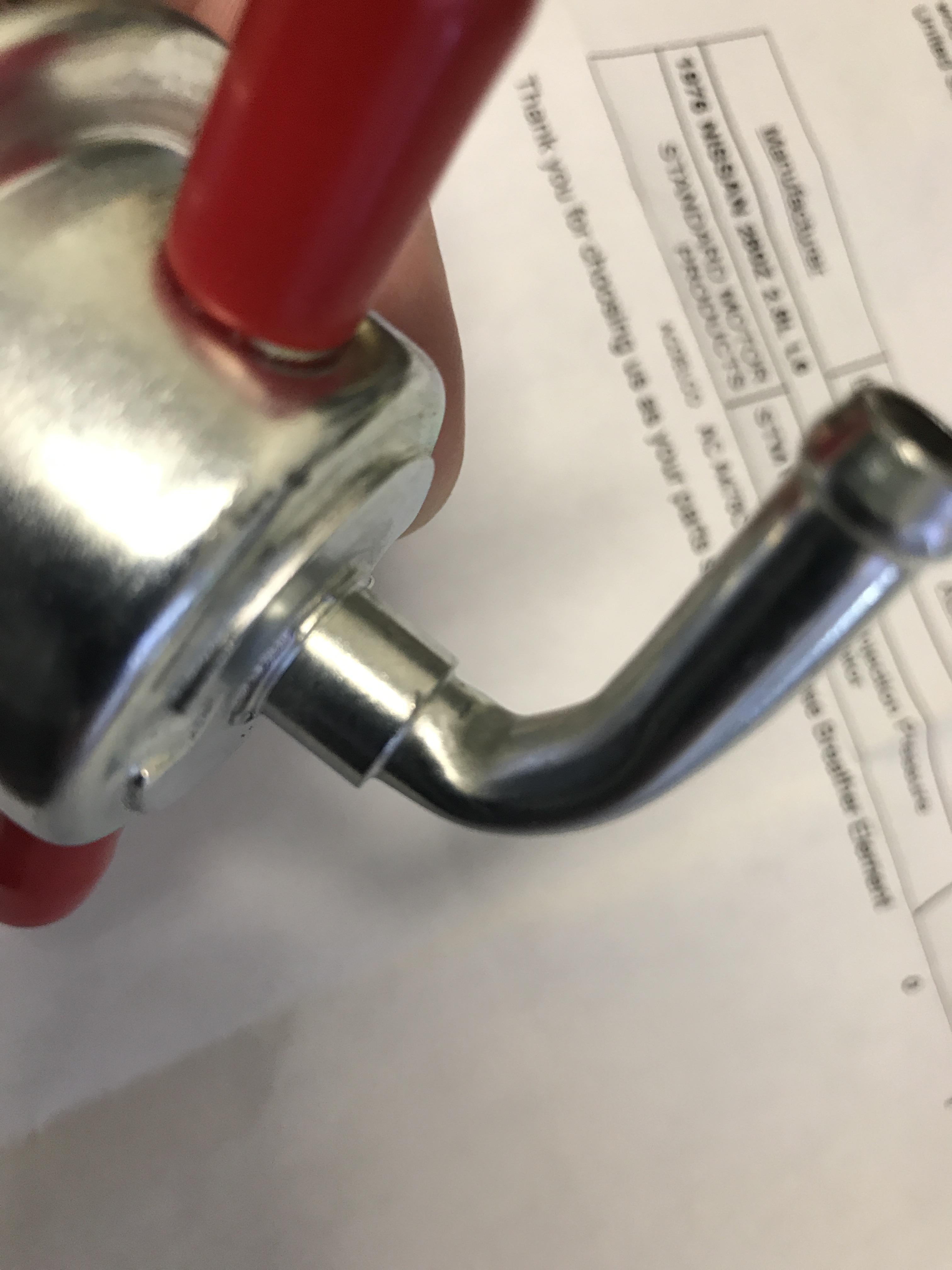

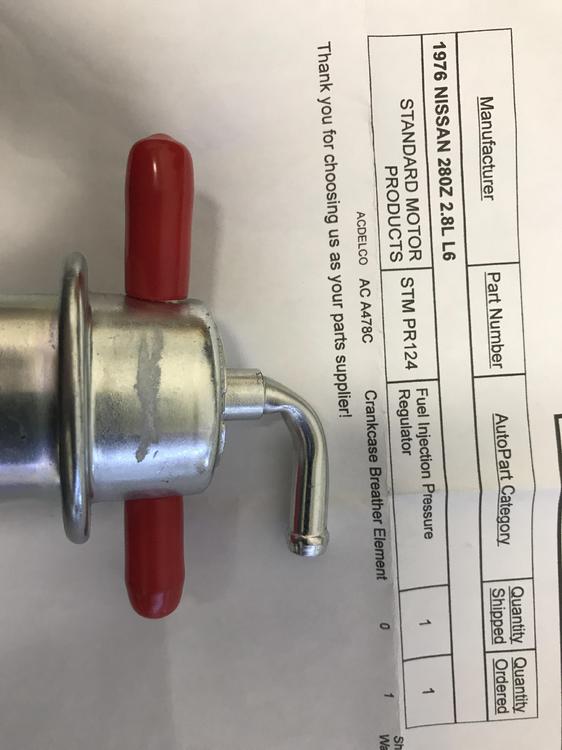

So, here's the part that RockAuto delivered after waiting for AN ENTIRE WEEK! ?
The box was not sealed, torn labels on the outside. It appears to have been a used / returned product.
The return fuel line looks like someone just bent it with wrench or something. J - A - N - K - Y !
Does not look legit at all and I'm not comfortable installing this thing in my car.
Sending it back for a refund.
Going to the local O'Reily today to order the part with the lifetime warranty, hopefully it will only take 2-3 days to get the part.
Arrrrrrgh!!!!! Damn Rock Auto!
