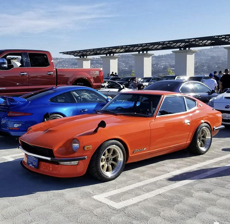

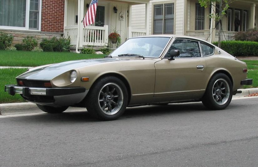

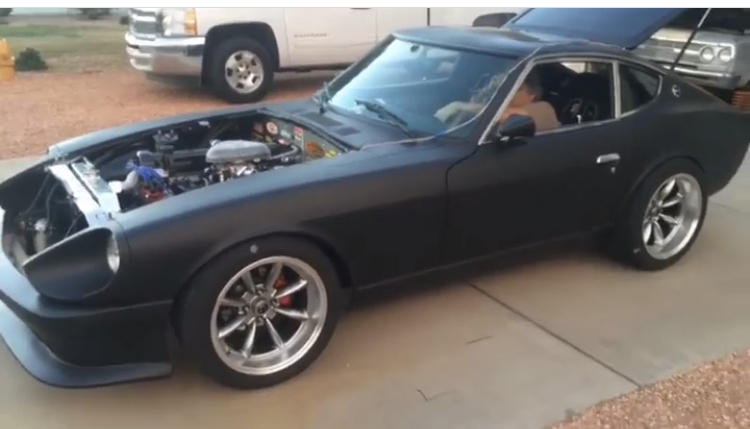

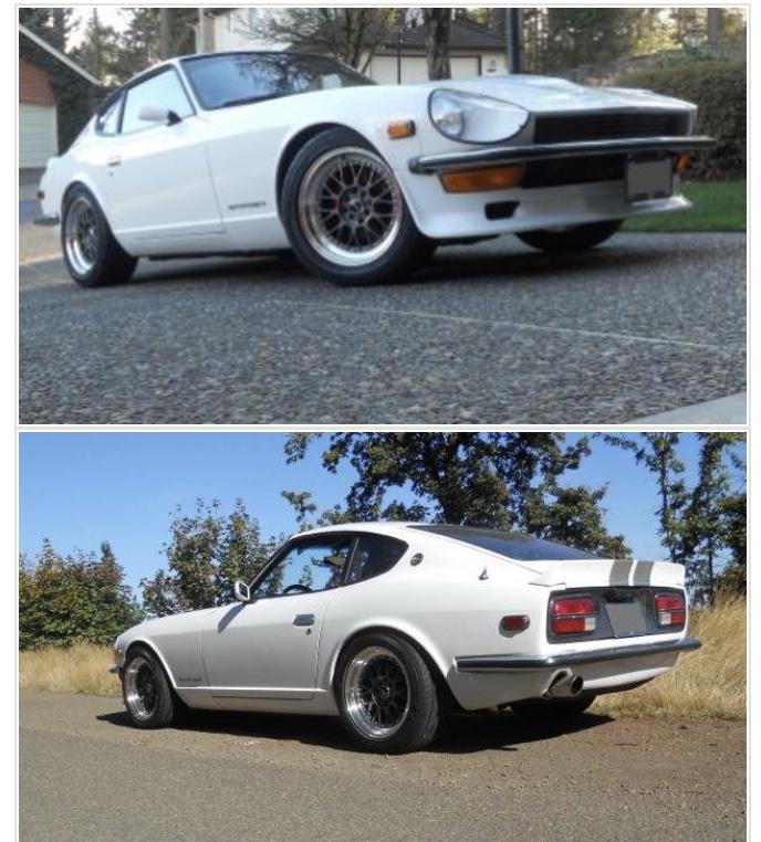

i have attached the perfect setup that im looking for

None of those setups have a stock fender... they will have to have been rolled or they will rub. Also, you will need to have some camber involved to clear the wells. The front air dams on all of those cars have also been modified (not stock) as the front wheels would rub the nacelles in corners.
