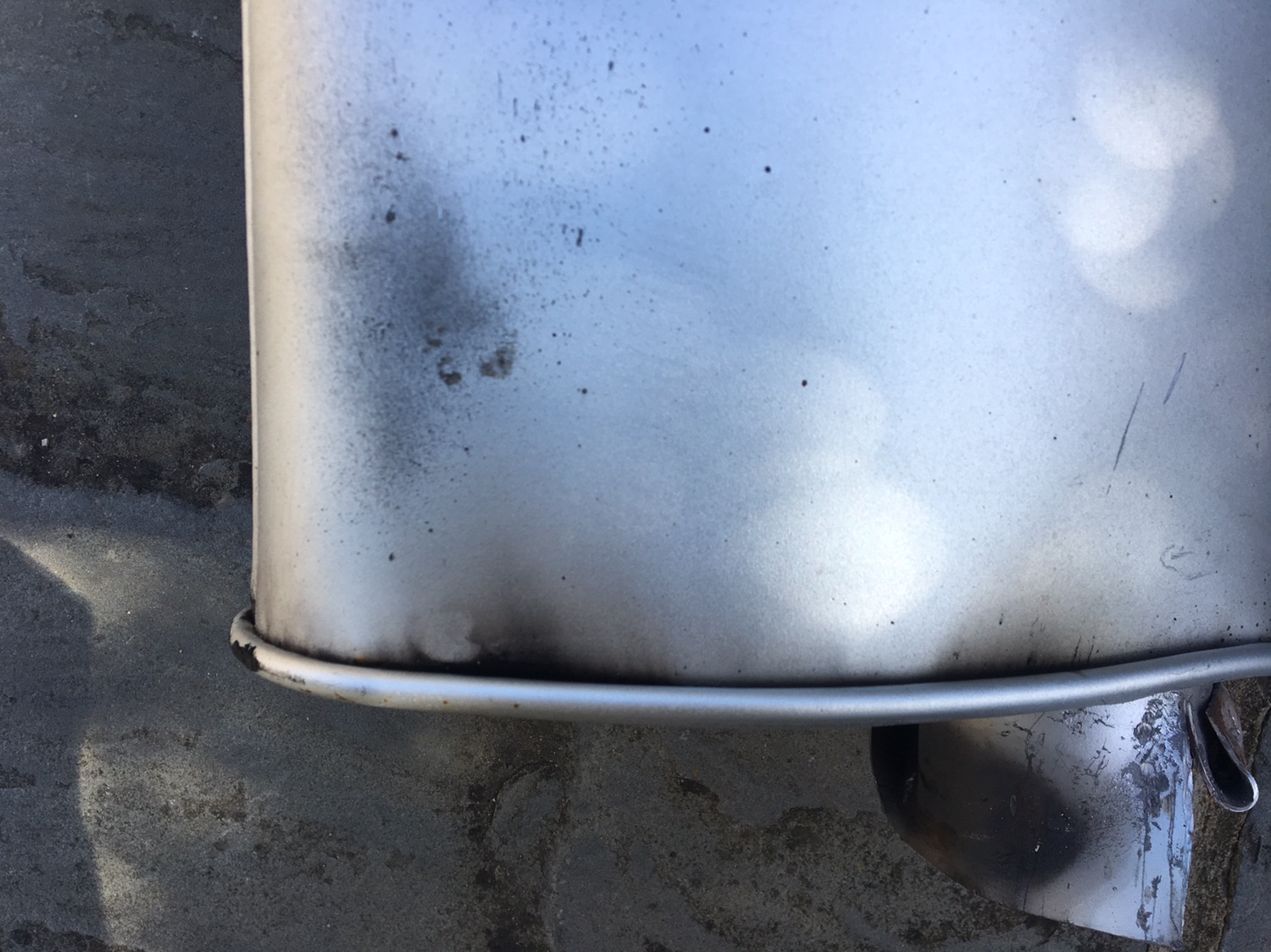

A word of warning on the 123 - don't trust the no.1 marking on the cap. Check the position of the rotor relative to the cap. I stupidly didn't and with timing 120degrees out, blew my muffler trying to start - at least I knew there was a spark :p
