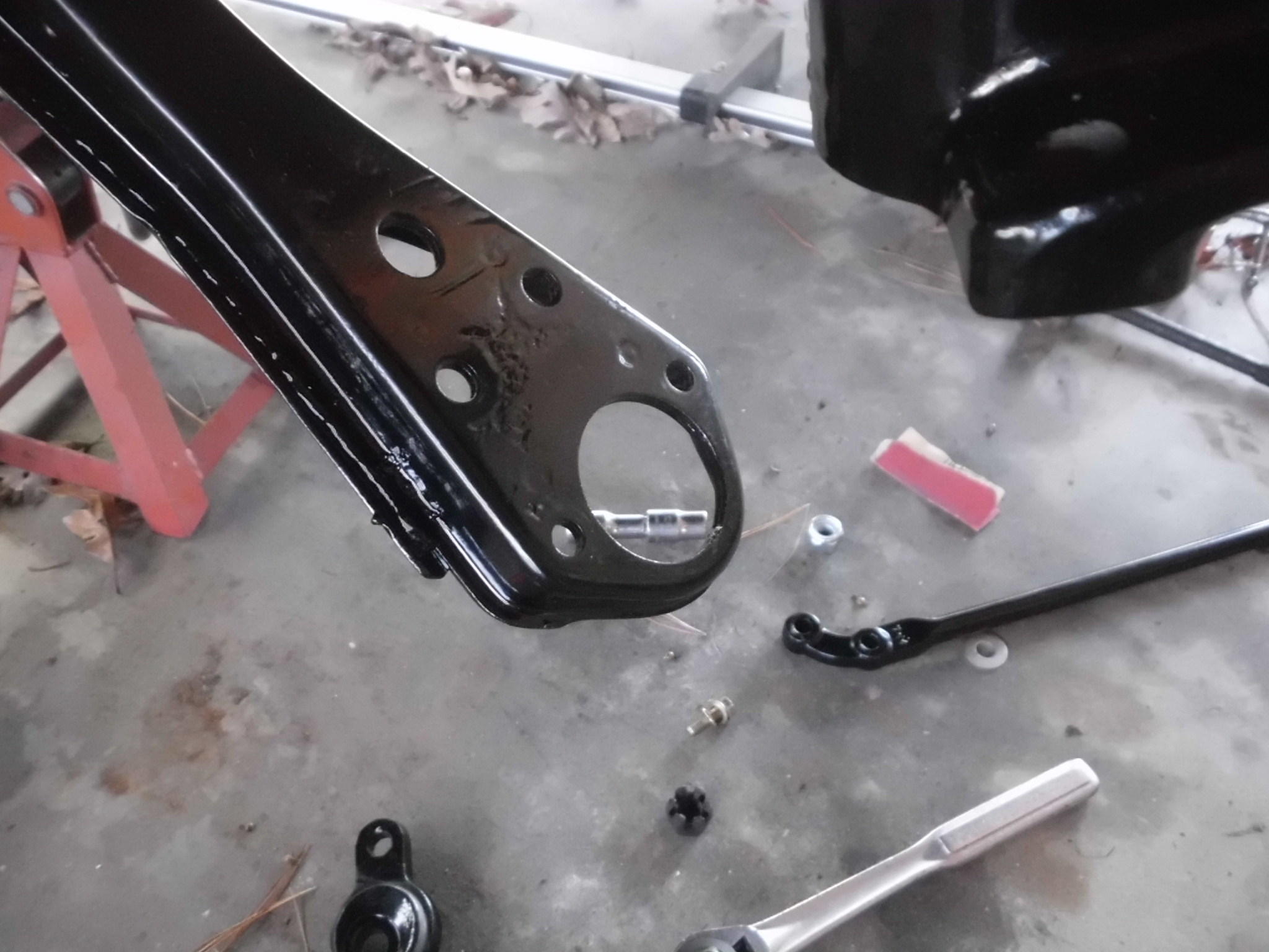

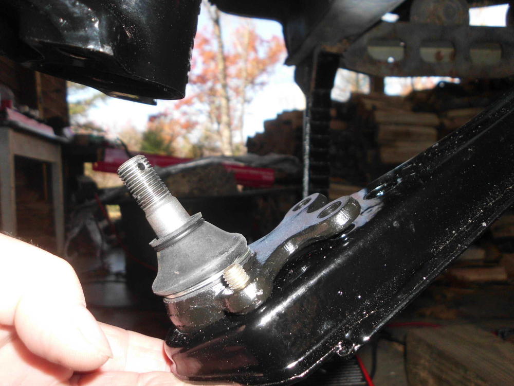

OK...If anyone is still with me on this topic. Does the ball joint go on TOP of the control arm or is it installed from underneath...? The ball joints I bought (MevoTech) fit nicely from underneath...meaning nice and flat and even. When I set the domed cup of the grease fitting through the big hole in the control arm, it does not fit flat. I cannot find a good picture of this in the factory manual...HELP...!
Yes, it mounts on top of the control arm.
Thanks Sheen...But they dont sit nice and flat. Not sure of they tare just bad castings, but they fit perfect from underneath.
I love to see a really good picture of how it all looks when correctly assembled....PLEASE...!
These are no good?  Maybe you're looking at the arm (transverse link) upside down.
Zed...I feel like if I tighten this down the ball joint casting will crack. I can hear the powder coating cracking on the control arm as I tighten the two smaller bolts. The casting seems to be a bit too large or tapered for the large hole...maybe too much powder coat...? I don't want to bend the control arm when I tighten the larger through bolts with the tension arm on top of the ball joint flange...Just nervous, that's all...! Thanks...Ryals
