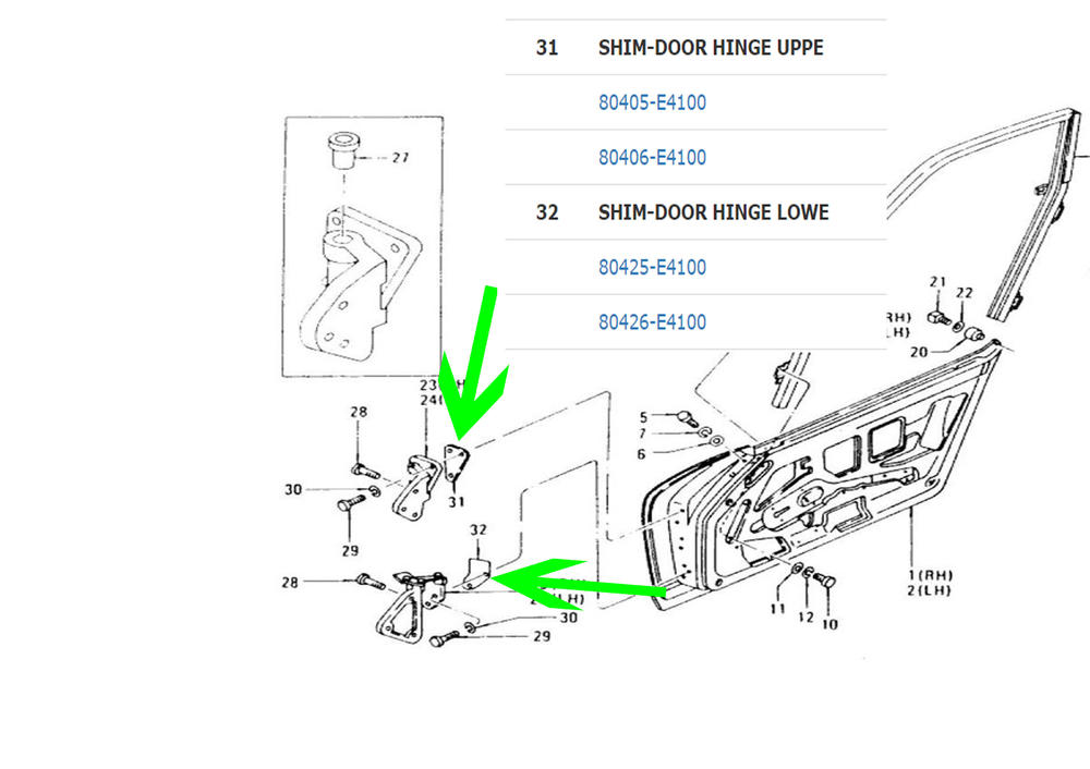

I'm searching for the 240z, 260z Shim doors, upper and lower, in order to adjust the 240Z doors properly.
Anyone can get me the pairs?
On the picture the arrows show the parts I'm searching.
Regards
Mário

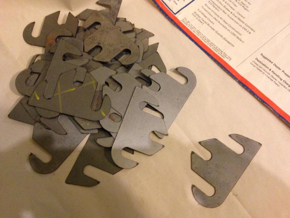

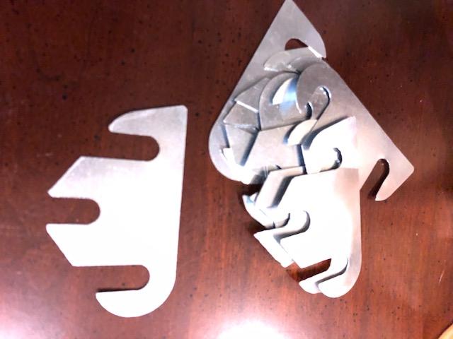

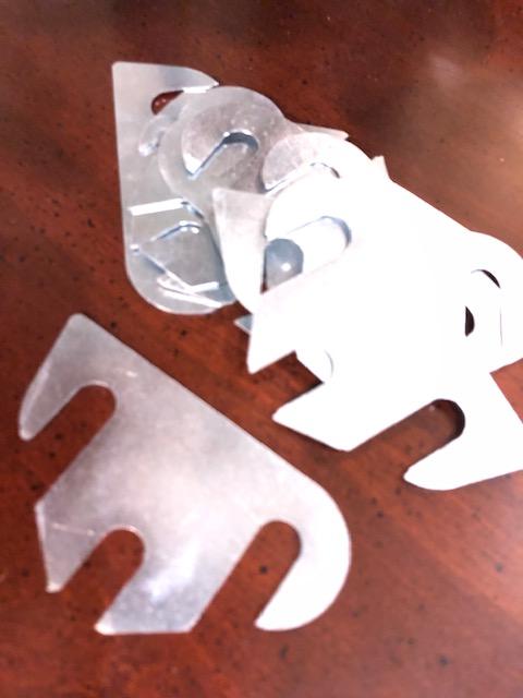

Yes, I had a 100 or so laser cut. I am waiting to make a zinc plating run to Muncie, then they will be ready.

Plan to possibly take them for plating Wednesday if the company is open. I will let you know when they are plated. JLP
