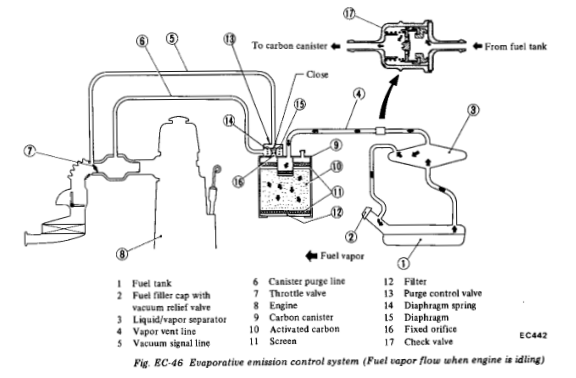

So I had forgotten that I had these snippets from the FSM that relate to that check valve. Had posted them somewhere on some thread prior. Details have faded. In any event, mention of the check valve started in 76. I don't know if it existed in 75 and they just didn't mention it, or if it was a new device added in 76.
Here's the location on the car:
Here's how it looks in the system schematic. This is from the 78 manual. Previous years had a similar pic, but 78 is the most accurate:
