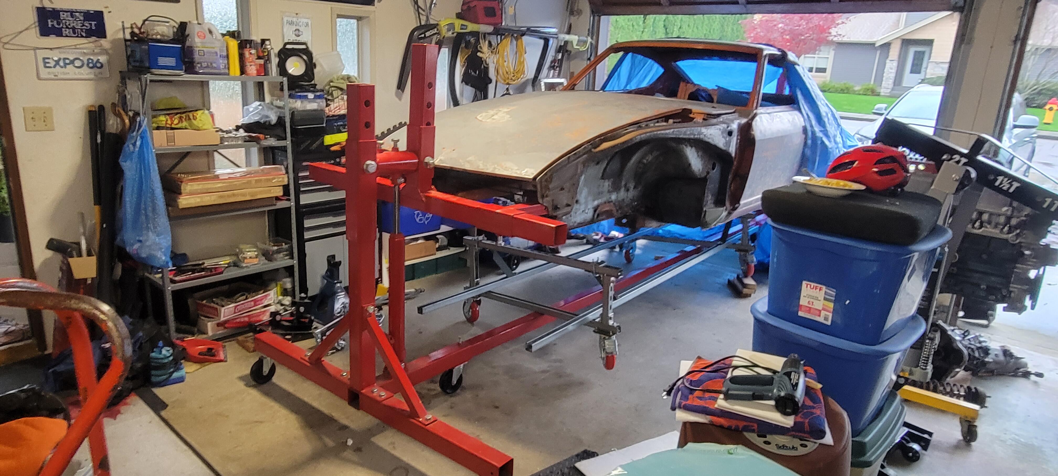

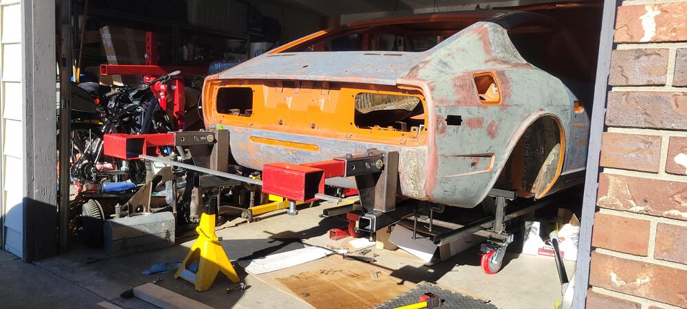

October 20, 20231 yr Author comment_658328 10 minutes ago, grannyknot said: Gottcha, from that first photo it looked like the rear axis was much higher than the front. Nice rig. Thanks, I agree that first image is decieving. Link to comment https://www.classiczcars.com/forums/topic/60693-1970-hls30-06521-re-restoration/?&page=16#findComment-658328 Share on other sites More sharing options...

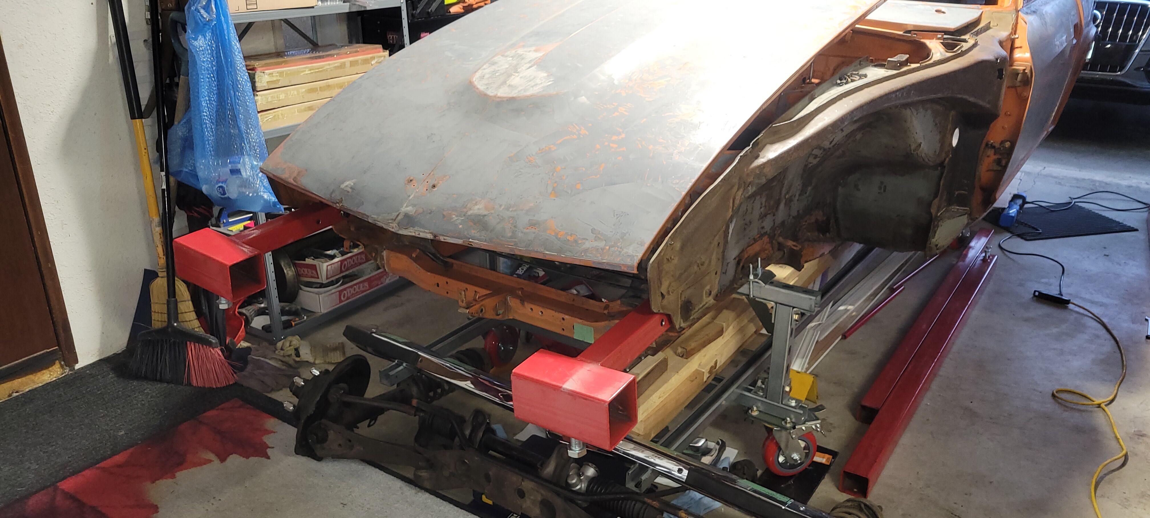

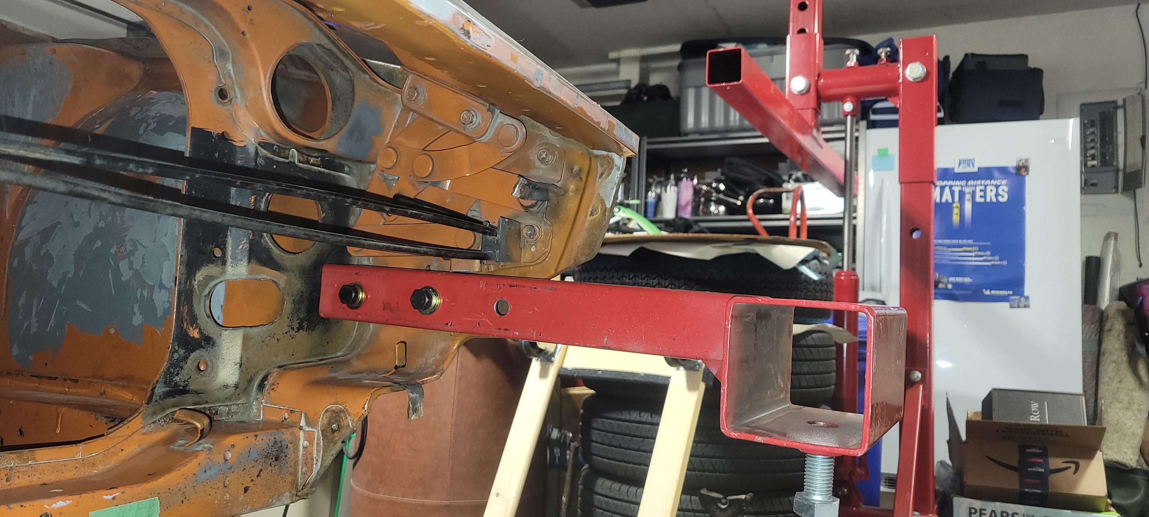

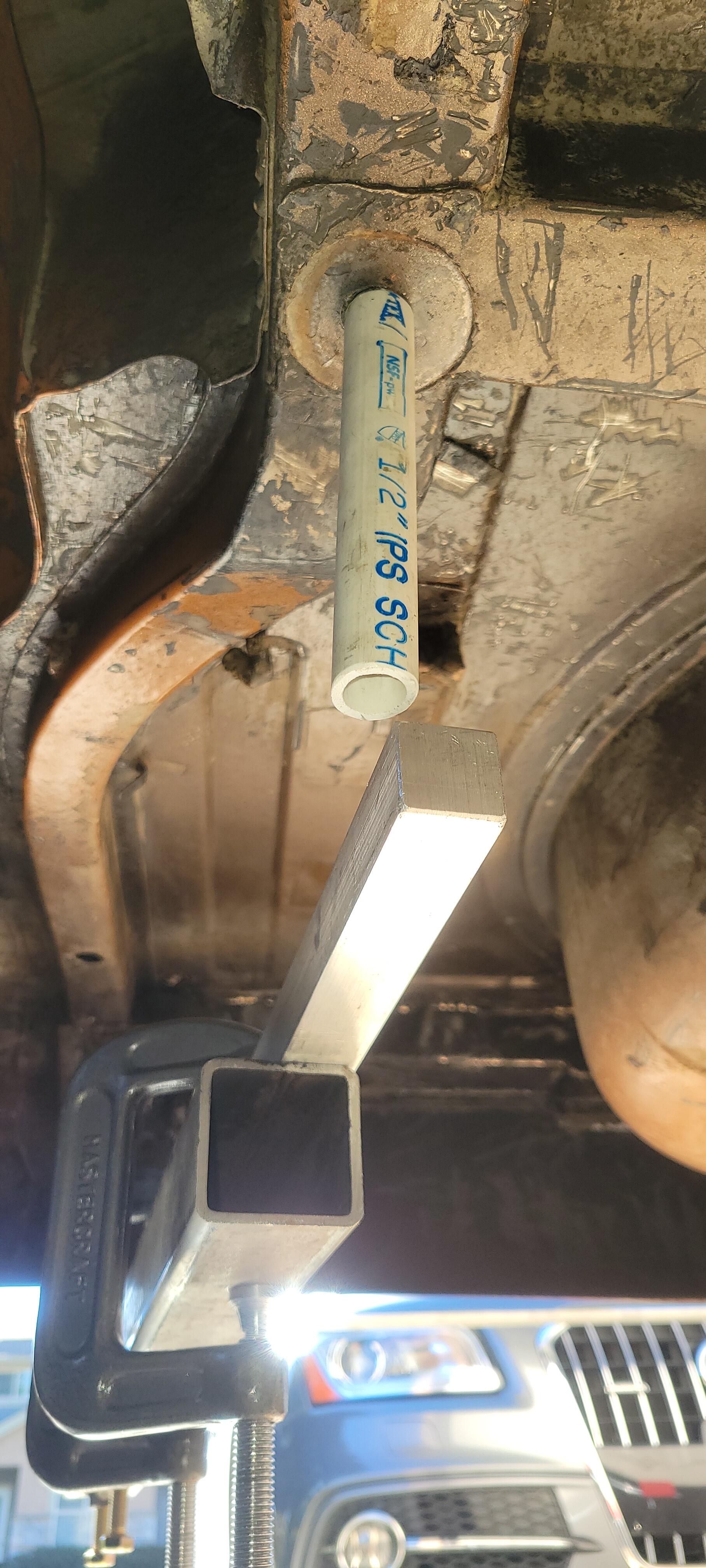

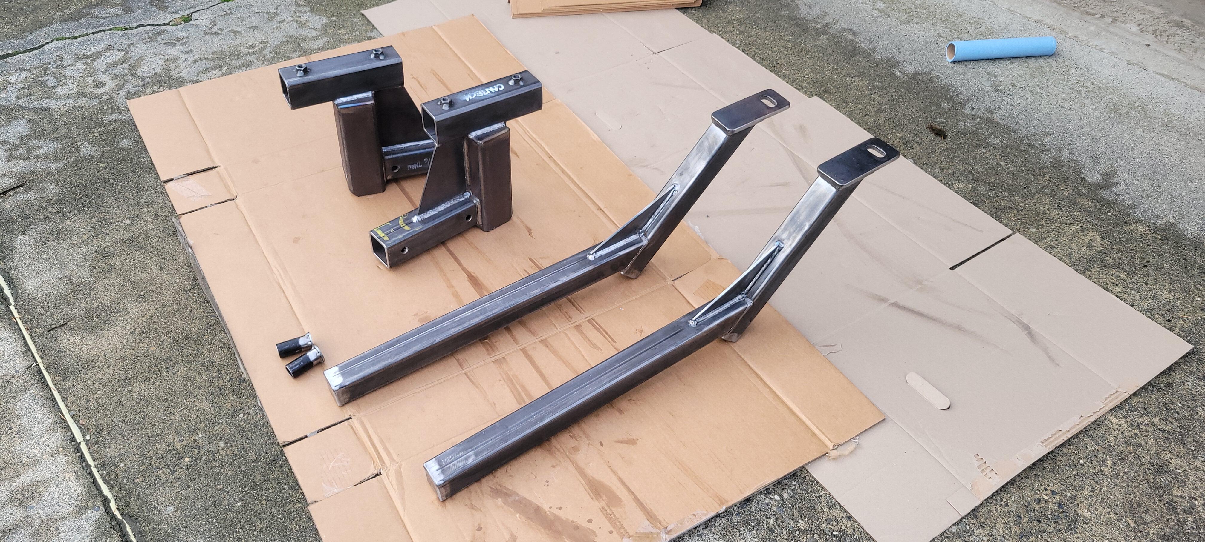

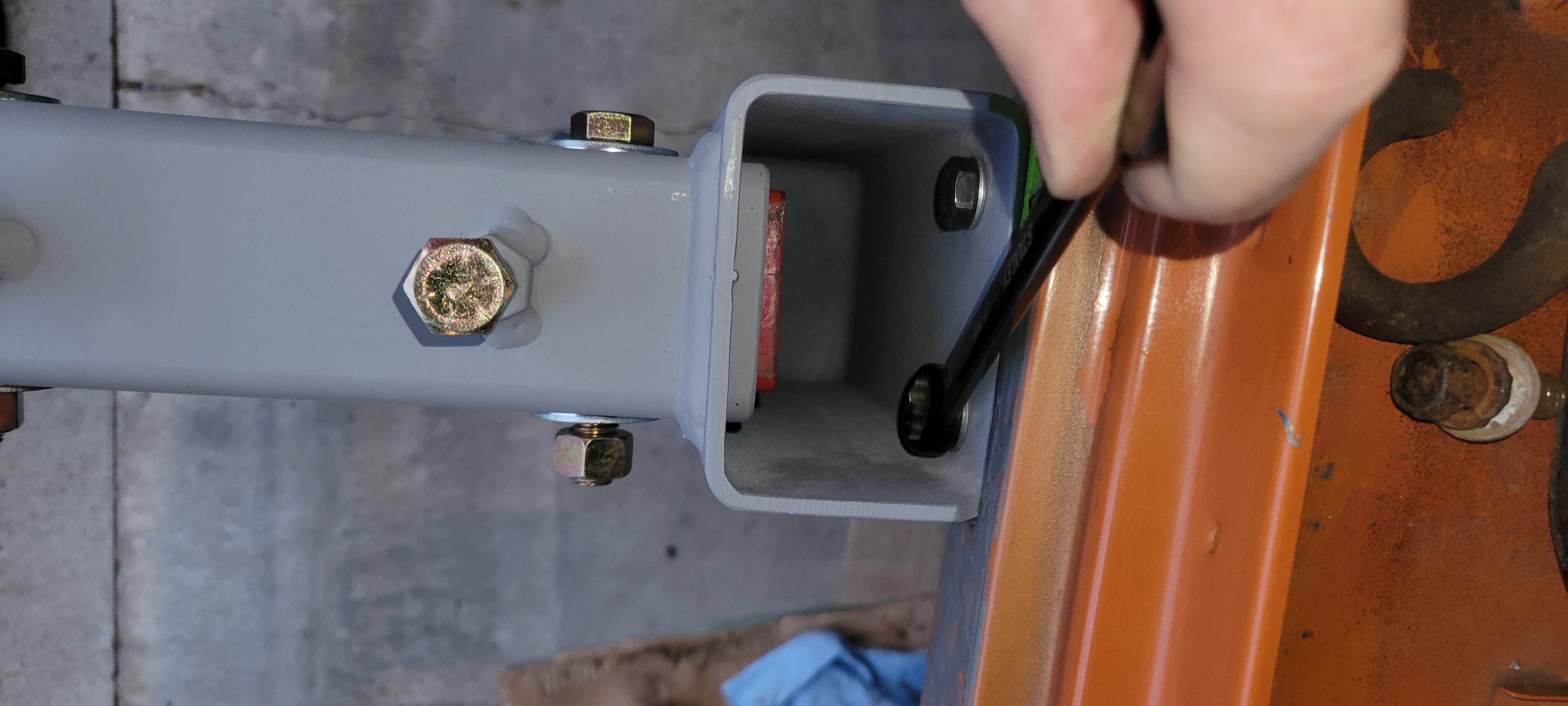

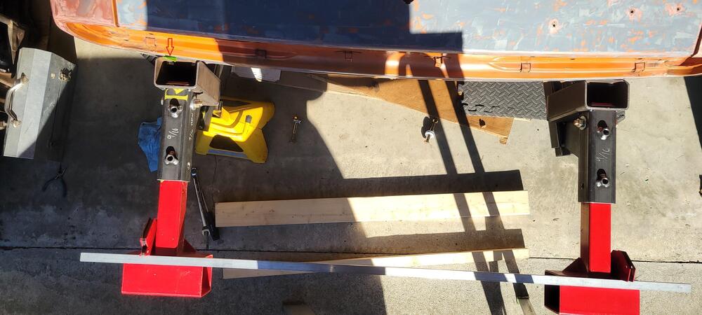

October 28, 20231 yr Author comment_658774 Yesterday I picked up the rear rotisserie brackets from my fabricator (in the tacked state) and this morning I was able to do a test fit to check the angle for the diff mount extensions. They fit good, so they can now be welded up as is. While they were attached I also did a squareness check and found that the left bumper mount was was note quite parallel with the right. A 1/8 inch shim (2 washers) between the far left bolt and the new bracket took care of the issue, so I will have no problems with alignment when assembling on the main rotisserie end support. Hopefully next weekend I will be able to get the body onto the rotisserie. The red arrow in this next pic shows where I need the 1/8" shim. Edited October 28, 20231 yr by CanTechZ Link to comment https://www.classiczcars.com/forums/topic/60693-1970-hls30-06521-re-restoration/?&page=16#findComment-658774 Share on other sites More sharing options...

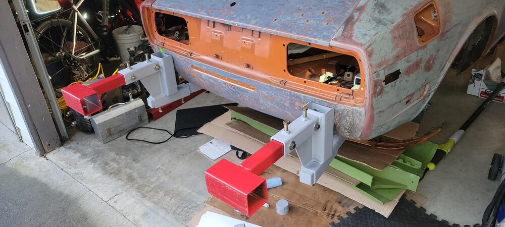

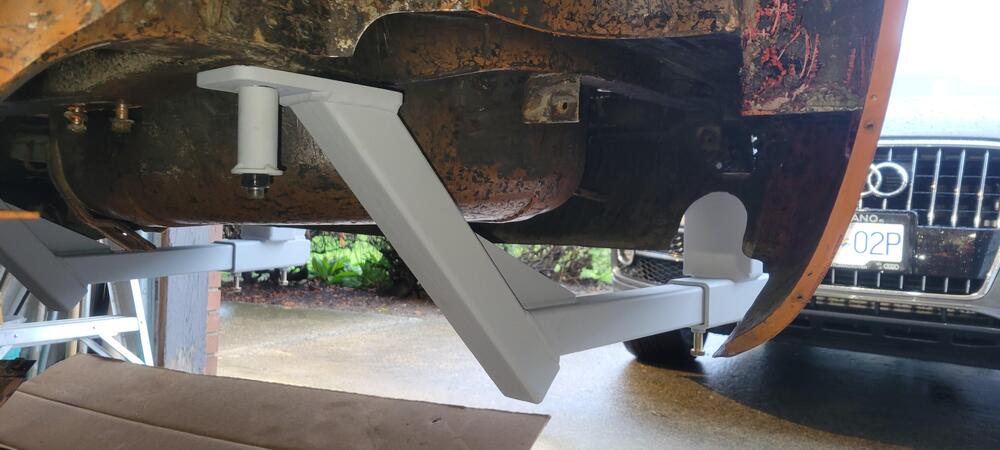

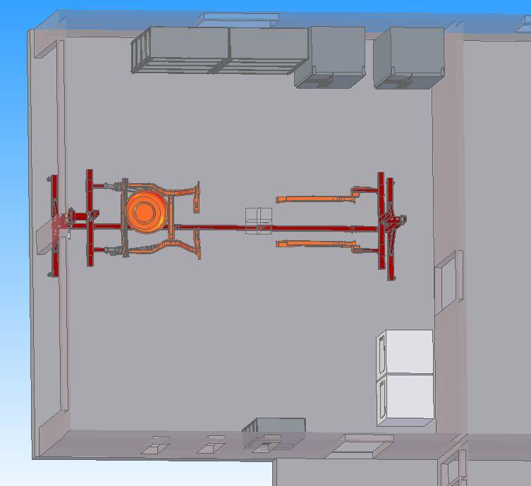

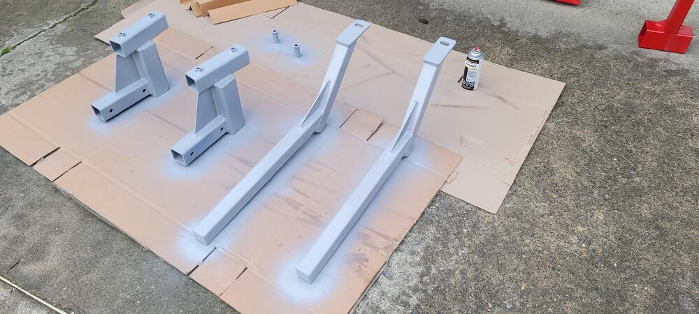

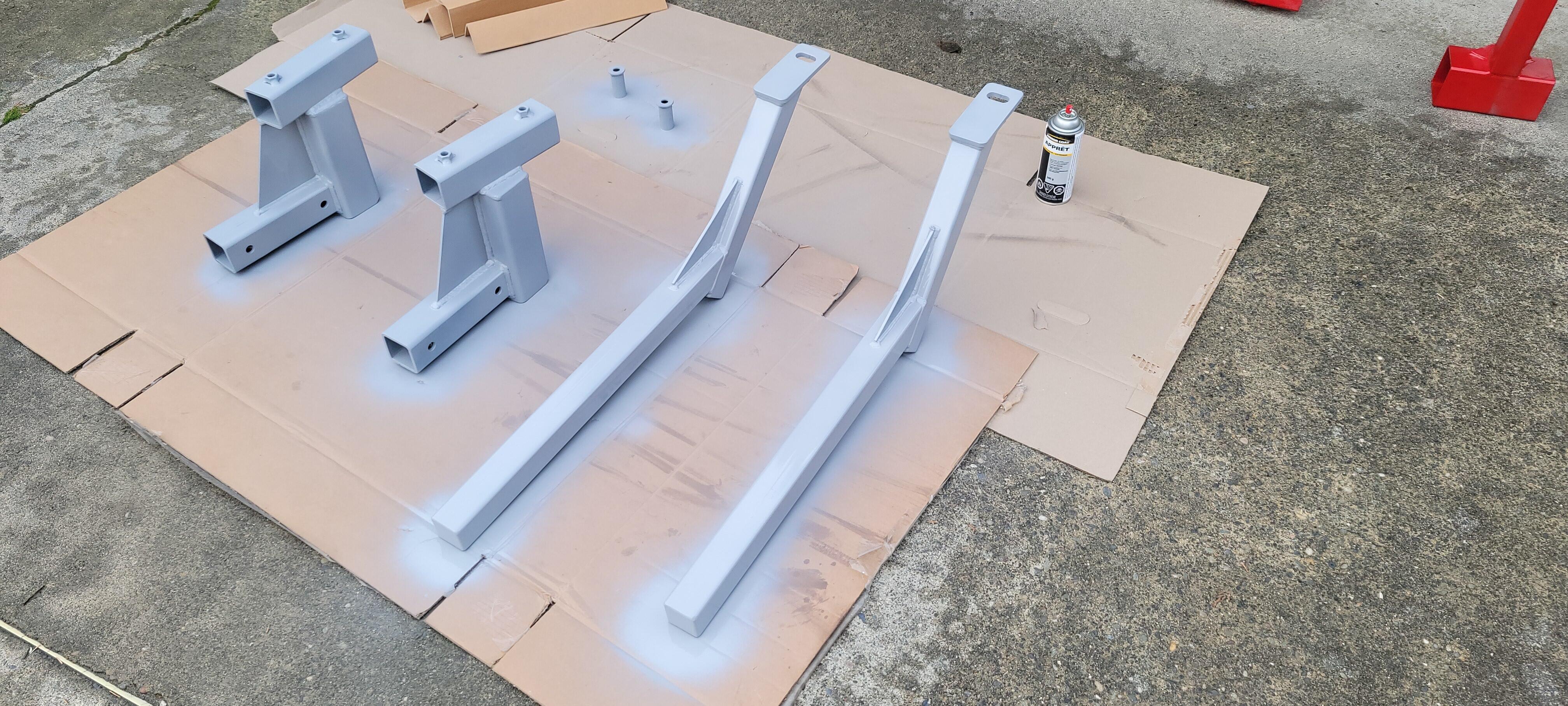

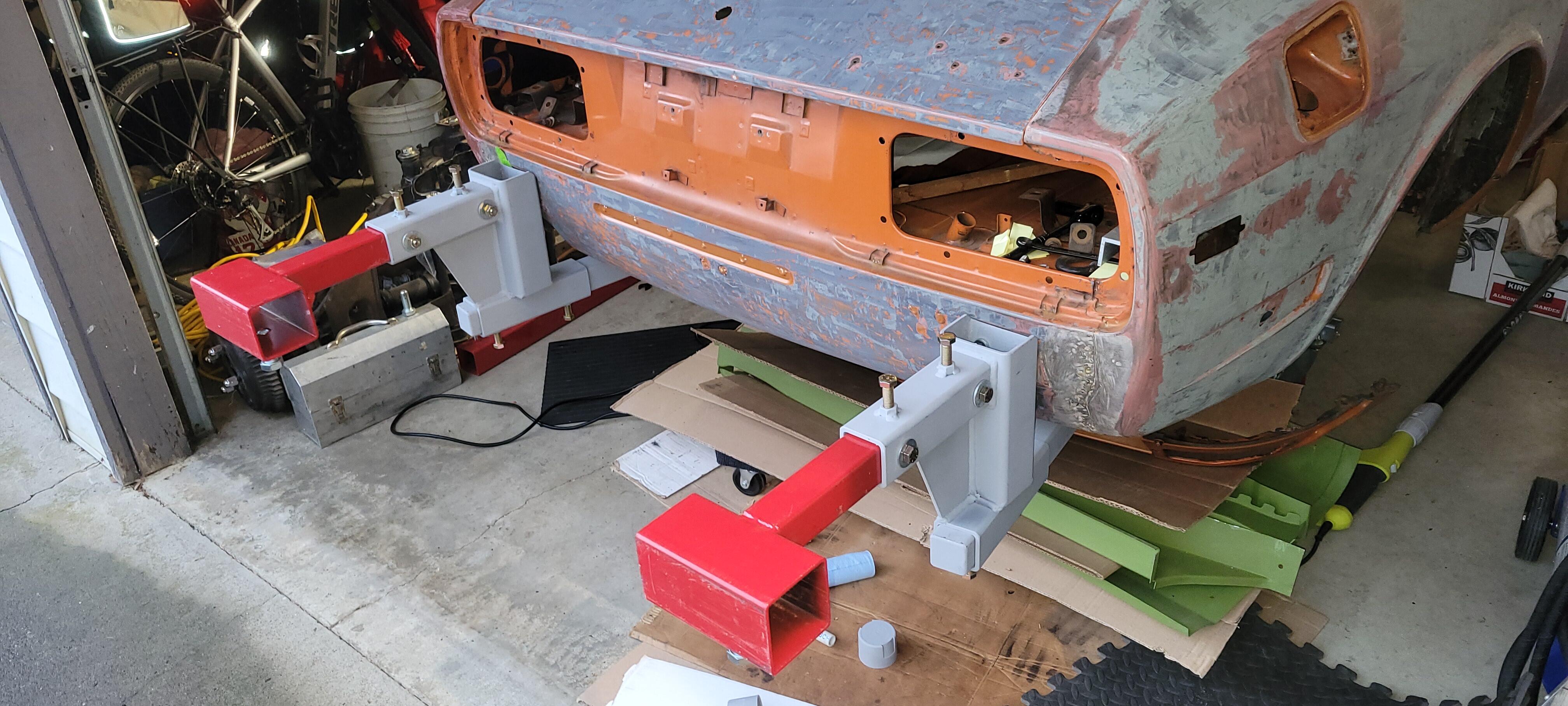

November 4, 20231 yr Author Popular Post comment_659043 Yesterday I picked up the finished rear brackets I had made for mounting the shell on the rotisserie and gave them a quick shot of primer. I'm very happy with the result, my fabricator does great work. Over the weekend I will be working on getting it all put together. I was hoping to do this in my driveway but the weather is not cooperating. The predicted rain for all weekend has already started. My garage is only 21' wide x 20' long so it will be a bit crowed during assembly. When it is all done there is not much front to back walking room but I laid it out in cad and after moving my beer fridge and work bench it looks like it will work. It was handy that I had created a basic 3d model of our house to plan our recent kitchen re-model. Here's a couple of images, Link to comment https://www.classiczcars.com/forums/topic/60693-1970-hls30-06521-re-restoration/?&page=16#findComment-659043 Share on other sites More sharing options...

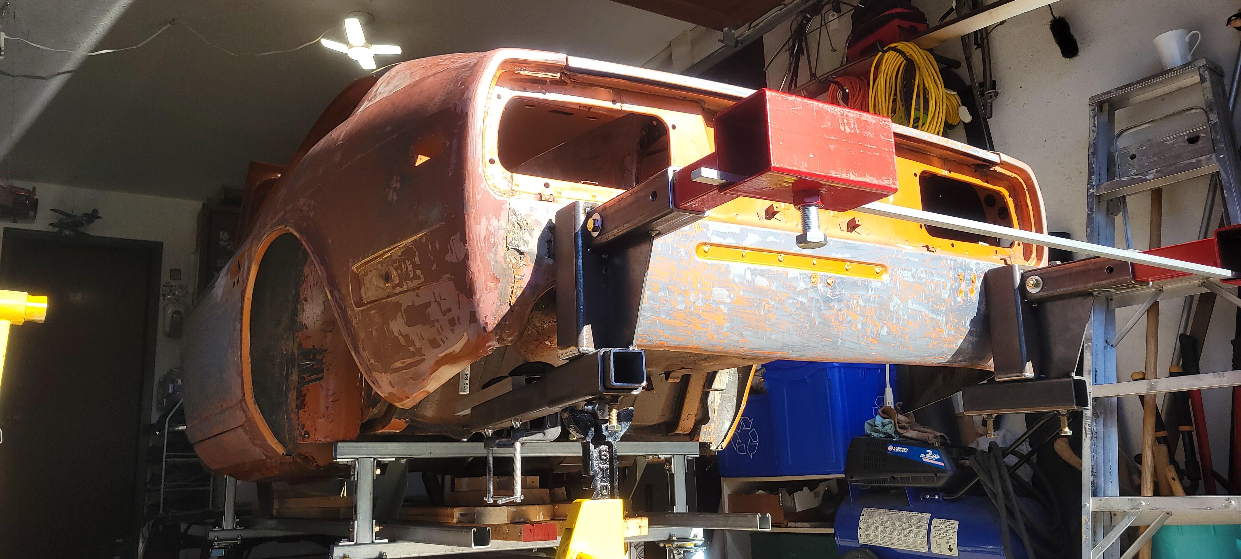

November 4, 20231 yr Author comment_659046 Installing the front and rear brackets went well, time for breakfast.🙂 Link to comment https://www.classiczcars.com/forums/topic/60693-1970-hls30-06521-re-restoration/?&page=16#findComment-659046 Share on other sites More sharing options...

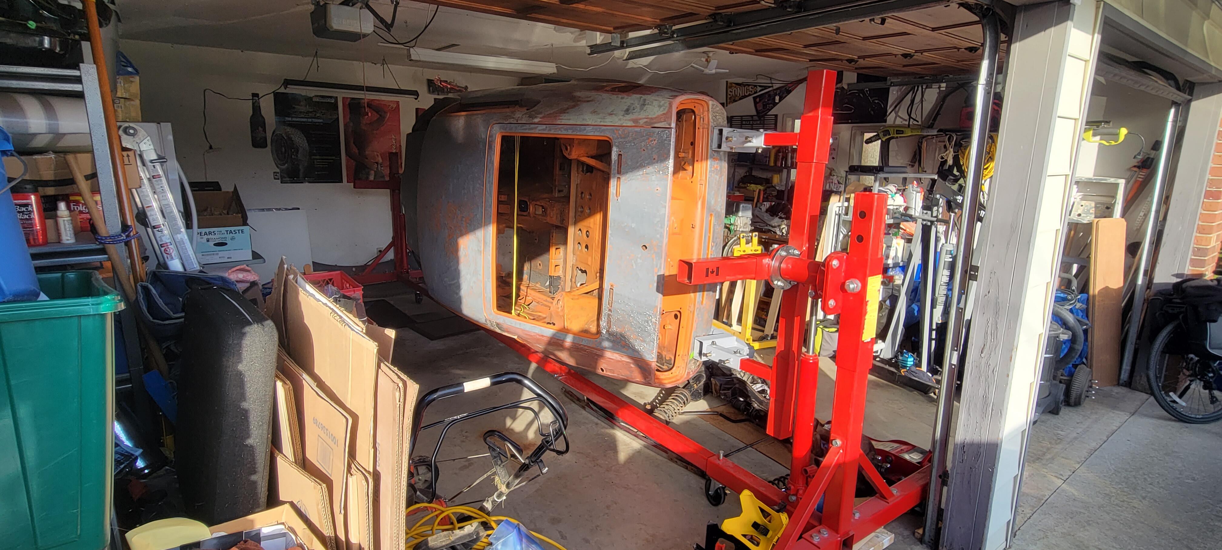

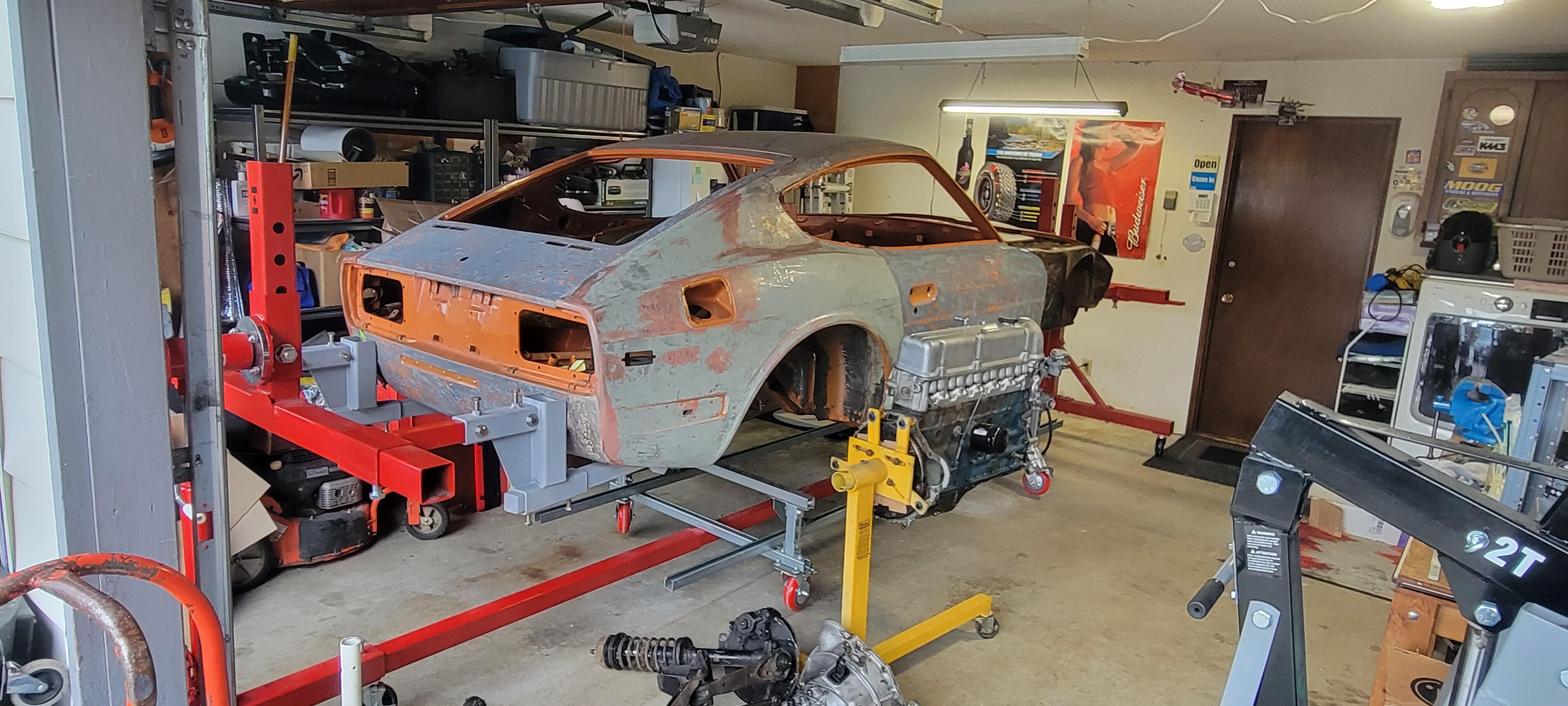

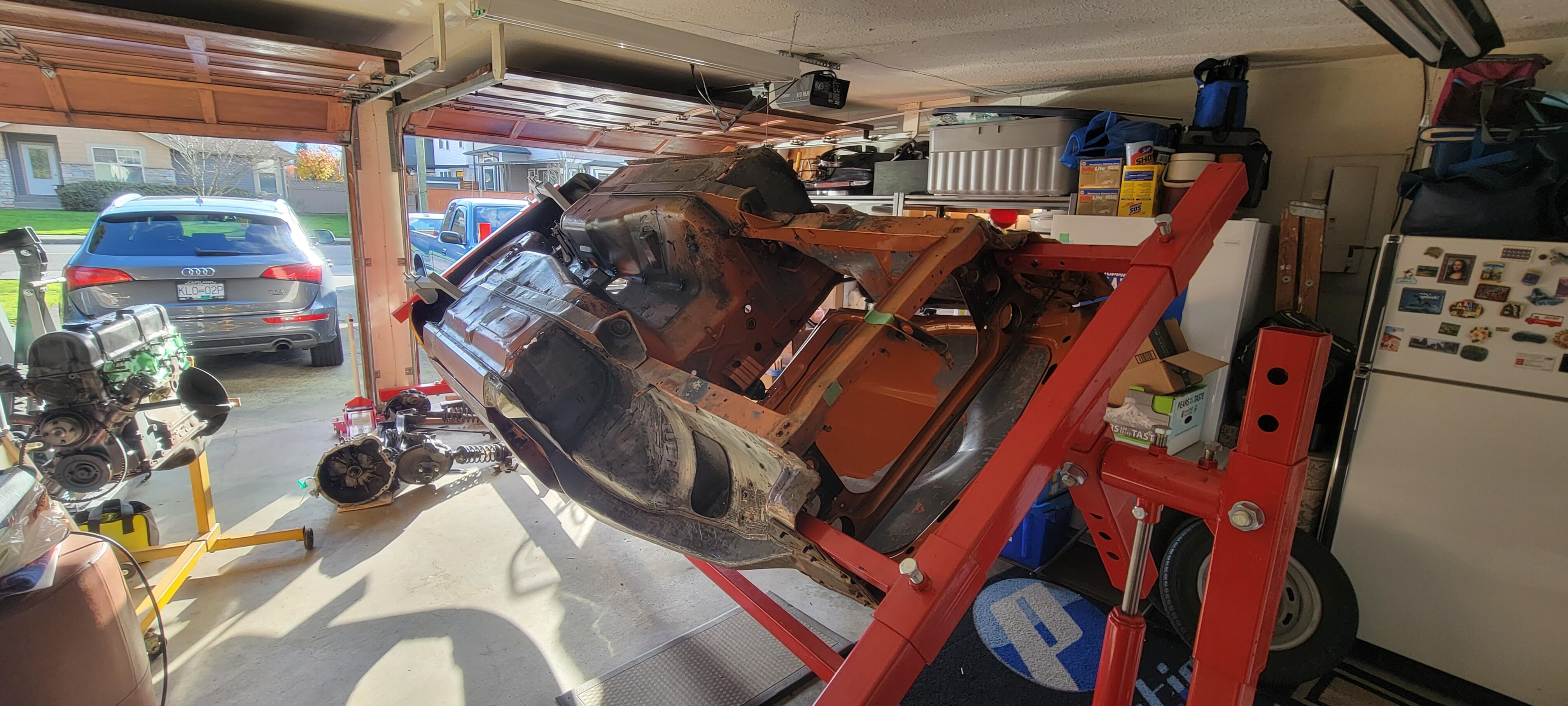

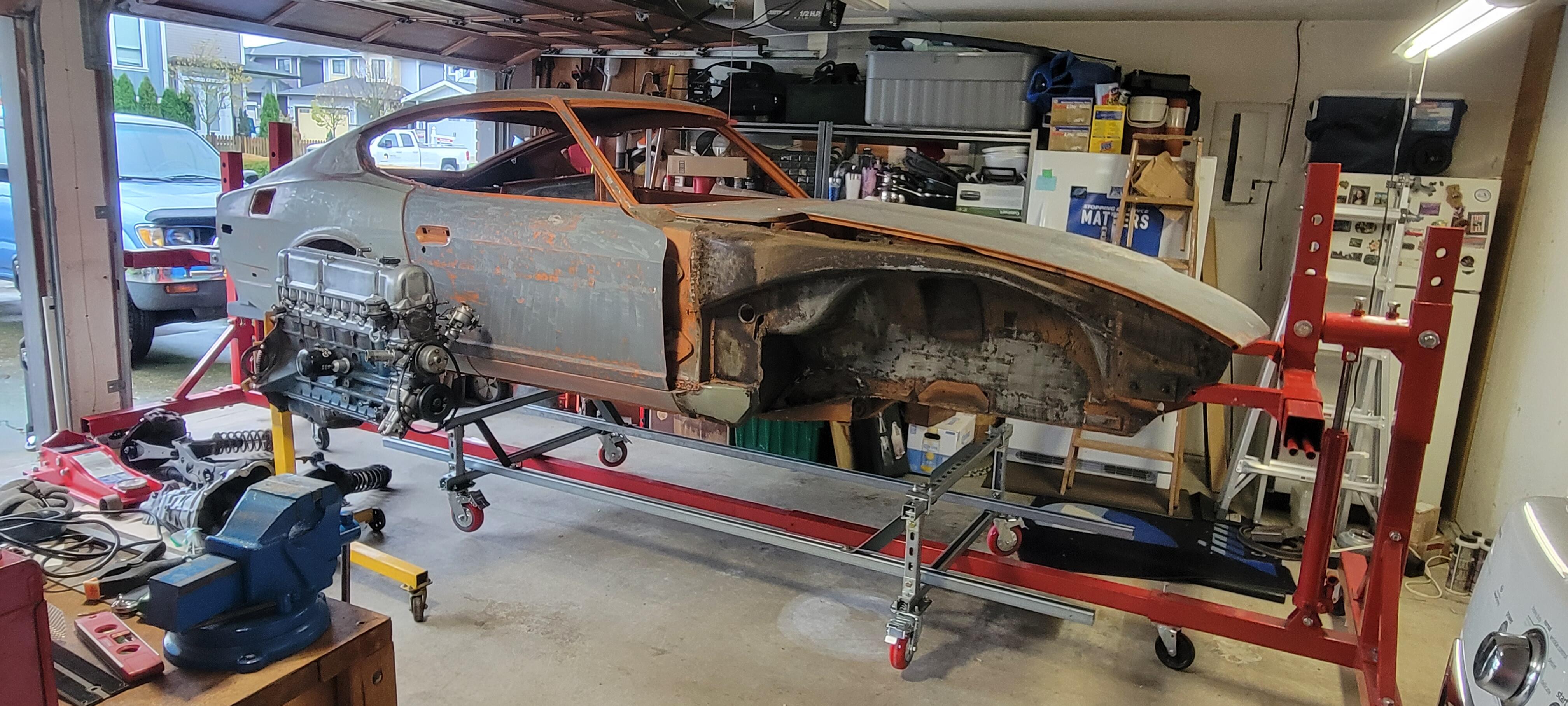

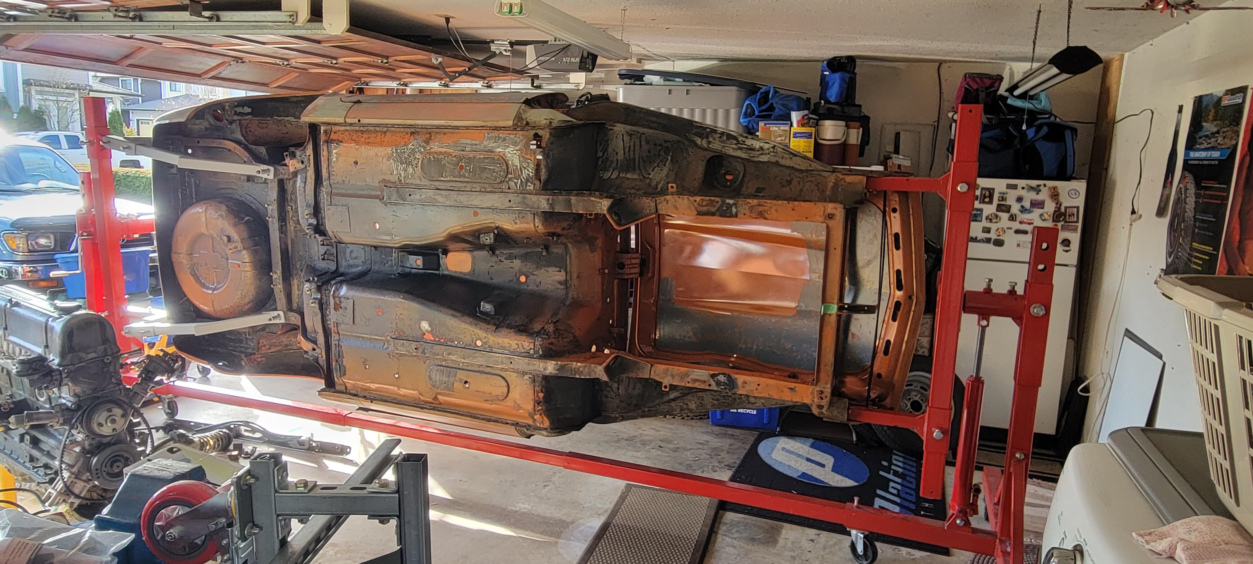

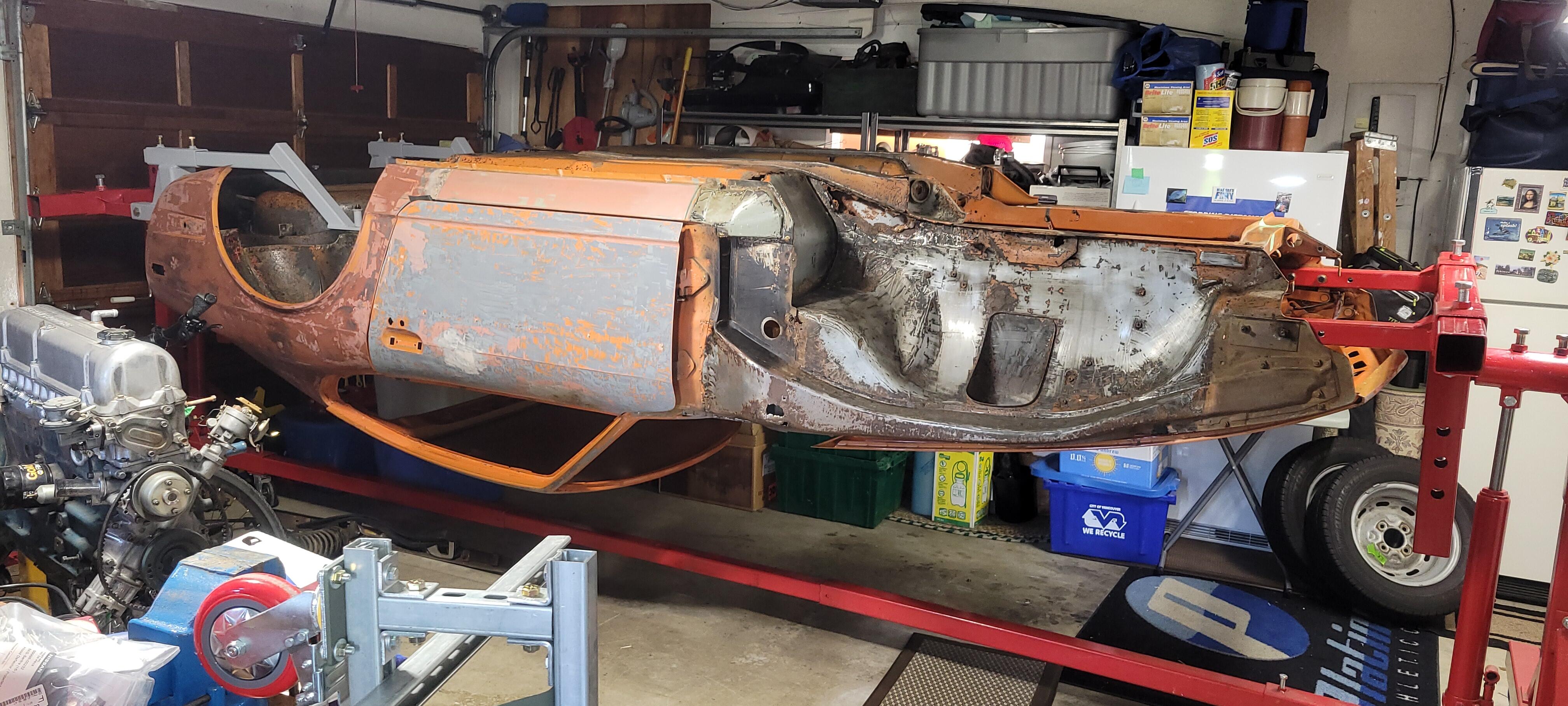

November 5, 20231 yr Author comment_659093 Yesterday, with the help of my son we completed getting the car on the rotisserie. It went very well. Now on to the bigger task of re-organizing my garage. Here's a few pics. Link to comment https://www.classiczcars.com/forums/topic/60693-1970-hls30-06521-re-restoration/?&page=16#findComment-659093 Share on other sites More sharing options...
November 5, 20231 yr comment_659095 Prepare to have your nice clean garage floor covered with sticky undercoat scrapings☺️ Have you spun it yet? Interested to see how your balance between top and bottom worked out. Link to comment https://www.classiczcars.com/forums/topic/60693-1970-hls30-06521-re-restoration/?&page=16#findComment-659095 Share on other sites More sharing options...
November 5, 20231 yr Author Popular Post comment_659096 15 minutes ago, grannyknot said: Prepare to have your nice clean garage floor covered with sticky undercoat scrapings☺️ Have you spun it yet? Interested to see how your balance between top and bottom worked out. Luckily I have already removed most of the undercoating, so hopefully there won't be much mess. As far as rotating it, I've only turned it about 30 degrees with my son holding the door closed. Still need to empty some parts out, like fenders and misc light items. It's been a bit of a storage bin. Also I will need to tie the doors, hood and hatch closed. It will likely be a fee days before I can do the full spin. I will most definitely report back when I get to it. Link to comment https://www.classiczcars.com/forums/topic/60693-1970-hls30-06521-re-restoration/?&page=16#findComment-659096 Share on other sites More sharing options...

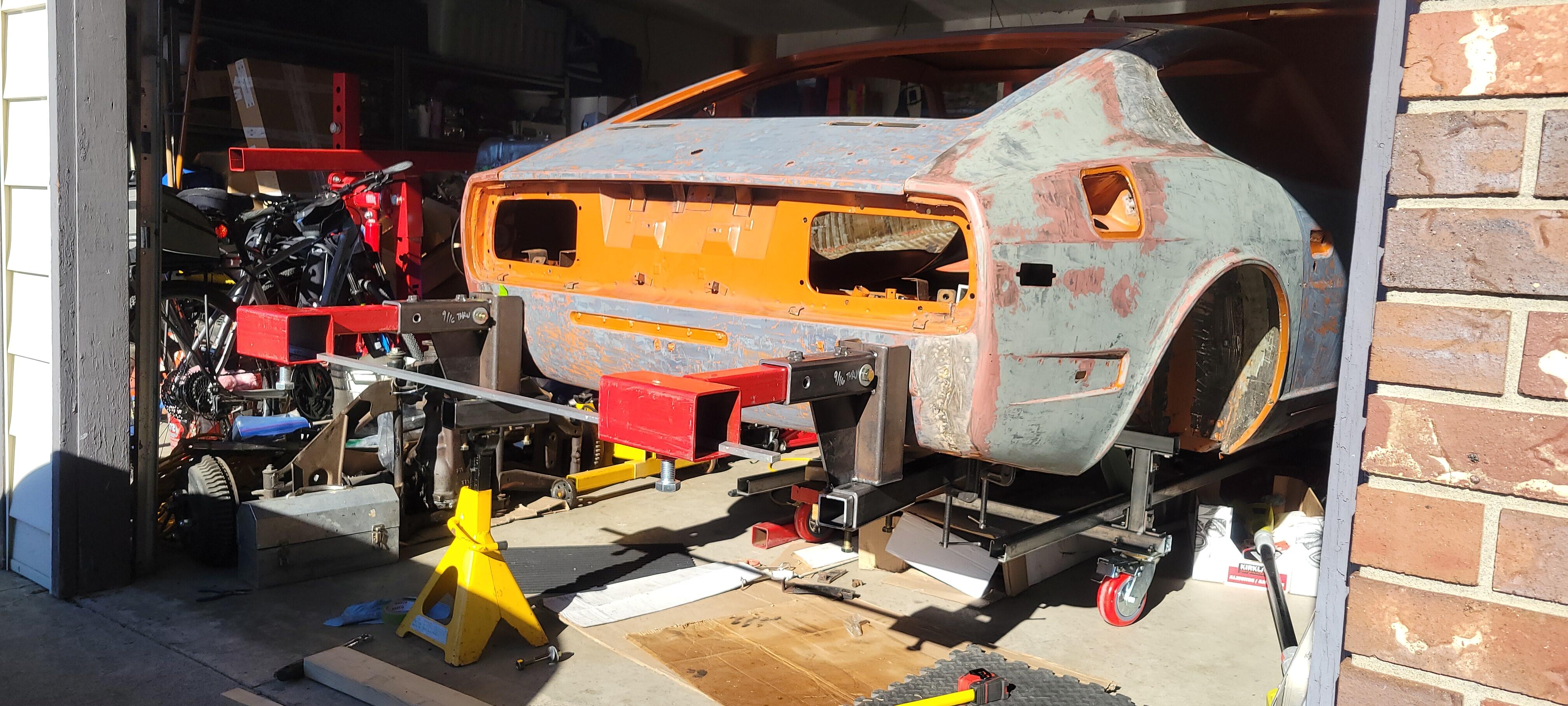

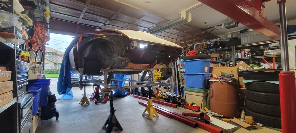

November 8, 20231 yr Author Popular Post comment_659181 I took a break today from work and emptied out the shell and made some room around it to do a test flip. The rotisserie has a worm gear reducer to do the turn, I counted 15 turns of the crank handle to rotate 180. The balance point appears to be quite good with the 5-1/2" drop from the rotation axis to the bumper mounts suggested by @grannyknot, thanks for that info. Although this is a bit subjective, as the 30:1 reducer makes it a little hard to judge. Here are a few pics and a short video. Link to comment https://www.classiczcars.com/forums/topic/60693-1970-hls30-06521-re-restoration/?&page=16#findComment-659181 Share on other sites More sharing options...
November 8, 20231 yr comment_659189 That 5.5" was with the hatch, hood and doors removed and I was free wheeling the spin, yours is probably bit top heavy but not a problem as the gears are taking the weight. Looks great. Link to comment https://www.classiczcars.com/forums/topic/60693-1970-hls30-06521-re-restoration/?&page=16#findComment-659189 Share on other sites More sharing options...
November 8, 20231 yr Author comment_659192 2 hours ago, grannyknot said: That 5.5" was with the hatch, hood and doors removed and I was free wheeling the spin, yours is probably bit top heavy but not a problem as the gears are taking the weight. Looks great. Thanks, and I totally agree that it will be more balanced with those items removed. They will come off eventually, just doesn't make sense for me to do it with the limited space I have. Link to comment https://www.classiczcars.com/forums/topic/60693-1970-hls30-06521-re-restoration/?&page=16#findComment-659192 Share on other sites More sharing options...
