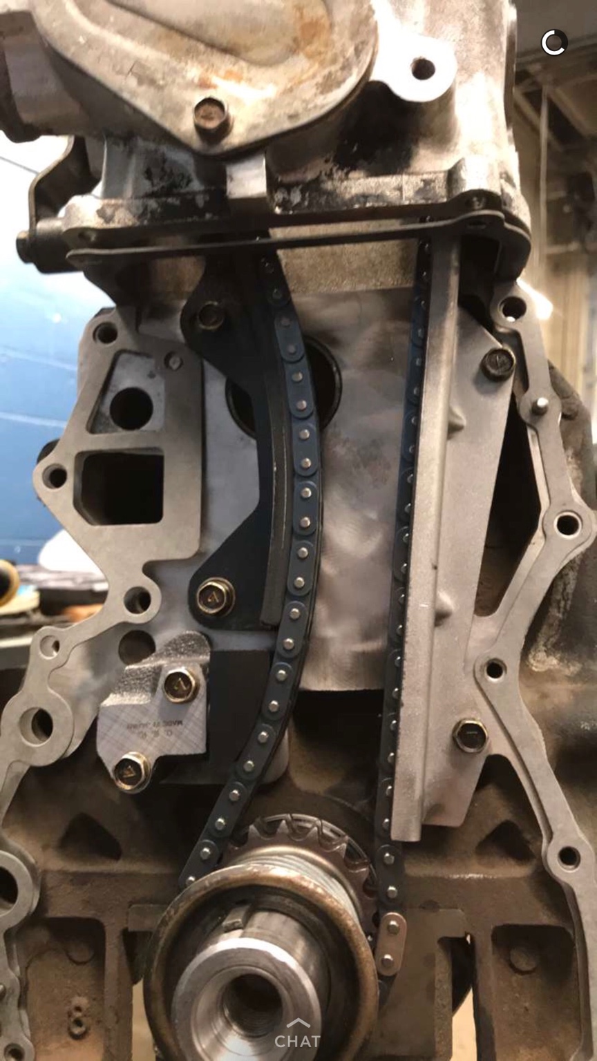

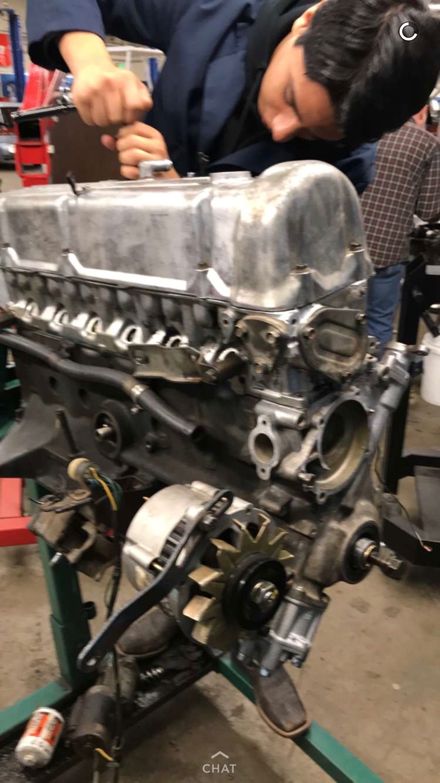

I parked my z for about a month after rebuilding the engine and driving it to school for about two months. I daily a different car to go to work to save on gas, and when I went to start my car it was dead because I left the radar on. I jump started my car with the daily driven car. But as it charged up enough to start and run, I let it sit for about 15 min. I started to drive it and when the rpms were up and I would let off the gas, the car turns off. I don’t know what the problem would be. (Pictures of rebuild)Image1532991631.815833.thumb.jpg.8a93489f8dac57248c3972ec4845c0f8.jpgImage1532991694.508865.thumb.jpg.72b691800cf924ded705a653d1b3bbfa.jpgIMG_2063.thumb.JPG.a2de35f5191e67830eeefb4b3acb0808.JPG

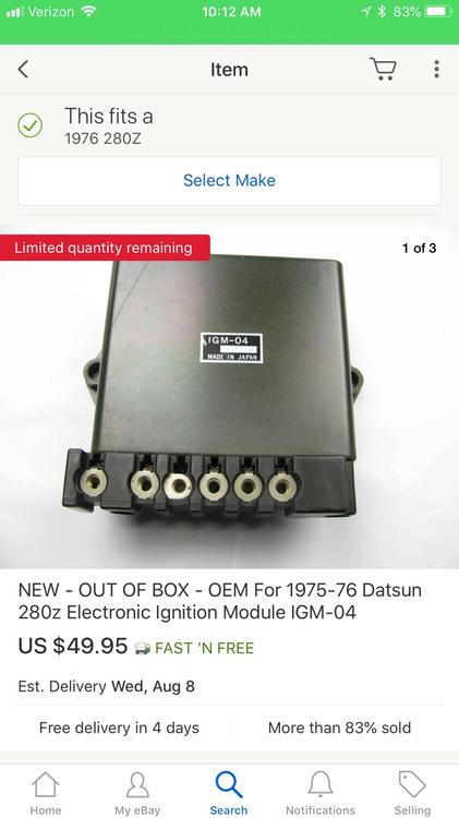

That sounds very much like mine when the ignition module was dying.  After it did what you describe you could let it sit for a few seconds and it would restart.  It would run fine if you kept it below about 3000 RPM.  But if you revved it, it would do the same thing.  The tach needle action is a big clue.
That's the California model, for single pickup distributors.  It might work but you'll lose one pickup.
But I've never heard of IGM-4.  It might not be a Nissan part.  Looks like a risky bet.
Their eBay store sells a lot of parts though and their ratings aren't too bad.
https://www.ebay.com/usr/spark-surplus
https://www.ebay.com/itm/NEW-OUT-OF-BOX-OEM-For-1975-76-Datsun-280z-Electronic-Ignition-Module-IGM-04-/182015405068?oid=182824115436
Edited by Zed Head
I have a CA car (single pickup) got that module off ebay, think it was the same dealer as the price looks like what I paid. Works fine. A swapped it for the OE one (that was working) just to make sure it worked, kept the OE as a spare.
Wdym by “pickup” , would it have a negative effect on the car?like what am I losing exactly?.
