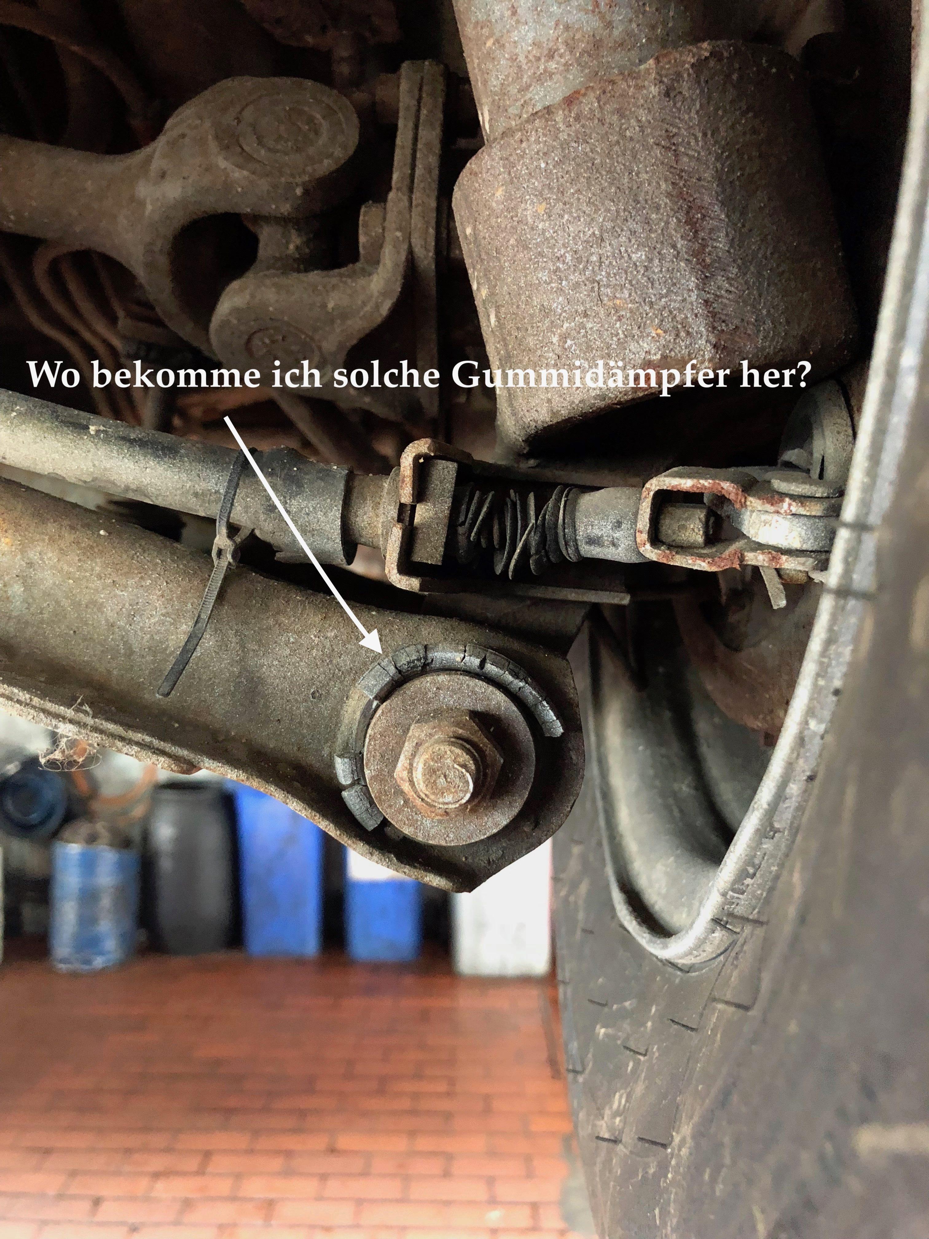

I amsearching for rubbers of the front and backaxle (see attachment). Where can I buy them= What is the partnumber of tese rubbers?
We call those bushings, or bushes.  Here is a web site that will have the part numbers.  You can search the part number on the internet and find many places that might have them.  You'll have to remove the spindle pin to get the control arm (transverse link) removed in order to replace them.  It can be difficult.
Wilkommen to the site.  Forgot to say that the part you're pointing at is just an outer flange of the main bushing.  There's a steel shell around a cylindrical bushing assembly that is pressed in to the control arm.

I believe it's #69 on the rear suspension page
55542-E4100
Available directly from Nissan $2.25 each. They are rubber flat washers that go under the metal washer and locknut to seal water out of the spindle pins. There are also control arm bushings further under there that are also available new from Nissan

Do you have a link direct to the shop and product? Are the rubbers in front and back the same?
Greatings Mark
By rubbers do you mean the bushings that support the car or the rubbers seals from your first picture? In any case they are not the same front and rear.
Since you're in Germany your best bet is to search for the part number I posted and see which one is cheapest with shipping and VAT included...
