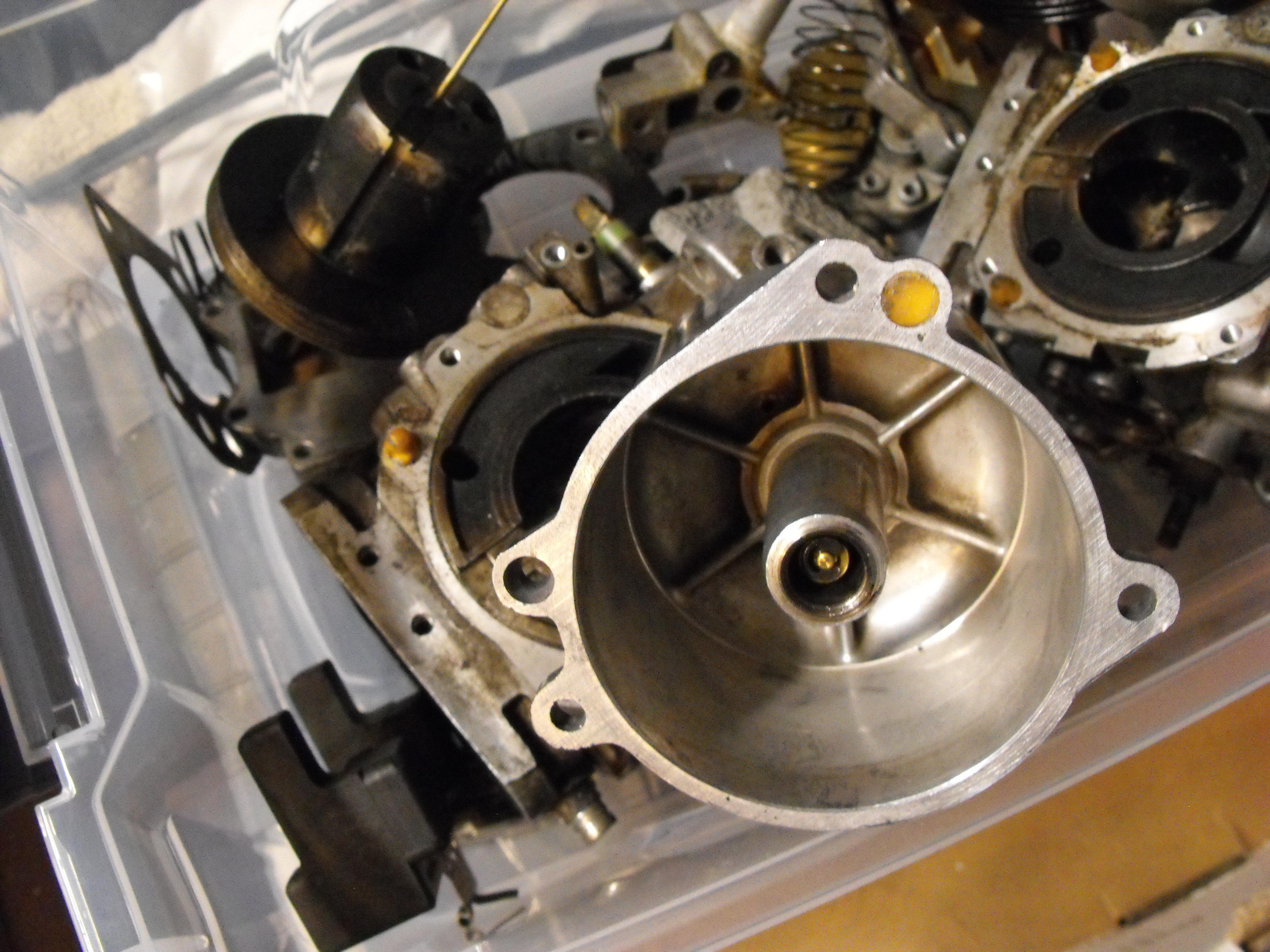

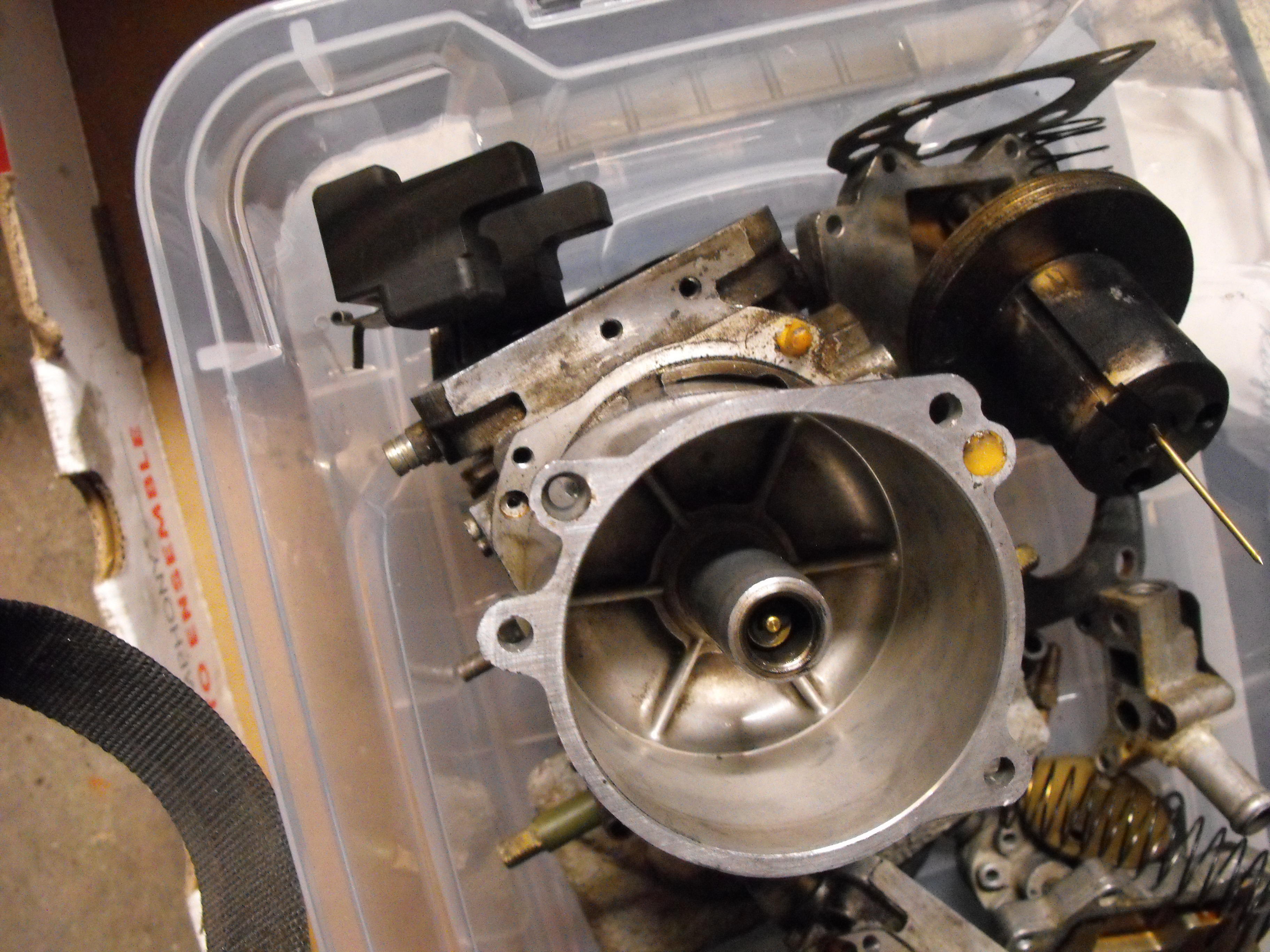

I did a quick clean and polish of one of the vacuum chambers.  They clean up well.

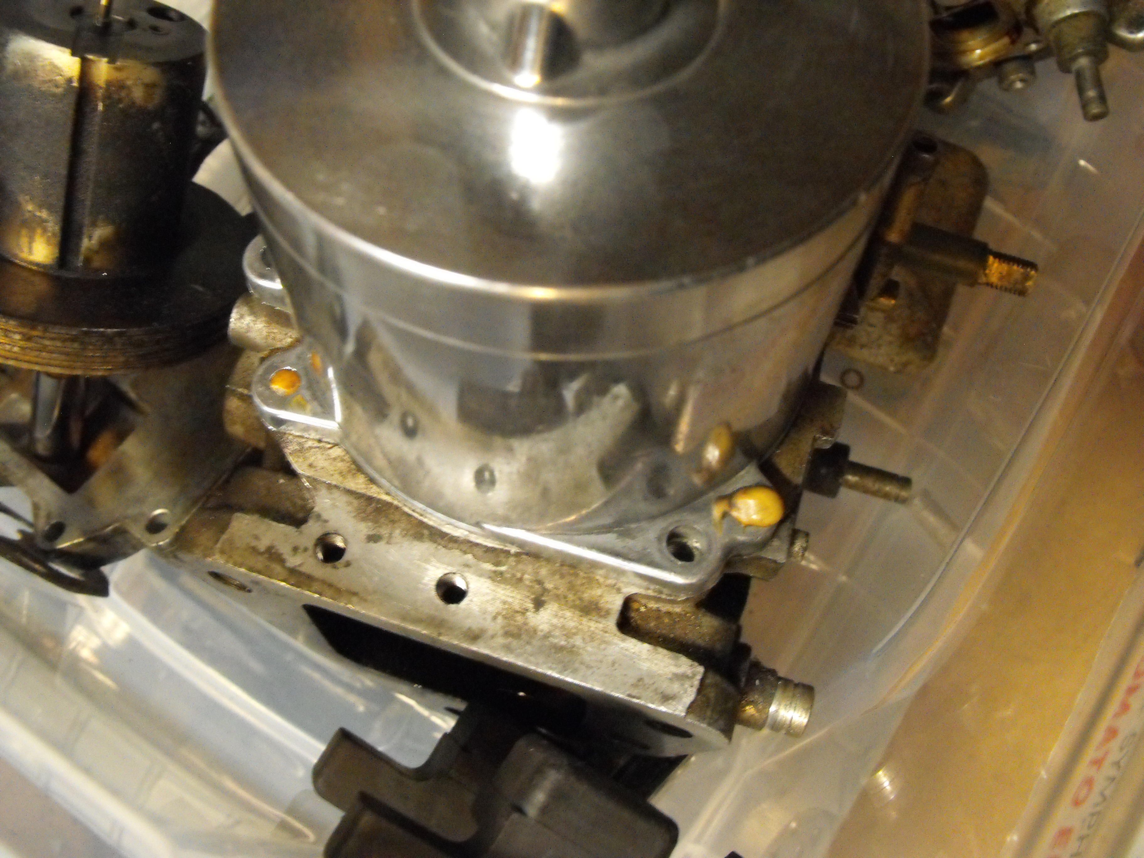

And last... Too bad about the broken alignment cone on the suction piston cover below. Is that a test piece just for clean-up and polish, or is that one that you were going to use on the final product?

Aaahhh, I see what you are saying about the cones.  Yes, these are the two I plan on using.  On the one carb, both of the plastic alignment nubs are on the base.  On the other carb, one cone is stuck inthe vacuum chamber.
EDIT: sorry about the bad pics.  the vac chamber flange is hiding the base area where the cone is displaced.

Well to be clear... Your alignment nub has cracked in half and only HALF the nub is stuck in the chamber cover.  LOL   The other half is usually still stuck in the carb body, but in your case, it has fallen out somewhere along the way and years. Unfortunate, but not insurmountable.
Those two cones provide very accurate alignment of the chamber cover with respect to the center bore where the piston slides up and down and where the needle slides into the nozzle. If that cover is out of alignment, the needle will rub the side of the nozzle hole and wear something (needle, nozzle, or both). You can usually get it aligned relatively well just by feel, especially since you still have one good nubbin. But if you were insane and had too much time on your hands, you would make an alignment tool that would be used to fixture everything in proper alignment and use some epoxy to cast a new alignment nub to replace the broken one. A feat I have not yet needed to resort to.

For the needle alignment, I would think the one nub and three screws would get me pretty close...but probably not perfect, Depending on the screw and tab hole tolerance. Interesting that the bottom part of the one nub is missing.

Agreed. (Without the suction piston installed) Put the cover on and put the three screws in but leave them loose enough that the cover can still rotate around the one existing cone nub. See how much play there is. Might be such that with the tolerance of the mounting screws combined with the single nub there might be very little play to worry about.
But if you do get energetic... I think all you would need is a steel rod with one end turned to be a precision fit into the hole through the suction piston cover, and the other end turned to be a precision fit into the carb body where the nozzle is installed. Remove the nozzle and then slip the rod into place and then put the chamnber cover on. The precision rod will align all the holes on the same centerline. Put the three screws loosely into place and then use a small syringe to inject epoxy into the alignment nub cavity to cast a new pin in place.
I wasn't there at the factory, but I've got a high degree of confidence they did something like that at the factory. You can even see the bubbles in the epoxy material in some of the pins where they didn't get all the air out. That looks like what happened to the intact pin on this body. Looks like a big air inclusion in the epoxy cone:

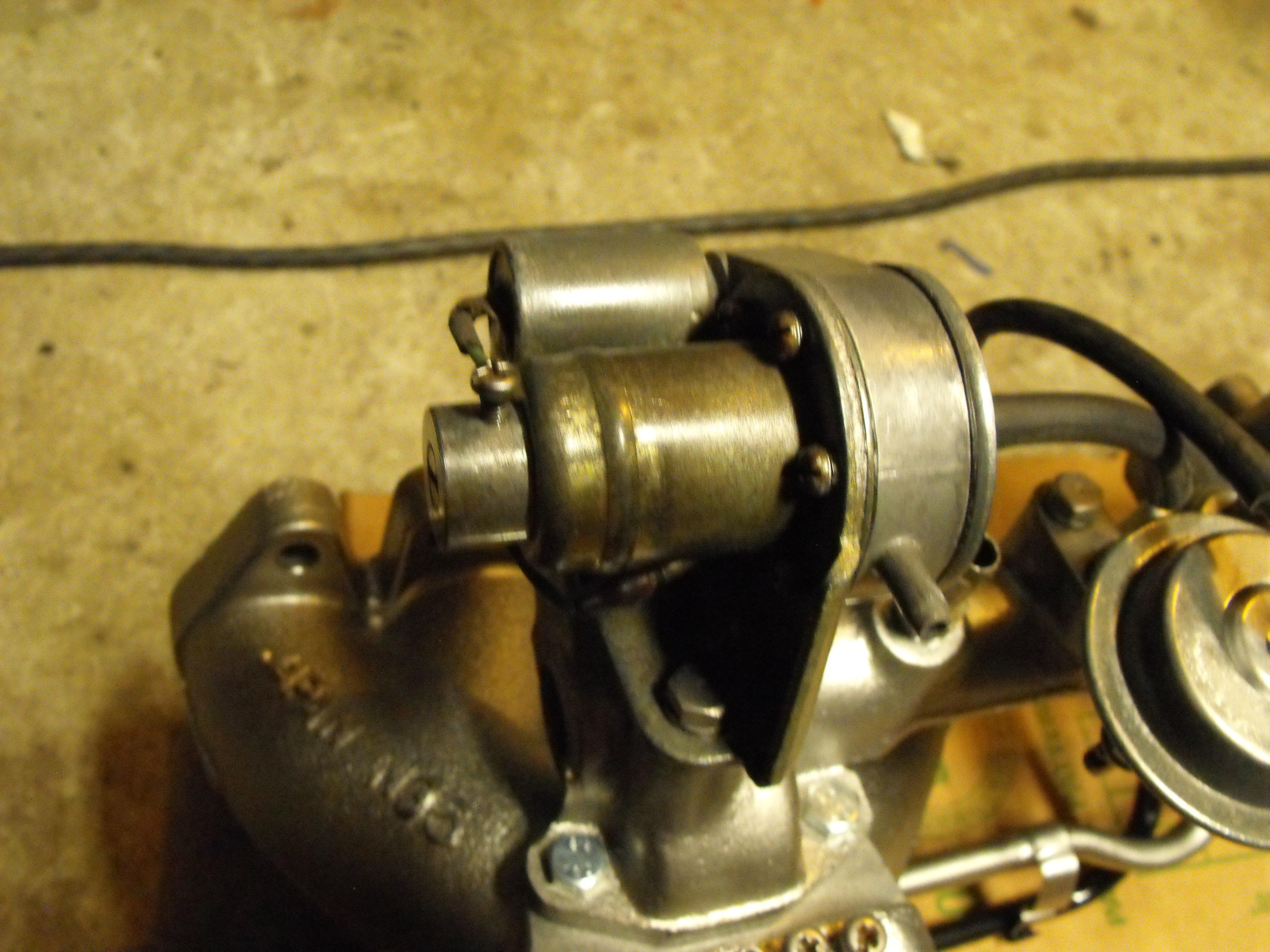

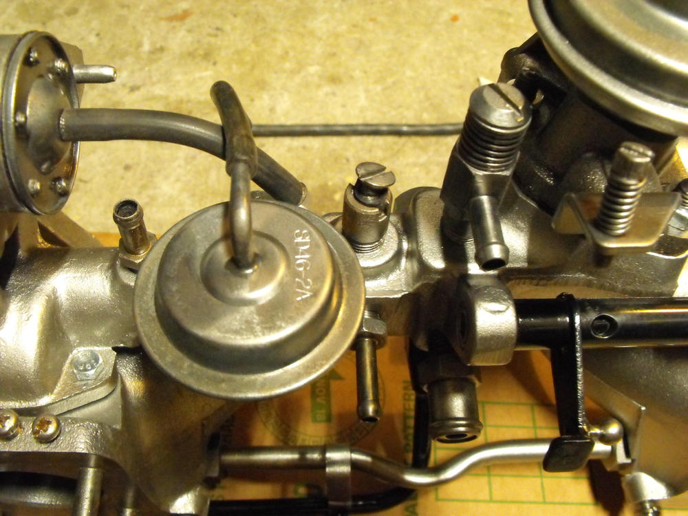

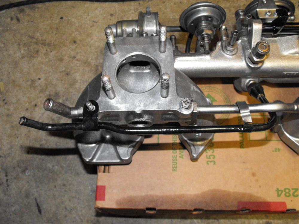

Got a 260 intake manifold off of eBay in today.  It has several common parts that I am missing and seems to be in nice shape. Paint will need to be removed.
