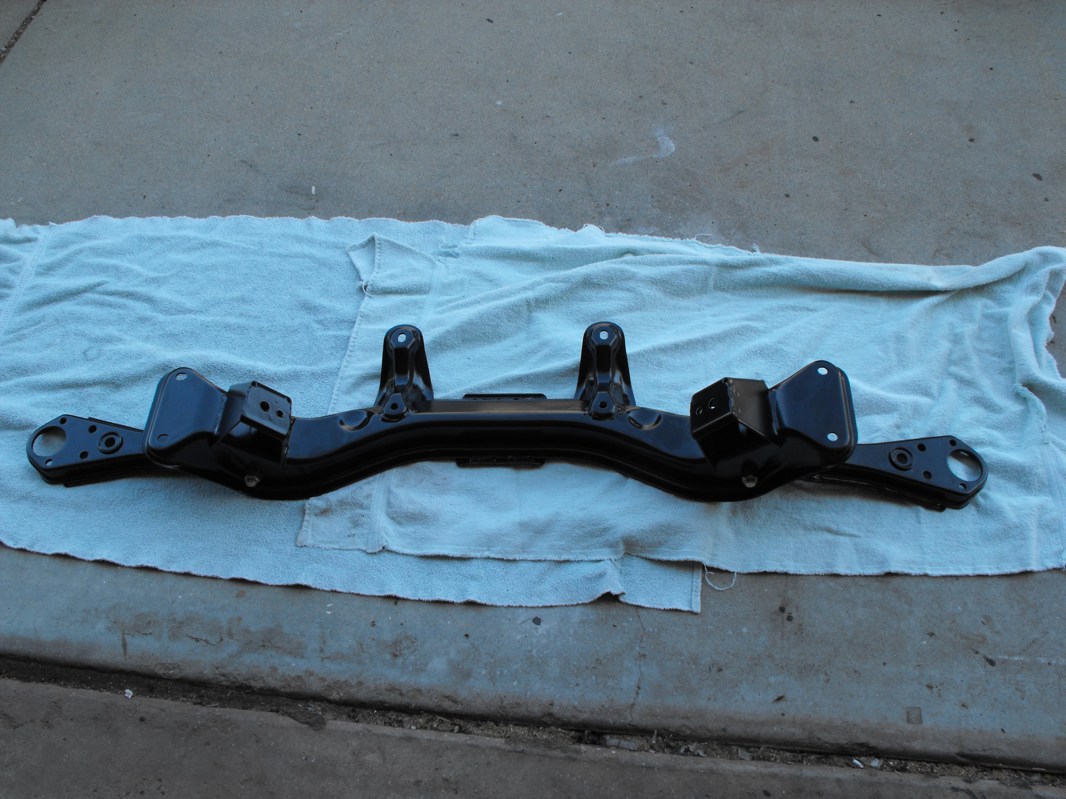

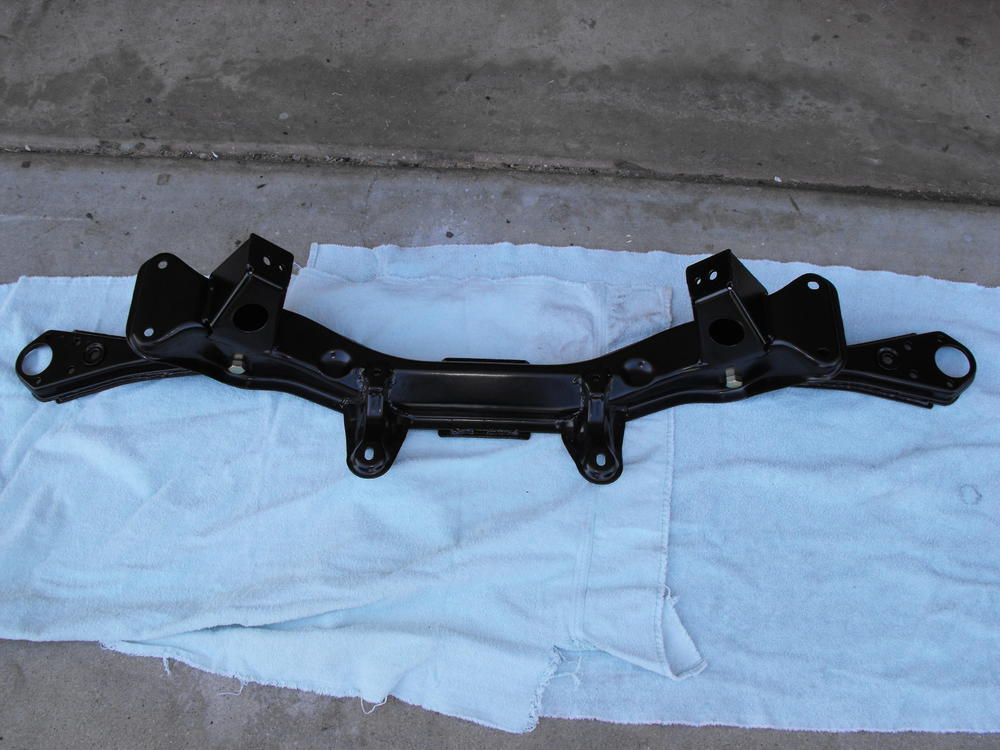

September 29, 20186 yr Author comment_558509 More suspension pics Link to comment https://www.classiczcars.com/forums/topic/60309-were-bringin-back-the-flat-tops/?&page=11#findComment-558509 Share on other sites More sharing options...

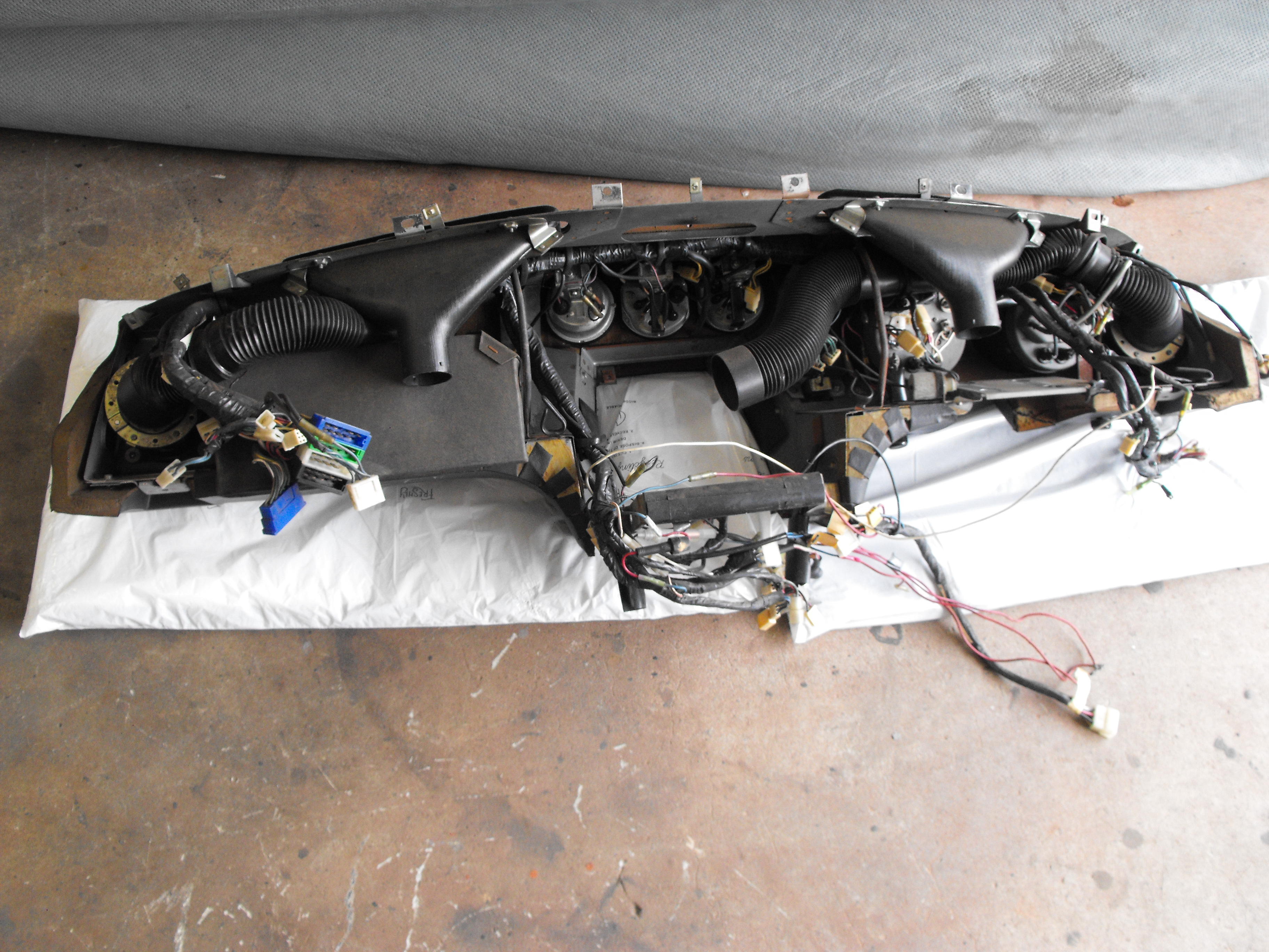

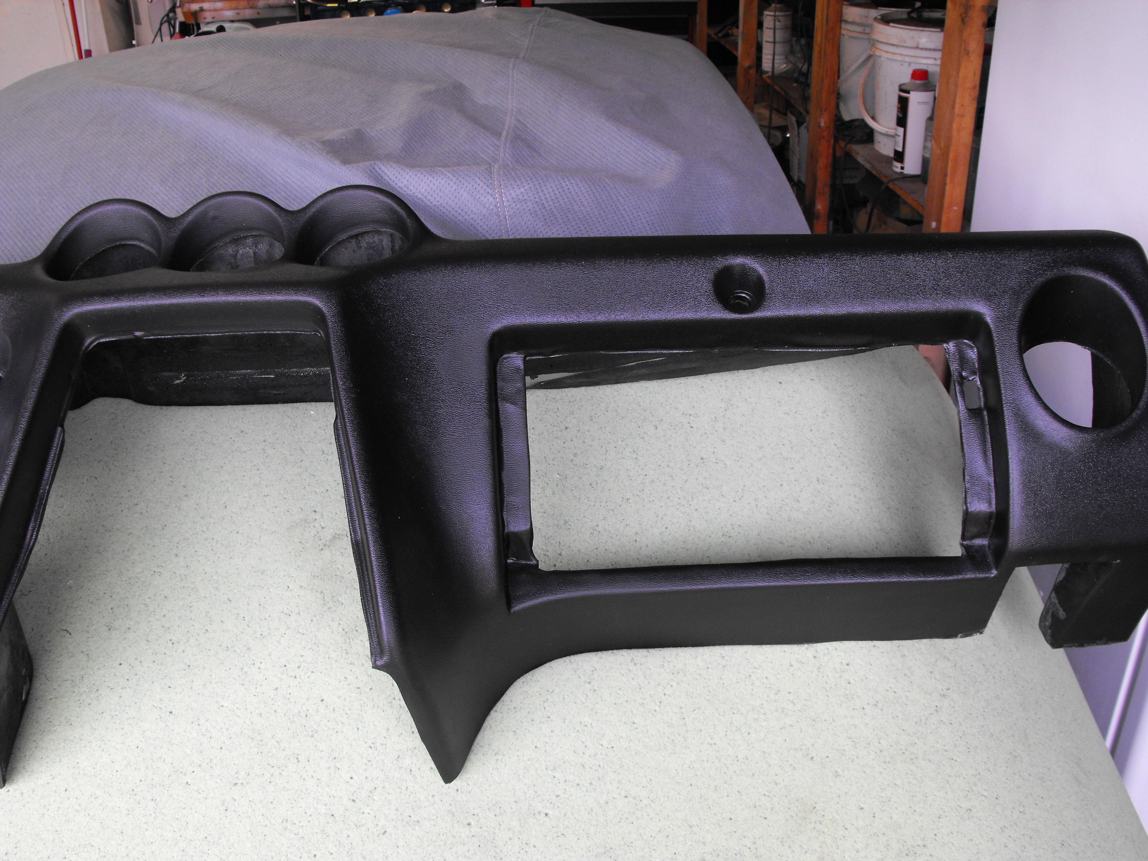

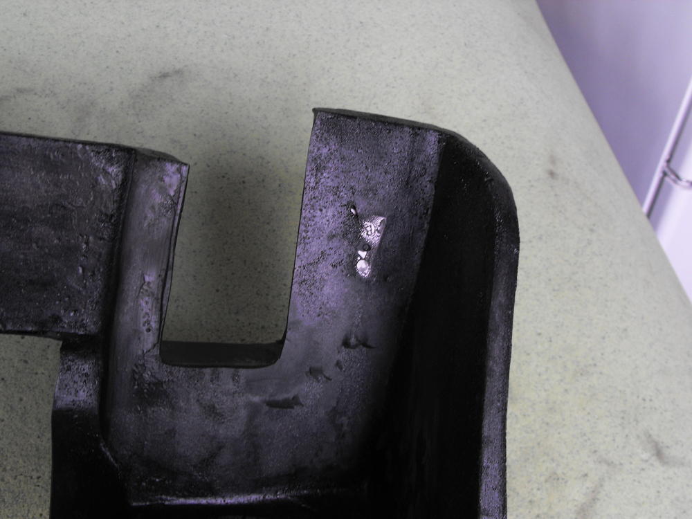

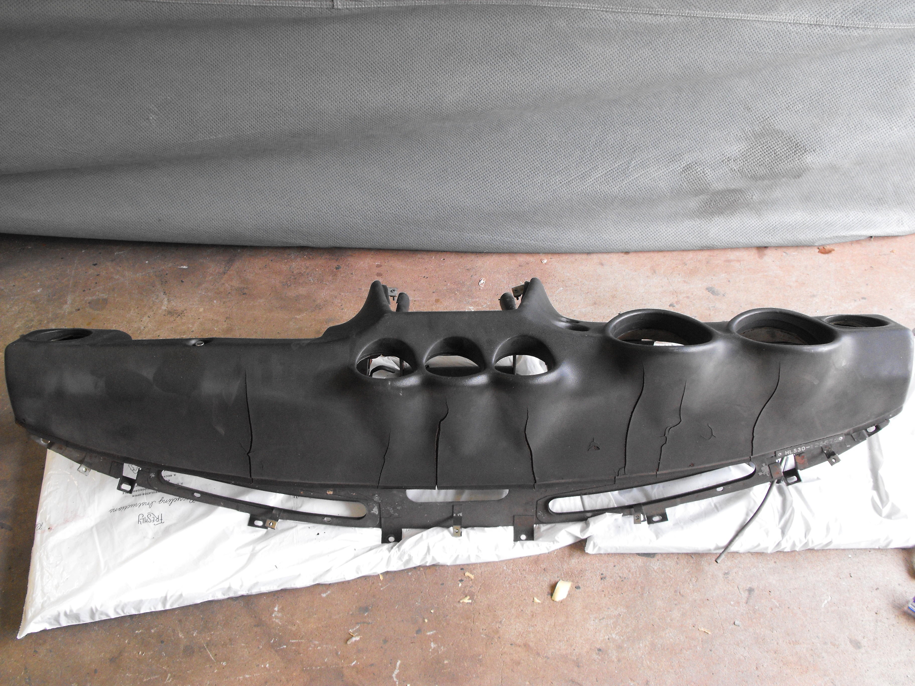

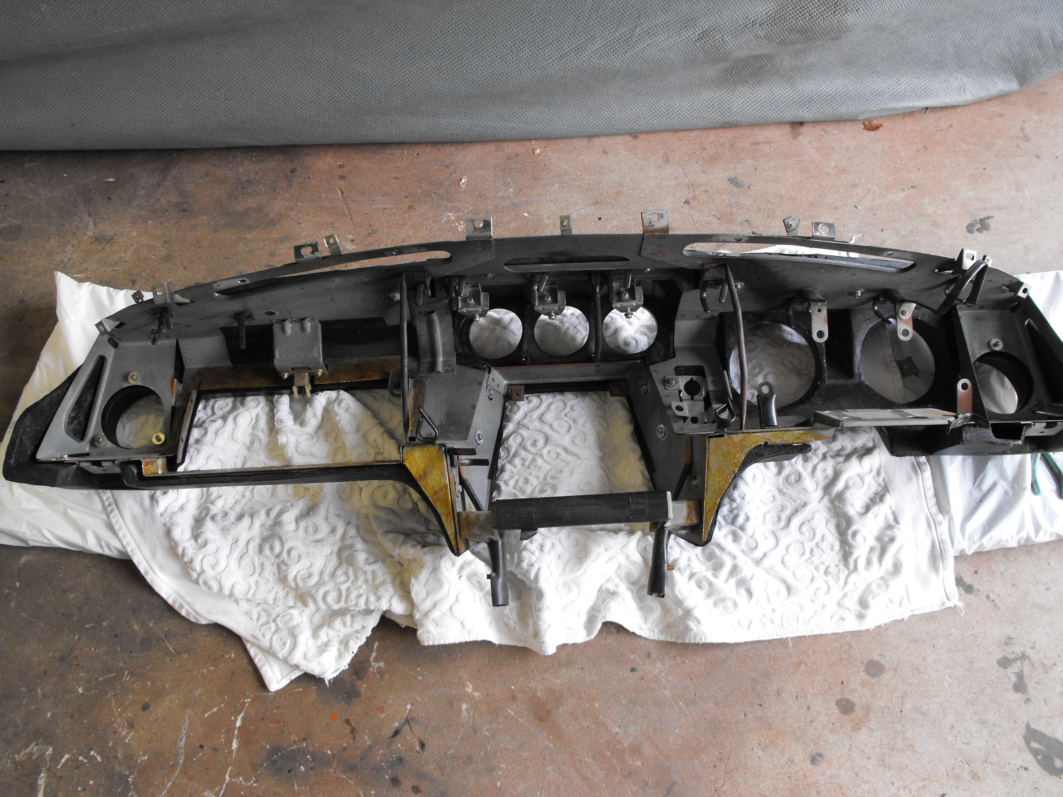

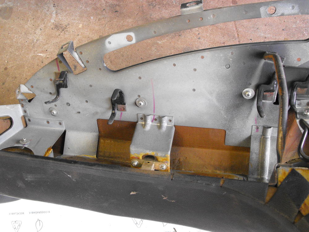

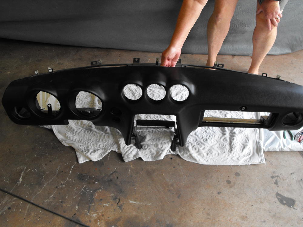

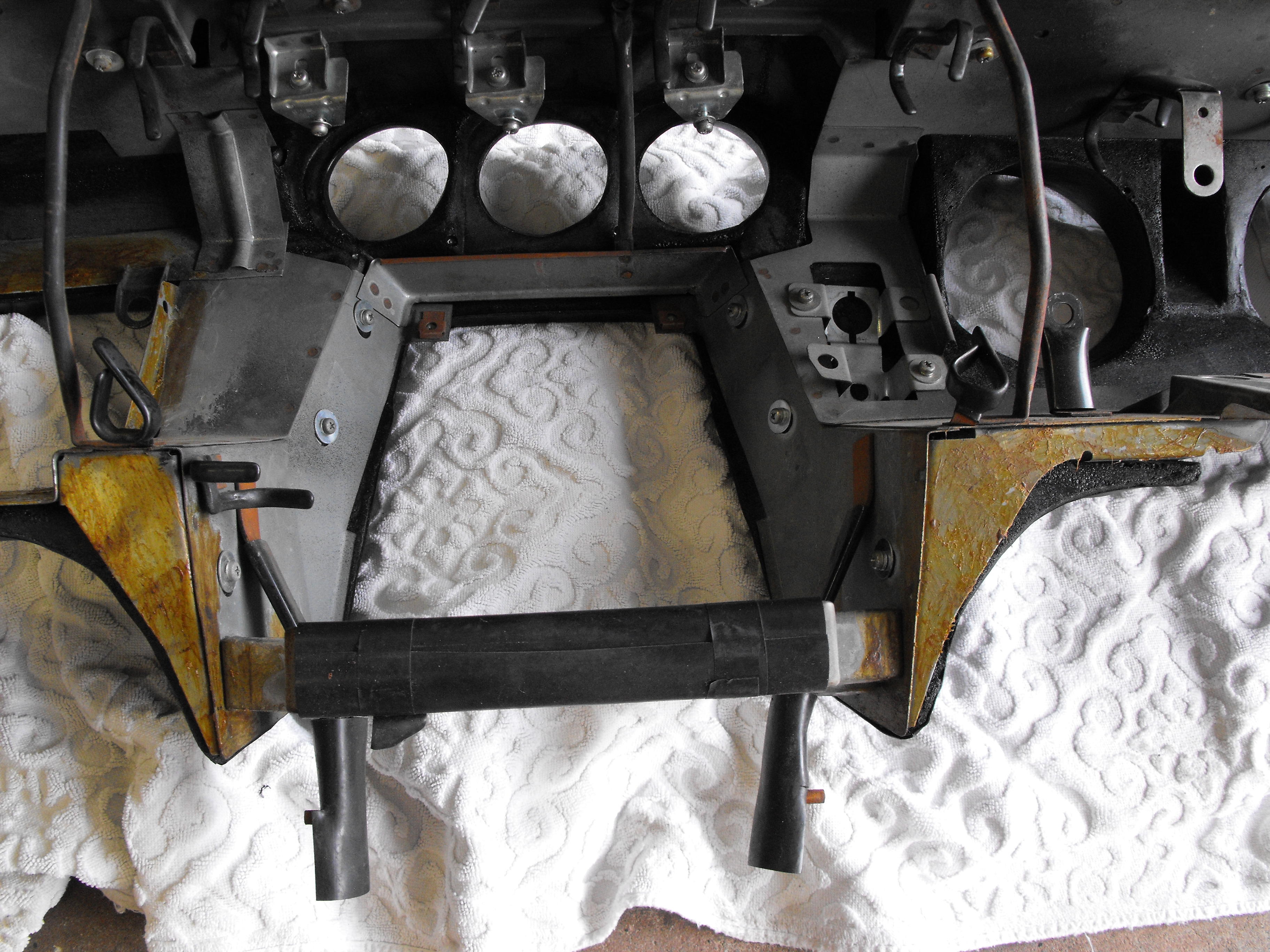

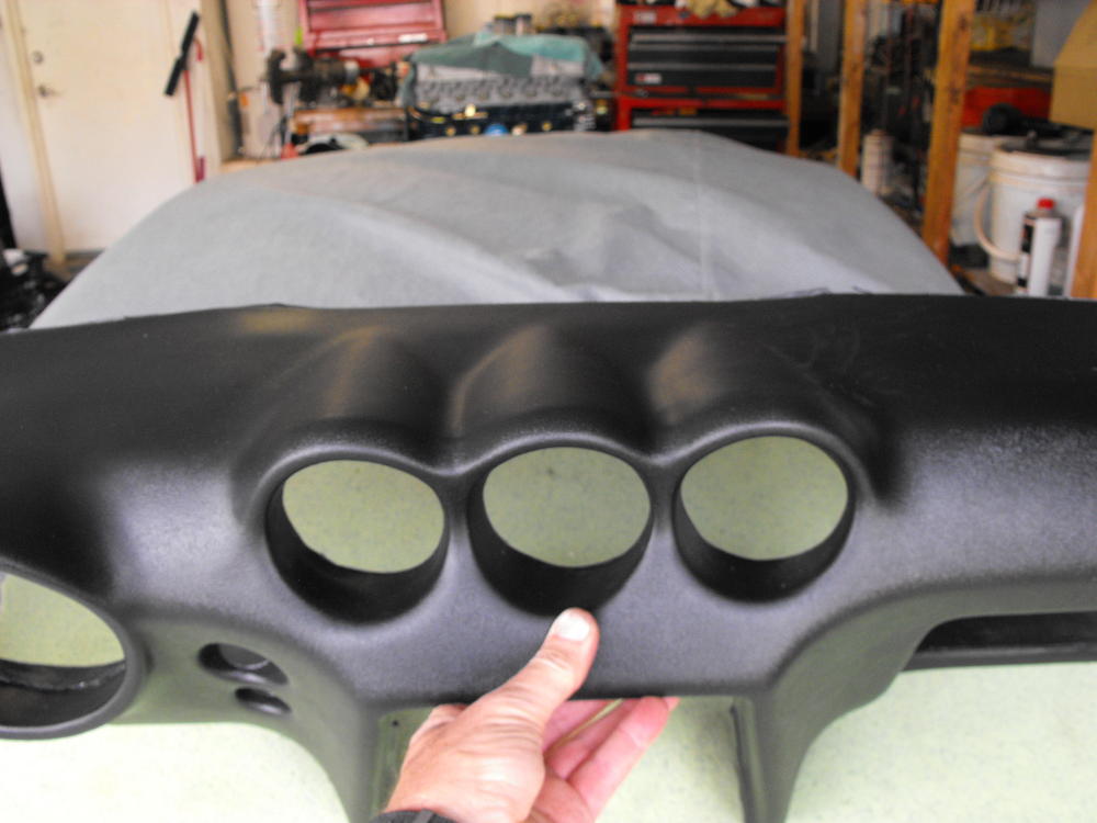

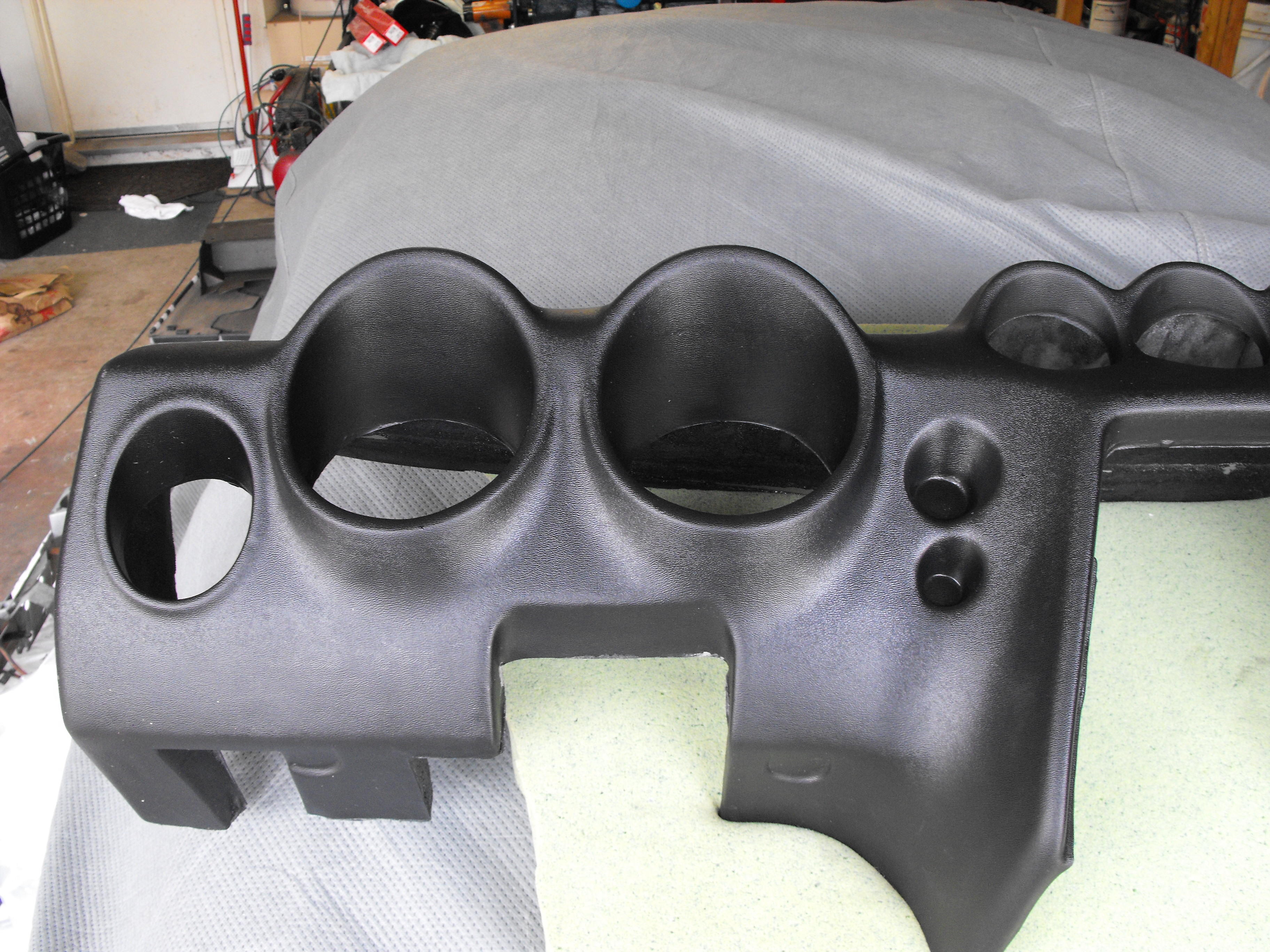

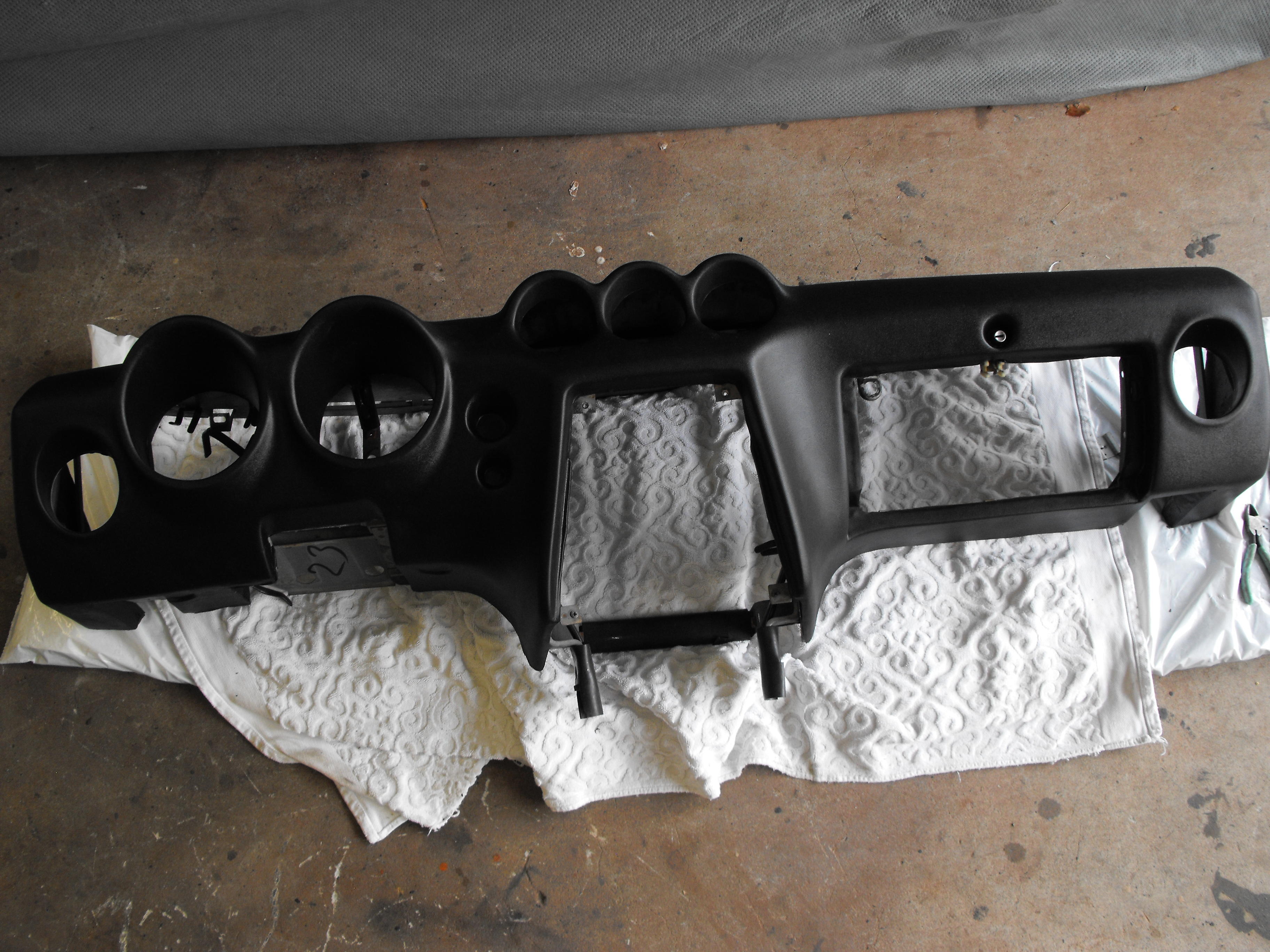

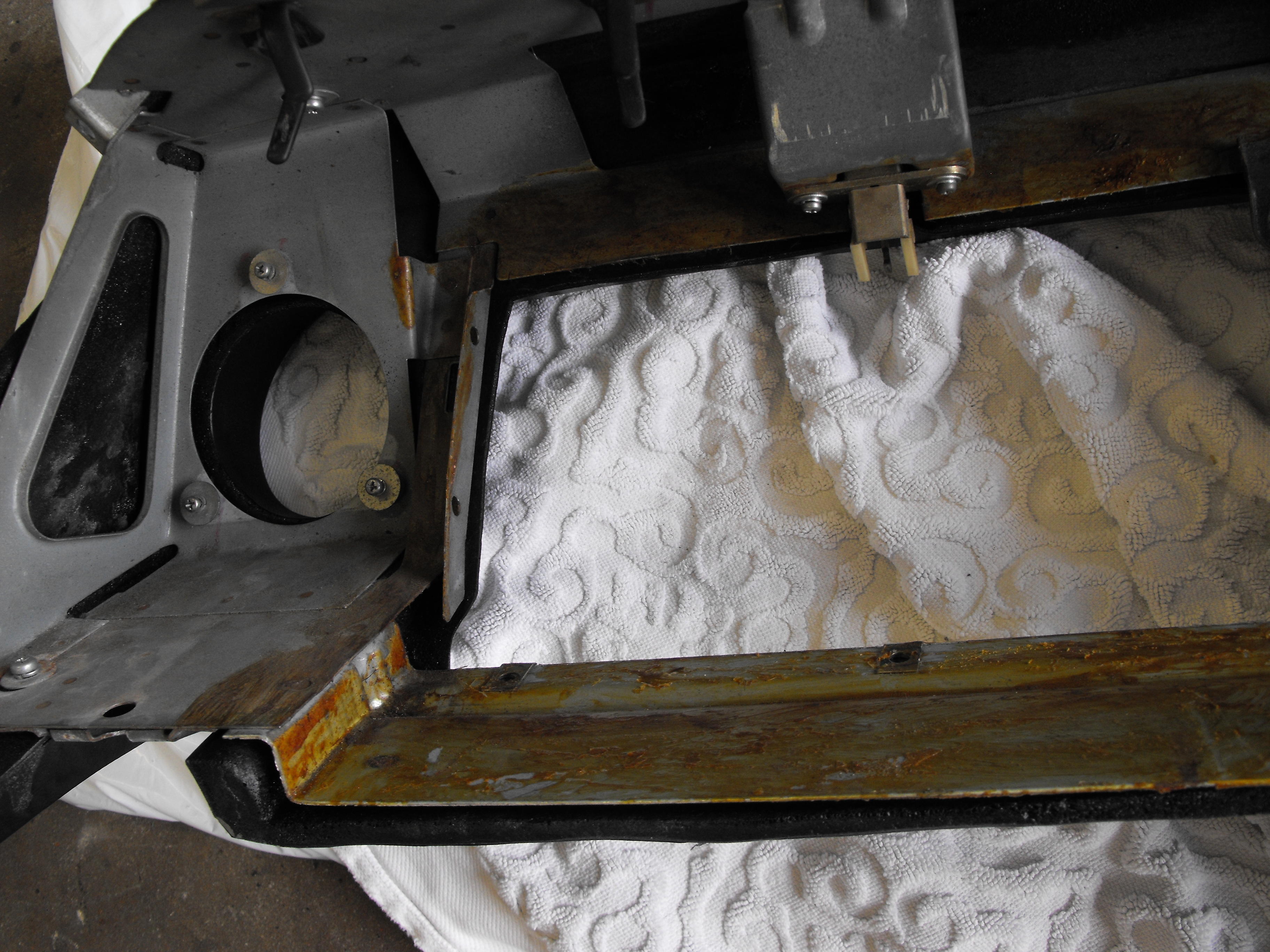

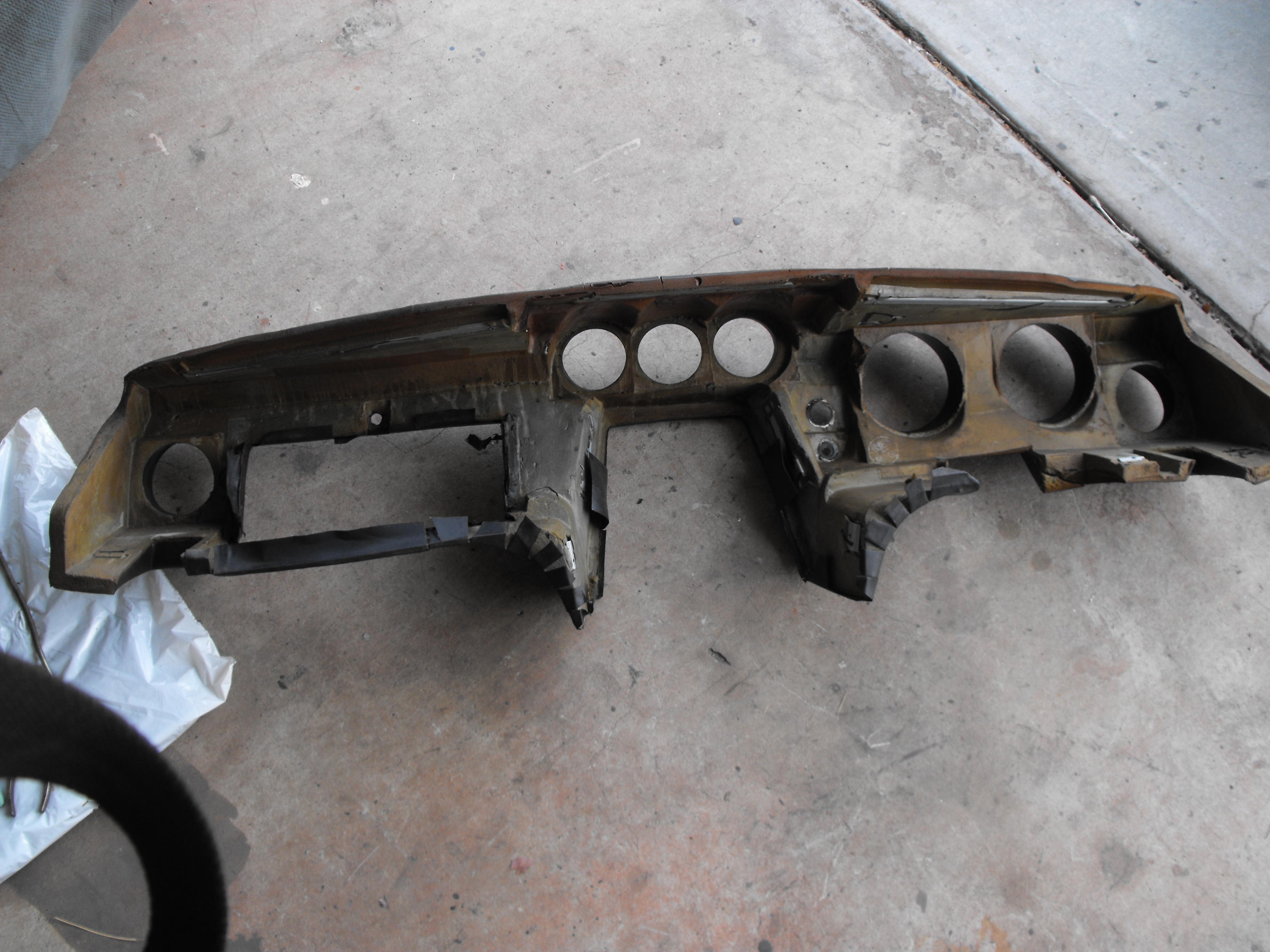

October 1, 20186 yr Author comment_558574 Today I installed the 'Vintage Dash' 240Z dash onto the dash frame. This is a first time install for me and it seemed to go fairly well. Removing all the instruments and wiring, removing the old dash and installing the new dash took less than 3 hours. It is was not too difficult. In regards to the fit, the dash fit very well on the frame. It was a bit snug and required exerting some force to hold the dash to the frame while screwing things together, but that is the way it should be. The holes in the dash lined up well with the frame and I had no issues. I would however, recommend clearing the dash screw holes before putting the dash over the frame. The holes can be a bit hard to locate if you try to find them when you have the dash over the frame. I was very tempted to use some spray adhesive, but there was not any on the original (except near the glove box) so I went without glue. The look and fit are very good. I like the shape of the dash over the water, oil and clock instruments and the texture is reasonable. It still does not match the original, but does look very good. The only negative comment I have about the dash is that they should have left flaps around the glove box and the heater cutout similar to the original. Neither of these areas is visible until you open the glove box, then you will see that the dash flaps do not go over the glove box stiffening rails. What I will probably do here is spray the flanges black and put some black silicon in the gap between the dash and the flange. That way the missing flaps will not be so obvious. Otherwise, the dash looks great. I will post about the instrument fit when I get to that step. The cost here is about half the cost of 'Just Dashes' and the appearance is great. I would also say that it is  easier to install the 'Vintage Dashes' dash than it is to package up your dash and ship it to 'Just Dashes'. Pics are below. Also, I am guessing that @jayhawkhad some work done on his Tachometer or someone in Japan is Psychic Link to comment https://www.classiczcars.com/forums/topic/60309-were-bringin-back-the-flat-tops/?&page=11#findComment-558574 Share on other sites More sharing options...
October 1, 20186 yr comment_558597 So far that new dash looks fantastic. Looking forward to getting all the gauges and other stuff installed. Link to comment https://www.classiczcars.com/forums/topic/60309-were-bringin-back-the-flat-tops/?&page=11#findComment-558597 Share on other sites More sharing options...

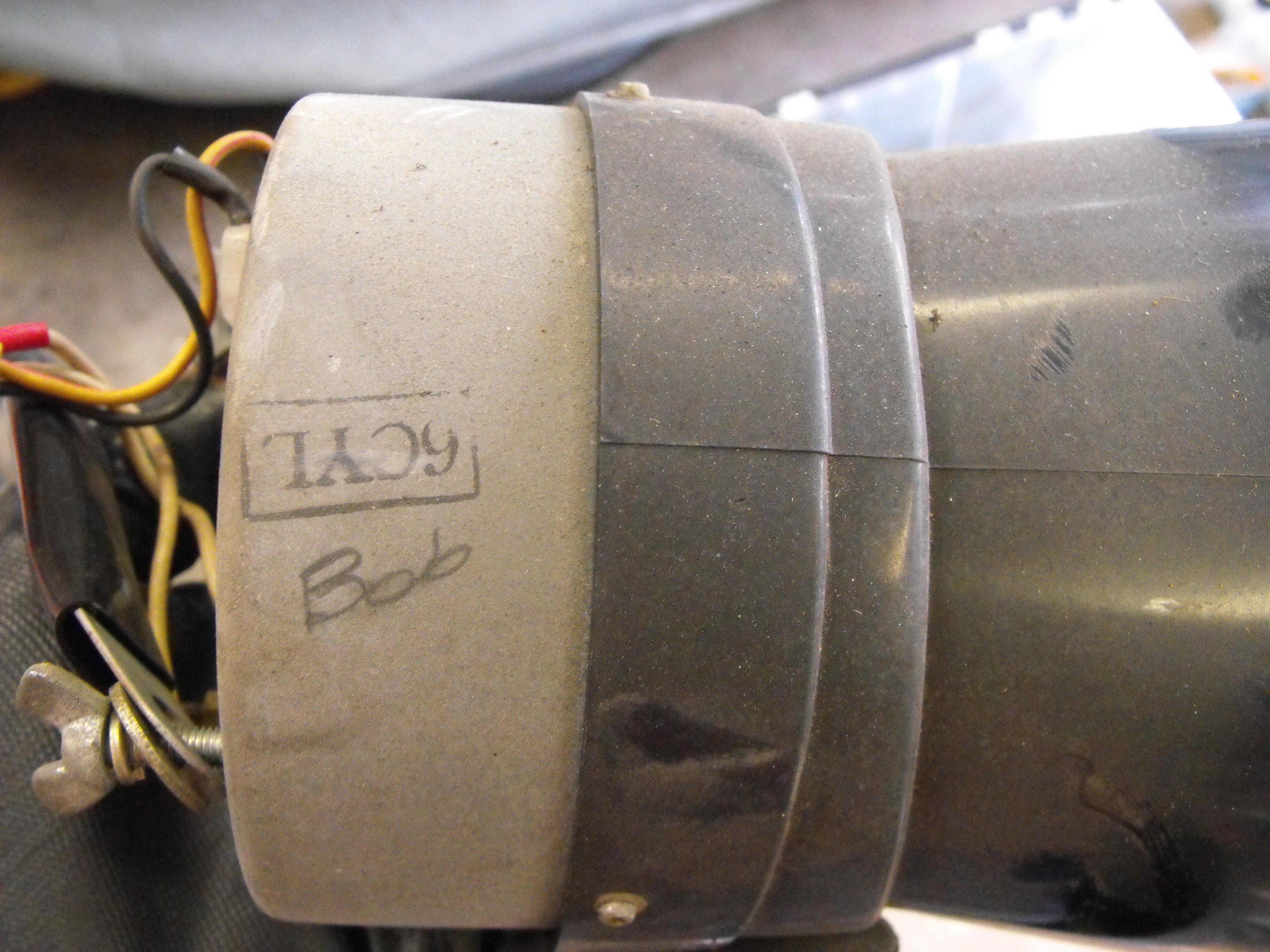

October 1, 20186 yr comment_558601 @jayhawk here (AKA Bob). That tach is a real mystery.  I know that neither I nor anyone else has ever pulled that tach out. And there are no entries in the logbook about that.  Could there have been a Japanese QC inspector named Bob? ?? very weird... I’m glad the dash is looking good. I’ll pass on your comments to the Vintage Dashes guys.   Edited October 1, 20186 yr by jayhawk Link to comment https://www.classiczcars.com/forums/topic/60309-were-bringin-back-the-flat-tops/?&page=11#findComment-558601 Share on other sites More sharing options...
October 1, 20186 yr Author comment_558607 1 hour ago, jayhawk said: @jayhawk here (AKA Bob). That tach is a real mystery.  I know that neither I nor anyone else has ever pulled that tach out. And there are no entries in the logbook about that.  Could there have been a Japanese QC inspector named Bob? ?? very weird... That's funny. Trying to get my head around that. Link to comment https://www.classiczcars.com/forums/topic/60309-were-bringin-back-the-flat-tops/?&page=11#findComment-558607 Share on other sites More sharing options...
