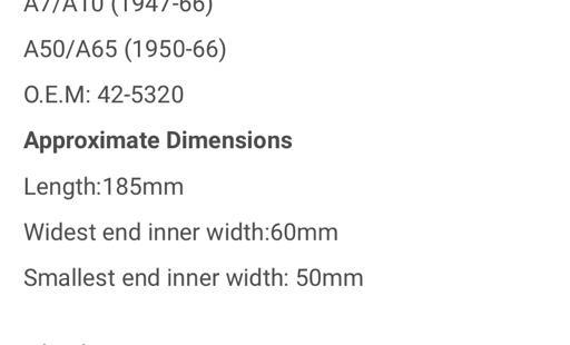

The OD on mine was also 55mm hence why the gaiter has such a great stretch fit without over stretching. I spent hours on google before I came across something that was right or very close on all three dimensions. I also didn’t want anything too short that would pop off every time the car was jacked up.

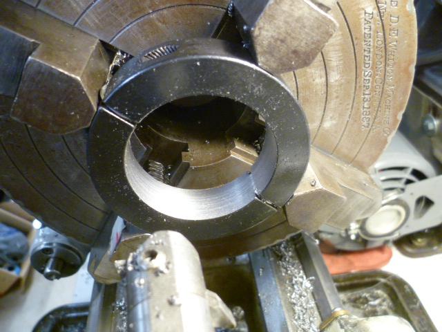

Not wanting to admit defeat, I aligned the collars and chucked them up in the lathe and bored them out to fit the 280 strut tubes. Looked like this on the lathe:

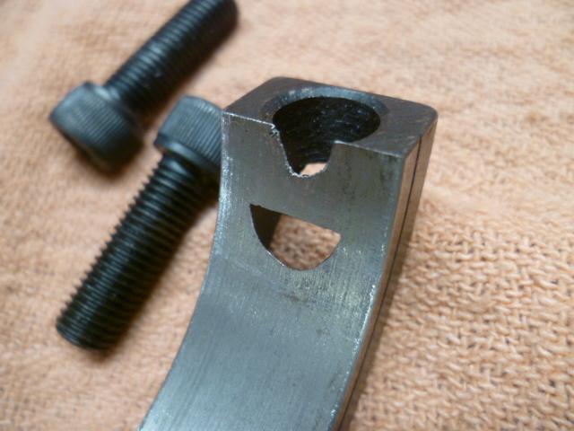

In the end, I had to take off so much material that they got a little Swiss-cheesie, but good enough for the temporary use that I plan for them. Would have been better to start out with 2 1/8 collars instead of 2". I would still have had to bore them out some, but not as much and they wouldn't be quite so holy:

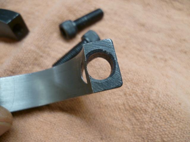

But in the end, here's what the bored out collar looks like on the 280 tube. Should be "good enough." :

Especially if you weld them into place when they are just right.
