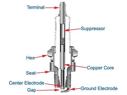

September 27, 20186 yr comment_558328 28 minutes ago, Zed Head said: That's what Mark was saying to do. Put the plug in the end of the wire then measure from contact inside the cap to the center electrode of the plug. He said body but I think he meant center electrode. Do it for all six so that you have a good comparison.  Link to comment https://www.classiczcars.com/forums/topic/60072-misfiring-while-cruising/?&page=10#findComment-558328 Share on other sites More sharing options...
September 27, 20186 yr comment_558338 Yes, the center electrode should have a good path back to the contact in the distributor cap. You might see high resistance since you probably have resistor wires, but all six plugs and wires should show the same number. Wiggle the wires around once you get your meter set up, for each wire but especially 3 and 4, to be sure that you don't have an intermittent break in the circuit. Link to comment https://www.classiczcars.com/forums/topic/60072-misfiring-while-cruising/?&page=10#findComment-558338 Share on other sites More sharing options...
September 27, 20186 yr comment_558340 4 hours ago, Mark Maras said: Â I'd grab a volt-ohm meter and measure the resistance from the contacts in the dist. cap to the body of the spark plug. Basically, remove the cap leaving the wires plugged in. Next remove the spark plugs and plug them back onto the wires. One of the meter leads will go onto the contact inside the cap. The other meter lead will go onto the body of the spark plug. Measure the resistance in each of the cap, wire, and plug. When you find one with a lot of resistance remove the cap and measure the resistance in the wire and the plug. Then reinstall the wire into the cap and pull the plug from the wire. Then measure the resistance in the wire and cap. Ask if you have any questions. It's the best way to learn. Mark, Ill follow your advice and do the resistance test with my Digital Multimeter. I also have a set of old NGK Blue spark plugs which i can test. I called my mechanic today and he argues that if the seals should be good or else the engine would present problems at high rpms. He doesnt see any oil on those plugs, more gasoline. Weird! Link to comment https://www.classiczcars.com/forums/topic/60072-misfiring-while-cruising/?&page=10#findComment-558340 Share on other sites More sharing options...

September 28, 20186 yr comment_558351 6.89 k spark plug 5 7.17k spark plug 4 5.83k spark plug 3 Edited September 28, 20186 yr by jalexquijano Link to comment https://www.classiczcars.com/forums/topic/60072-misfiring-while-cruising/?&page=10#findComment-558351 Share on other sites More sharing options...
September 28, 20186 yr comment_558353 One... https://www.taylorvertex.com/faqs/#ohmsonwires http://www.ngk-sparkplugs.jp/english/techinfo/resistor-wire/01/index.html Edited September 28, 20186 yr by Zed Head Link to comment https://www.classiczcars.com/forums/topic/60072-misfiring-while-cruising/?&page=10#findComment-558353 Share on other sites More sharing options...
