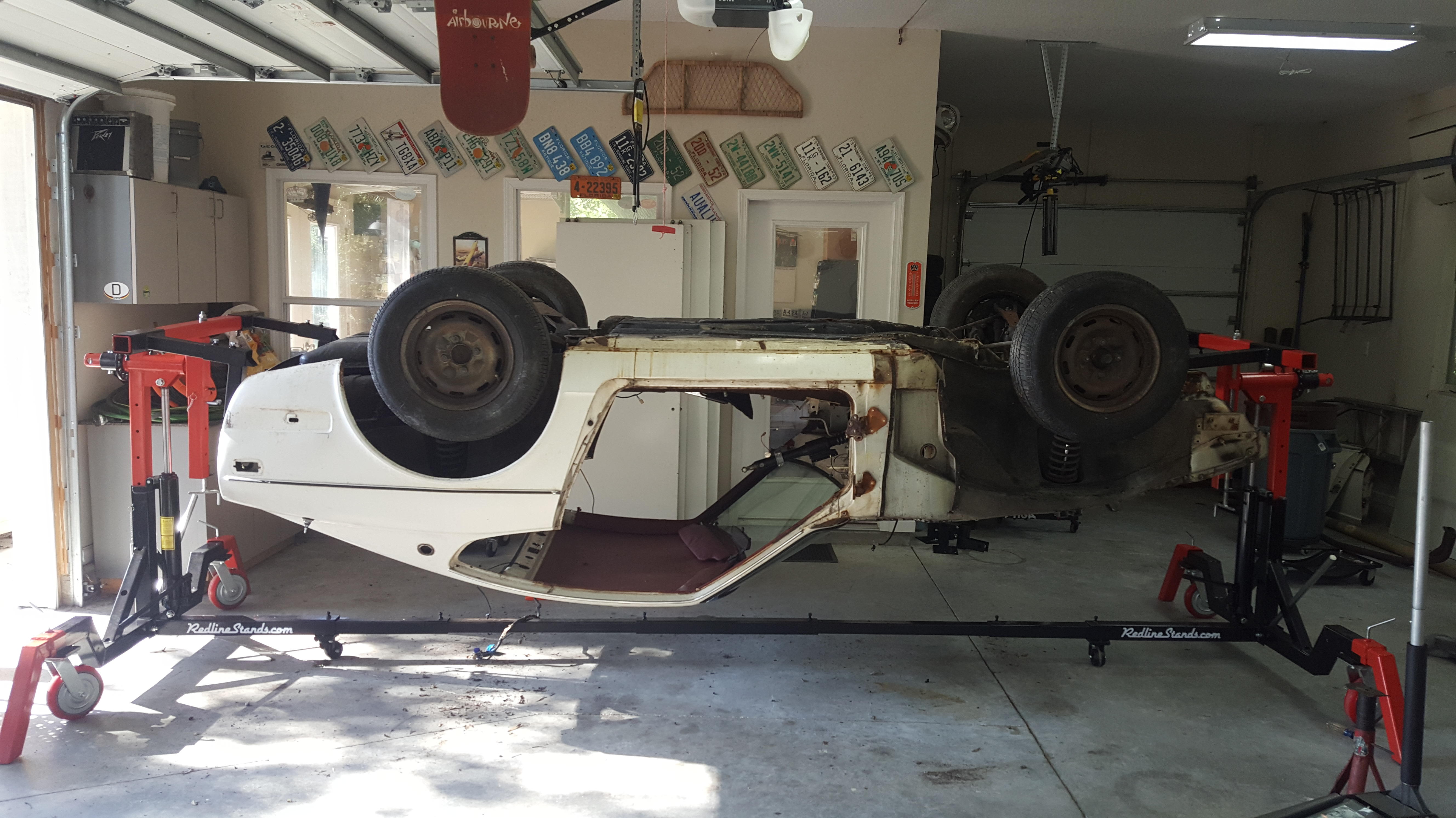

On rotisserie, so now the rest of the disassembly.
Will have pictures soon. Sort of new at documenting work. I work alone and seem to get involved without breaks or thinking of stopping for documenting.

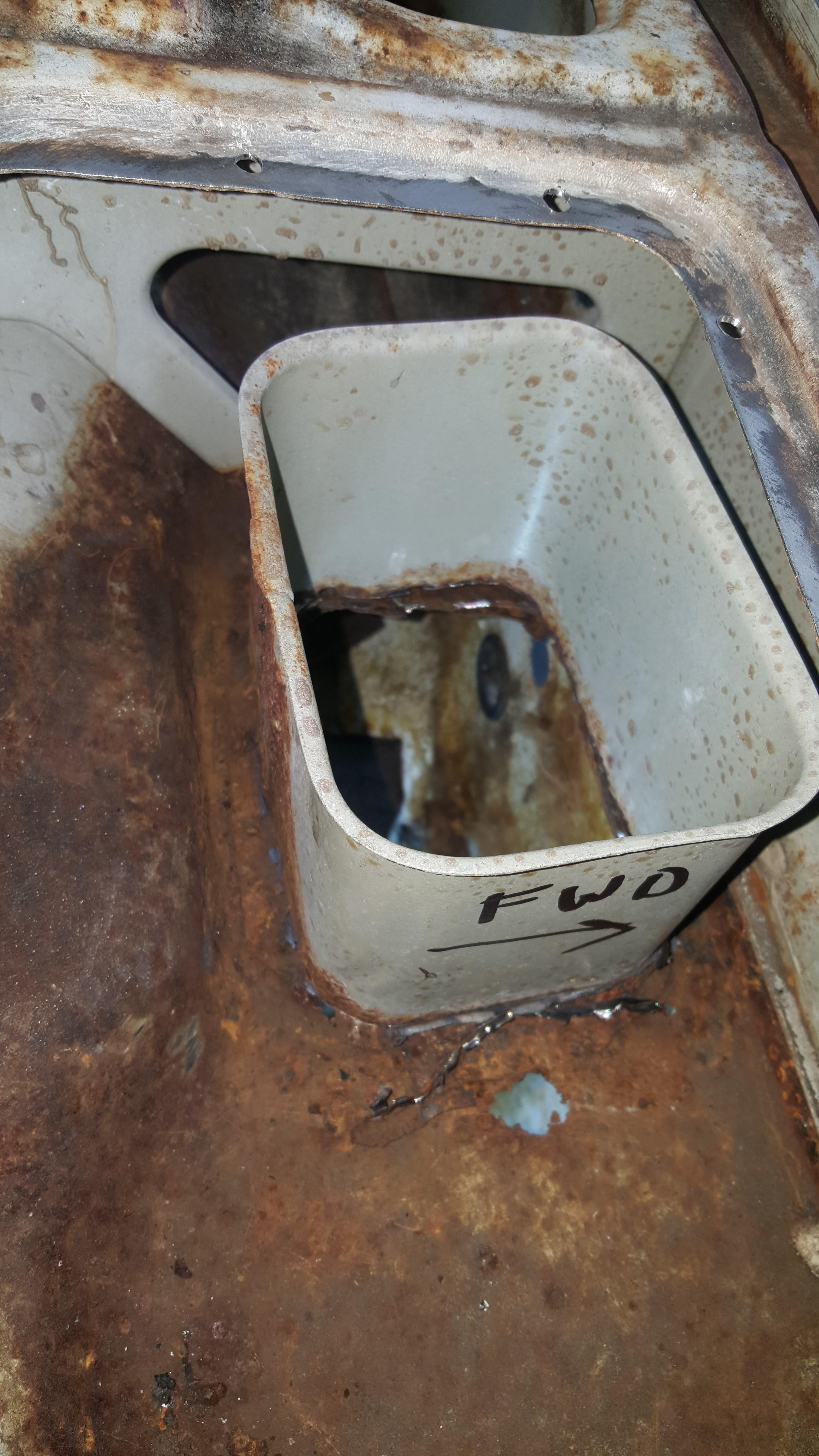

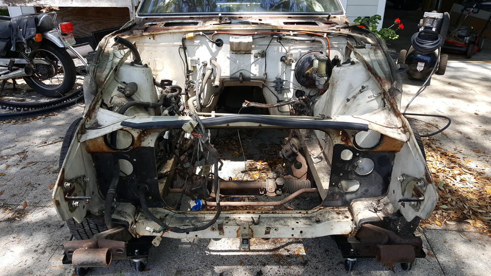

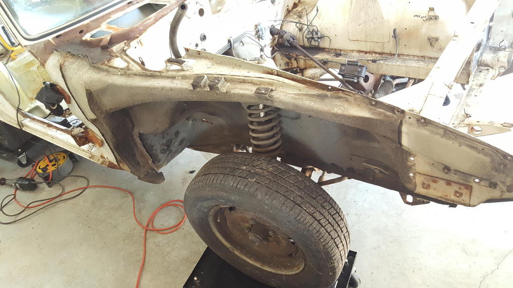

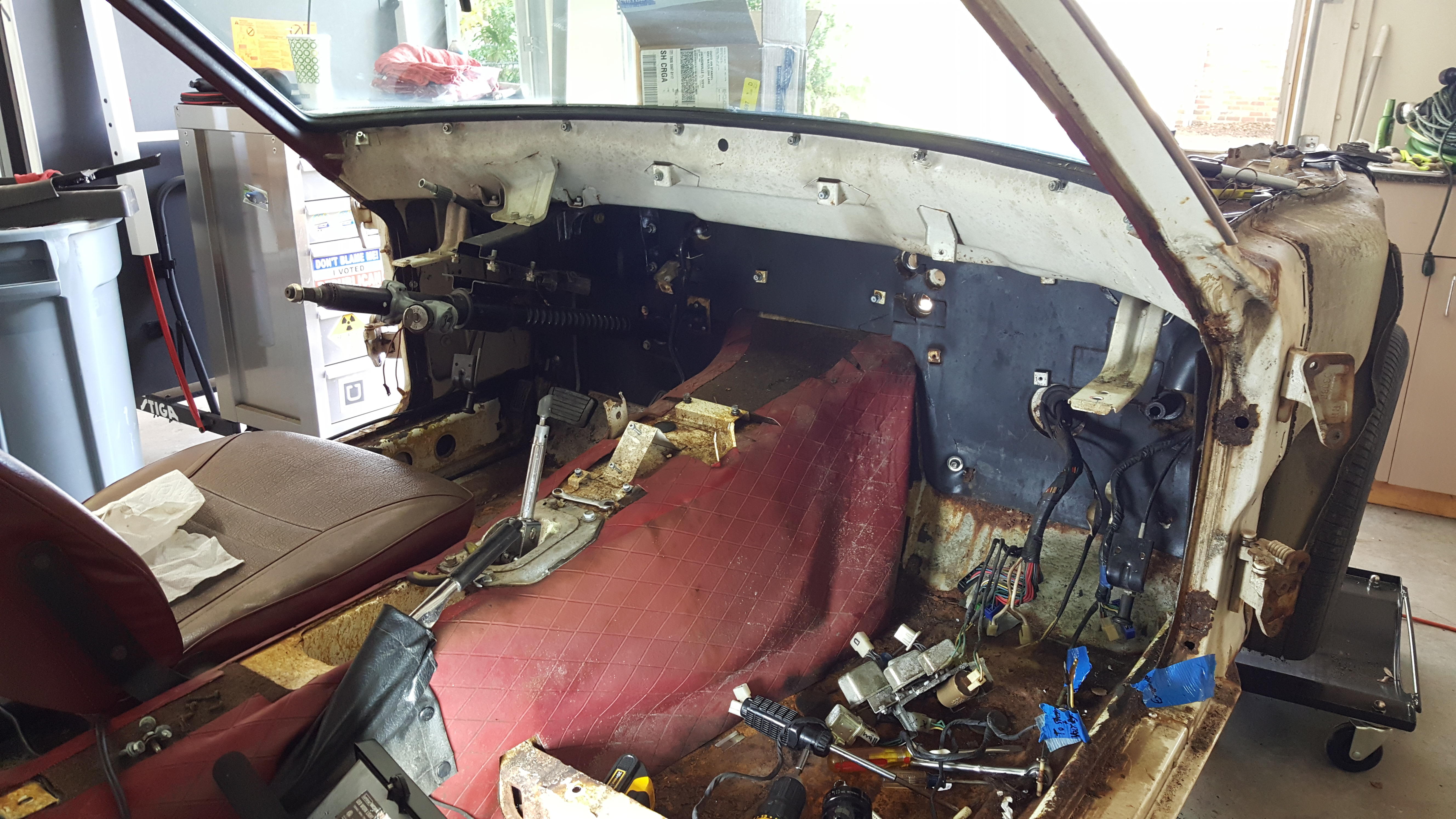

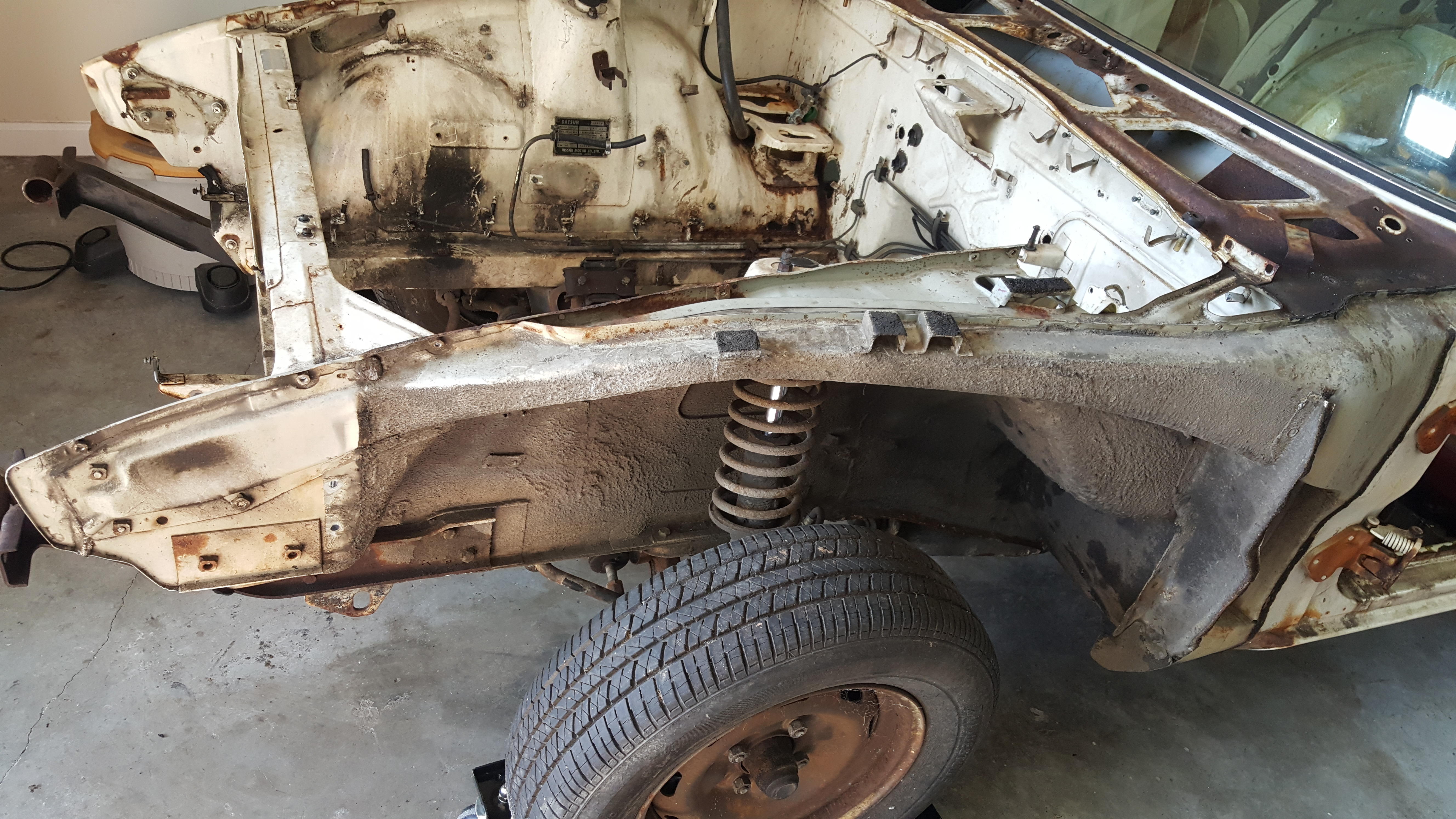

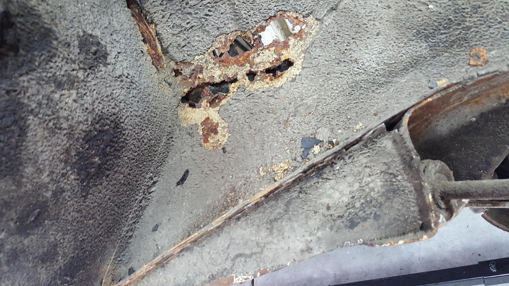

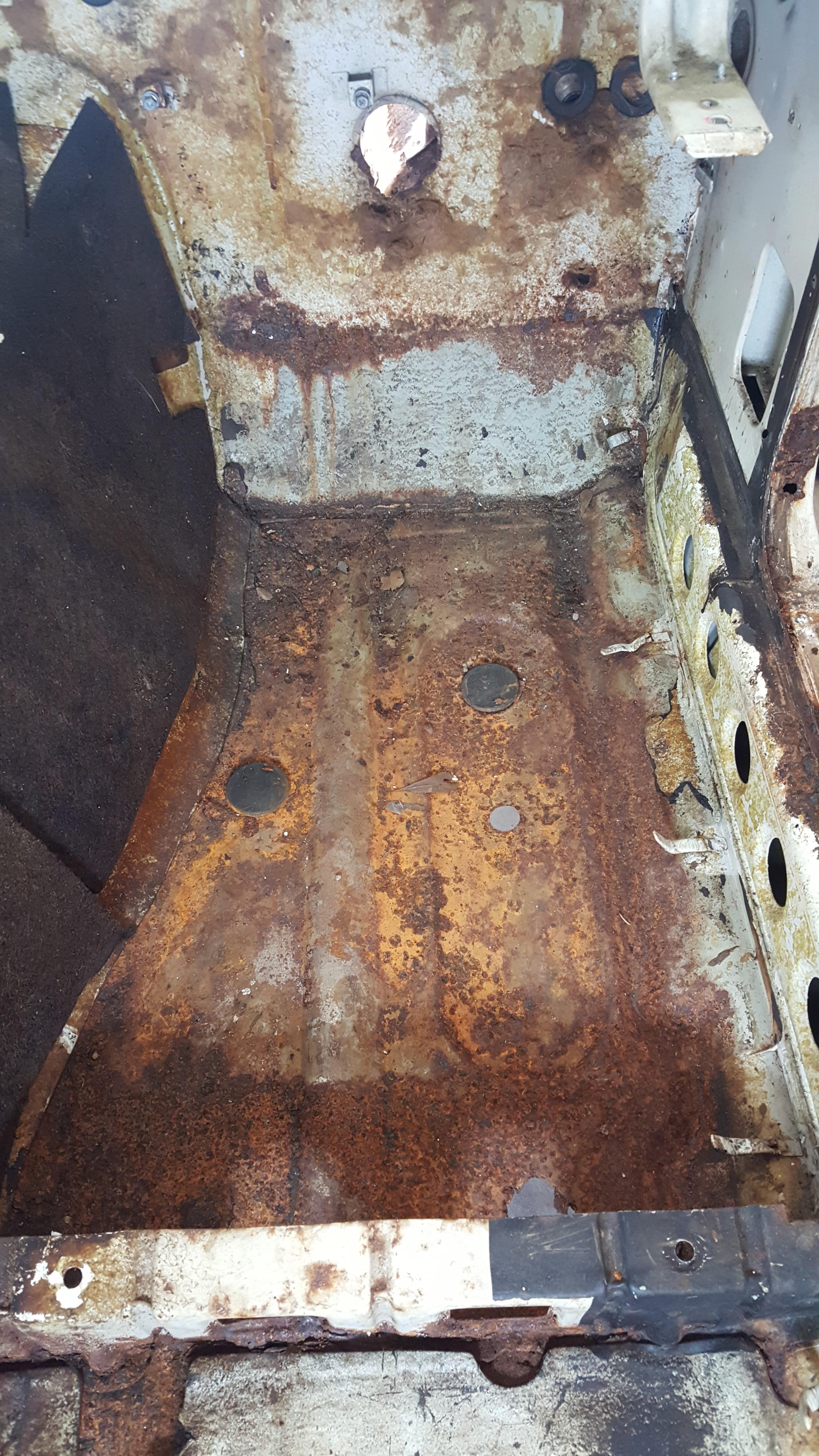

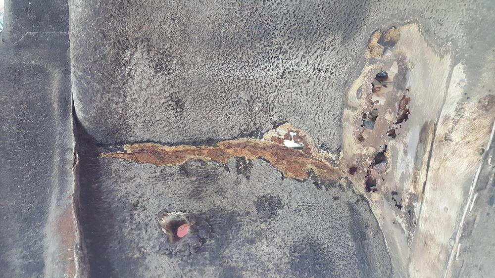

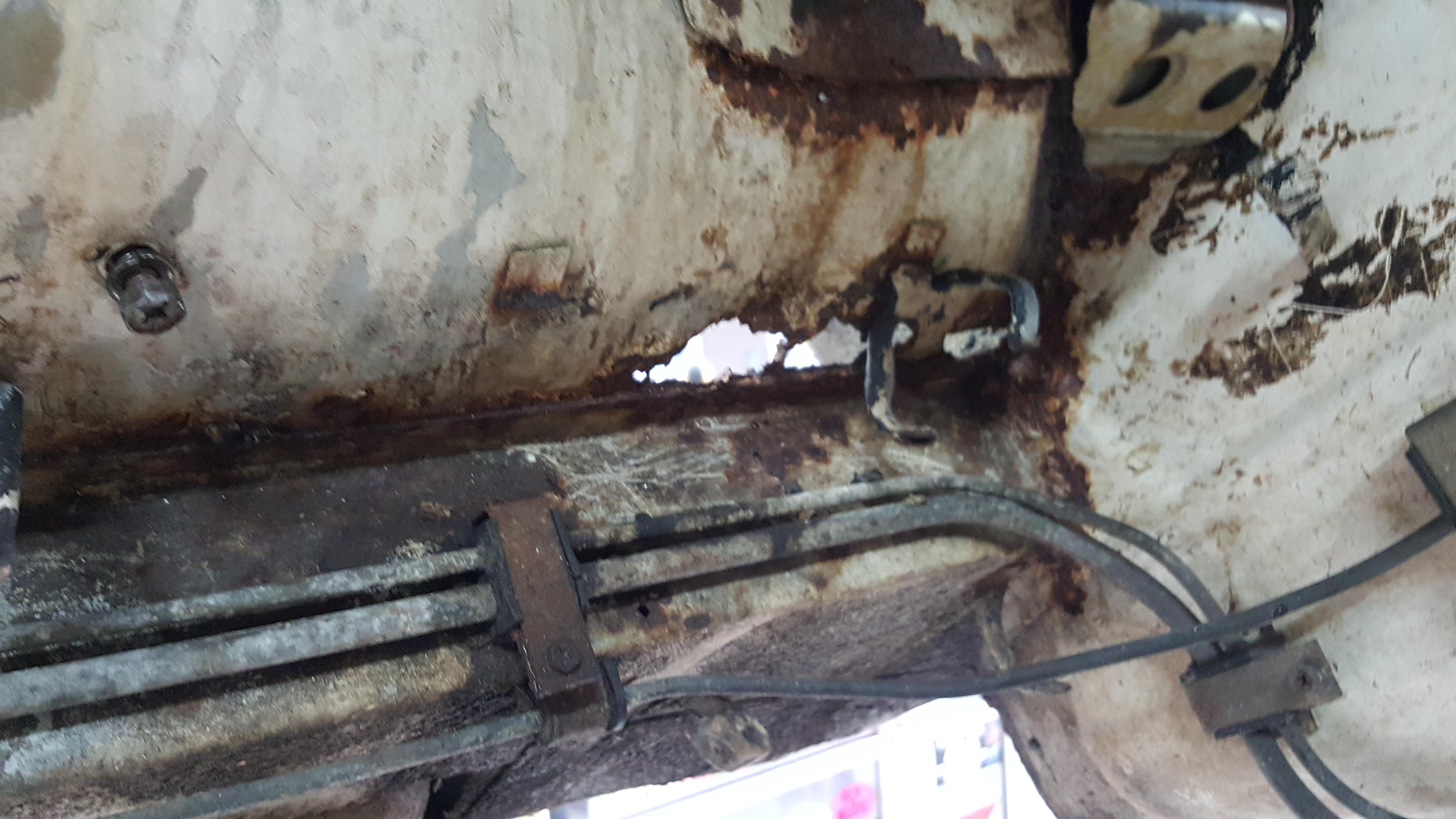

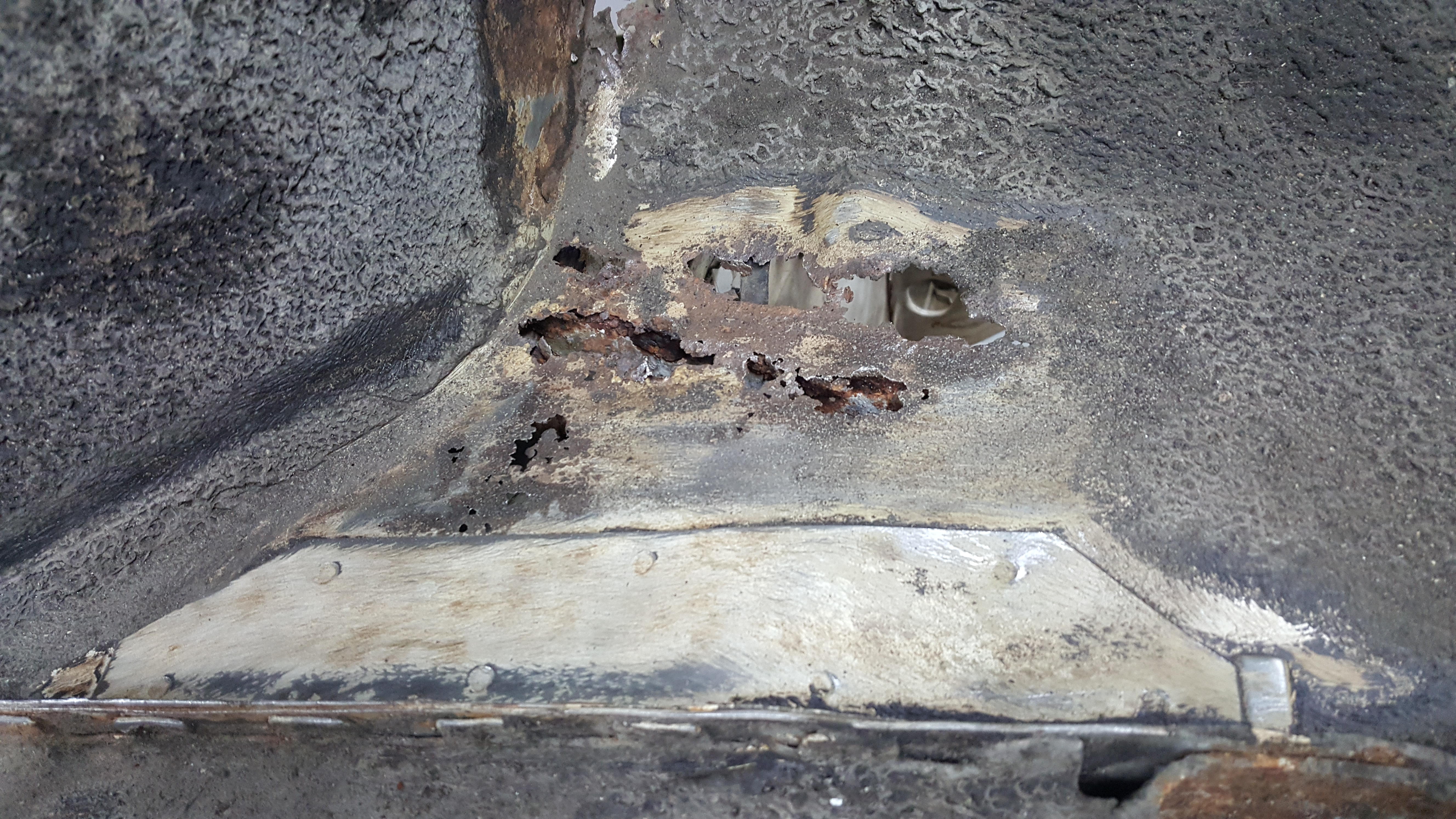

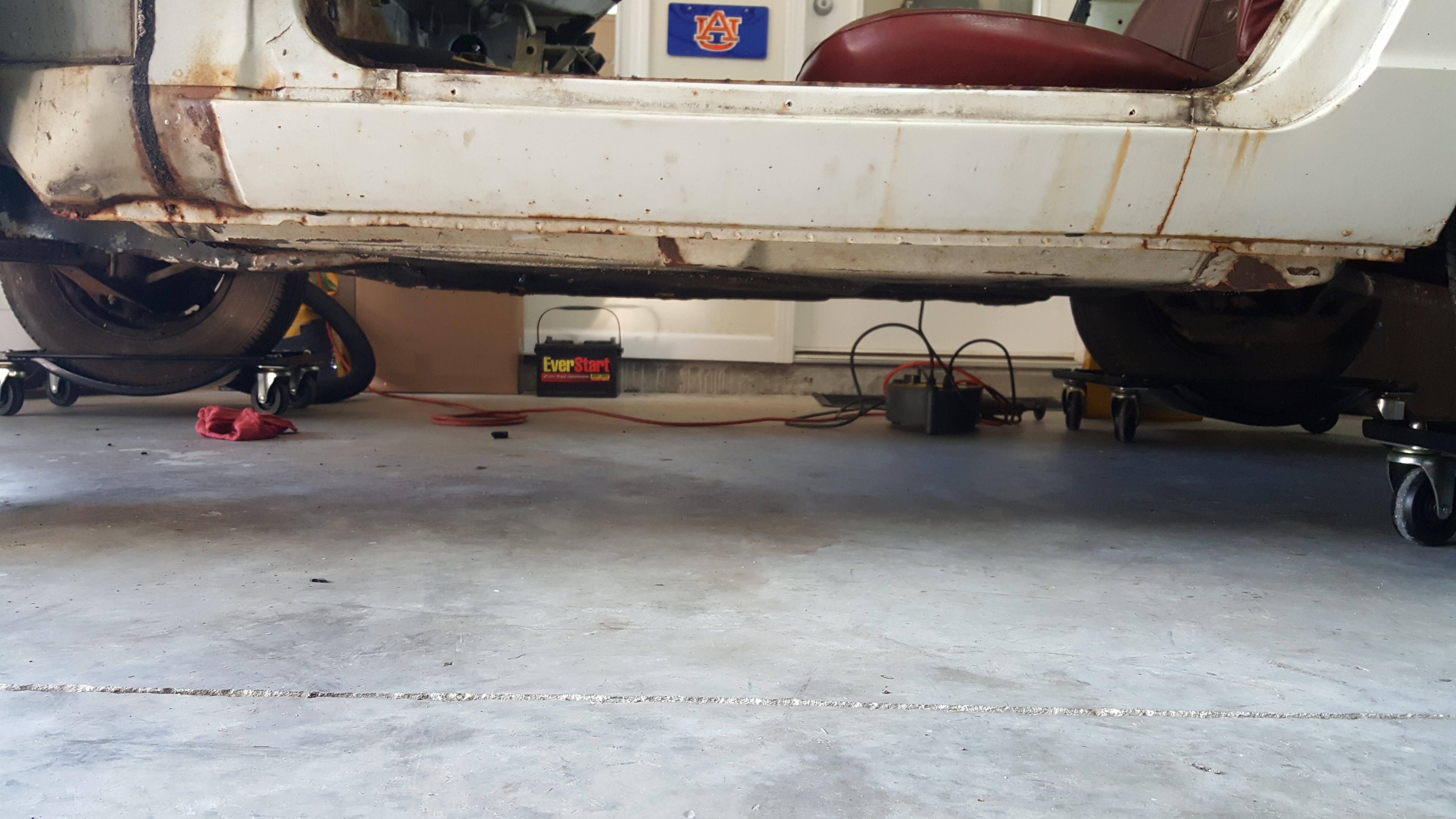

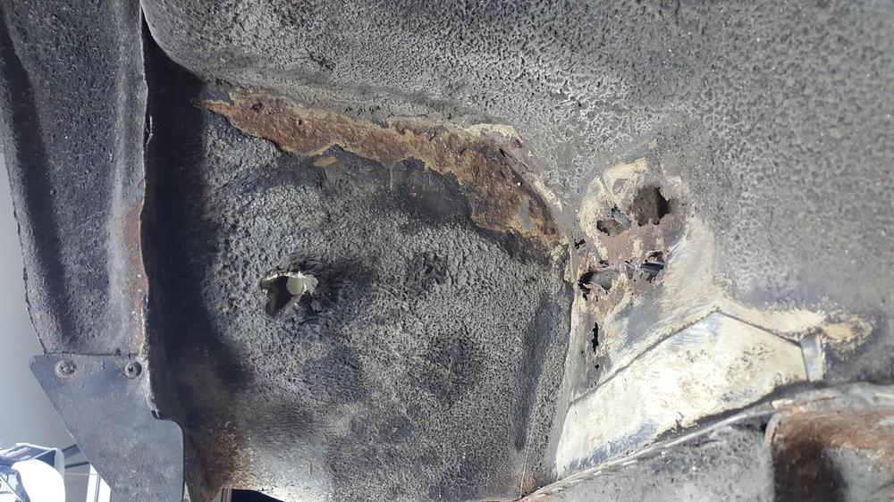

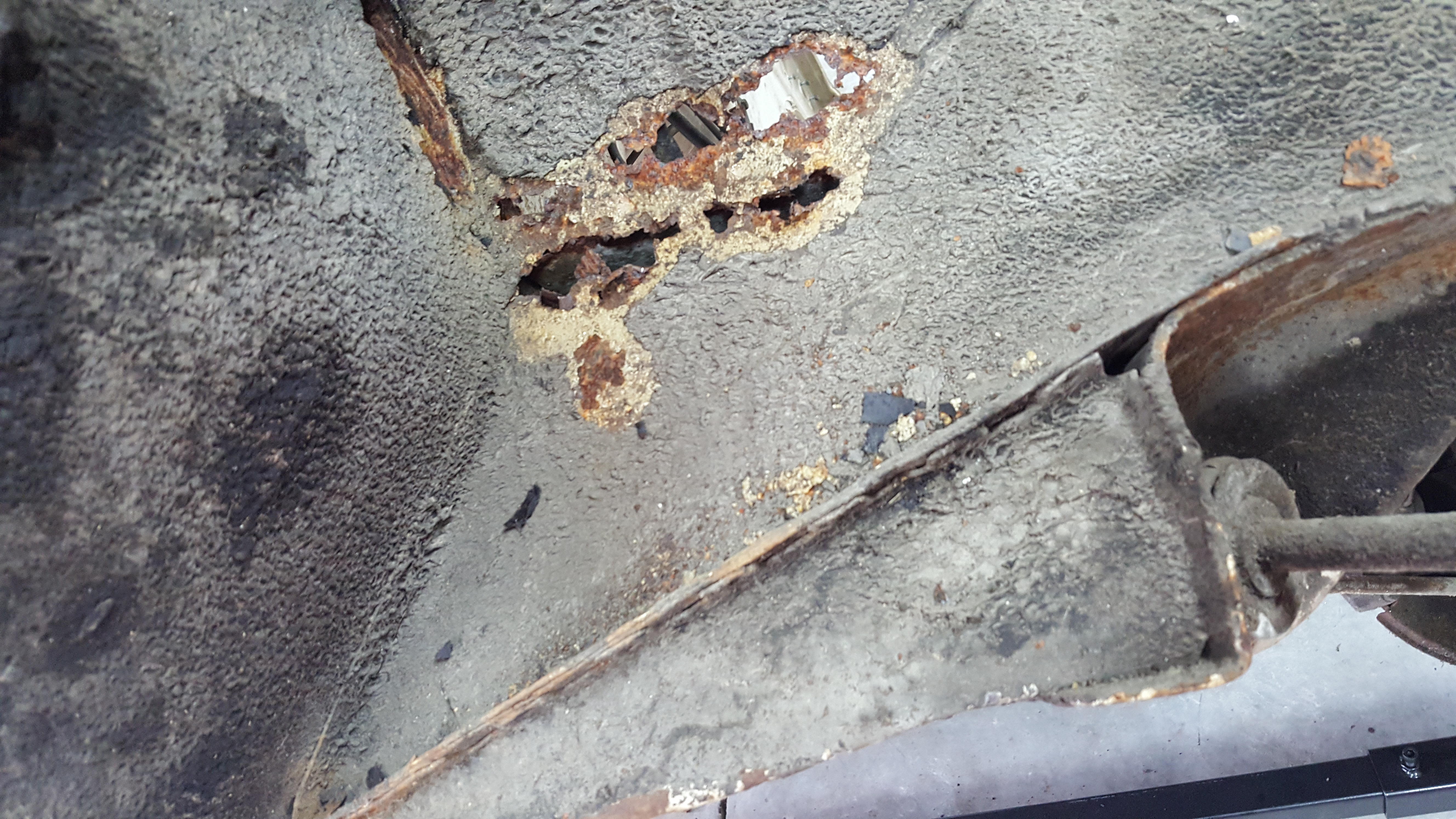

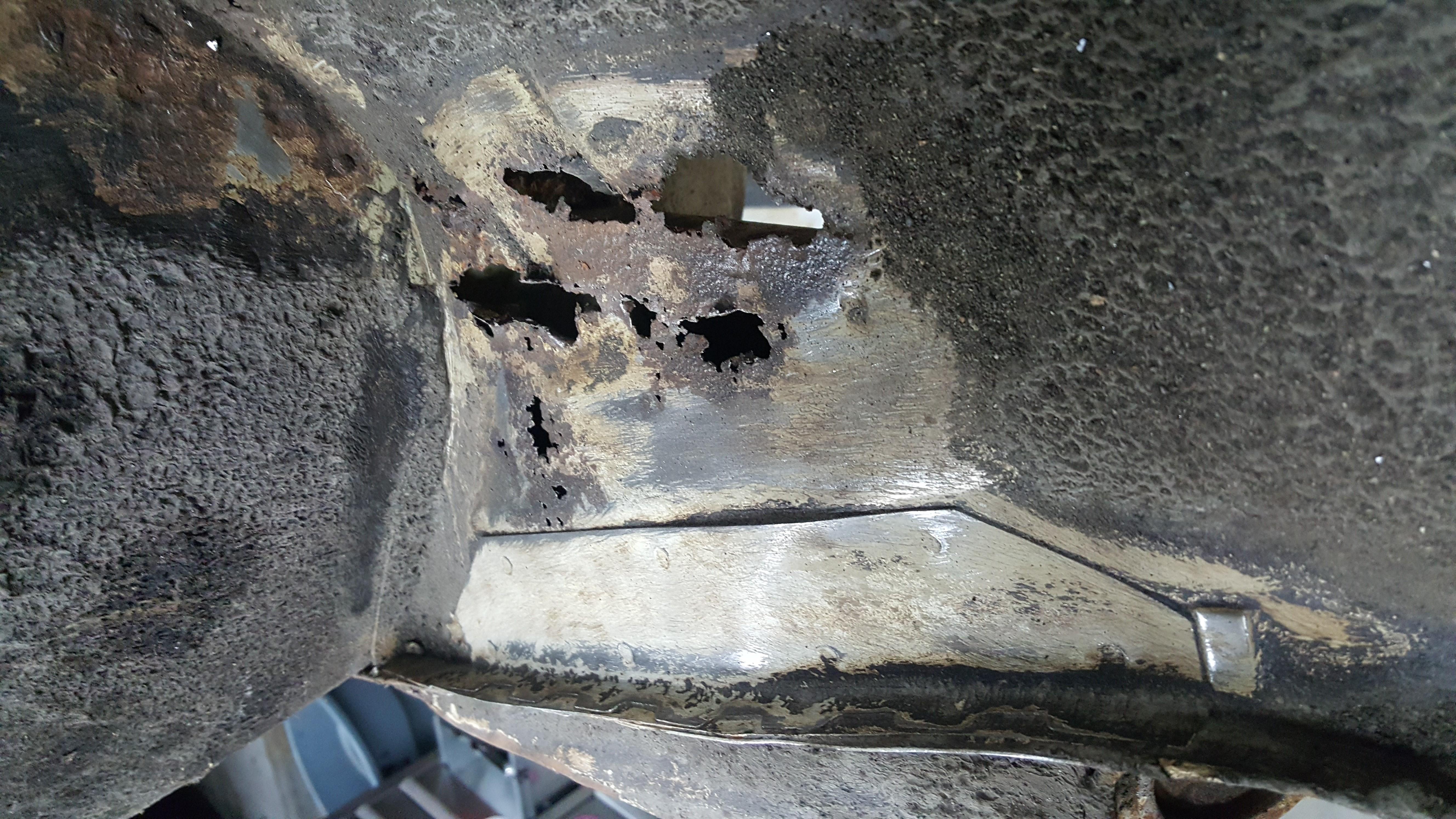

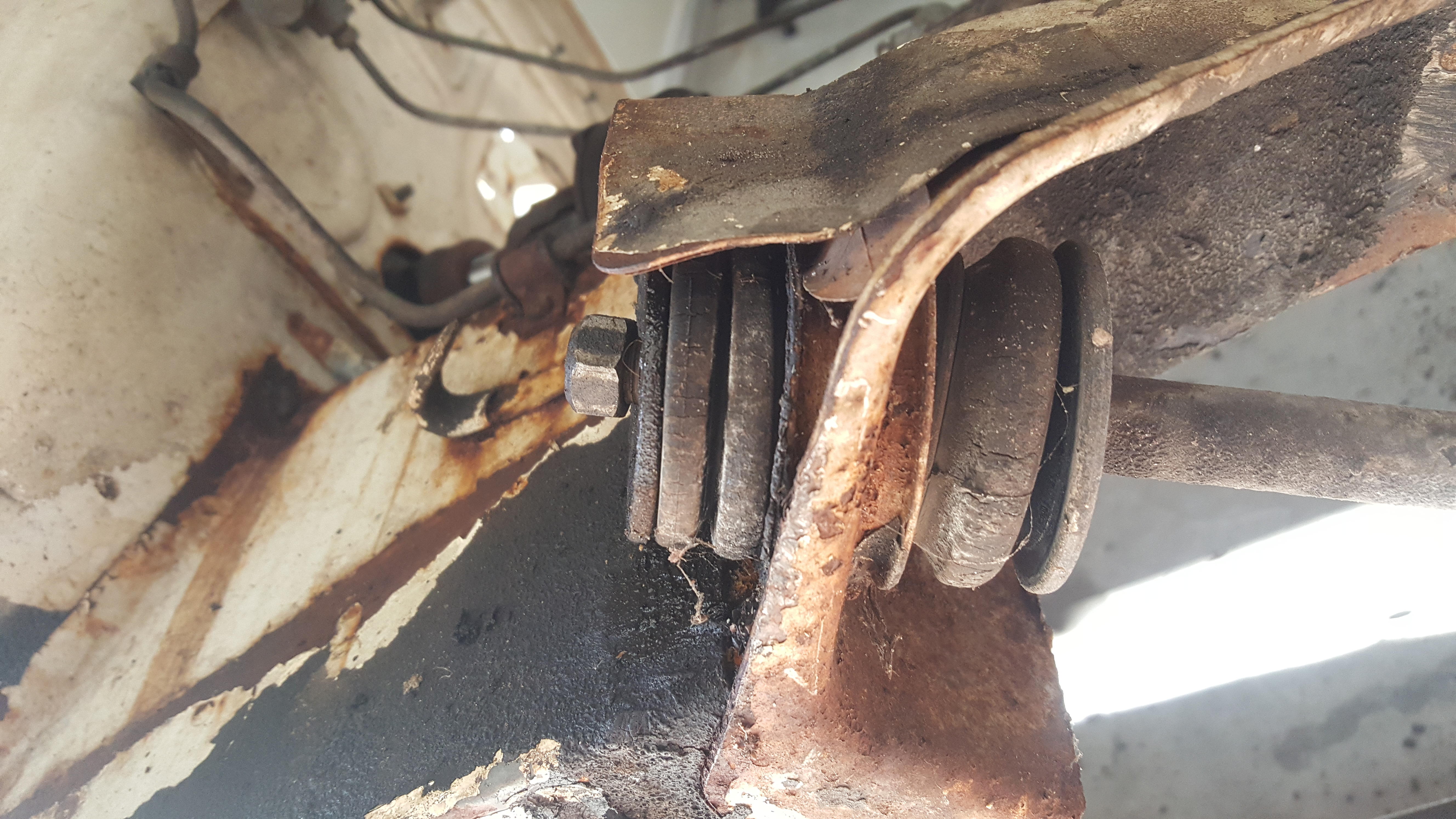

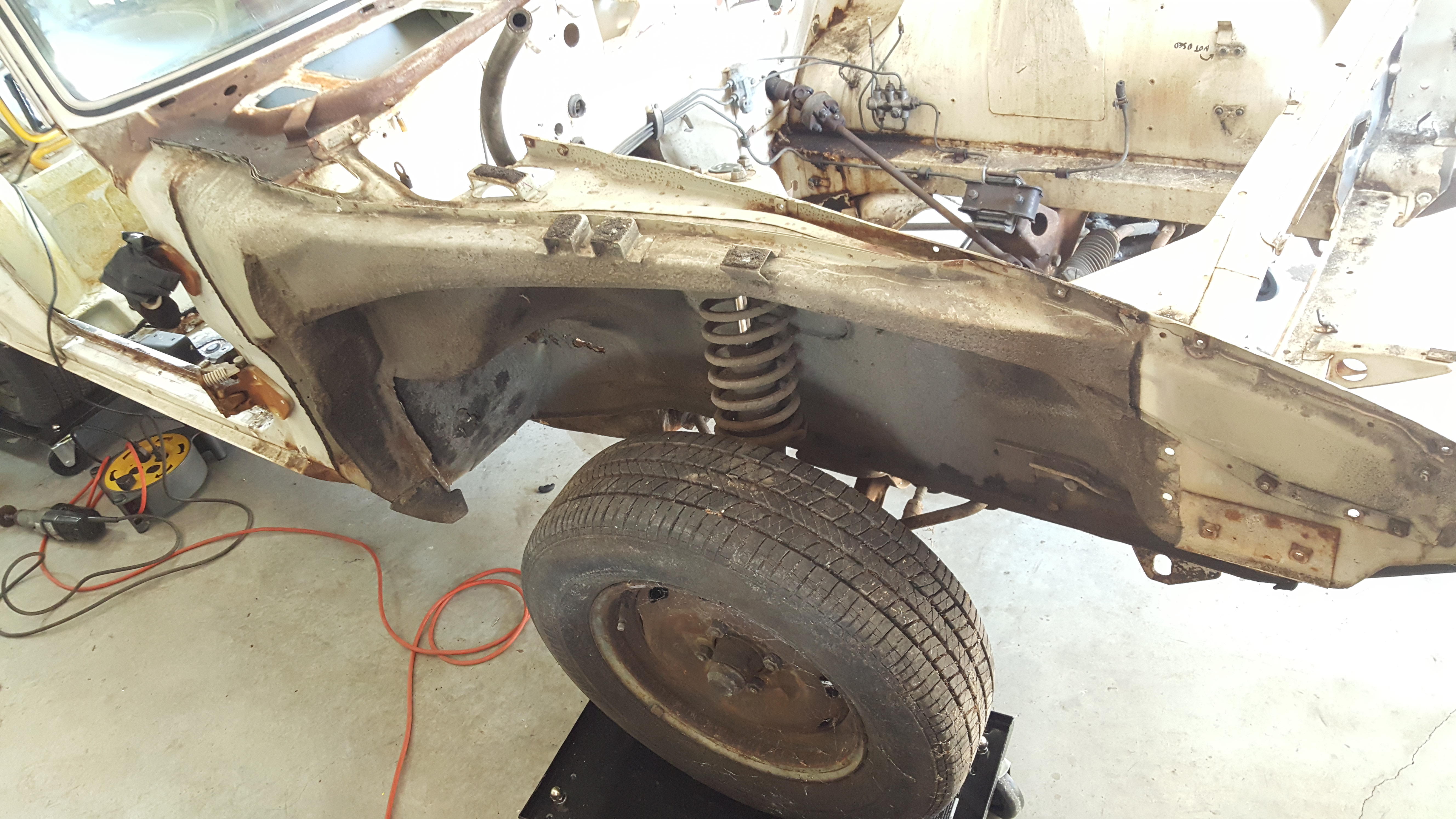

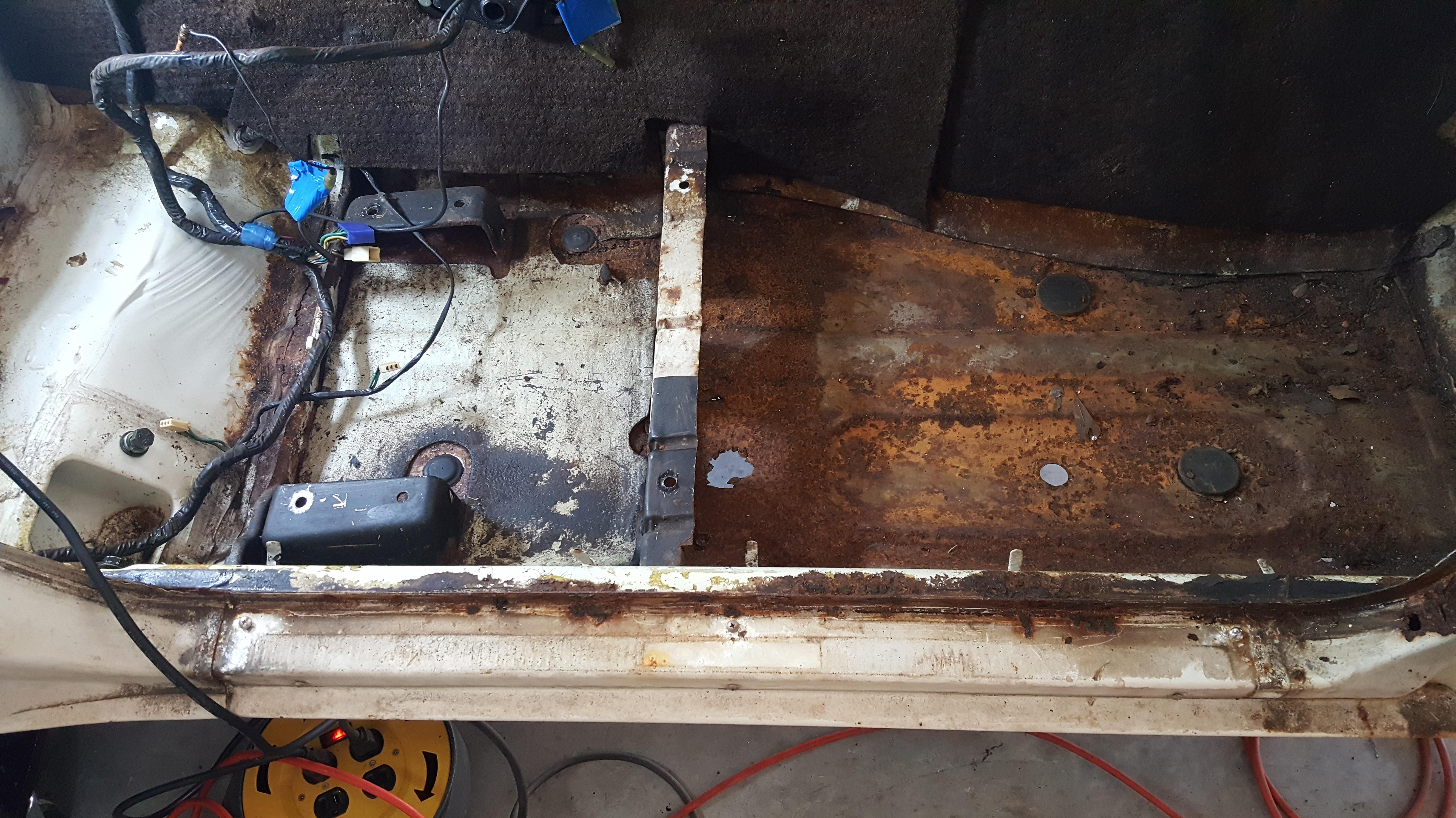

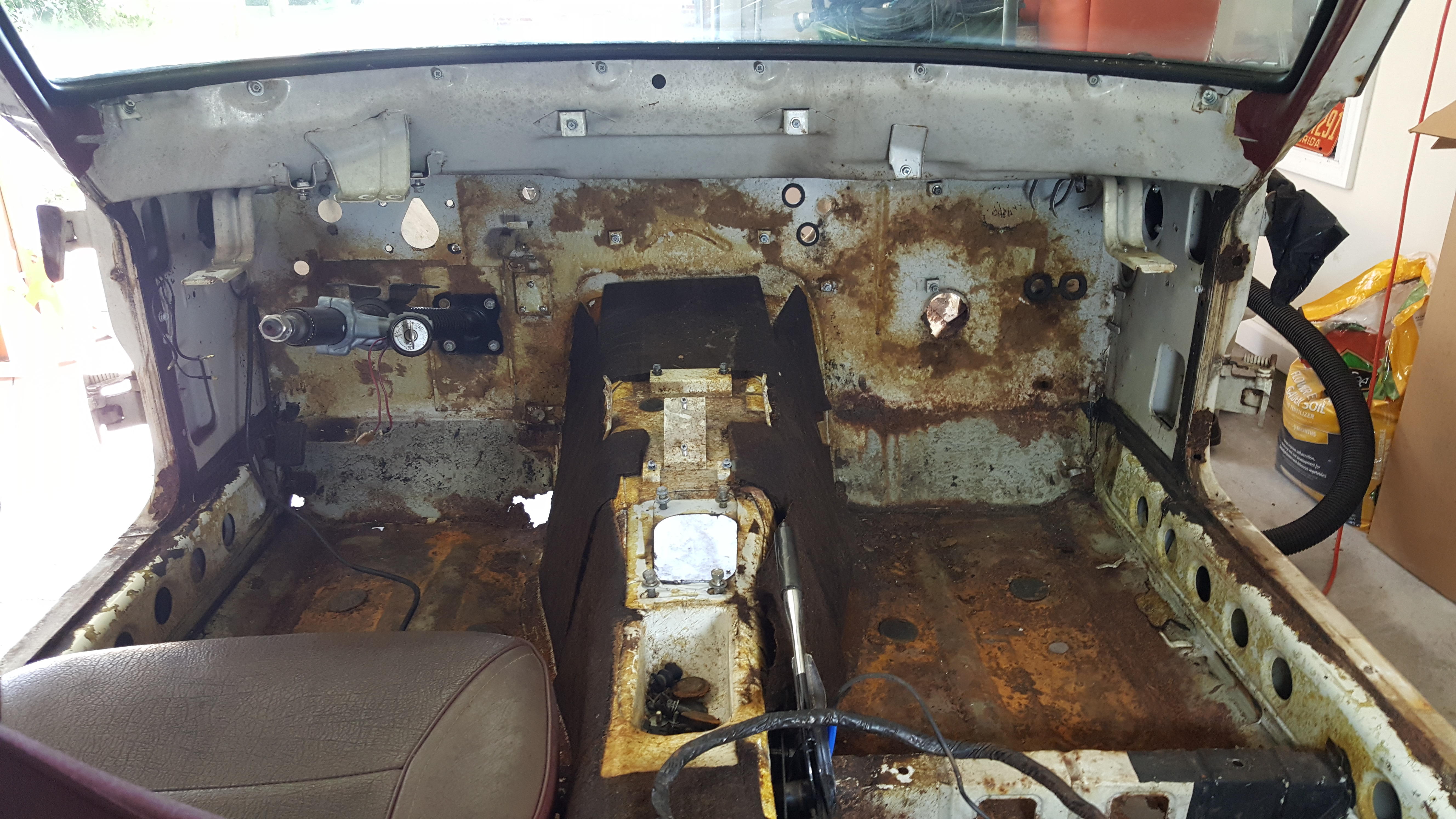

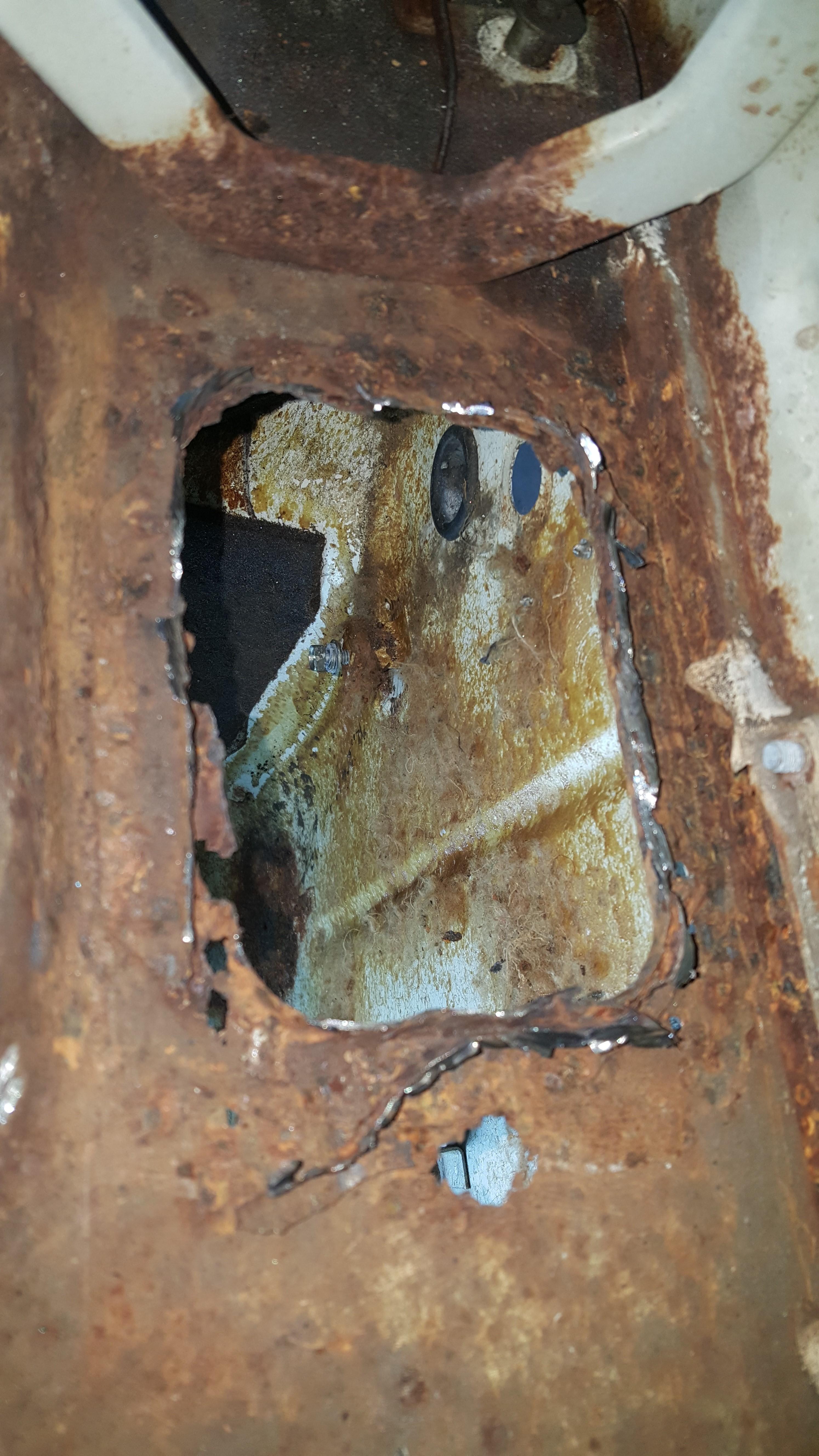

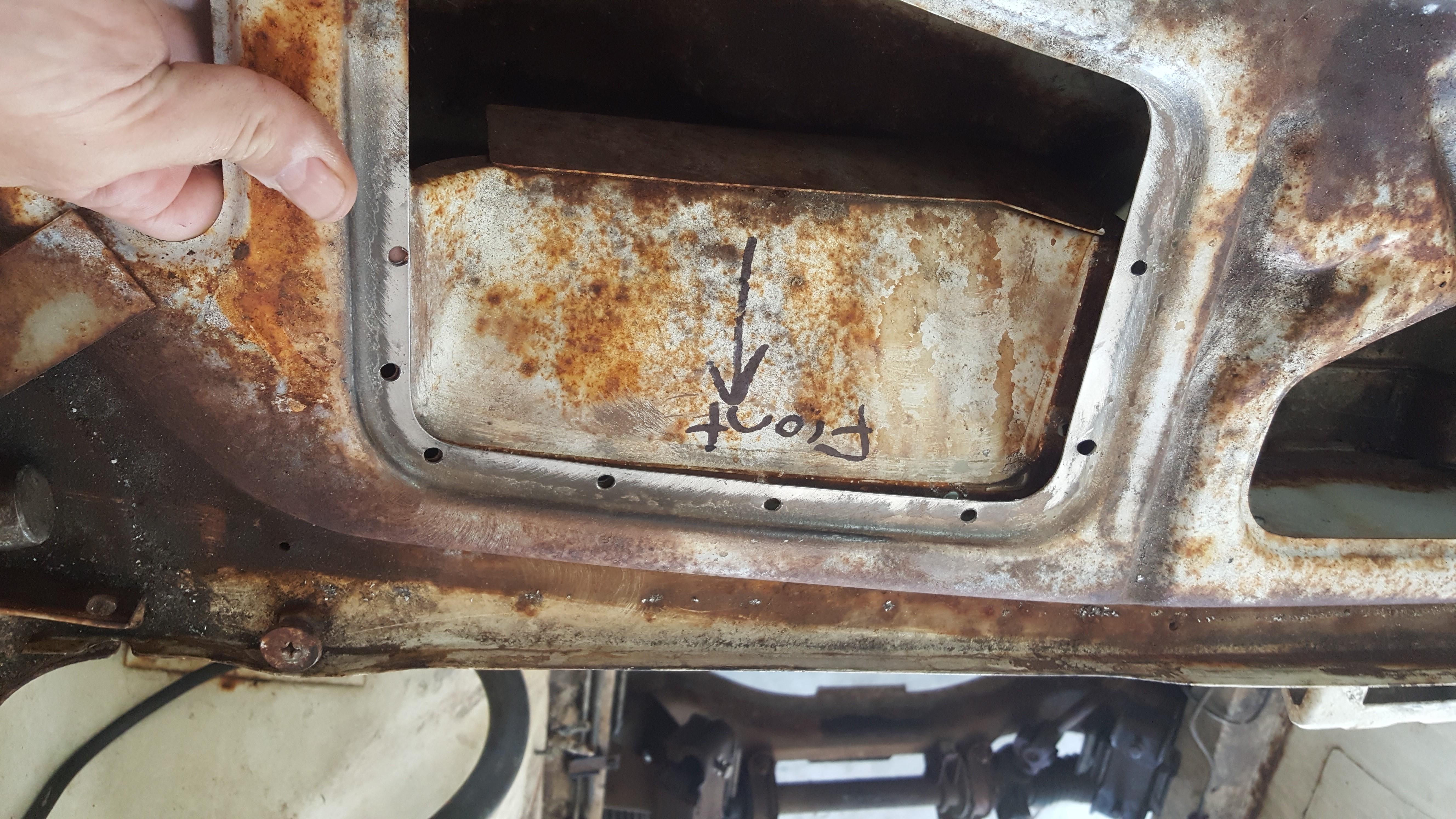

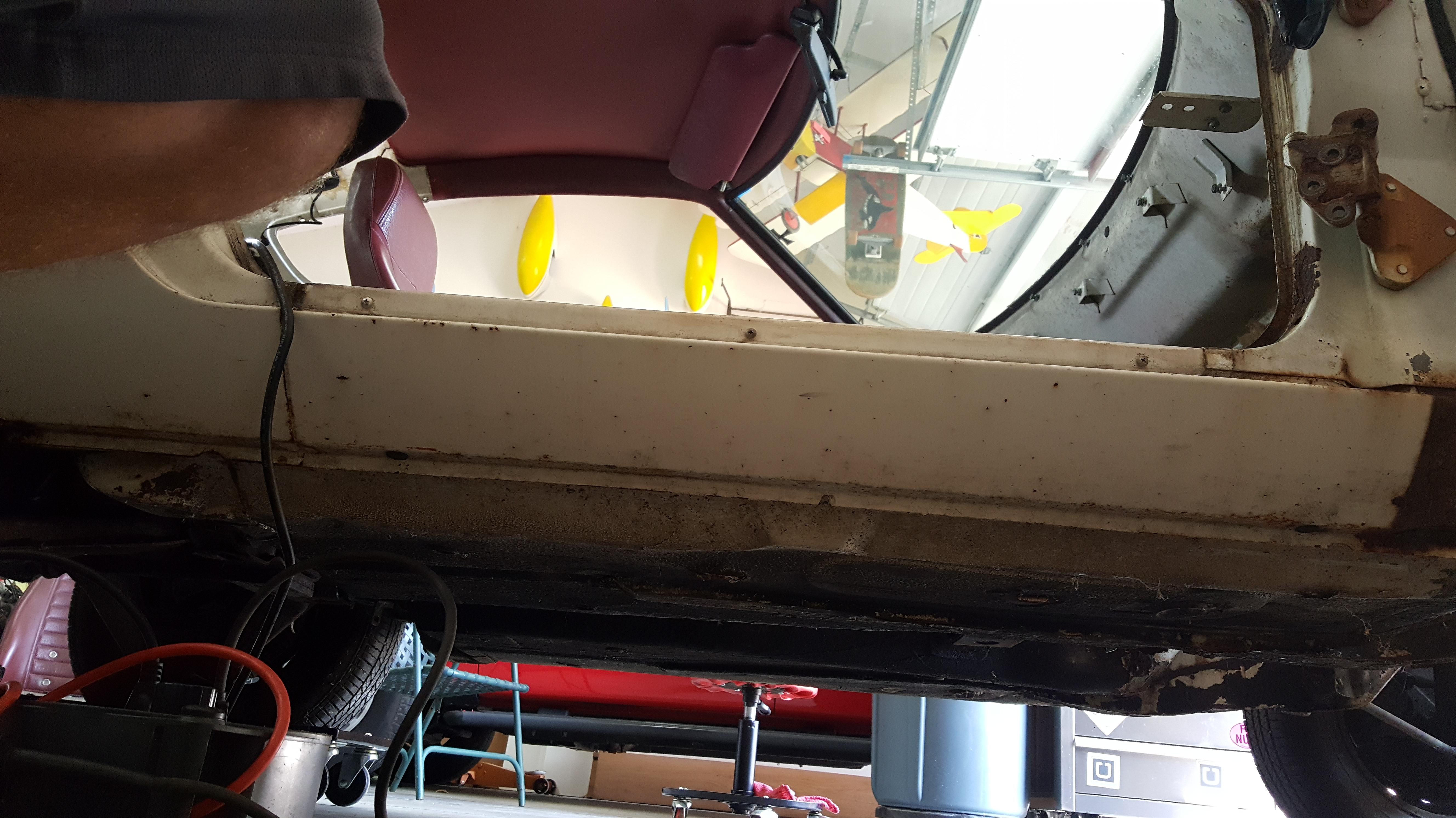

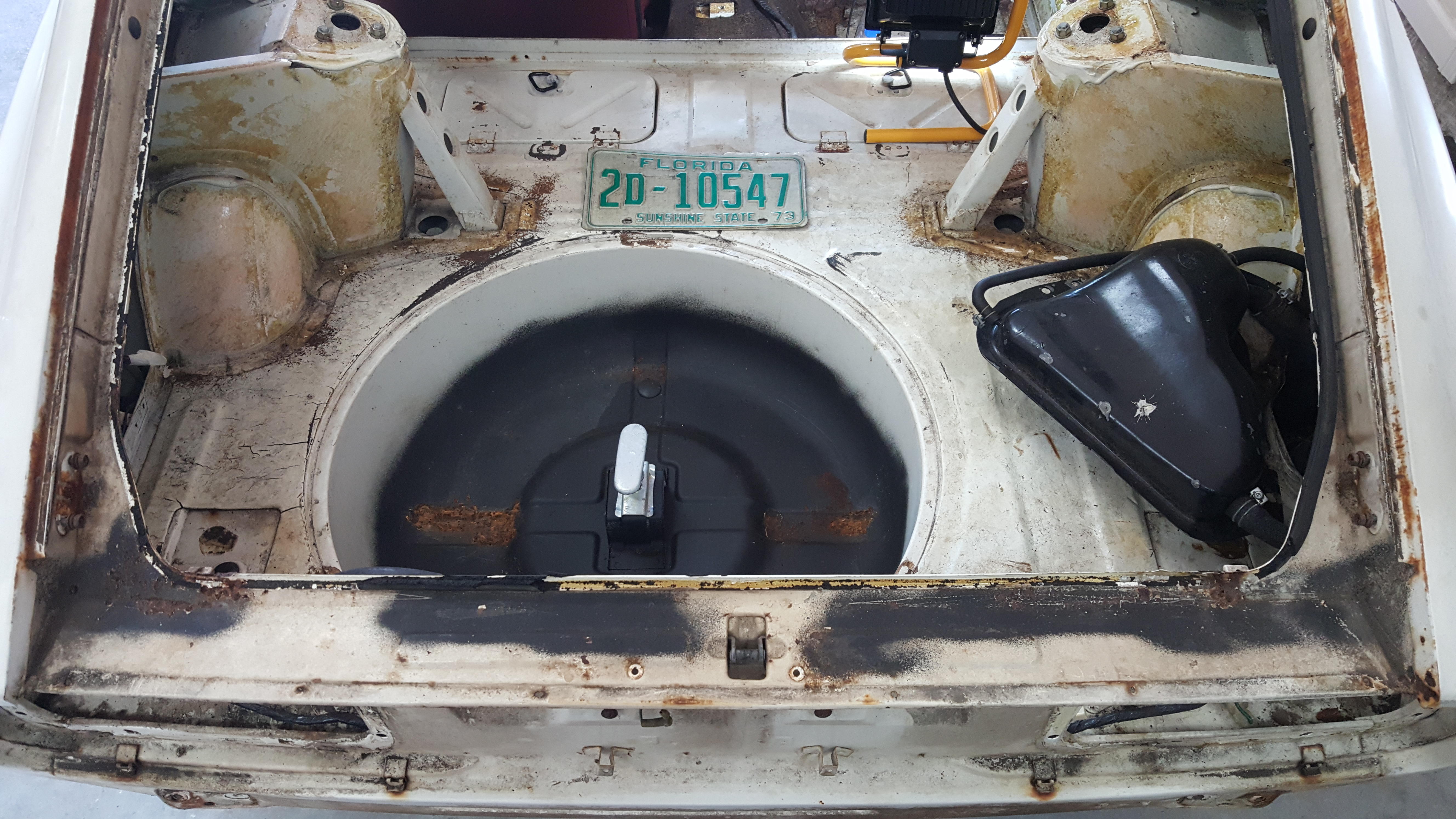

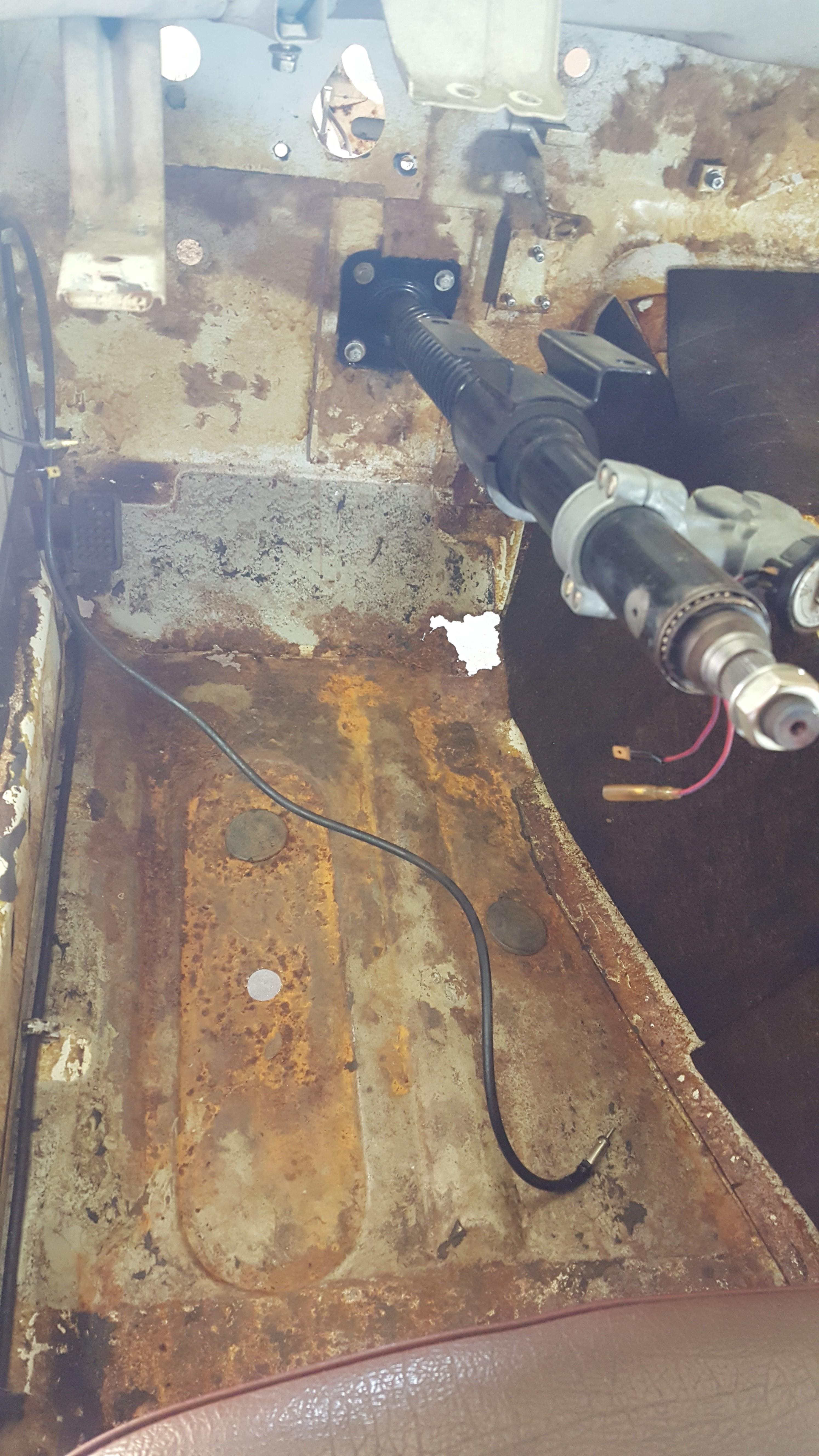

Car is completely disassembled, assessing the rails. Obviously the rears and the floors need replacing, I'm hoping to save the seat attachment points, we'll see.

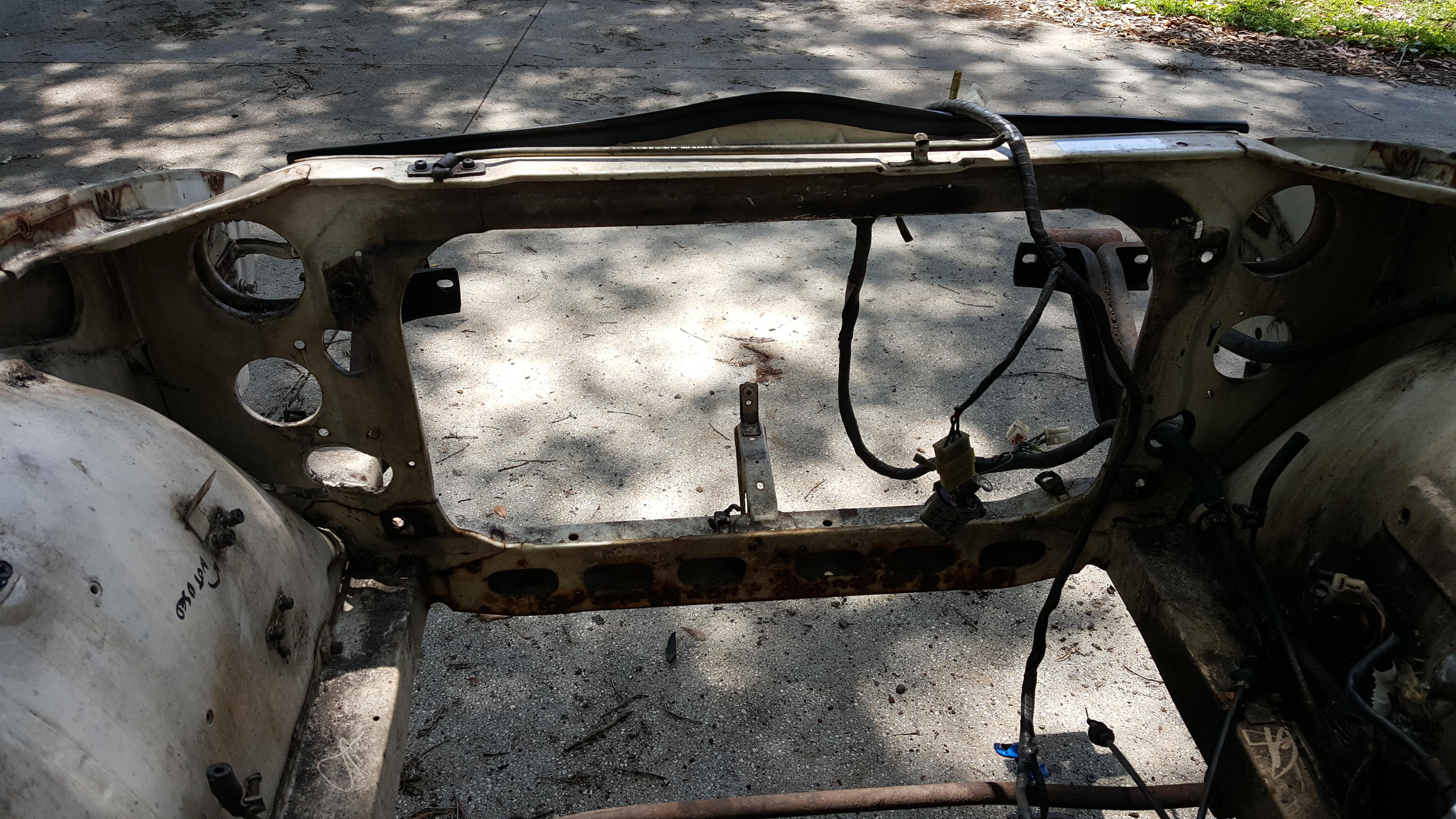

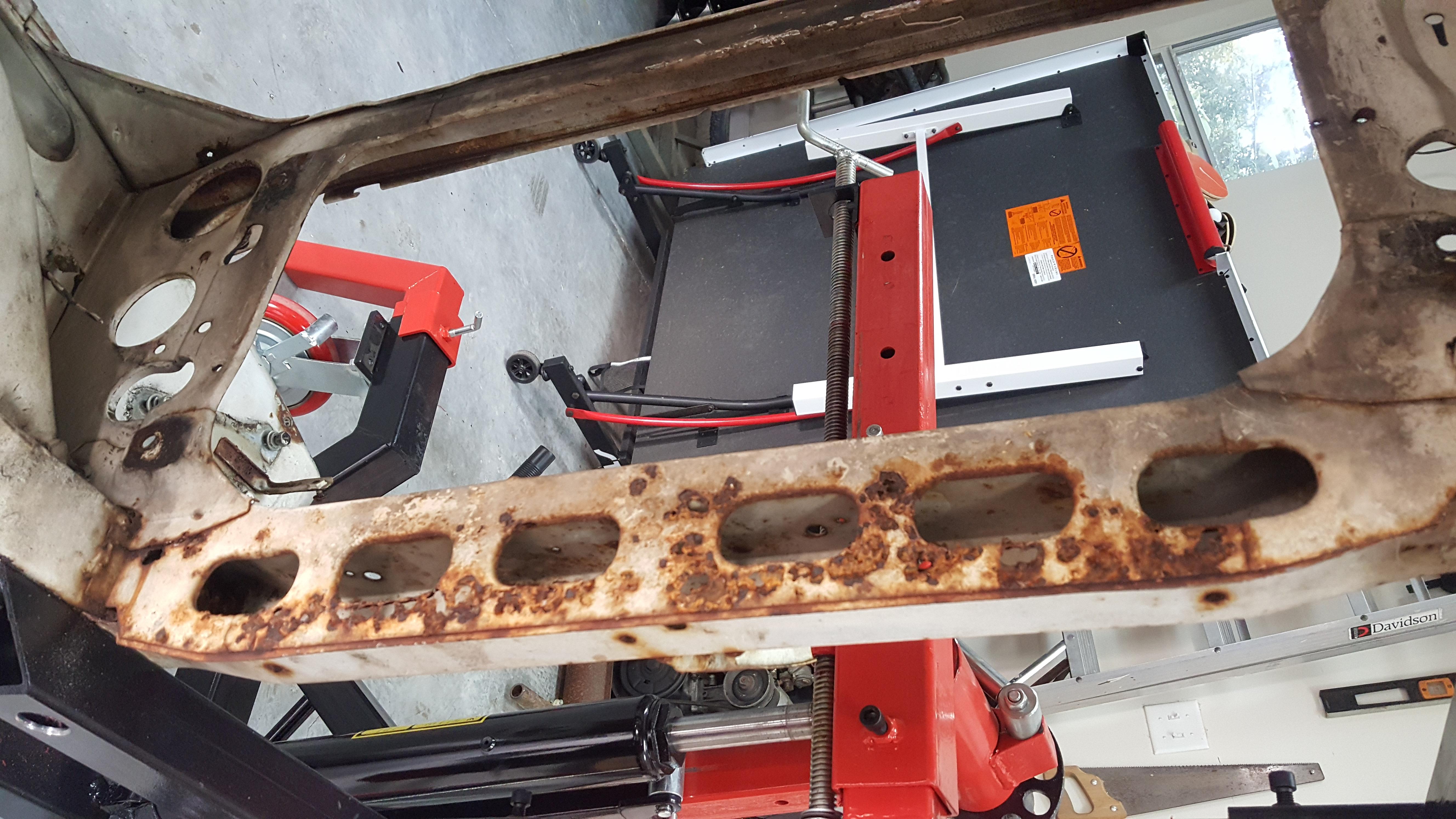

Front rails need some love, not sure yet if replacement is needed. Front cross member is rusty but only on the rear portion, it appears clean on the inside other than a couple of areas.

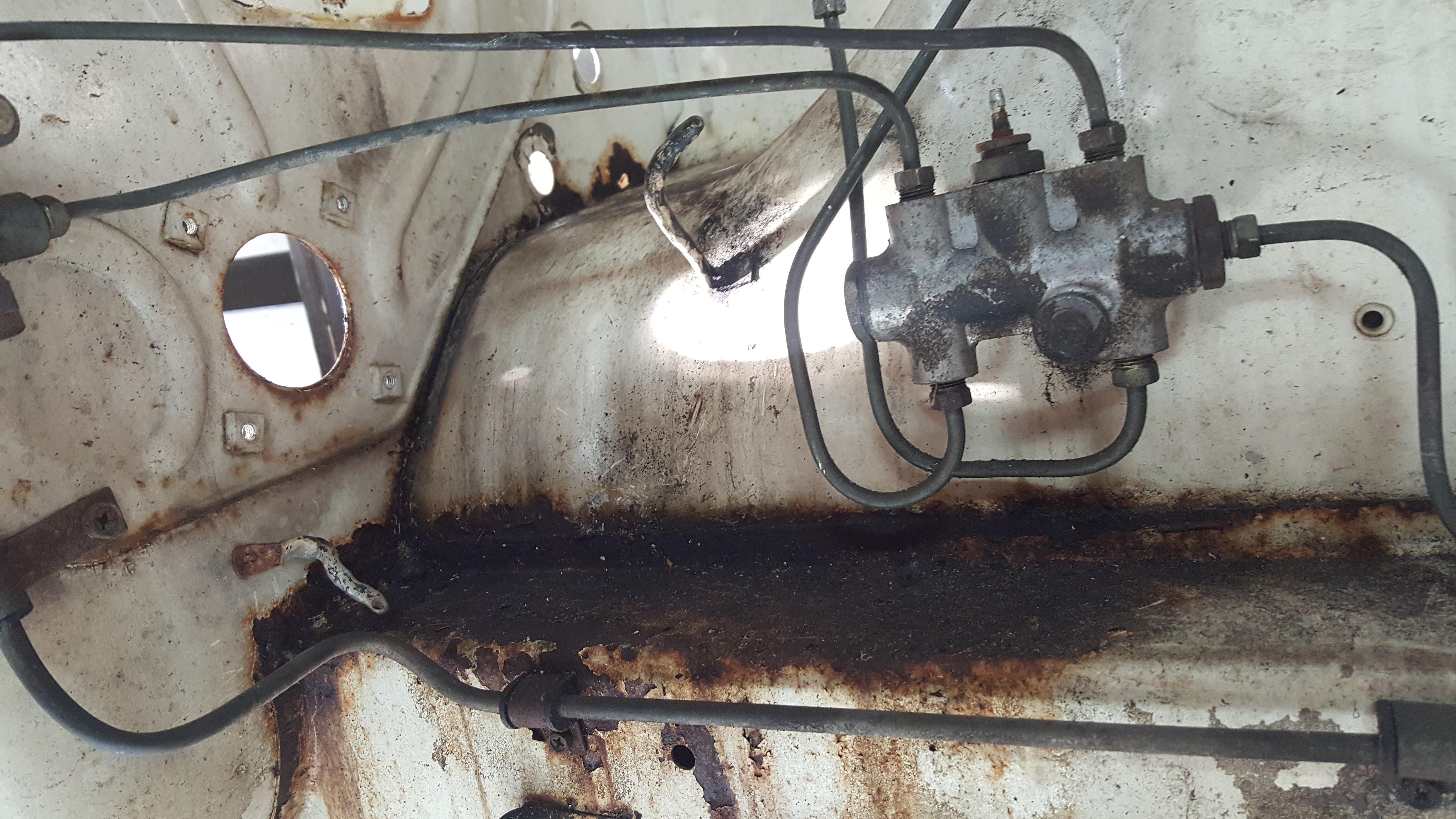

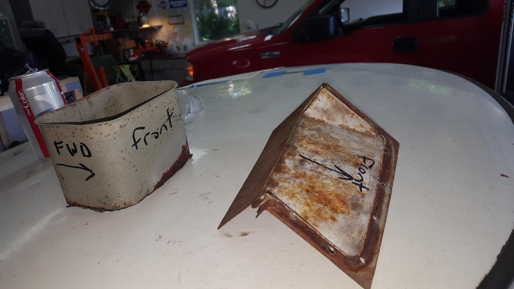

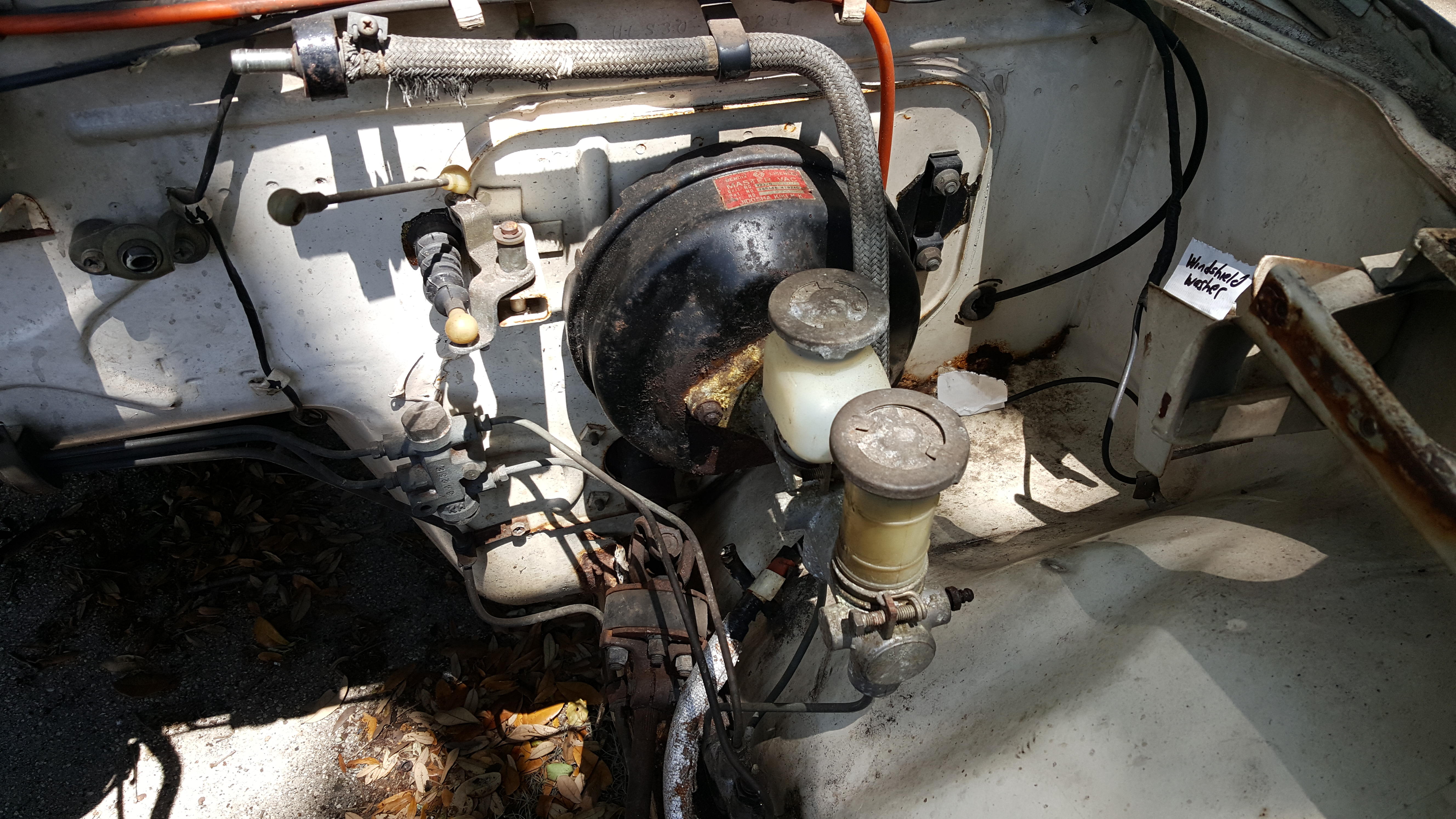

Ill be removing the battery tray to address the firewall where it attaches to the rear part of the fender wells on both sides of the car. Pretty gnarly.
All the brake and fuel lines are off at this point now.
