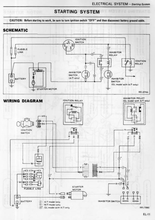

Did you cut the wire?  There is a factory service manual available for free download.  https://www.classiczcars.com/files/category/14-280zx/
No I didn’t cut the wire, the wire was already cut. The red/blue wire is connected to a little square box on the ignition , where the key goes in and I can’t find where to plug it in. I looked at the diagram you suggested and it just looks like it’s a ground..
If the engine ran before, and the wire was cut before, then it would not be the problem.  Seems like you're focused on something that probably doesn't matter.
Do you have a meter?  You need to find out where the power is and where the power isn't.  The ignition relay is a good starting point.  And the fusible link.  It supplies the relay, which passes the power on to the harness.
With a meter or a test light you can find out where the power is not getting through.  This is just one diagram of many in the Electrical chapter.  With wire colors.  Locations are in another part of the chapter.  You just have to get in there and poke around.  Don't forget to double-check the battery connections.  They can be tight enough to run the meter but loose enough to open up when the starter draws a lot fo current.  They need to be tight and clean.

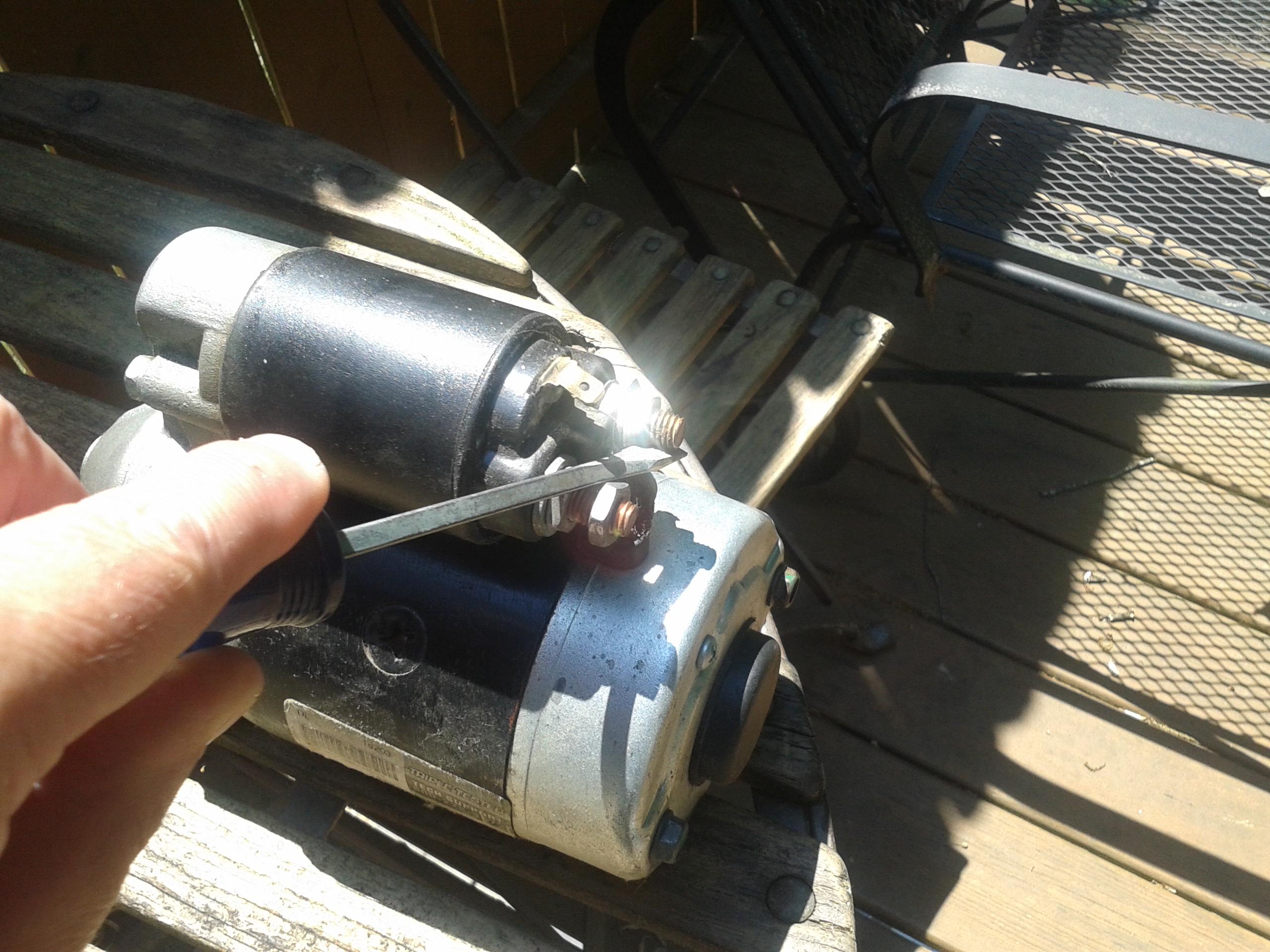

You can always use a srewdriver to jump the post on the starter. Bypasses all the BS switches but you'll still need to find and fix the problems.

The guy I bought it from did say he took out the dash and “fixed it” . And jump on the post starter? What does that do and how? And the lights for the dash turn on when I turn on the headlights on. Not the side markers, but the headlights with them
Probably shouldn't have mentioned that. If you have issues elsewhere it might not work. But here's what I've done before. turn they key to on and make sure it's in neutral. Touch the two leads on the solenoid with a screwdriver. It'll arch and scare you when it does but it should force the starter to spin. Have you tried pushing or pulling it in gear as another way to start?
