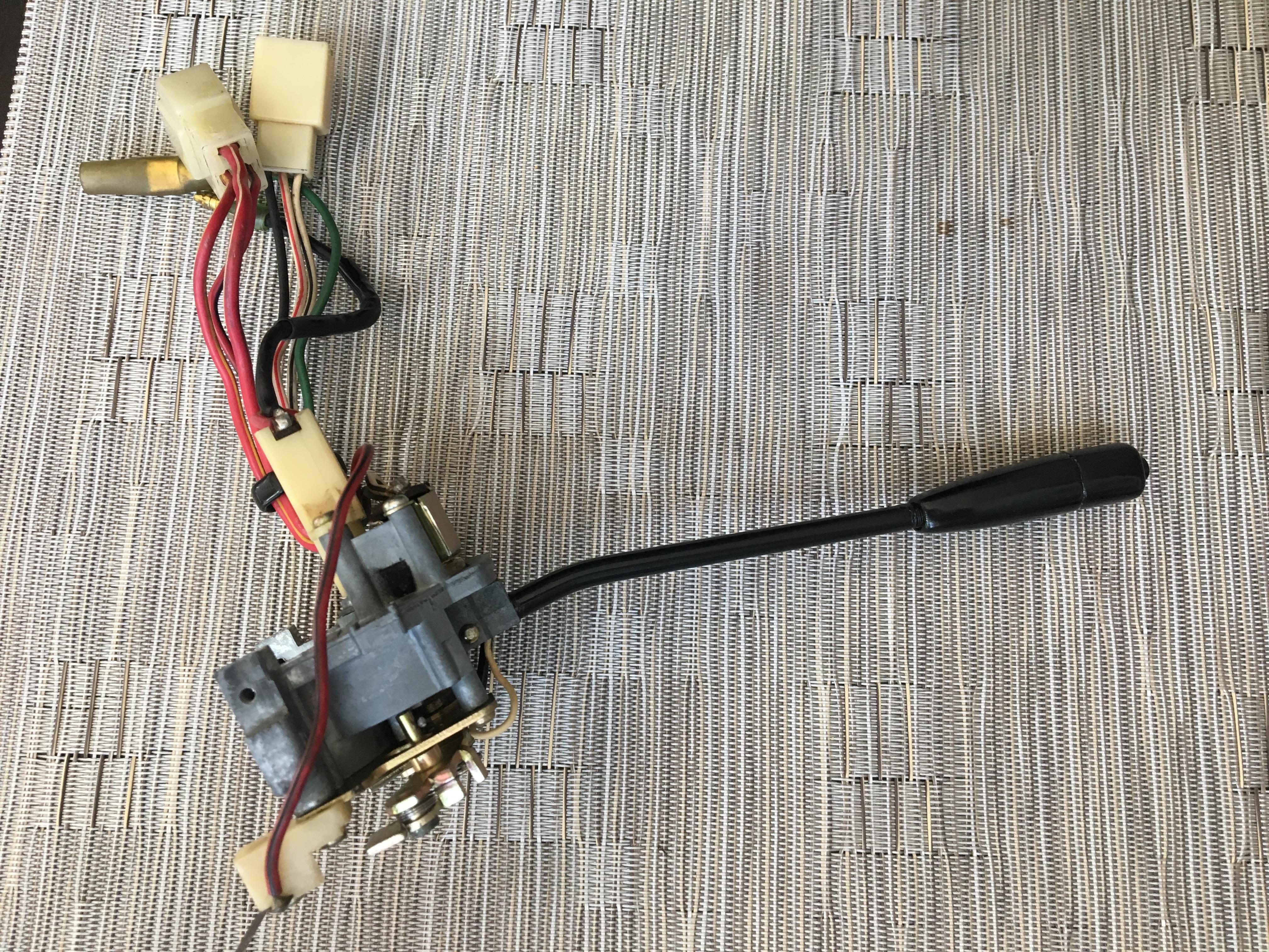

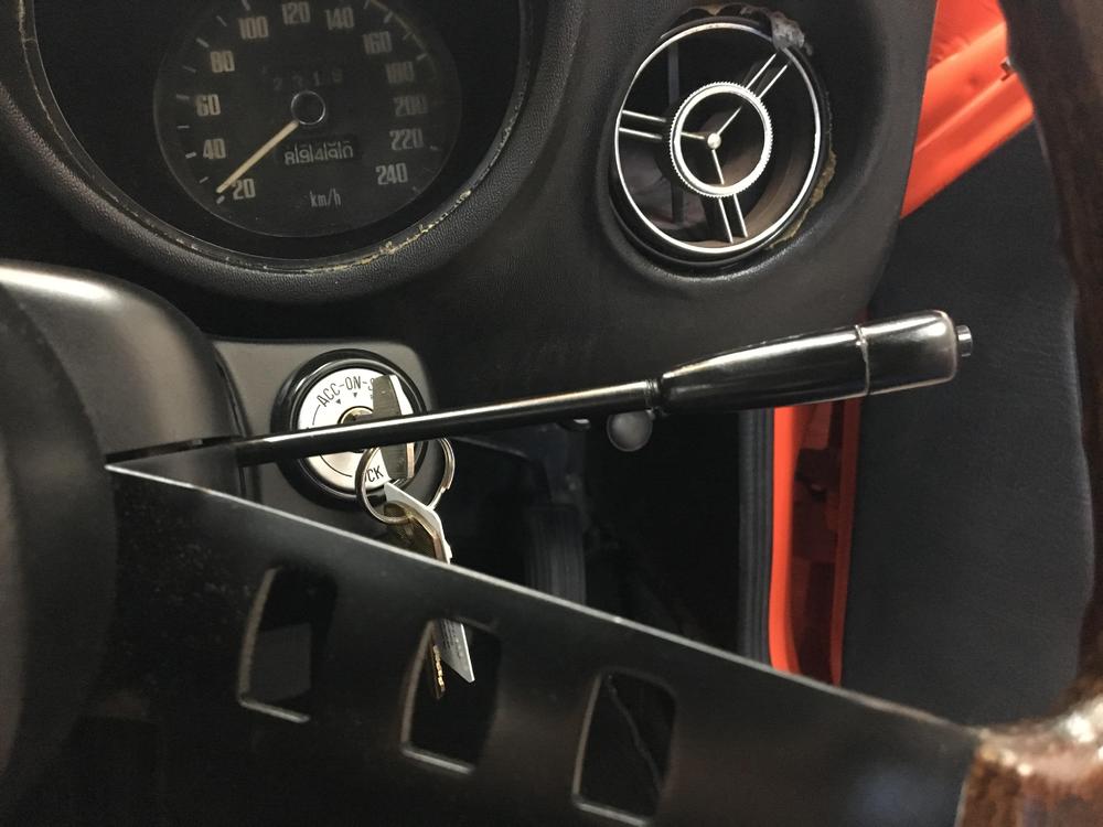

An update. The end of the indicator was missing the knob and the push to flash switch.

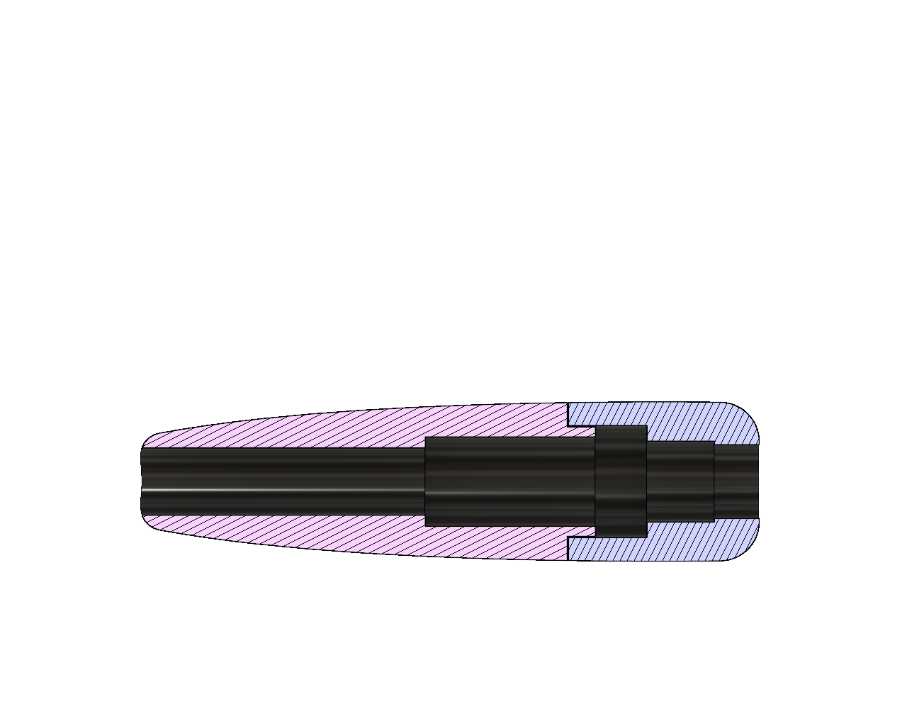

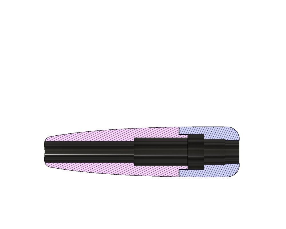

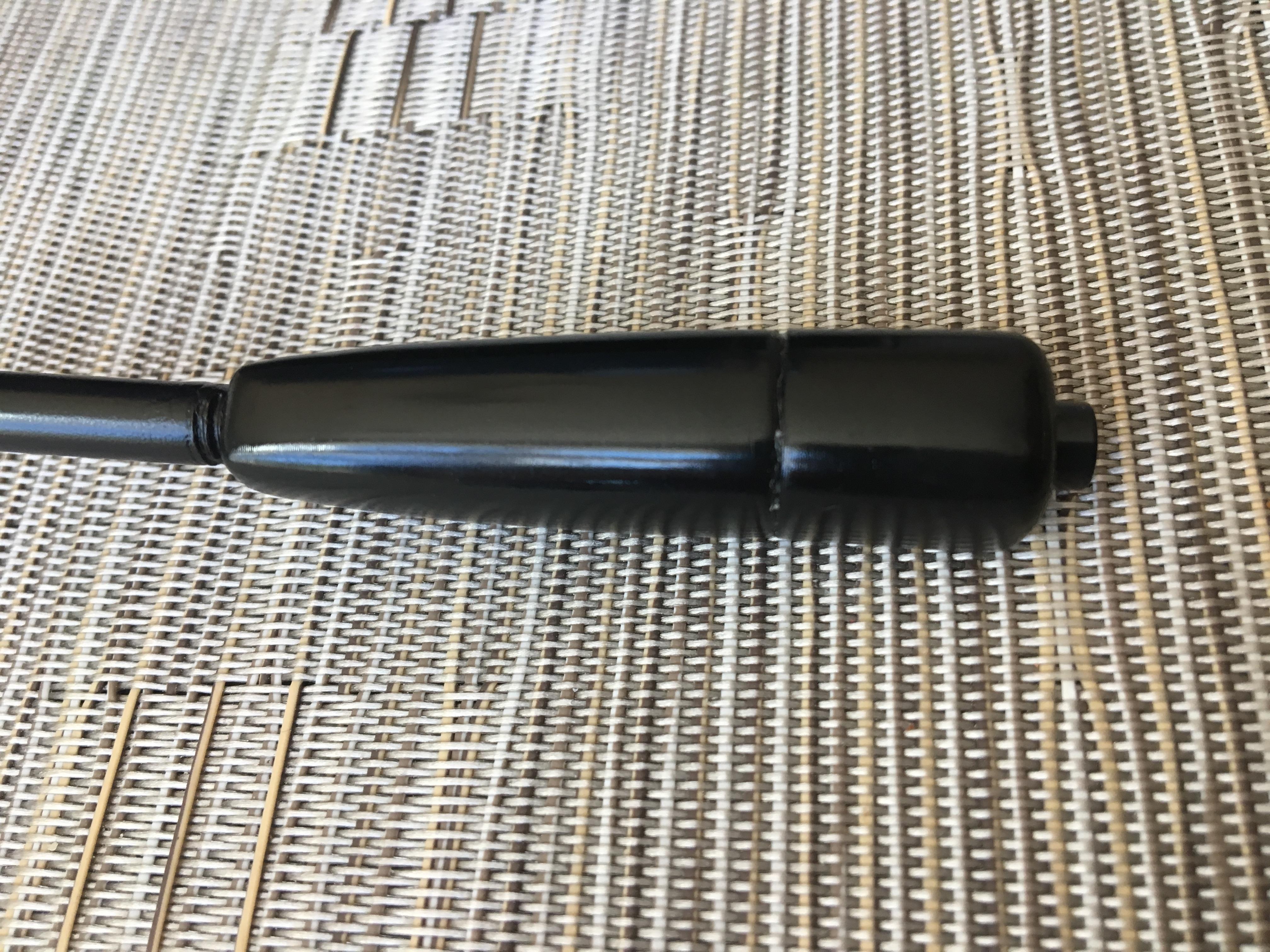

I 3d modeled and printed a replacement complete with momentary switch for the lights. All wired up, relay and lights working well.
I have uploaded the 3D model of the indicator arm knob and instructions to thingiverse
