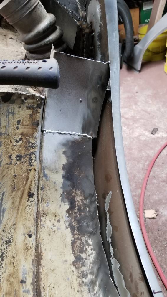

November 20, 20186 yr comment_562024 On 11/12/2018 at 8:18 PM, Elliott000 said: She was an early 260. Im hoping/assuming they are the same on that outer bulkhead area haha Sent from my SM-N950W using Tapatalk  yes they are the same part. I checked out the part numbers on the microfiche..........64150-n4501 (dpending on year and LH/RH side).... 240s and 260s use the same. The inner guards aren't the same however.... Why am I researching? .... Because of this..... Is it too far gone? Should I junk the car? Link to comment https://www.classiczcars.com/forums/topic/59909-where-to-go-with-this-rusthole/?&page=10#findComment-562024 Share on other sites More sharing options...
November 20, 20186 yr Author comment_562025 My first thought when I got my car home was dammit. Toasted haha, but I'm happy I chose otherwise. I had to rebuild the whole front frame rails, the uppers we are talking about I was prepared to hand make and had started but scored on these. How's the lower/main frames on your car? Hardest part is them. Floors and those rails are pretty straight forward but re installing the tension rod mounts was a measure 8 times weld once dealSent from my SM-N950W using Tapatalk Link to comment https://www.classiczcars.com/forums/topic/59909-where-to-go-with-this-rusthole/?&page=10#findComment-562025 Share on other sites More sharing options...
November 20, 20186 yr comment_562026 This is my third Z. Last one I did was back in Australia in 2002 (im now in Toronto) and I thought it was really rusty then. I was blown away when i saw this one. Luckily I bought it so I have something to do. I will make a metal brake and buy a bead roller. Not concerned about the simple shaped stuff, or the stuff I can buy....But I am really concerned about the inner fenders. The less patch work the better, Ill stick it on a jig and rotisserie.... and install big pieces of metal where possible. Step one...acid dip and prime..... then reconsider. (I am now on the hunt for a front cut (260 or preferably a 240) Just not sure how far gone is too far.  What do you mean by 'lower/main frames'?  Link to comment https://www.classiczcars.com/forums/topic/59909-where-to-go-with-this-rusthole/?&page=10#findComment-562026 Share on other sites More sharing options...
November 20, 20186 yr Author comment_562045 Referencing the main front rails that the motor mount/crossmember/suspension bolts too. Yours may be fine but mine were trash. It's funny some of these cars can be solid in places others are wrecked. Either way. If you can acid dip that's awesome and i think you'll be fine. Sent from my SM-N950W using Tapatalk Link to comment https://www.classiczcars.com/forums/topic/59909-where-to-go-with-this-rusthole/?&page=10#findComment-562045 Share on other sites More sharing options...
November 20, 20186 yr comment_562048 Oh yeah.... They'll be trashed. All good. Thats a simple shape and id feel better with fresh rails anyway. 47 year old car..... Its old. When I get it dipped I'll post photos.  Link to comment https://www.classiczcars.com/forums/topic/59909-where-to-go-with-this-rusthole/?&page=10#findComment-562048 Share on other sites More sharing options...

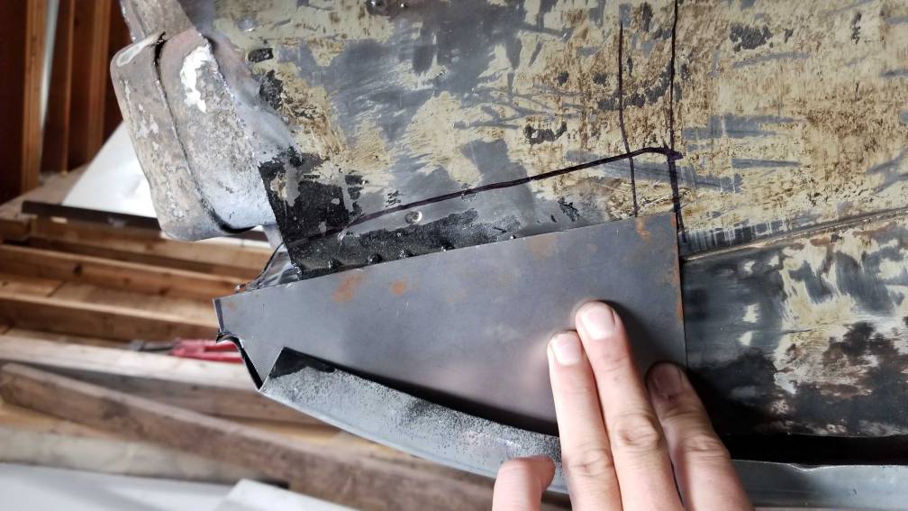

November 21, 20186 yr Author comment_562147 Any thoughts on how to shrink/tighten this dent up? Rear quarter dent, id like it improved for when I tie the patch inSent from my SM-N950W using Tapatalk Link to comment https://www.classiczcars.com/forums/topic/59909-where-to-go-with-this-rusthole/?&page=10#findComment-562147 Share on other sites More sharing options...

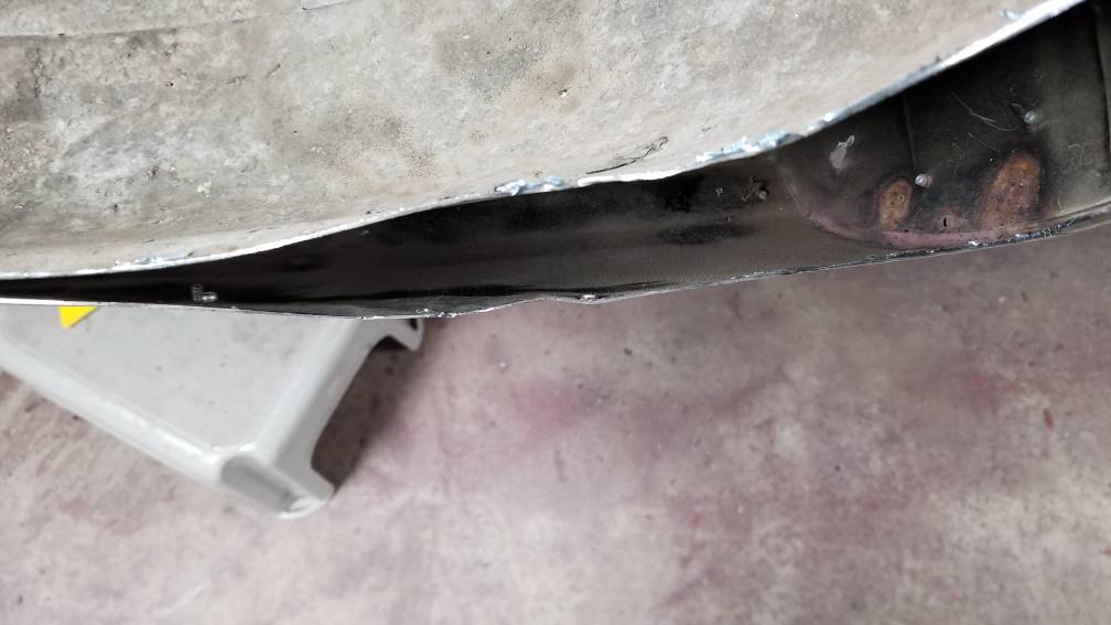

November 21, 20186 yr Author comment_562153 Also, more important. I've been starting at this inner fender for over and hour trying to figure out how to button it up and I'm getting choked. Maybe I shoulda spent the 500 bucks.... What to do. I don't care how or looks I just want the road grime to stay out until I cut for flares after inspection. Just tack a piece in and around and load the gaps with seam sealer? I don't even want to tack it to the quarter panel because I feel like a tack in the middle of the panel is gunna make a bump ill have to deal with more bondo laterSent from my SM-N950W using Tapatalk Link to comment https://www.classiczcars.com/forums/topic/59909-where-to-go-with-this-rusthole/?&page=10#findComment-562153 Share on other sites More sharing options...
November 21, 20186 yr comment_562158 3 hours ago, Elliott000 said: Any thoughts on how to shrink/tighten this dent up? Rear quarter dent, id like it improved for when I tie the patch in Sent from my SM-N950W using Tapatalk  I am having a hard time telling what I'm looking at. I would hammer & dolly it the best I could, then shrink what ever areas needed it. A propane torch and a wet rag or a shrinking disc and a wet rag. It doesn't have to get that warm to work. Link to comment https://www.classiczcars.com/forums/topic/59909-where-to-go-with-this-rusthole/?&page=10#findComment-562158 Share on other sites More sharing options...
November 21, 20186 yr Author comment_562159 sorry, cars upside down. skin with rivets/lower is the quarter panel. Other piece is the inner wheel house. Im not concerned about the inner just the quarter straightness Edited November 21, 20186 yr by Elliott000 Link to comment https://www.classiczcars.com/forums/topic/59909-where-to-go-with-this-rusthole/?&page=10#findComment-562159 Share on other sites More sharing options...
November 22, 20186 yr comment_562161 36 minutes ago, Elliott000 said: sorry, cars upside down. skin with rivets/lower is the quarter panel. Other piece is the inner wheel house. Im not concerned about the inner just the quarter straightness Ok, got it. I would still go at it the same way. Look for places where the metal got stretched and shrink those. If you over shrink an area you can dolly it to stretch back out a little. Link to comment https://www.classiczcars.com/forums/topic/59909-where-to-go-with-this-rusthole/?&page=10#findComment-562161 Share on other sites More sharing options...
