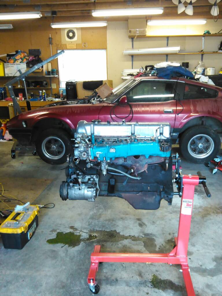

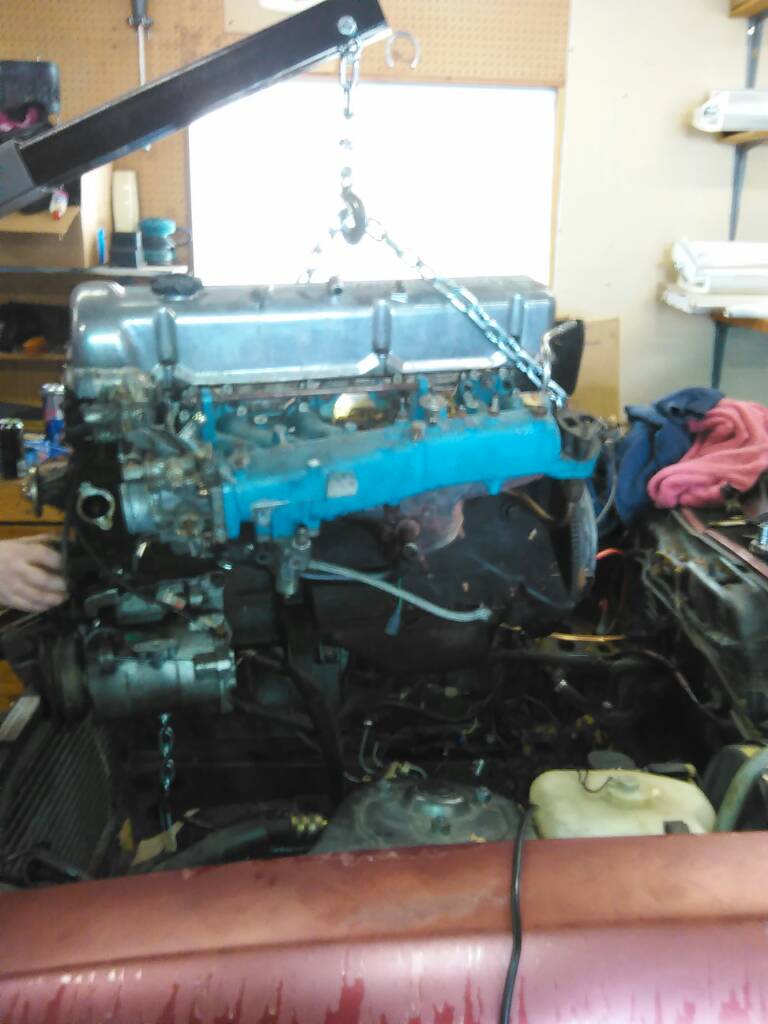

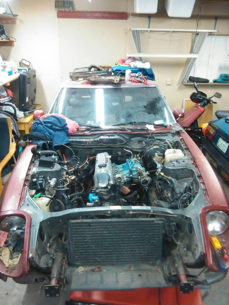

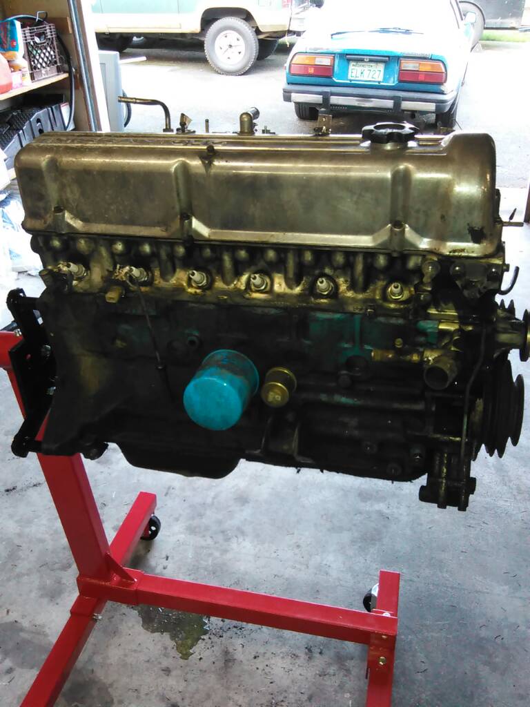

Pulled the F54/P79 out of the parts car finally. Not sure how I want to build it yet. Whether stock or some moderate performance gains.
The '80ZX I have on the road now doesn't need rebuild yet, but I believe I've read that the N47 head on that car with a more aggressive cam coupled with the F54 would produce some good performance gains.
For now I will break it apart and see what's what. It'll be my 1st L series rebuild.
I will be getting ahold of the how to rebuild your Nissan/Datsun L series book for sure. IMG_20180309_162002.thumb.jpg.75e7b45ade36cd99a4f4ccbc4fa55ae5.jpgIMG_20180309_161745.thumb.jpg.60c3232453a44f832c1e942630fd8c9c.jpgIMG_20180309_144644.thumb.jpg.d761876efef563cd668c90faa09a2f1b.jpgIMG_20180307_175932.thumb.jpg.1431ea3be8fa57c9a043723655324ccc.jpg

If you read up on the p79 head that Eliji has done for Guy you see it's easy and a straight forward head to modify. Shave the head and put pre '79 valves with a descent cam from what I understand. I think if you google "diseazed motor rebuild classiczcars.com" you should find it.

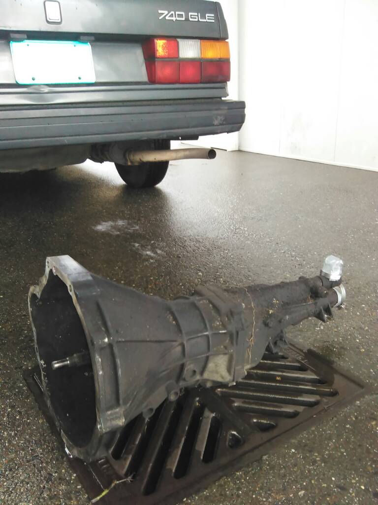

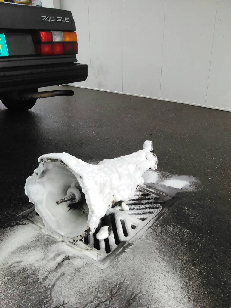

Thanks.  I just ordered it.  I'm just going to leave the head on the block on it's stand until the book arrives.  Just to make sure I start from square one.  A quick question if you don't mind..The transmission from that car is covered in oil and general gunk.  It shifted okay when it drove, so i don't plan on having it rebuilt.  But I will be re-sealing it.  Is there a safe way aside from 100 cheap-o wire brushes and 3 cans of de-greaser  to clean the trans casing without getting water/solvents inside?

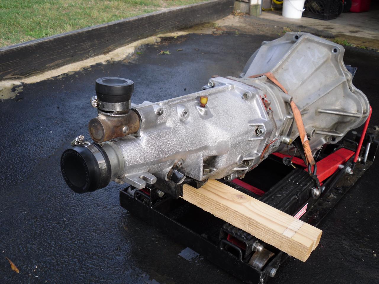

I put a rubber plumbing cap over the output and a smaller one on the shifter hole.  can't remember the sizes, you'll have to measure but they were just a few dollars.  pressure washed it first to knock the big stuff off then covered it with some cheap walmart oven cleaning foam.  Pressure washed it again and it came out nice and clean.  You could probably use a good hose pipe nozzle and a brush if you don't have a washer.

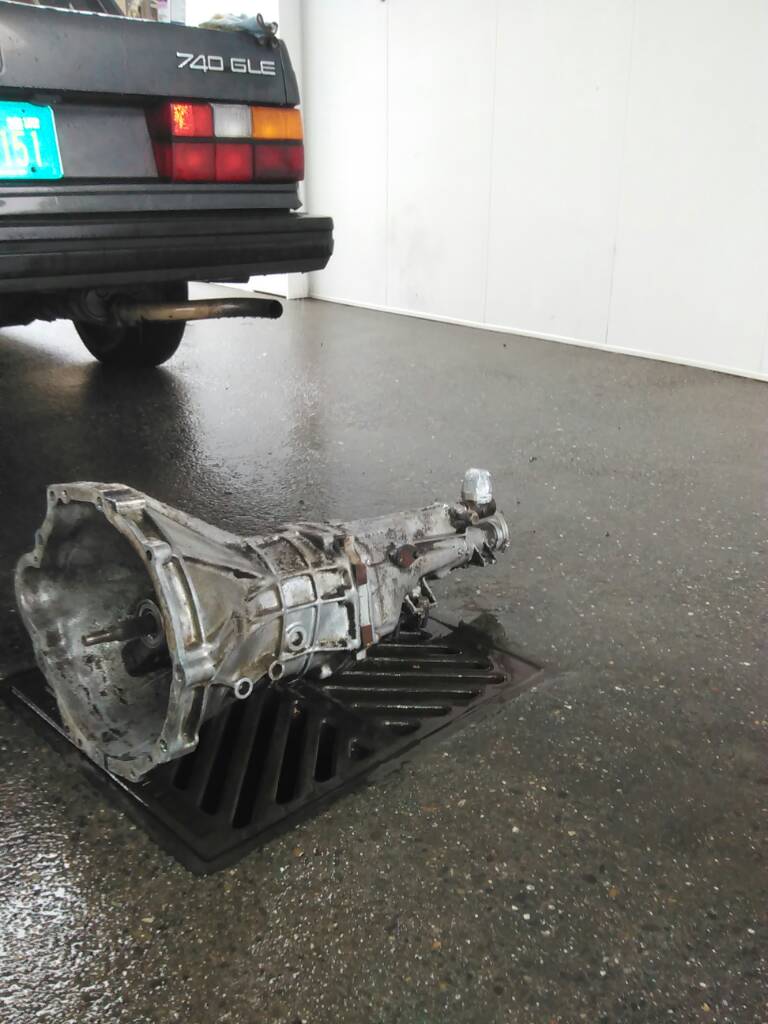

Worked beautifully, thanks. A bit of detail and it'll be all good. IMG_20180313_144616.jpgIMG_20180313_145359.jpgIMG_20180313_150134.jpg

Looks completely different. :)
Now you won't have to wear gloves everytime you grab it.
