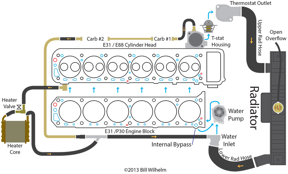

Search these words and you might find something.  Might not be the source of your problem but the results will be worth reading, long-term.

It was doing the same thing when it wasn't bypassed, I just by passed it to do the flush(didn't want acid in a brand new core) and did not reconnect it yet.

The dilemma is if you do fix the problem you might not know it because you've created another known overheating situation.
