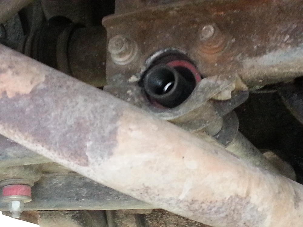

As a new muffler was being installed, muffler man noticed the bolt and bushing missing from the rear lower control arm.  He advised me to get it fixed soon as it was dangerous to drive that way.  I took it to Pete my mechanic immediately.   Getting a spare from Greg,  Pete placed it in RedBird without a bushing, and tightened all of the other bushings as they were loose.  I learned that this should not have happened, the bolt and bushing should not have fallen out.

a few things, there are factory OE bushings, and then there are PU after market bushings (I see red bird has a lot of those), both available. I prefer factor OE when ever possible, they do have a correct method of install, such as not tightening the bolt until the car is loaded (on the ground not suspended in the air with the wheels hanging). This is due to the fact that the bushing is bonded to the inner metal part, tighten the bolt with the car in the air supported by frame and you pre stress the bond (when lowered to the ground). The PU bushings don't have this issue as there is no bonding (they are installed with a lubricant between the urethane and the metal inner part) . While being a mechanic is great, unless you know the ins and outs of a Z car, then forums with members that eat and breathe this stuff can be a better source info about what parts are available and what best practice may be. There will still be bad advise, so you need to try and figure out what people to listen  to. One way of knowing is listen to those the have the most success with their own cars. Also if you get a consensus of opinion, avoid the outliers unless they are the only ones with success.
One last thing on tightening, the FSM has specs on most every nut and bolt, IIRC these require 100ft lbs, which is a lot, maybe more than what might seem right if not consulting the FSM. there is not a lot of room under the car when its on the ground so if trying to tighten that way is may be possible that someone takes a short cut and just does not get on it hard enough. For me the best practice would be to load, tighten then lift and torque to spec, at least with OE bonded bushings.
The bushing you currently have (red showing in photo) is an aftermarket PU style.

Well I can definitely supply the bolt and washer, and at the very least a stock bushing. I have to look and see if I have a spare poly bushing, If I do, that's coming as well. Please send me a PM and we'll arrange shipping details. Slightly late Xmas present, K?
Thank you zKars.  We have connected, and these parts are being sent from him to me!  Great news!!!
