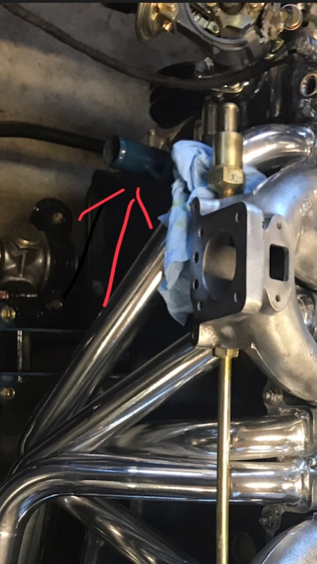

Posted January 1, 20187 yr comment_538791 Any suggestions on aftermarket air filter and crank case breather. I was considering using the stock air cleaner. But as my engine is coming together I am re thinking that. I have seen some nice pics of aftermarket filters. I will be running SU Carbs from Ztherapy Sent from my iPhone using Classic Zcar Club mobile Link to comment https://www.classiczcars.com/forums/topic/59281-crankcase-breather/ Share on other sites More sharing options...

January 1, 20187 yr comment_538804 Excellent writeup. How many triple carb setups have I seen with a little K&N filter on the block tube and often the same on the valve cover. I just checked Rock Auto's listing for PCV valves for the 83 NA and Turbo models to look for differences. They list the identical valves for all of the approx 6 manufacturers of valves. Great..... And while it's "possible" that all these valves meet the turbo sealing spec, I think we know the truth about that... And to assist with the actual question, once you get your balance tube back on, put the stock PCV valve back in and run the stock PCV hose between the block vent and the PCV valve. Put a little knipple on the back of whatever air cleaner you run and put that hose onto the valve cover. Edited January 1, 20187 yr by zKars Link to comment https://www.classiczcars.com/forums/topic/59281-crankcase-breather/#findComment-538804 Share on other sites More sharing options...
January 1, 20187 yr comment_538805 Not the question you asked but I see you have the stock (hot=closed) manifold heater thermostat attached to the front intake manifold. On the stock 240z that thermostat goes on the back of the rear intake manifold to a steel tube that goes around the back of the motor to heater Y-pipe. There's a BSPT hose barb that goes on the front. I think it's a different size hose barb than the one on the thermostat housing so it takes a special hose. All that stuff was available last time I looked. Maybe it wouldn't make any difference where the thermostat is attached (I don't know enough about how it works to say), except the special hose might not fit as well. Link to comment https://www.classiczcars.com/forums/topic/59281-crankcase-breather/#findComment-538805 Share on other sites More sharing options...
