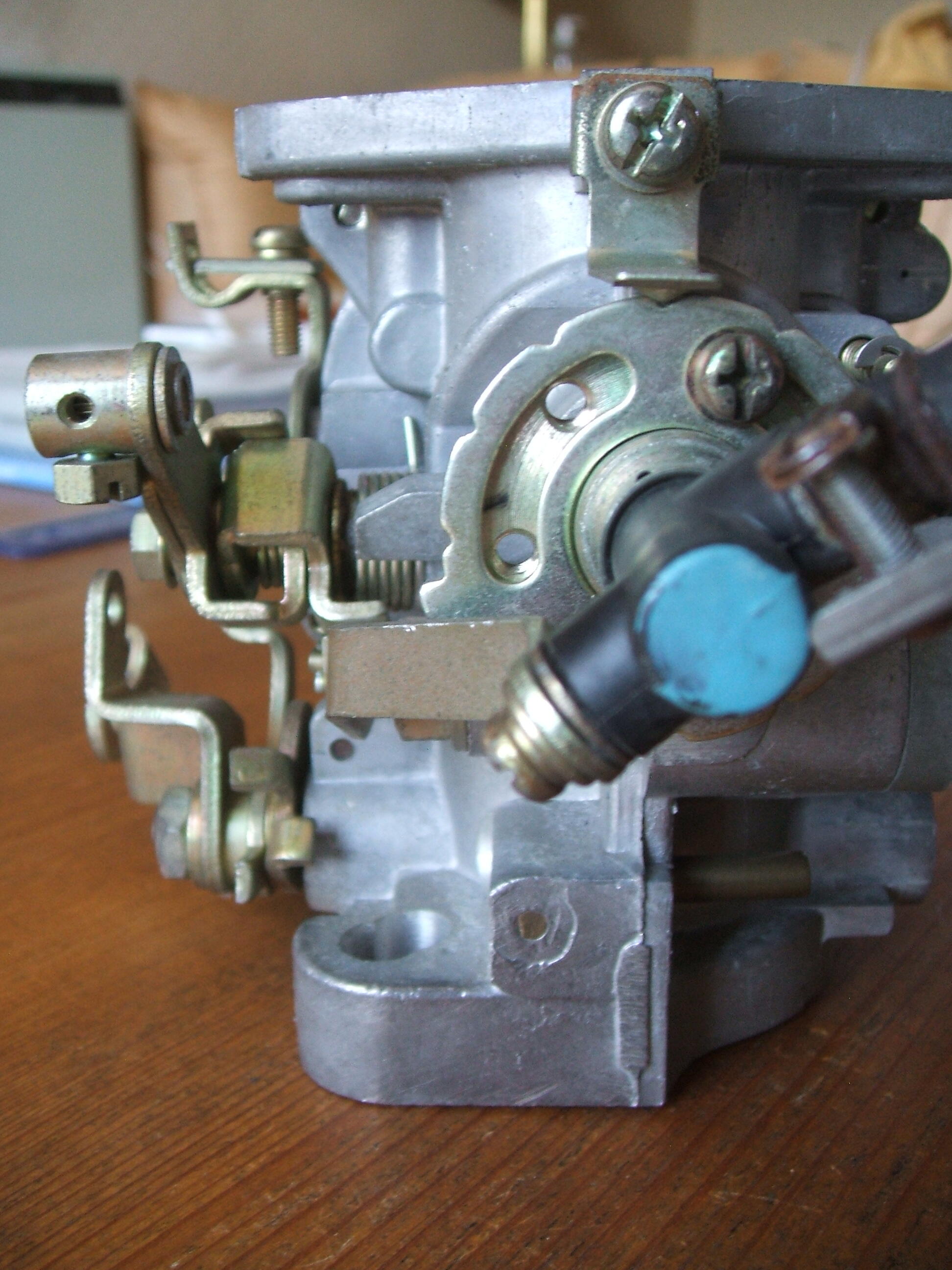

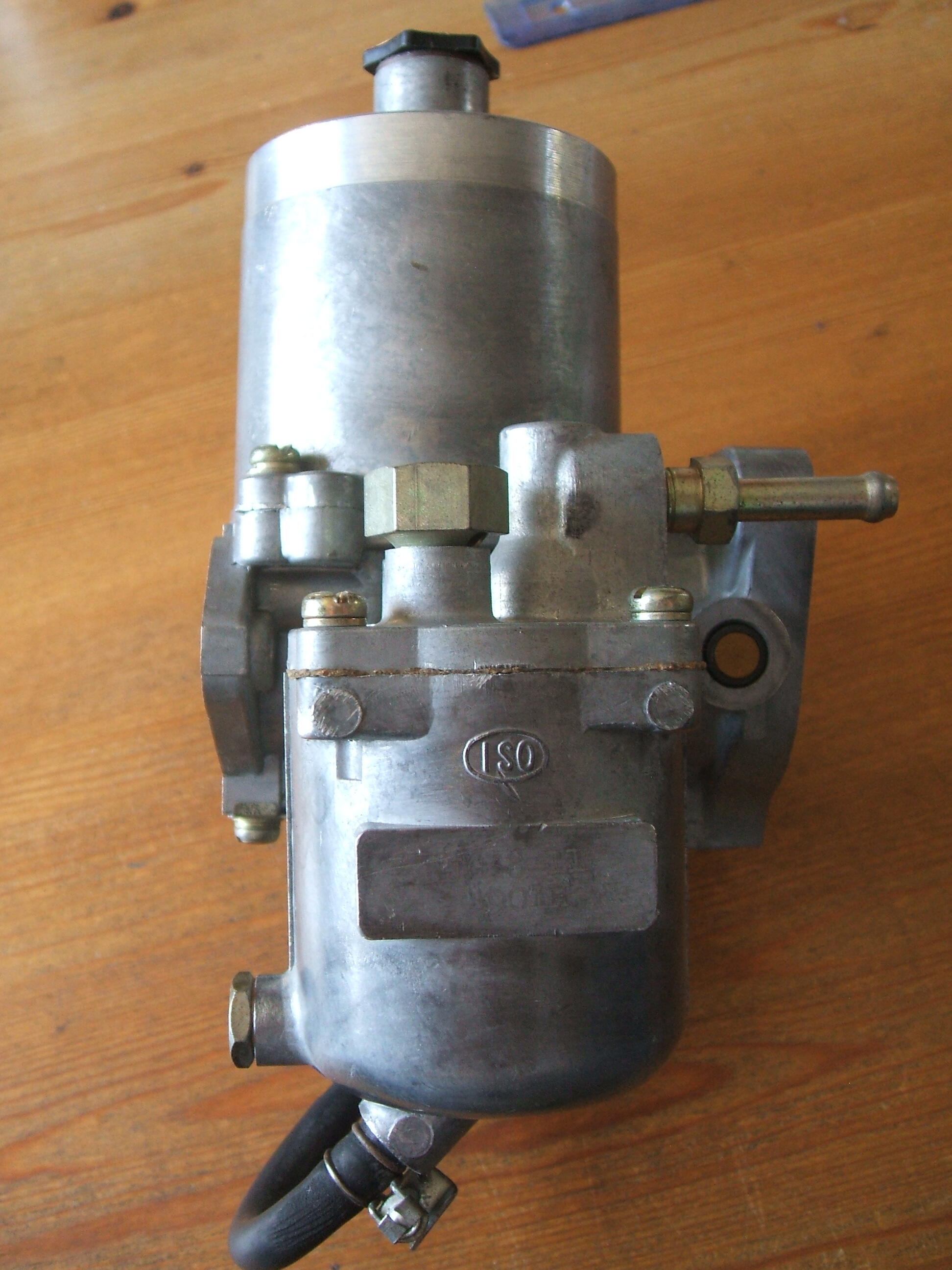

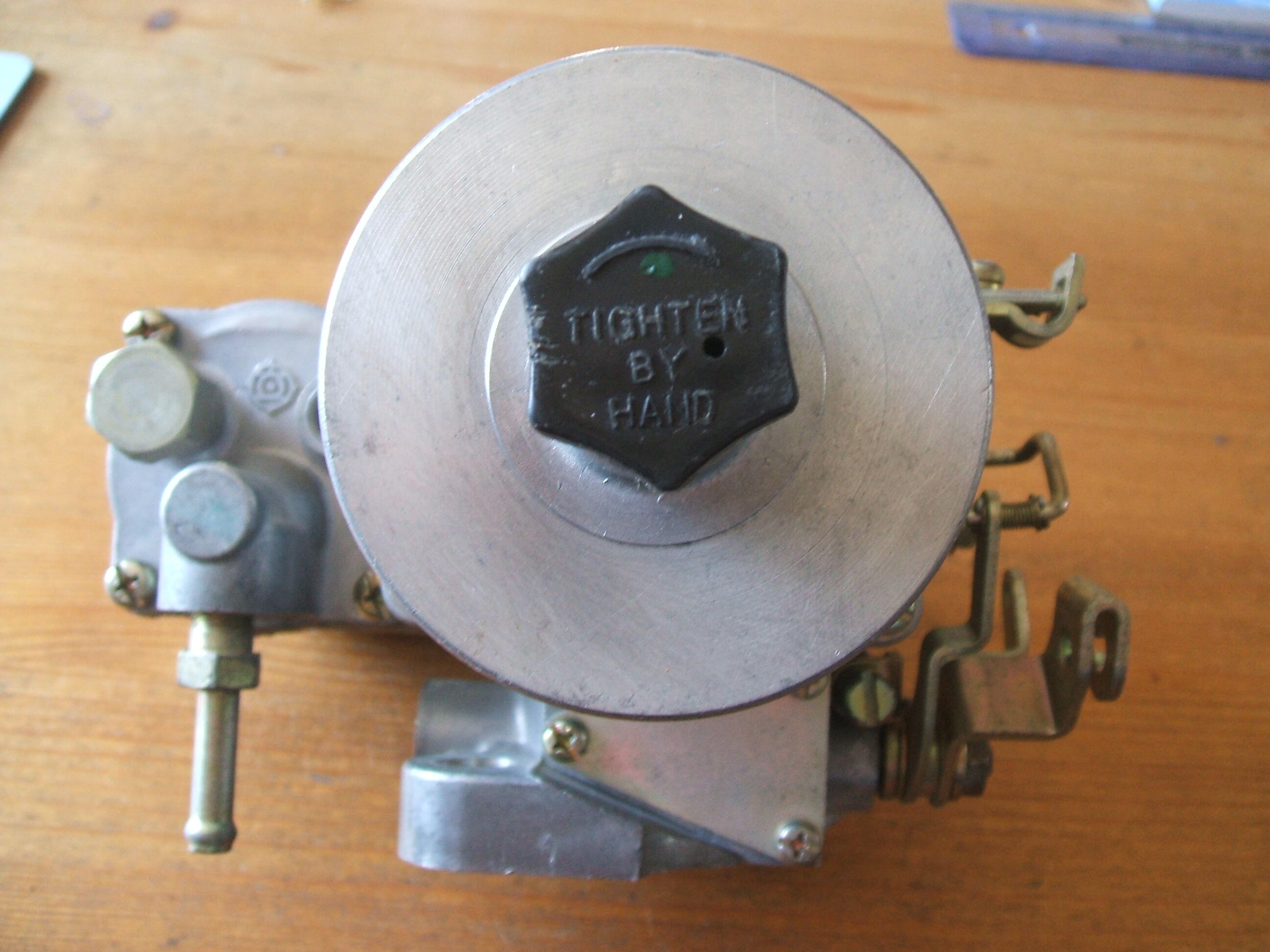

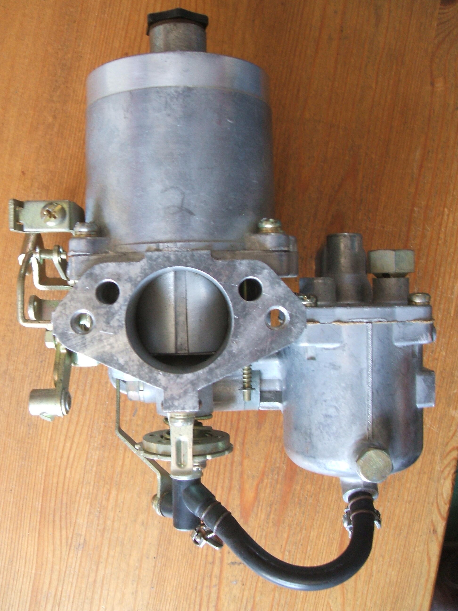

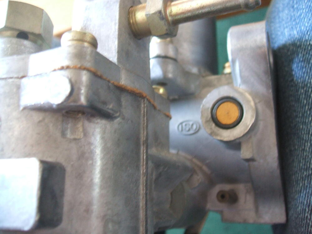

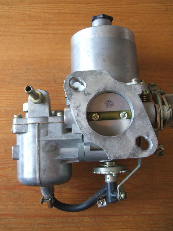

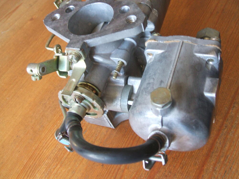

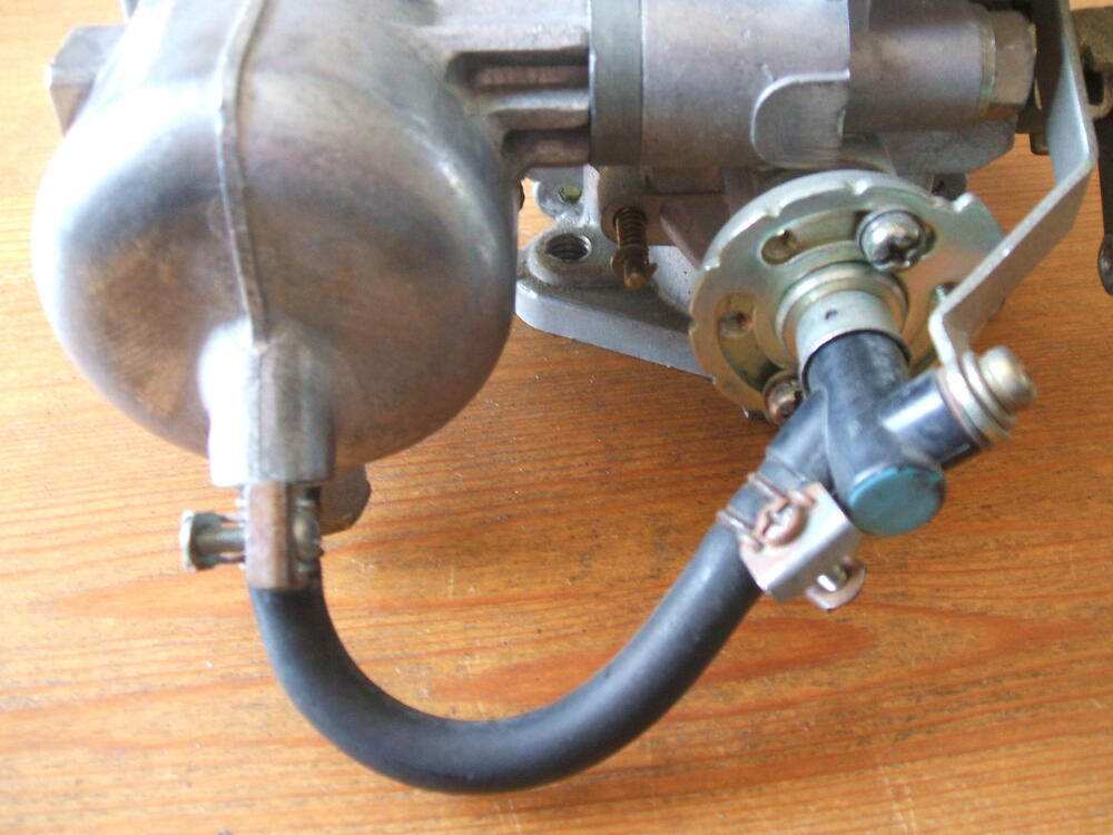

August 27, 20222 yr comment_644593 Looking at zKars post number 8, I picked up a NOS, what I think is for the 510sss, though I think the same carb was used on the JDM L20 S30Z as well... It looks very much the same, but since this was found in Europe, the set-up is (?) slightly different. I gather this is the rear carb. I would be grateful if someone would confirm and thus there are some nice reference photos. It has HJG38-11 4901H on the side of the fuel bowl. Link to comment https://www.classiczcars.com/forums/topic/59088-510-sus/?&page=8#findComment-644593 Share on other sites More sharing options...
August 27, 20222 yr Author comment_644595 I have no idea. Maybe Alan Does... Link to comment https://www.classiczcars.com/forums/topic/59088-510-sus/?&page=8#findComment-644595 Share on other sites More sharing options...
August 30, 20222 yr comment_644702 I must need my glasses checked, as I see a multitude of similarites with zKars images in post no.8. On further digging, it looks like the HJG38 is for some models in the P510SSS, and the B210 range, though could well just be a needle difference for these two differing cc's as the bodies look the same. According to the Datsun 1200 site, this could be the Nissan Competition set-up, as it is without the advanced idle mixture set-up (IMS) (between the base of the carb dome and the manifold flange it just has a blanking plate, no pipework) and has a banjo fitment bolt for a metal drain tube on the fuel bowl (instead of a barbed fitment for a pipe to go to the air filter housing). It could be that the Nissan Competition (USA) is standard for Europe. I see references to these sometimes being single carbs on some engines, but nothing found to support.... More digging.... Link to comment https://www.classiczcars.com/forums/topic/59088-510-sus/?&page=8#findComment-644702 Share on other sites More sharing options...
