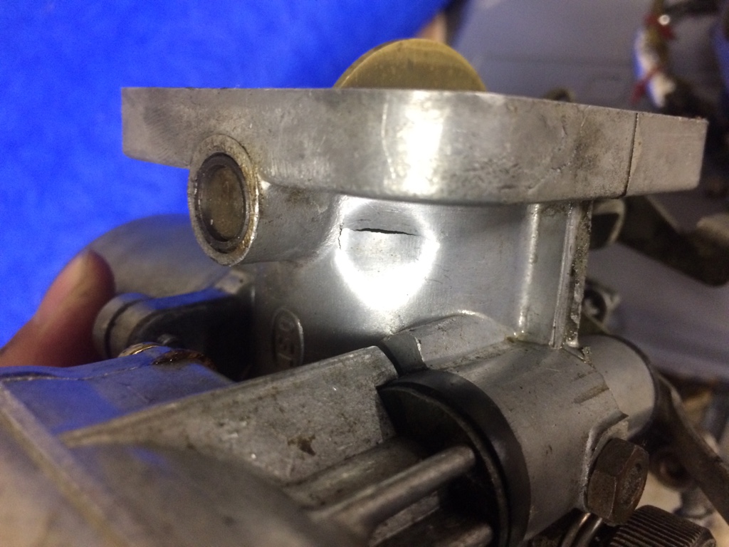

I had the exact same problem and I kept checking everything. And I found a hole after the dash pot before the butterfly. IMG_2382.JPG
The guy sold it to me told me they are bored out... It is a bit bigger with a custom grind needle. The wall is thin and the poor guy might have went though with a 10mm wrench.
I don't have time to put the engine back in the car for testing yet, but I hope this will fix it.
