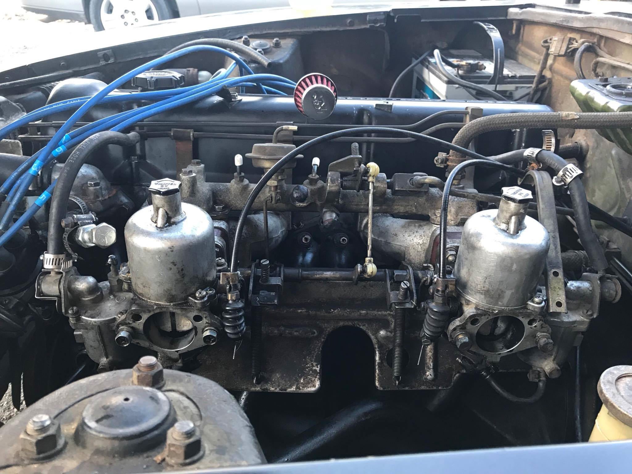

Hi guys, im having an issue with my startup, whenever i start it up it revs out of control and im forced to stop it because it seems like its going full throttle
Info:
Twin SU Carbs
Smog Equipment removed
L24 Block
N42 Head
And sometimes it revs all the way, stops, air pops out of the carb then it revs back up again almost to red line and continues

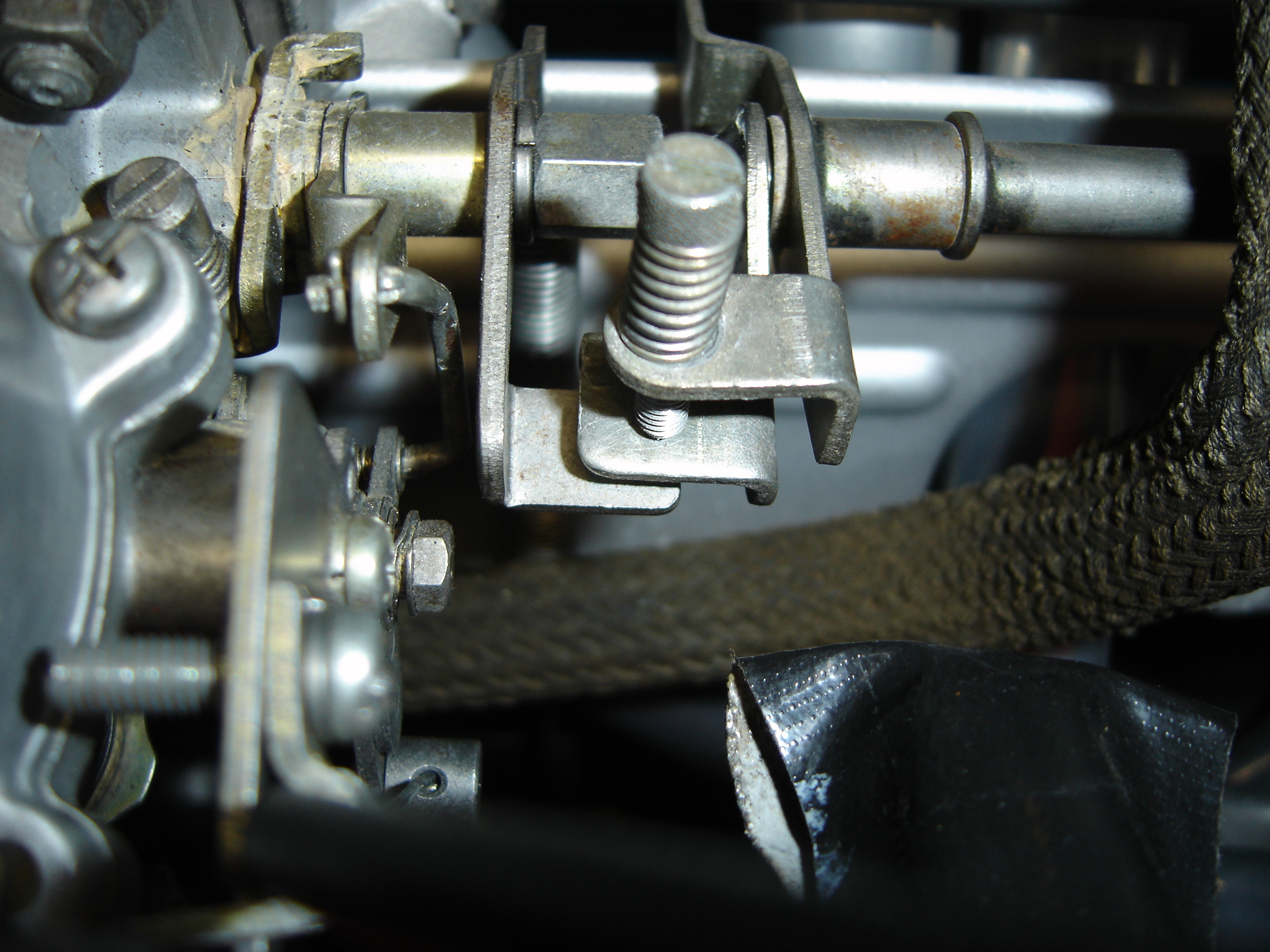

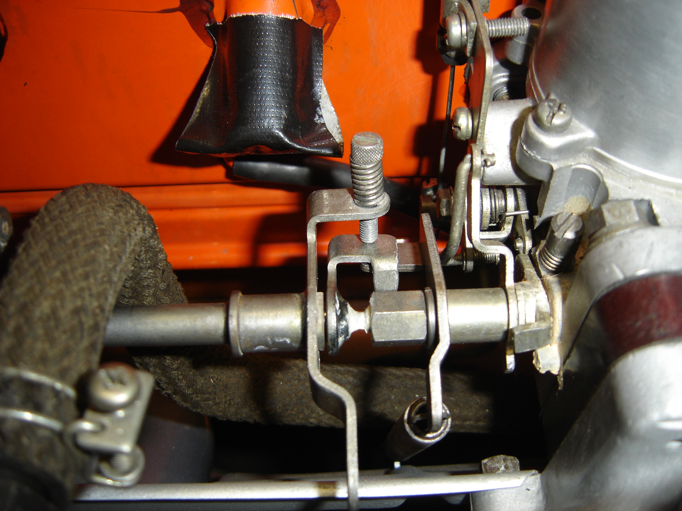

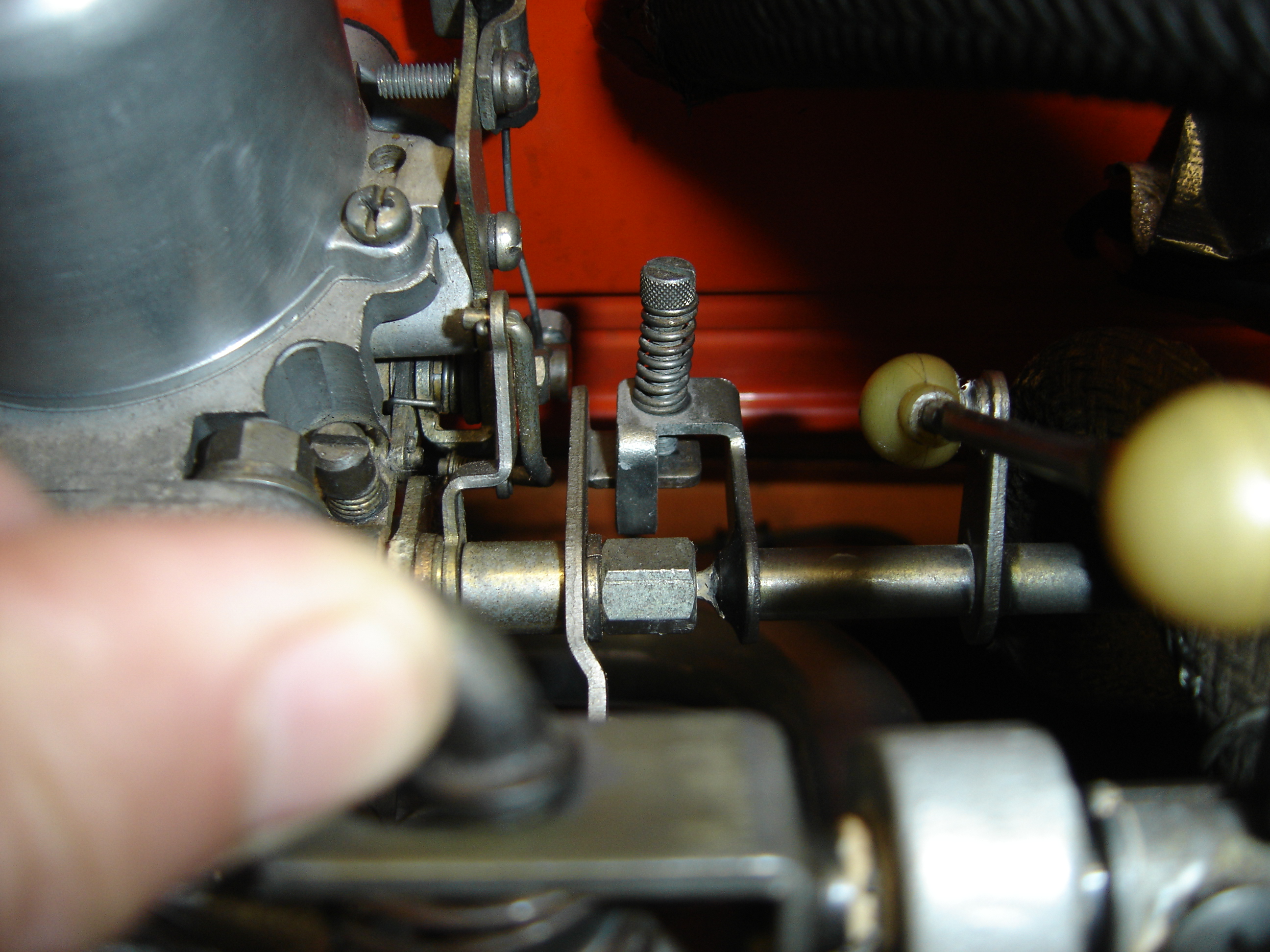

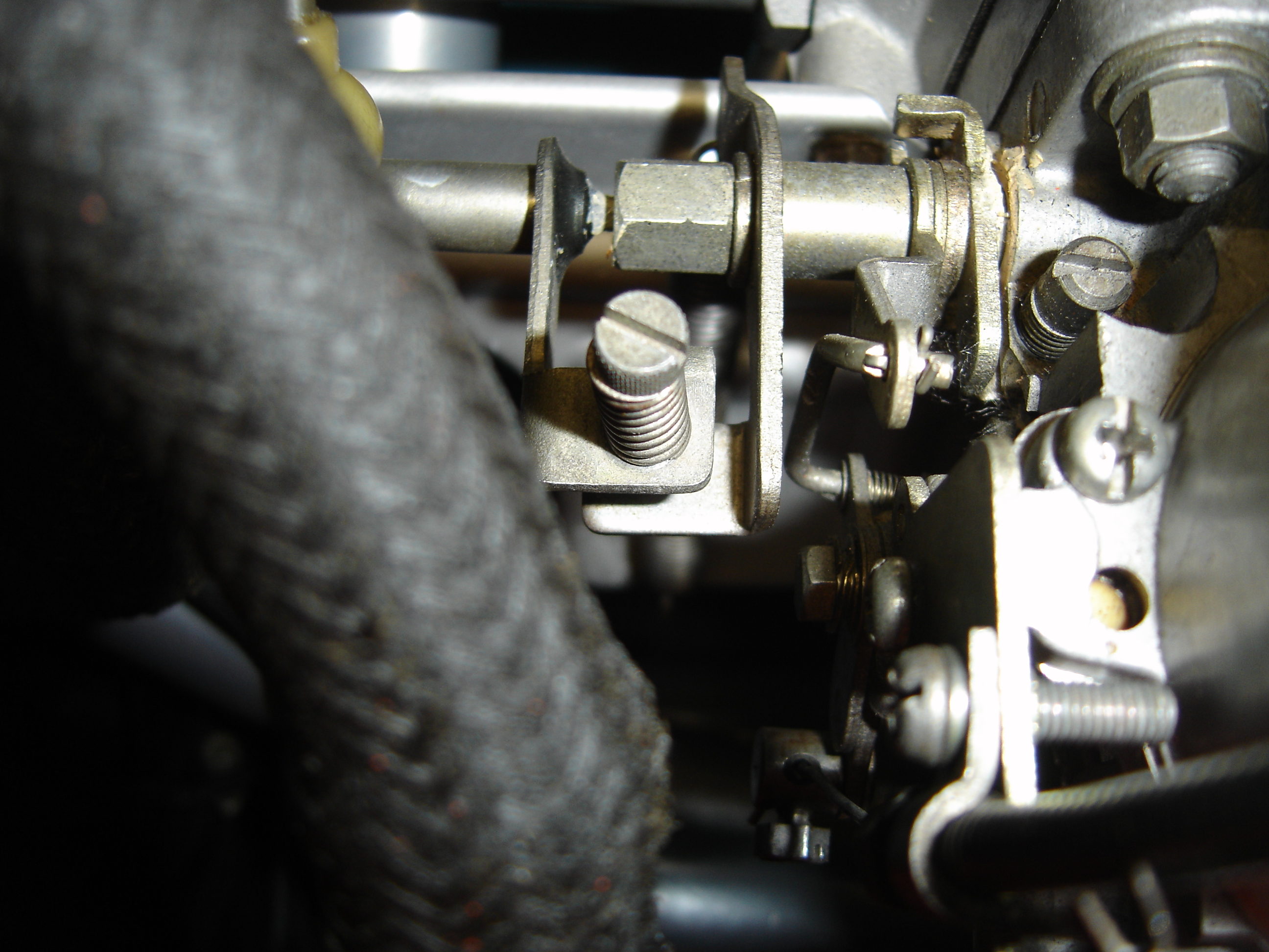

Have you recently messed with the linkage in between the carbs?  I had that happen when I took mine off and didn't reinstall those flats or stops in the right order.  The ones with the screw and spring.
Yes i removed the link between do you have a picture of what it is supposed to look like?
I must have not put it back correctly

You appear to have put new boots on the choke cables. Maybe the wires are too short. If I remember right from the locking barrel at the ends it should measure 2" to hold down for the cable. When full choke is on it measures 1 1/4".
Also feel the bottom and see if the nozzles are up or down. I'm just guessing at things that I've had trouble with.
