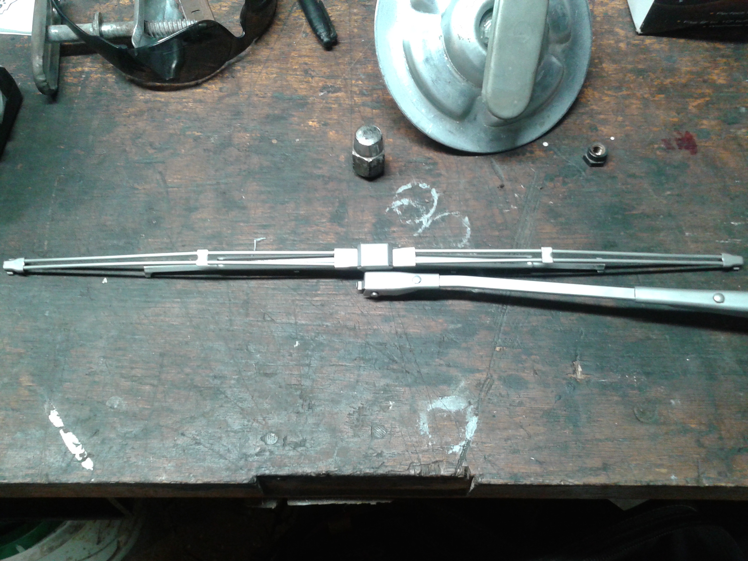

I've sandblasted the black paint of my 280's wiper assembly. Looks to be stainless like the 240s. I just now thought to see if a magnet will stick. But anyway should I clear coat them or just wipe them with Never Dull wadding? I don't want them to rust.
Thanks for any replies and sorry for jumping on here so quick. I'll try a magnet right now.

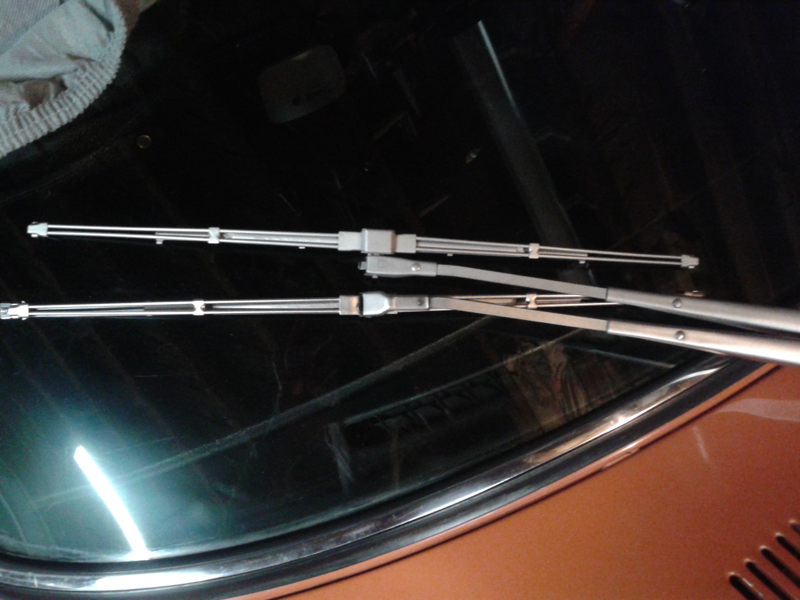

I used a matte clear coat after removal of the black paint on mine It's important that the wipers don't reflect light onto your eyes. I don't  have a closeup of the clear coated wipers but you can see the finish if you zoom in on the pic.

Capn': I thought they were ferrous because a magnet does stick to them. I guess I was wrong.
Site: The wiper blades with the "wire style" frame are not from a 77 or 78 280. The 280s in those years had a solid holder for the blade. The wiper arms themselves are the same as earlier Zs I think, and you can interchange the blade holder you like best. Since I prefer the wire style holder I went with those and stored my solid, black originals. What I stripped and clear coated was the arms.

I've got them nice and clean and will try and put a coat of clear on today, rainy out now.
