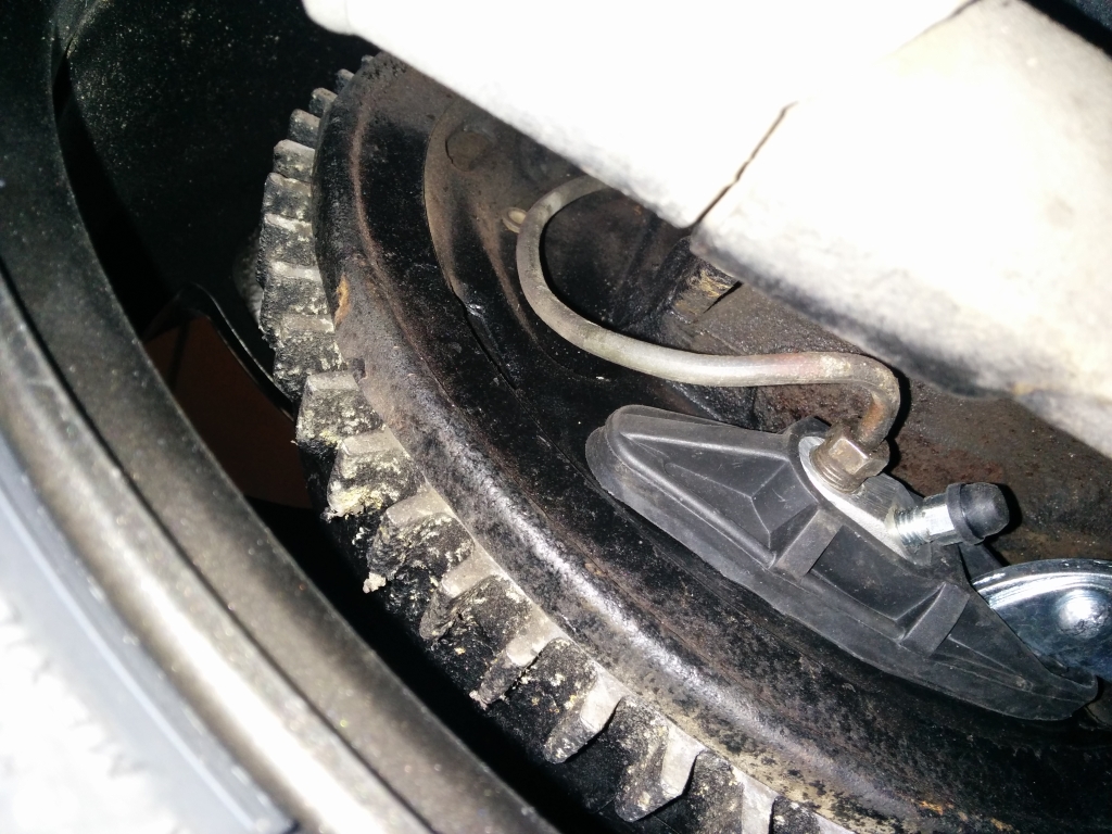

Got the early wheel cylinders changed over to the later version cylinders just fine. My buddy Dan changed a bend in the brake line and it still runs just fine around the front of the drum back plate. can't imagine paying ~$200 a piece for the early cylinders when the later version can be had for ~$40 a piece and work just fine!

w3wilkes, Thanks for this thread!  I really didn't want to spend $450+ for left and right wheel cylinders, and this post gave me the courage to go with the later-model cylinders. I replaced the old "hard-lines" with new (20inch) which wasn't too expensive (about $6 each) or difficult to bend. For the record, my hard-lines don't do a tight 90deg turn. They come out of the cylinder and do a tight "U" turn then do a gentler 90 toward the front.
Thanks again!
