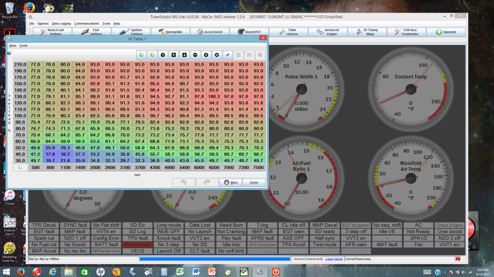

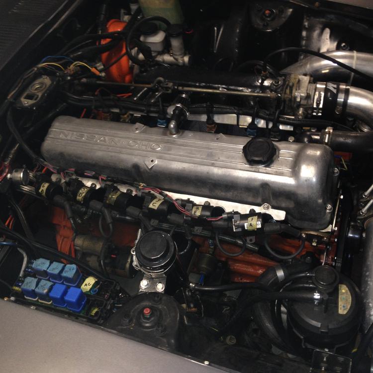

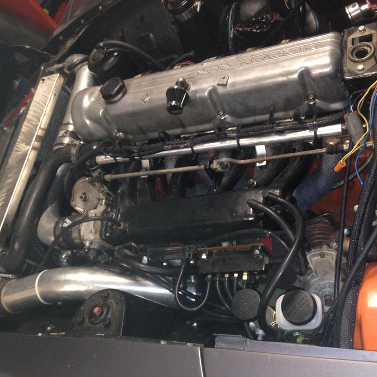

Hey all, started to work on Megasquirt tuning. Currently my fuel/air ratio's are way to rich. It would take about 30sec with the garage door to earn you wings. . if you know what I mean. Stopping at a light in traffic could turn you green. My car is a 1976 Datsun 280Z. The engine is a L28 out of a 82 280ZX turbo completely rebuilt with a new turbo. The air/fuel ratio was running in the 16.5 to 18 range at idle(800rpm's) Cough Cough. What level should I be at? I have seen on some U-tube videos that they run between 10 and 13. At the same time, what temp should the engine be running at? 160? 170? 180? We tinkered with it a little, the following screenshot was where we were at when we shut it down for the day. we ended up getting the fuel ration down to 12 to 13. We bottomed it out at 10 when the temp started to go up to 185. We increased the levels and got it back up to 12 to 13 with temp at 176. following pic was screen shot of where we stopped. Also some pic's of under the hood.
Some spec's:  Running a MS3Pro-ECU,  Delphi Fuel Injectors Low Impedance 55lb/hr at 43.5 psi.  Currently running 40psi at fuel regulator,  Turbonetics turbo,  JE flat top pistons with a bore 3.425(86.99mm)

You have some nice parts.  Not really clear what you're adjusting though.  "Increased the levels" could mean almost anything.

You really need to get as many specifics on your build before putting any power to this engine. Your VE table looks lean at boost , but I'm only NA .
