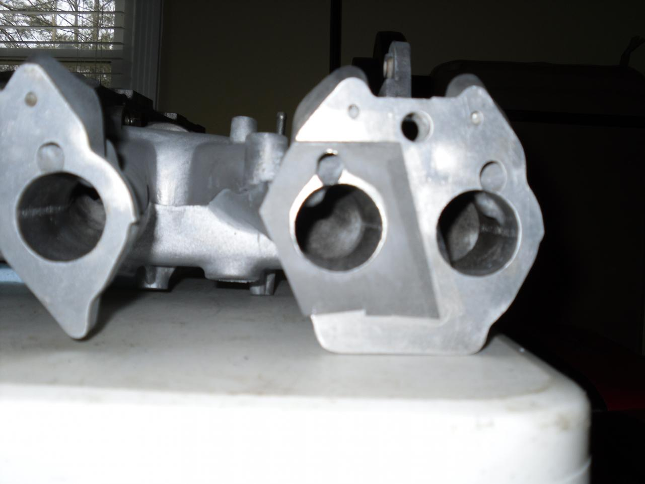

Thank you, what do you mean by "port match the intake to the head"?
here's the difference in intake ports from my intake to an N42 head that I used instead of a N47 head that came on my '77.  Small hole going into a bigger hole on the cylinder head side.  I marked the cylinder head holes on a piece of gasket paper then laid them on the intake.  Took a sharp scribe and scratched around the smaller intake holes.  Then used a grinder to open up and roll the edges like a bugle.  Quick and easy way to move more air, more air=quicker revs.
