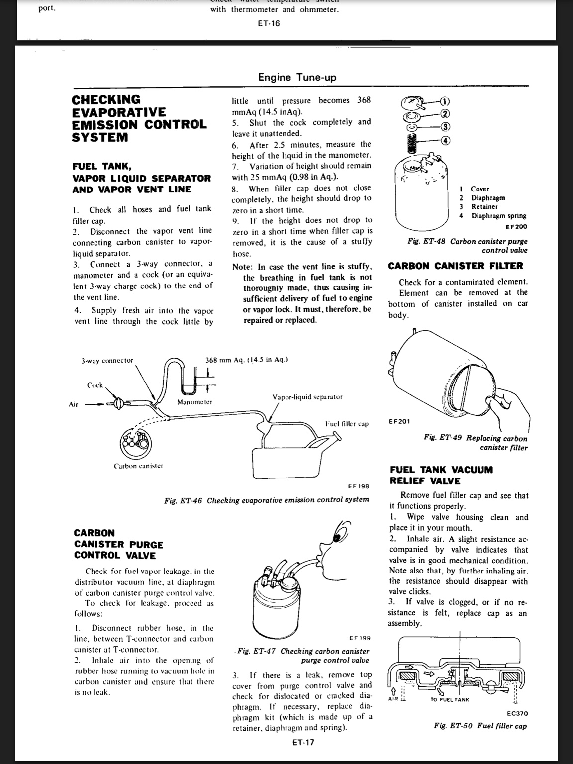

Did a little reading on the FSM, and apparently that little thing is called a "****" ?.apparently also can obstruct fuel delivery? Or something IMG_2909.JPG

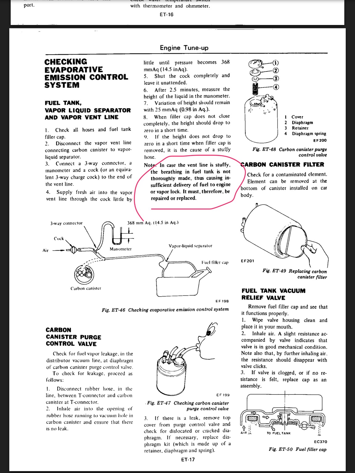

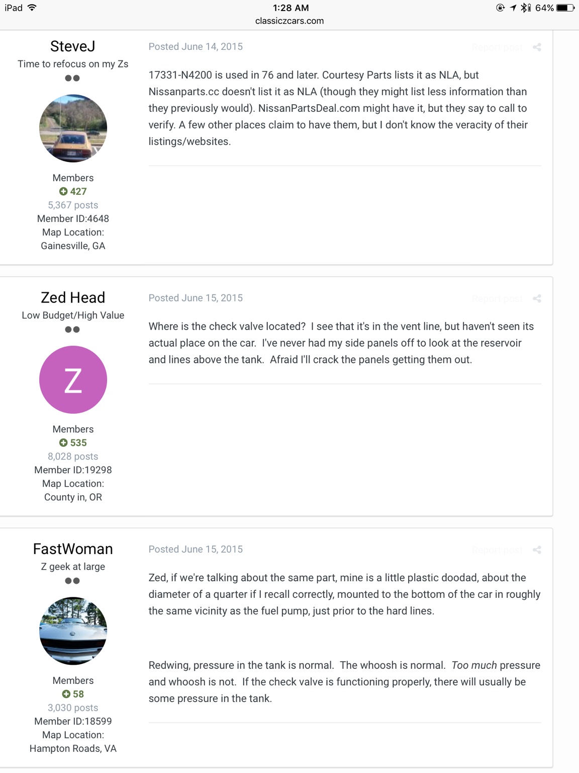

that whole section on the evap in the FSM is a bit confusing to read. The way I take it the gas cap has  a check valve that lets air into the tank from the atmosphere, as the fuel is used up to prevent a vacuum in the tank.
the vapor tank  check valve and the canister and the vacuum lines are a way to siphon off the excess fumes from the gas tank.  due to heating of gas tank and fumes from gasoline, if anything the plugged line would cause a build up in pressure in the gas tank and not a lack of fuel to the FI. I know it says otherwise (per your circled part of the FSM) but frankly that does not really make a lot of since. the vapor line check valve would never allow an influx of air to compensate for the use of fuel, incoming air has to be from the gas cap. the whole point of the gas cap/evap system is to close off the tank from the outside air, burn up gas vapor when the engine is running or trap it in the carbon canistor when the engine is off.
I think the intern engineer may have written that part (or translated it ) of the FSM. Note how the diagram does not show a check valve but its discussed. Also of note there is a built in restriction new the carbon canister in the rubber line that connects to the hard line back to the vapor tank. I don't think is mentioned. I have no idea what its function is.
