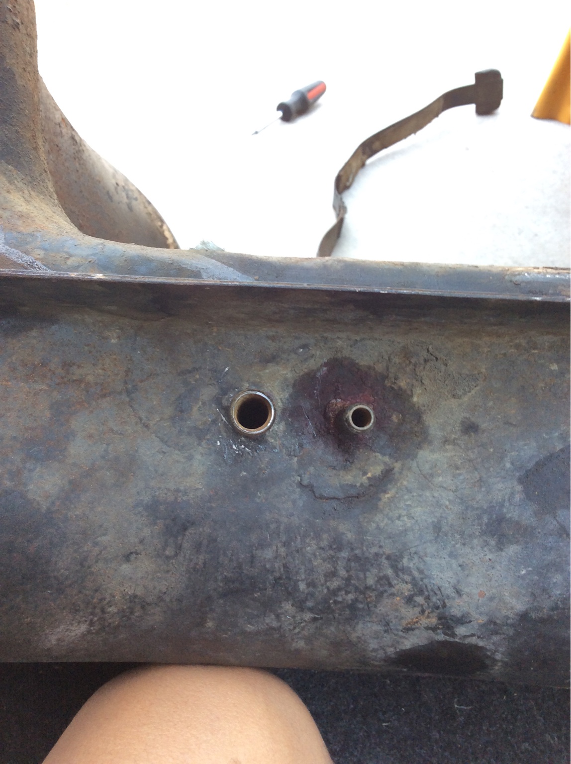

Oh didn't realize you only had the one pump.  Might be easier to use a small gas can now  put both lines into the neck of the gas can with the larger line closer to the bottom
In an early post you said it seemed difficult to blow through on the tank. Did you use your mouth? It should be fairly easy to blow both lines with a small rubber hose.

This one. So you had a hard time blowing air with you mouth.? Did you try both lines and notice a difference?
The  larger line is the supply, smaller is the return.
The filter on the vent line is a sign of trying to think about too many things at the same time.  Break it down, understand what each part does.  You have the tank out and the pump is right there.  It's about as simple as it will get.  Don't make it complicated.  Set up a comfortable piece of cardboard under the back of the car and figure out each fuel and vent line, and how the pump and lines and filter and fuel pressure regulator work.
Yes I used my mouth, and both were the same.

Easy or hard to blow? I mean obviously it won't be like exhailing. But not like trying to suck a Wendy's frosty through a straw!
I will try my best tomorrow do do this as I get off work at 4pm. I don't know what happened to the little black thing but I will ask my dad what he did with it.
Sent from my iPad using Classic Zcar Club mobile
It sure took more effort to blow through than the top two lines.
