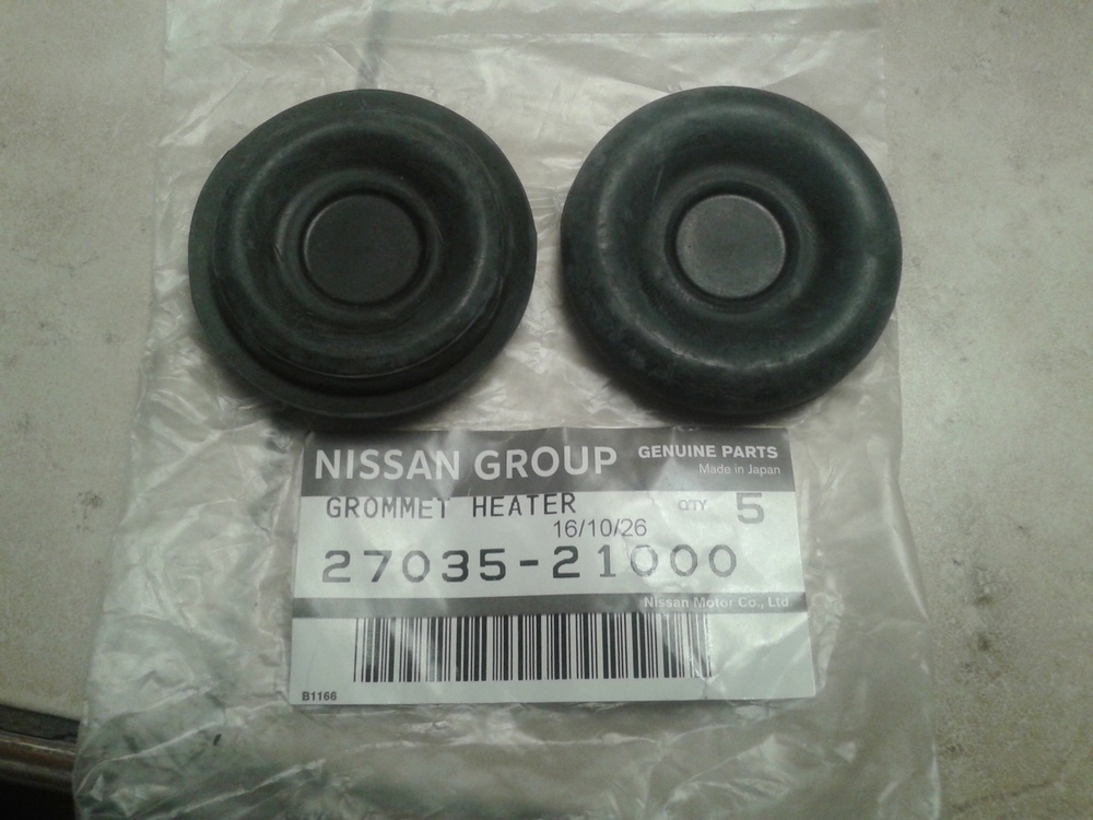

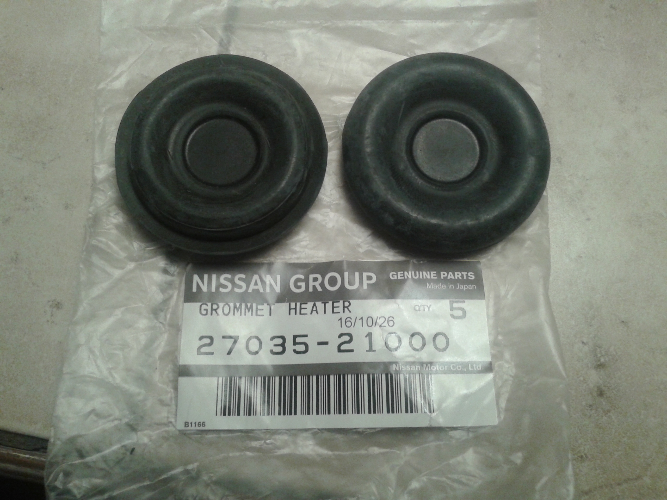

July 18, 20178 yr comment_526038 I'm good and awake now so I need to wise up my earlier post. I don't have a metric tape measure and in between 3/8s & 1/2 inches would be 7/16". And I thought transferring one on a piece of paper then mailing it to you would work as good as the actual piece? And then I thought about the rubber stoppers on the bottom of the hatch, mine were rotted out so I bought new ones from my local Nissan dealership. They use some crazy descriptions on their packaging but theses are the ones. Link to comment https://www.classiczcars.com/forums/topic/58138-rear-deck-lid-pannel-material/?&page=2#findComment-526038 Share on other sites More sharing options...
