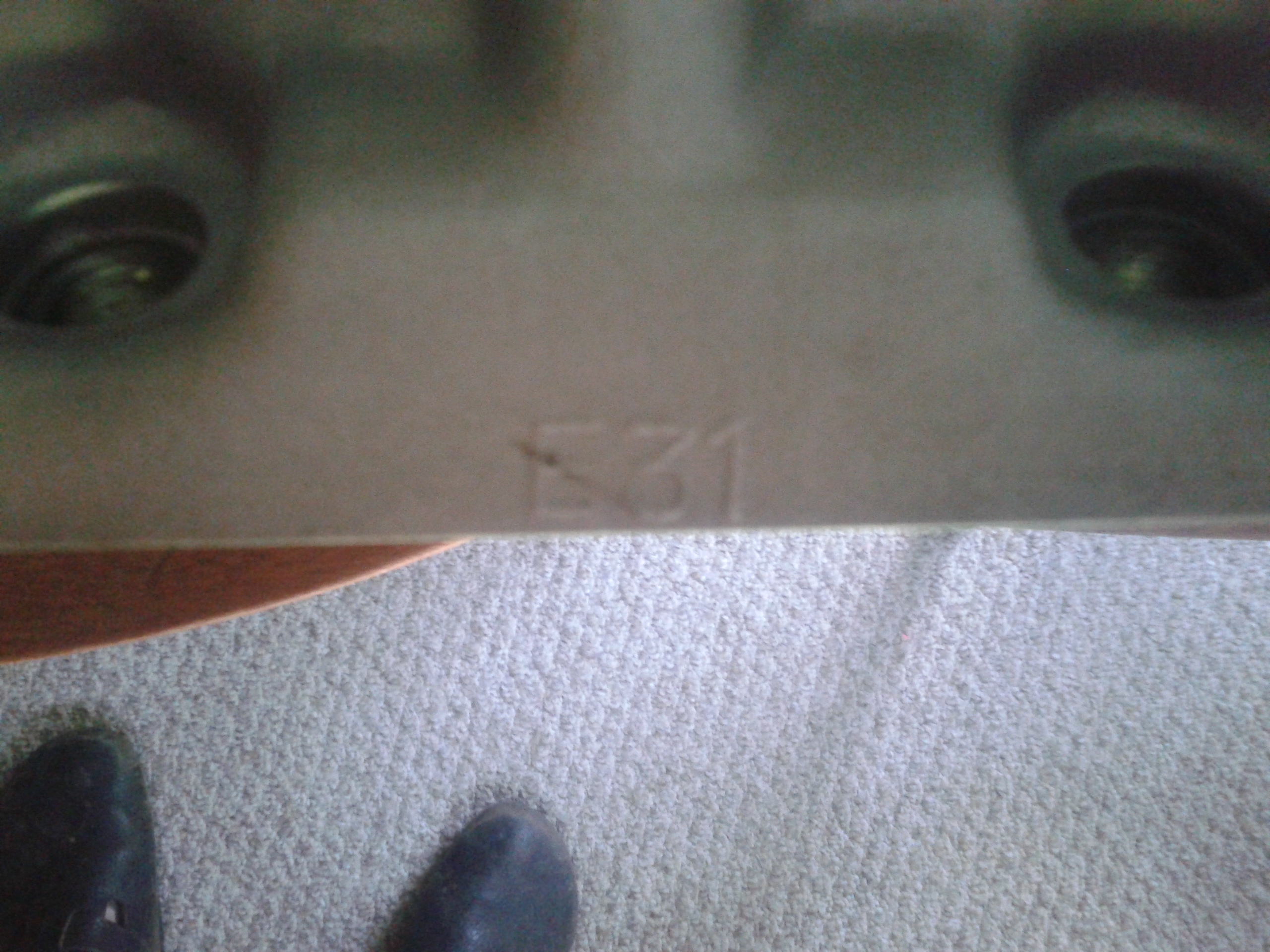

For what it's worth mine was cut once since I've owned it to straighten it, can't remember the thousandth though but here's where mine is against the E31 stamp. My machinist told me it wouldn't need to be shimmed?
Edited by siteunseen

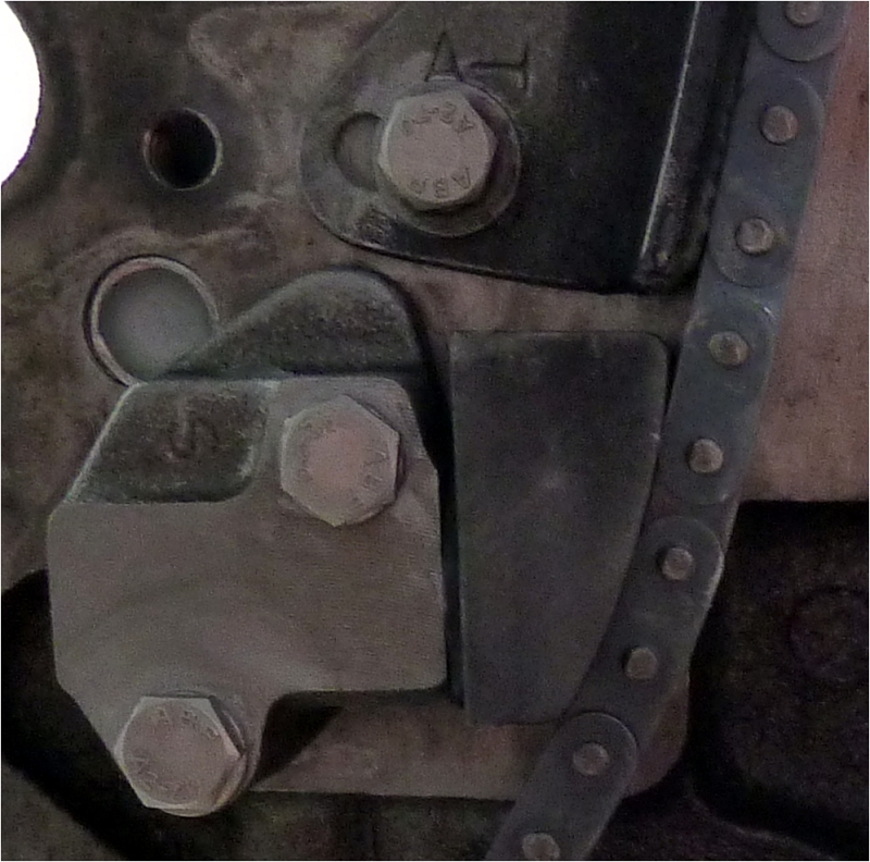

The bottom of the passenger side guide should be further  to the left so that the chain tensioner  is doing most of the pushing at that point.
The bottom of that guide should be tucked in away from the chain so that there is no wear on its leading edge. Take a look at this:
