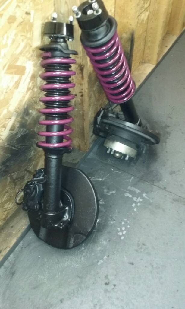

June 16, 20178 yr comment_523233 Hi there,i had the same problem on my 78z i replaced the springs and struts with the staggs vouglant kit and problem is goneSent from my SM-G360P using Classic Zcar Club mobile Link to comment https://www.classiczcars.com/forums/topic/57923-death-wobble-in-steering-wheel/?&page=2#findComment-523233 Share on other sites More sharing options...
